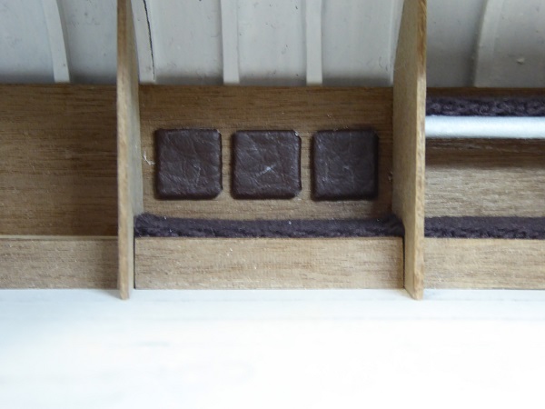

Fitted, including mattresses top and bottom.

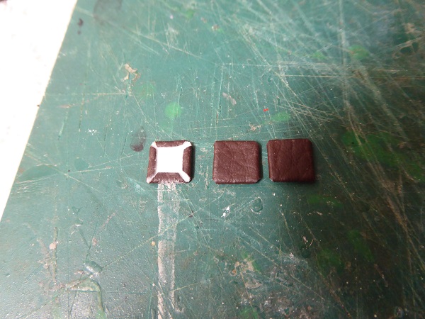

#782 Posted : 23 September 2021 20:43:09
Next i worked on adding panelling to the Officers area. Each piece of panelling was covered in leatherette.
#783 Posted : 23 September 2021 20:43:57
Leatherette panels as well as mattress fitted to the Officers bunk space/dining area.

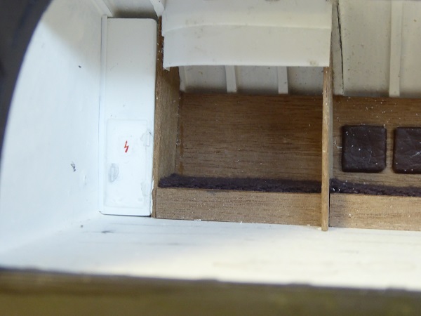

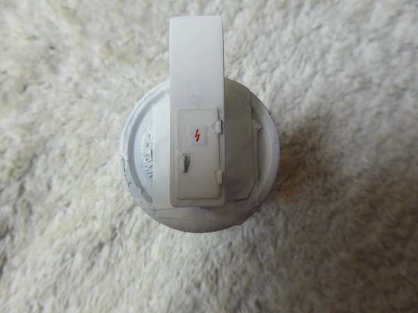

#784 Posted : 23 September 2021 20:45:27
I then made an electrical cabinet which is fitted to the side of the CO's cabin.
#785 Posted : 23 September 2021 20:48:31
Electrical cabinet fitted as well as a curved shroud above the CO's cabin. I will fit a curtain to this shroud in a later update. BigGrin

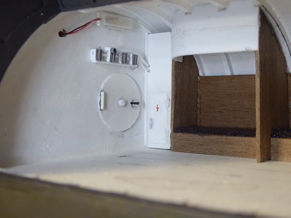

#786 Posted : 23 September 2021 20:51:36

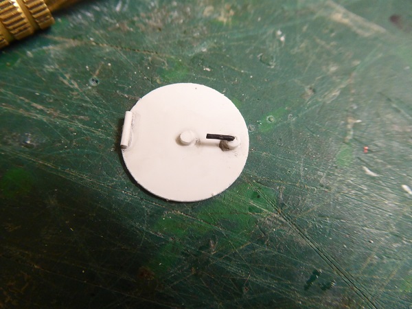

Next job was to make the water-tight bulkhead door that connects this space to the Control Room. Fairly simple to make; i used a compass cutter to produce the acetal disc and then added the hinge and handle boss from acetal rod and the handle from 0.7mm diameter solder. Painted, varnished and pin washed.
#787 Posted : 23 September 2021 20:53:58
The final jobs included the fitting of the water-tight bulkhead door, making an array of junction boxes that are wired into the electrical cabinet and finally adding the LED lighting. The lighting was tested, i just didn't a take photo working.

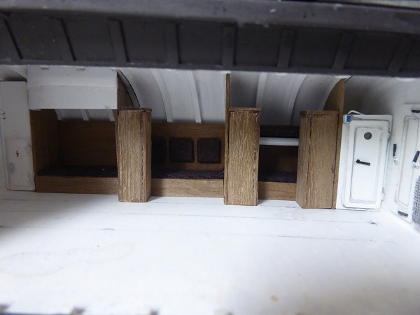

More progress made on fitting out the Officers Accommodation space. The attached photo shows 3 fitted wardrobes made of walnut veneer.
#790 Posted : 30 September 2021 20:27:16
Looking from another angle.

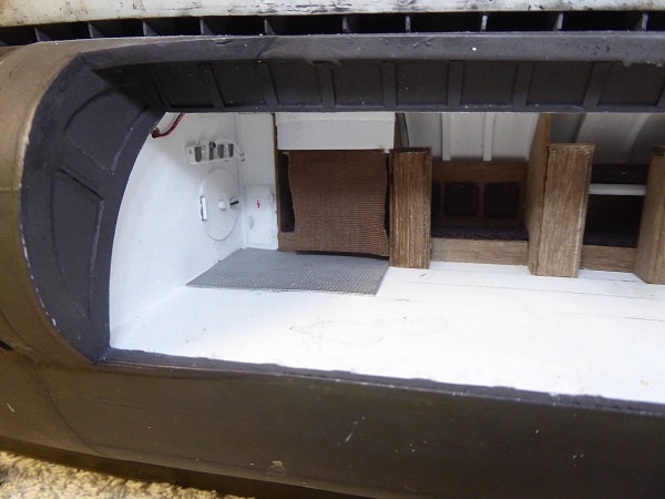

The attached photo shows a curtain made from thin cotton jersey fitted onto a rail behind the shroud, giving the CO's cabin a bit of privacy. I also fitted a section of treadplate.
#792 Posted : 30 September 2021 20:29:33

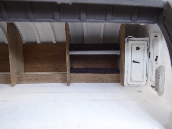

#793 Posted : 30 September 2021 20:33:54

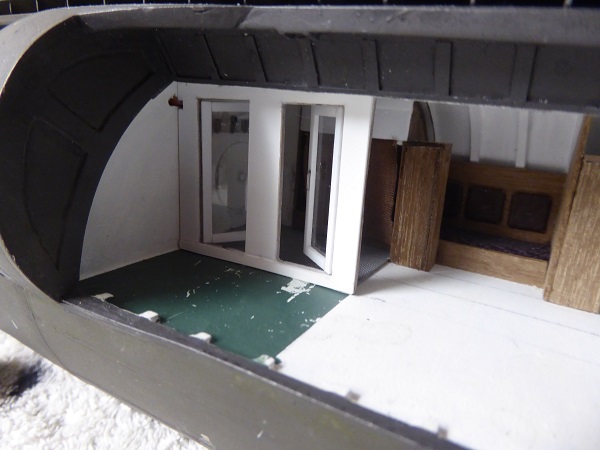

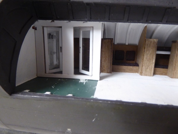

The next step was to make the dividing bulkhead and access doors to the W/T shack and Sonar shack. I also painted the floor of these two areas in matt green. I glued the doors in the ajar position. The reverse side of this dividing bulkhead has a walnut veneer backing to reduce light bleed.
#794 Posted : 30 September 2021 20:34:23

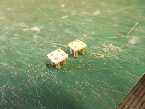

First of all i just want to say how proud i am for having my 1/48 scale U-boat highlighted as a 'notable build'. Brilliant!Love This just spurs me on to keep posting regular content on this build and any future builds.

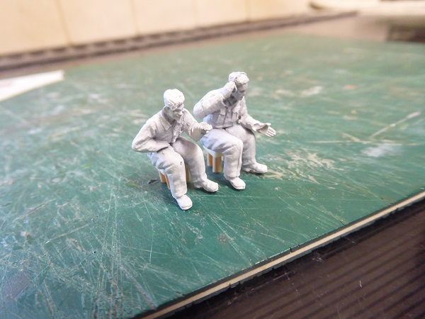

So, after a nice relaxing week off it was time to crack on with this model. First job was to make a couple of stools for the two watchkeepers to sit on. I bought, quite a while ago, a pair of O gauge stools, but i didn't like the legs supplied. So i added my own made from toothpicks! I could also adjust the height to suit the watchkeepers too.LOL The stools aren't finished at this stage and will be covered in leatherette when done.
#800 Posted : 14 October 2021 20:54:17
The attached photo shows the two watchkeepers sat on their respective stools. The figures themselves took about an hour each to assemble, what with their separate arms and legs and checking all aligned.
