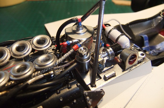

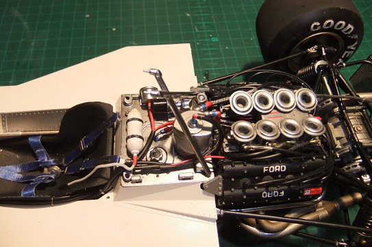

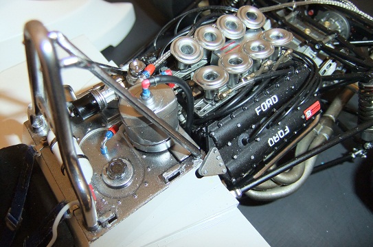

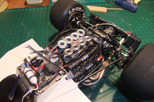

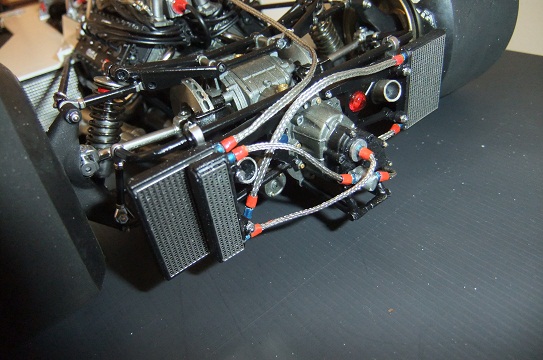

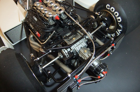

I've now got most of the hoses around the engine. The gearbox oil cooler piping is my best guess as I'm putting on the slanting rear wing and the arrangement is different from the kit instructions.

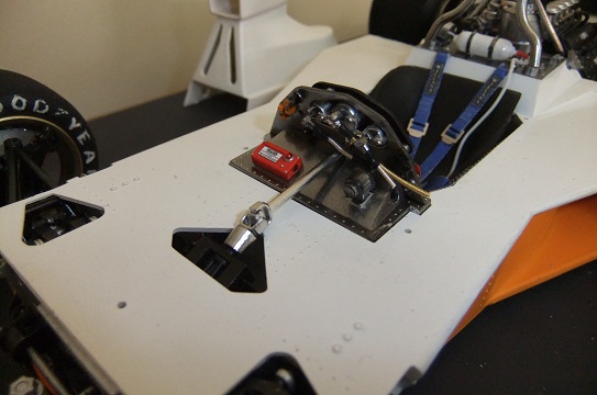

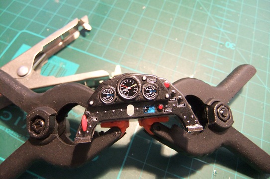

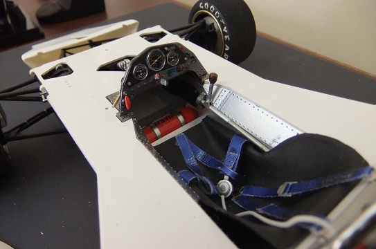

Attention now turns to the instrument clusterBigGrin . I'm still working out a wiring arrangement but have started with the rev's cable and pressure hoses.

As far as the oil cooler plumbing goes, I think you've got it about right? Who's to say it's wrong anyway as they very often changed things from race to race back in the '70s and you would likely find two M23s in the same team even that weren't identical, so I wouldn't waste too much time worrying about it as long as it looks believable and you don't invite a rivet counter around to your house to have a look at it, you should be fine!! Cool BigGrin
I believe those aftermarket braided hoses that you've used are hollow and tubular aren't they? If so, it might be worth inserting some electrical cable (white would be best so it doesn't show through the braid easily) through it or you could use some heavy duty clear fishing line of the right diameter? You could even paint the cable or fishing line silver before inserting and then you would find it extremely hard to notice through the braid at all? Using the braid as a sleeve over the cable would stop the braid from flattening out or kinking at a bend and make it look more round in profile and therefore more realistic? Hope that helps?
Hi Kev,
Great idea, why didn't I think of that Confused The braiding is hollow and the thin fishing line idea or fine metal wire will support the tube and stop it kinking. Will give it a go.BigGrin

Not sure if you misunderstood what I meant but you don't want the fishing line to be too thin or the wire to be too fine, whichever you use, the idea is not just to have an internal support for the braided sleeve, but more akin to the braiding being a kind of slightly loose fitting 'sock' over whatever internal material you use? It needs to be fairly close to the internal diameter of the braided sleeving though not a tight fit obviously and it also needs to be flexible enough to bend to any shape, obviously?
It helps if you can round the ends of the internal wire or fishing line so that you can thread it through and it doesn't catch on the inside of the braid? It also helps if you leave a little protruding at each end (2-3mm) so that you can then drill a similar diameter hole in the fittings or whatever you want to join the hoses to, and thus get a stronger joint between the two than if you just glued them together as a 'butting' joint - a bit like a locating pin and hole that you get in plastic kits when you join two halves together?
Thick soldering wire is another useful material for the task if you can find the bigger commercially used diameters, like the sort that plumbers use on the bigger jobs or just twist together several strands of a smaller diameter to fill the braided sleeve's diameter? Or you could even use string? There are loads of materials you could use as long as it gives a round profile to the hose and not flat or kinked?
Hope that helps?

#74 Posted : 20 January 2015 22:37:58
BigGrin Wire for fishing traces has a clear plastic coating or the wire used to make jewelry with the black plastic coating ,bought on a spool so you cut off what you need is another source of this type of materialCool

Hi Kev,
Thanks for the extra advice. You're quite right that the inner wire support must be a neat fit in the braid.That way it will give a nice cylindrical form to the hose. The trick is to find that perfect size of wire or line.
