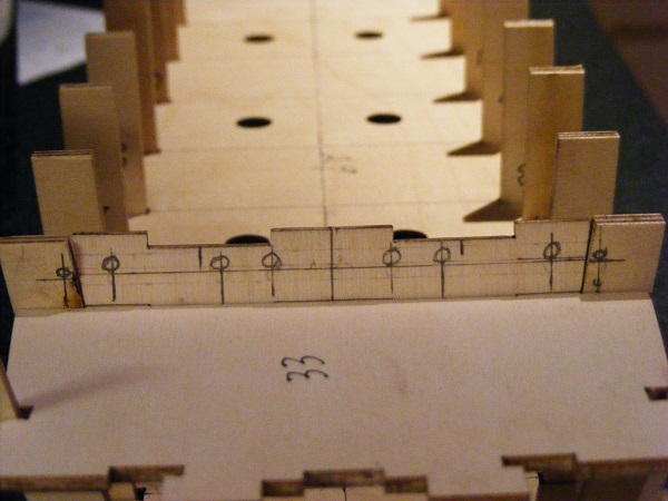

Starting now to get into the build proper and throughout this build I will be using various reference material in my research, these include a number of well known websites, other modellers builds and of course A Modelmaker's Manual by Peter Davies-Garner. Instruction now tell me to start working on the forward Well deck but decided first thing to do was to carry out the research on this area.. Immediate thing that popped out had to do with the stern wall on this deck... The kit does not have any windows/portholes on this wall but rather shows two doors port and starboard... No where can I find in any of the material I looked at the existence of any doors on this wall so first modification got under way...
Peter's book shows a lot of detail on this wall but his diagrams are at a scale of 1/384, so some obvious conversion calculations had to be done in order to ensure the windows were in the right place and of course the right size and dimensions, these will need to be drilled out especially as I'm lighting this kit... There is also two light fitting to be fitted too.... The holes need to be drilled at 2.4mm dia and the outer holes which incidentally have to be drilled through the rib are 1.9mm... Tonight was simply calculations and marking out which did take some time....

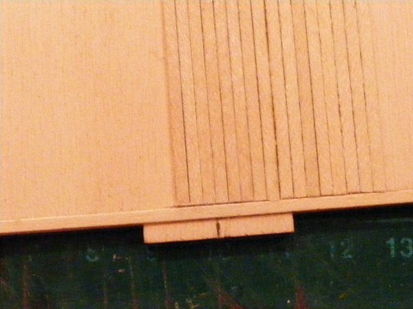

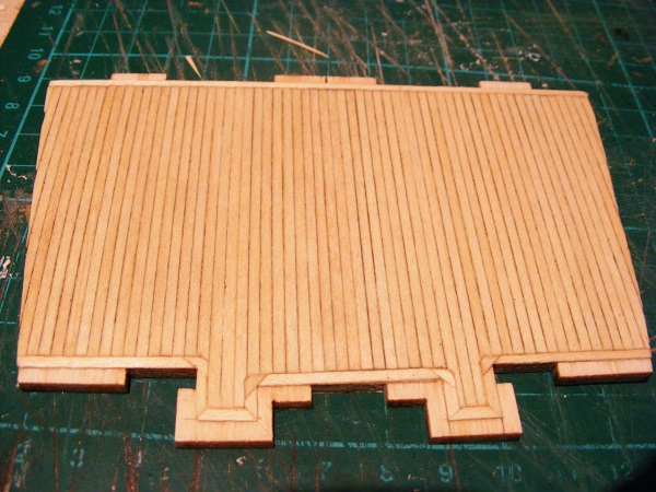

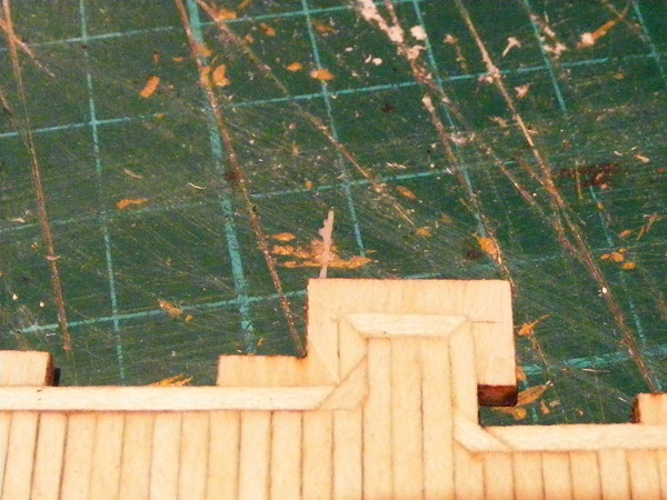

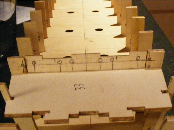

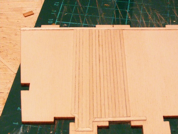

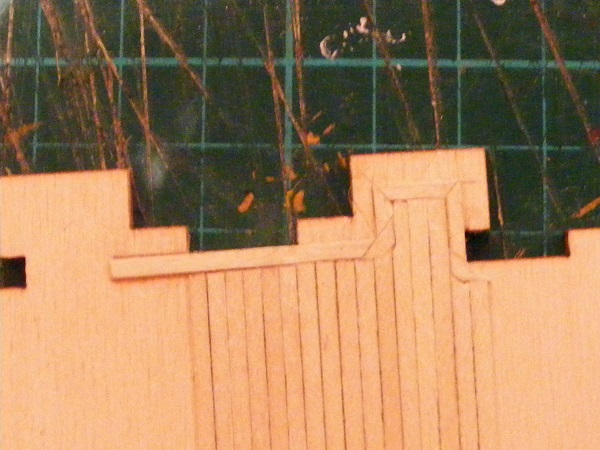

Have once again changed the build sequence a little... Instructions say to fit the forward well deck bulkheads and then plank the deck.... Decided to start planking the deck first before fitting the bulkheads, this gives me easier access... Planks are very thin at only 2mm wide and also decided to run a pencil lightly along one edge of the planking strip to give the planks a little more definition...Cool Cool More research revealed the deck planking was also edged along the bulkheads so thought I would try to recreate this on my build.... fiddly but think the results will be worth it... Hopefully get some more done tomorrow.....Cool Cool

Posts: 1,344

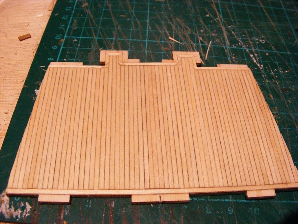

Deck planking now complete on the forward well deck... When all the planks were laid and the deck surrounds done I gave the whole piece a rub down with very fine wet and dry.(dry of course).... Have now given it it's first coat of natural Danish Oil and am very pleased with the results.... going to give it another coat tomorrow just to darken it a little more...... then onto the front and rear bulkheads.....Cool Cool ..
