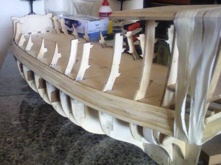

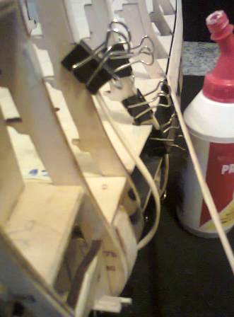

Packing the ribs and glued
After steaming the bamboo and bending it, I fitted it dry in place and left for a day to rest. It took the rib's profile very well.
I used 4 (2x4mm) bamboo and carefully sanded it down to a 1.5 mm thickness with fine grain sanding paper... a process that went rather quick.Cool
Blink I gauge the thickness with an electronic caliper.
This strips is now to be glued onto rib #26 and #27 and left for a day to dry completely. When ready, the new strips are to be futher carefully sanded down to take the profile of the hull and then shamfered for the planking to sits close and tight.
The picture shows a strip glued and the other strip posed dry fitted to show the steamed method.

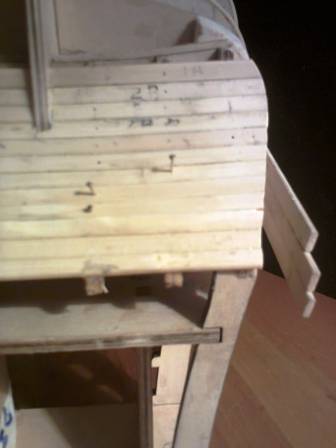

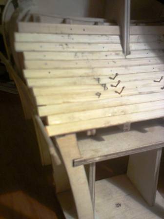

I have done the planking of the underside gallery. I use the side planks to gauge the contour of rib #27.
To plank the underside Gallerry, I used 4x5mm planks (5mm bamboo cut to 4 mm) to get a closer fit into the bottom round profile of brackets #30. The 5mm planks do not sit well into the roundness of the bootom brackets.
By doing this, I do not have to cut fillers.I end up using 13 planks which of some measure 5.5mm; 5mm and 4mm. I mentioned that I do have a mixed supply of 5mm and 5.5mm bamboo. It came in handy for those awkward spaces.
Angry Mad Crying My 0.3mm bit broke leaving me bored again. I tried to nail the plank without drilling, but its everybody's bussines
that the bamboo did splitAngry (F@#%K). Off I go to do some...

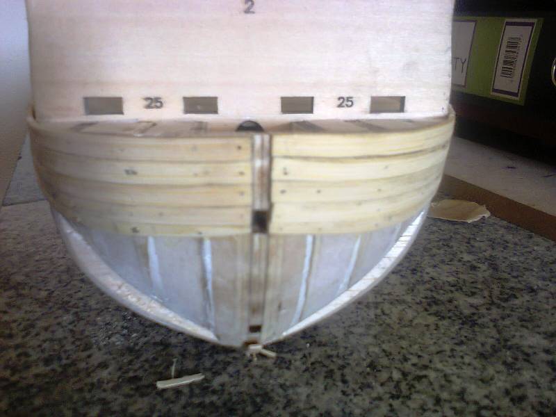

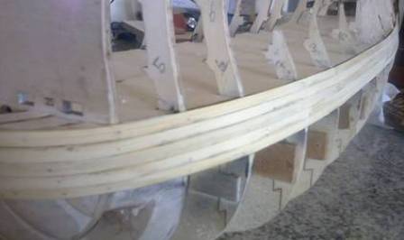

With some tweaking, I manage to get a few planks done. The backfilling does not make it easy to plank, as I have to watch every plank careful that it sits well with the new profile. Although its time consuming, its worthwhile doing it as prescribed by my teachers.BigGrin
I have removed the hull from the jig... (Thank goodness)Huh to start on the Garboard planks. This should be an easier task, because I did not put the back filler all the way on the offending ribs.
The minor flawsBlushing in the planking can be rectified with woodfiller and sealer. I came across a cleaner cloth damp with alcohol. Apperantly it removes the residue left by the glue line. I want to give it a try.
I followed the deck plate strict when I laid the first row and graduately relaxing the strain of the wood-grain as I proceed to the next row. I am happy with the natural flow of the planksBlink .
