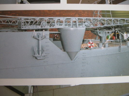

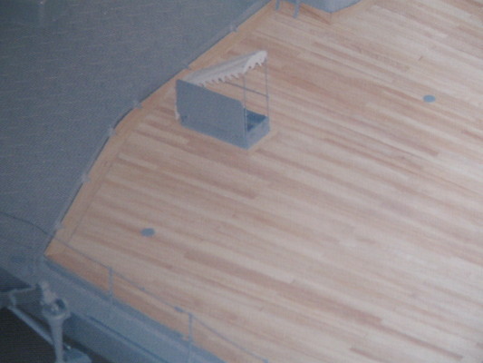

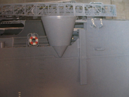

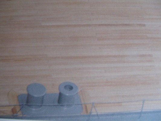

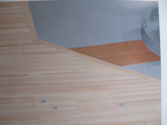

#75 Posted : 22 July 2010 09:41:05
Rank: Amateur level 2
Joined: 21/09/2009
Posts: 46
Points: 130
Location: Here
Some photos of the Kure museum 1/10 Yamato model which might help, also noticed that the edge of the wood deck is lined around its perimeter.

jinks8
#76 Posted : 23 July 2010 01:06:17
Joined: 24/01/2010
Posts: 131
Points: 398
Location: North Yorkshire FILEY By The Sea
Thanks Trawler will look at the photo on Kure museum site a little closer but as you can appreciate their is a vast difference in scale and sum things are just not feasible on 1/250 the deck is one that is. Will modify my deck to incorporate the border should make it better
