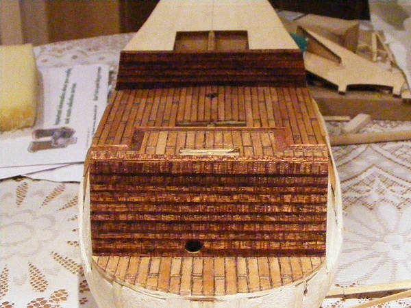

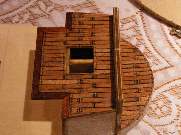

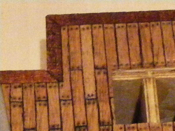

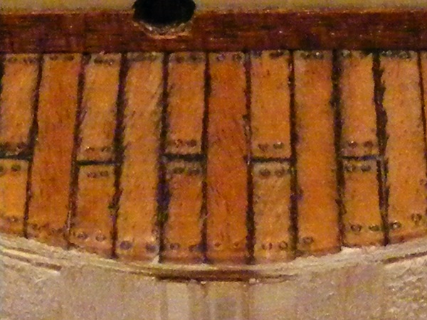

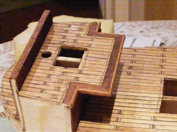

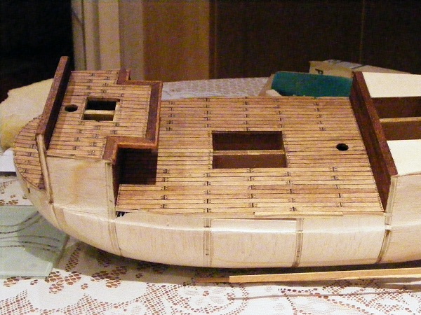

Spent some time today working on the decking on the bow and foredeck, trying to ensure I came up with the look I was after. Think I came up with something I am very happy with... pics make the deck look a little darker than it actually is.... BigGrin BigGrin. Using Danish Oil on the decking strips was explained in previous posts....
Treenailing was achieved by drilling a .5mm hole then marking the hole with the point of a pencil. I also wanted the Mahogony edging to be a little darker so gave one side a coat of Burmeze Teak before fitting. Finally, gave the decks a final coat of Danish oil. Once dry I intend to seal it all with a coat of clear matt varnish.... BigGrin BigGrin ..
Thanks to all for looking in...... BigGrin BigGrin

Nice Tree-nailing, looks really smartThumpUp

Thanks Andy, lengthy process but think it was worthwhile....

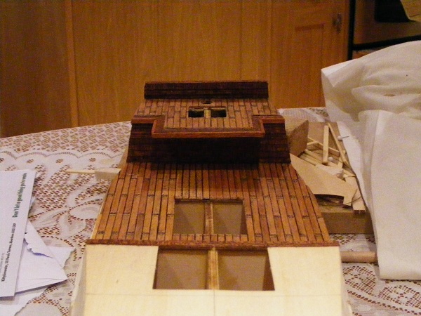

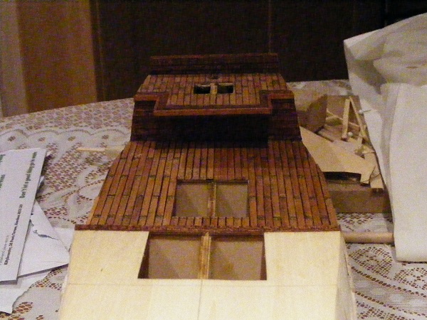

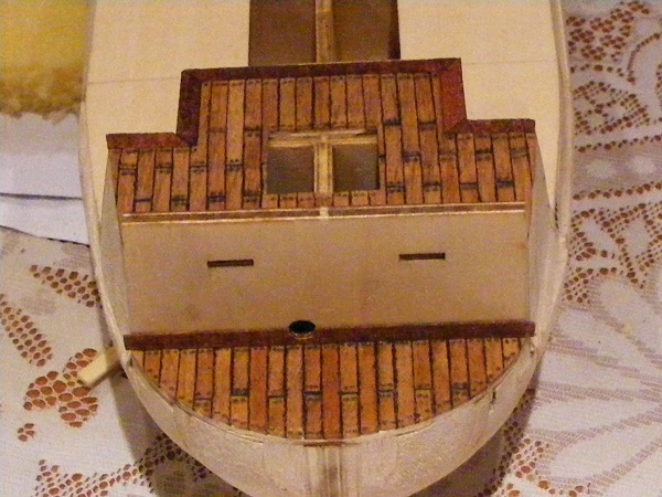

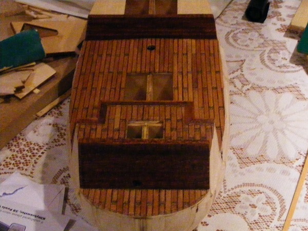

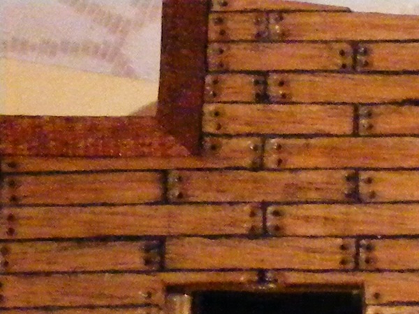

A little update on progress... Have now completed the Waiste deck decking and lined some of the forward bulkheads... Some of the pics do show the deck being darker than it actually is Glare Glare , the 2nd and 3rd pictures give a truer reflection of the colour...BigGrin BigGrin Only have to give a little tidy up to the deck edges and round the openings for the gratings... Tomorrow it will be back to finishing the first layer of planking on the SOTS....Cool Cool Thanks to all for looking in.... BigGrin

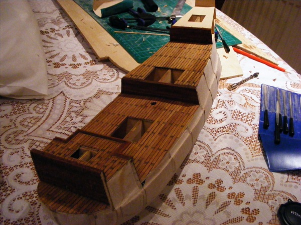

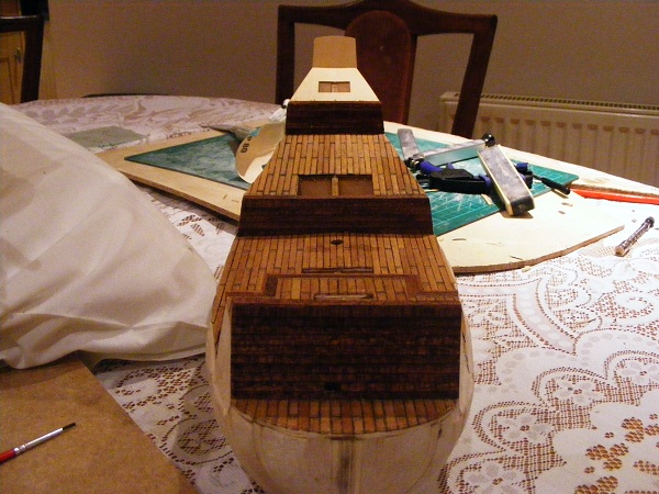

A little more progress today, managed to complete another deck and lined a bulkhead.... with a little luck should finish the decking tomorrow... Slow progress but I really like how its looking... Cool Cool

Very nice planking, well done! I think it will be better to cover the deck when you have to go on with the hull planking/sanding.

Looks stunning certainly rewarding the time and effort spent Cool
#80 Posted : 28 April 2013 09:53:33
Love Love the planking Alan stunning jobBigGrin Rgd Martyn
