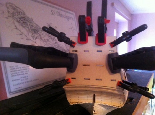

To make sure the rear panel of the gallery was flush to the top of the frame, I clamped a piece of balsa on top and fitted the rear panel to butt up against it.
Pic 1:
Then it was a case of making sure the back panel was straight and clamping it in place, belt and braces here to make sure it didn`t move.
Pic 2:

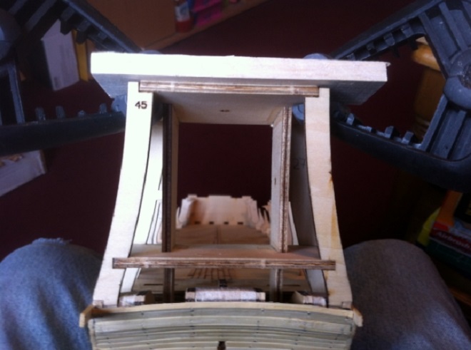

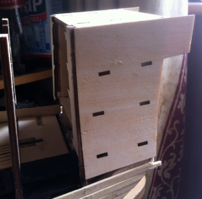

The side panels were next (these pics also show dummy gun supports),clamping these also included some wedges under the clamp faces due to the curvature of the framework.
Pic 3+4:
Next a pic of the length of the dummy gun supports.
Pic 5:

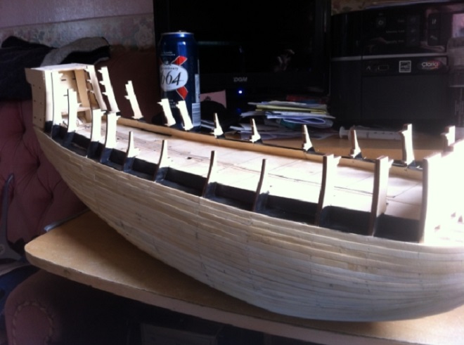

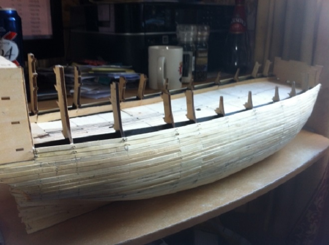

Having had a short break from planking, yep, back to planking. The good bit was, no serious bends and/or twists required. Cool Cool.
So three layers of planks followed and here is the results to date.
Pic 6+7:
