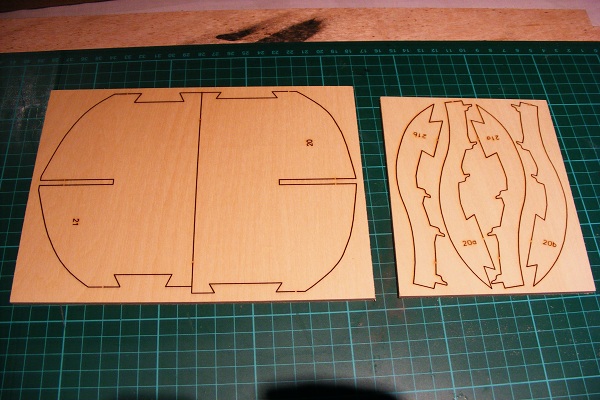

Issue 6 arrived and inspected the parts closely for any signs of damage or warpage. Here is the items received and looks as if there isn't much to be done this week...
#62 Posted : 13 October 2012 21:44:31

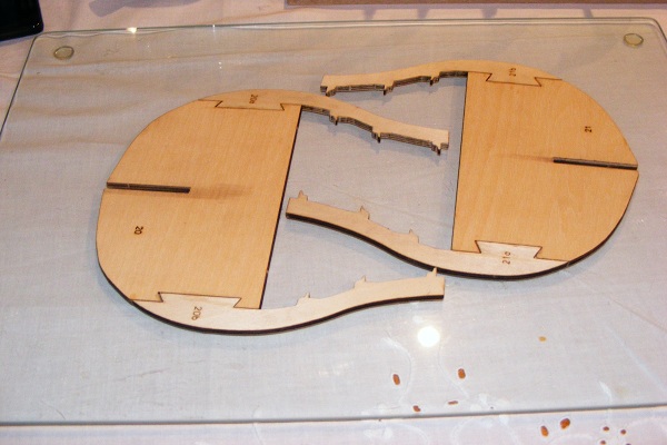

Carefully cut out all the parts and sanded all the dark ash from the joining edges. Using PVA, assembled ribs 20 and 21, set them in my glass press to ensure they dried flat...

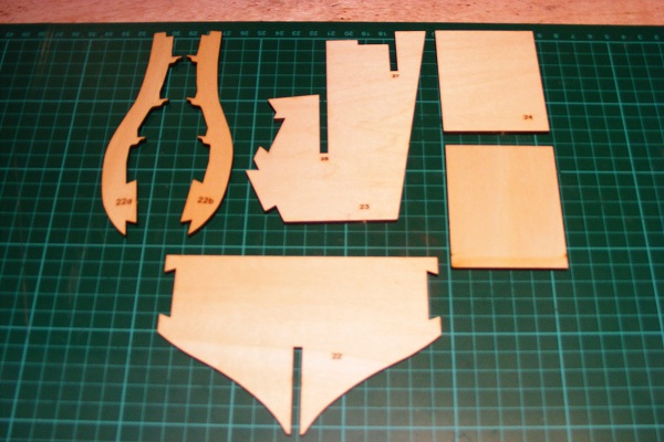

#64 Posted : 19 October 2012 00:32:38

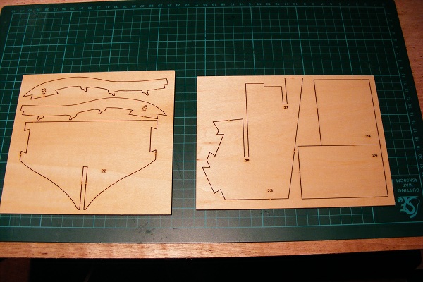

Picked up issue 7 from the newagents today and after reading the magazine decided to get down to some work.... These are the parts contained, checked all the parts for possible damage or warpage, to my relief all is ok..
#65 Posted : 19 October 2012 00:35:54
Set about carefully separating the parts from the fret and using emery board carefully removed all the black ash from the joining surfaces.
#66 Posted : 19 October 2012 00:38:33
Using PVA glued parts 22a and 22b to rib 22, cleaned off any excess glue and placed the completed piece into my glass press to ensure it set flat. Will continue with the final keel section tomorrow....

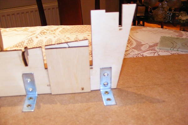

Decided now it was time to set to work proper on the keel and ribs, gluing everything in place... maybe I am being a little over cautious but having read through various builds it is an area I wanted to make sure I got absolutely spot on... get this part right and I think I may have a fighting chance of producing a nice build. Final keel section cleaned and glued in place, ensuring the brace pieces were firmly fitted and clamped in place. Left to dry before going any further.

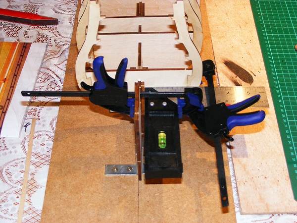

#68 Posted : 19 October 2012 21:38:24

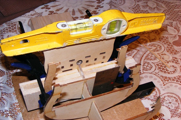

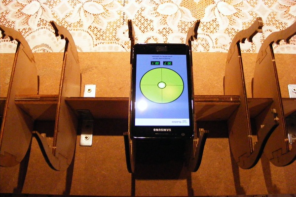

Now set about fitting the ribs, suffice to say the same procedure was carried out for each... Glued in place and using a set square ensured each rib was set to 90 degrees both to the keel and to the base board. Left each rib to set before moving onto the next...
#69 Posted : 19 October 2012 21:42:05

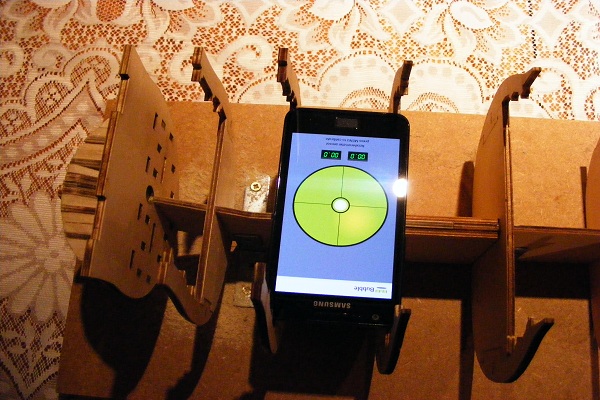

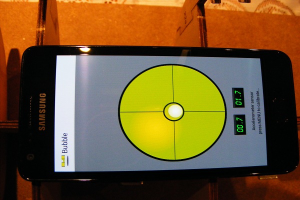

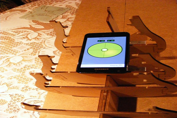

When all the ribs were set in place, I checked to ensure everything was level and that there was no twisting of the keel, did this using a leveling app on my smartphone, checking in several different places.. Noticed towards the stern of the ship the deck level starts to rise slighly.... Feeling confident everything is straight and true ready for the next issue....

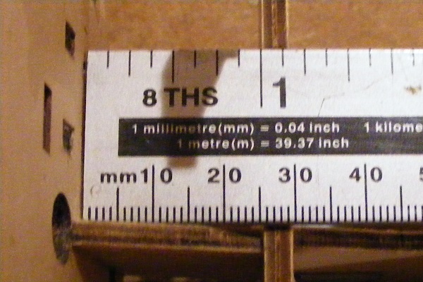

#71 Posted : 23 October 2012 21:20:56

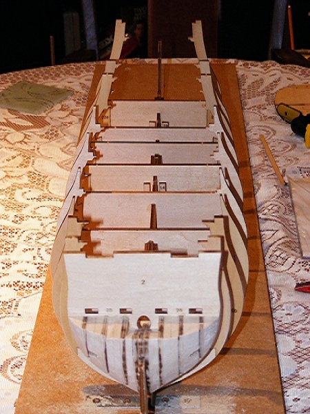

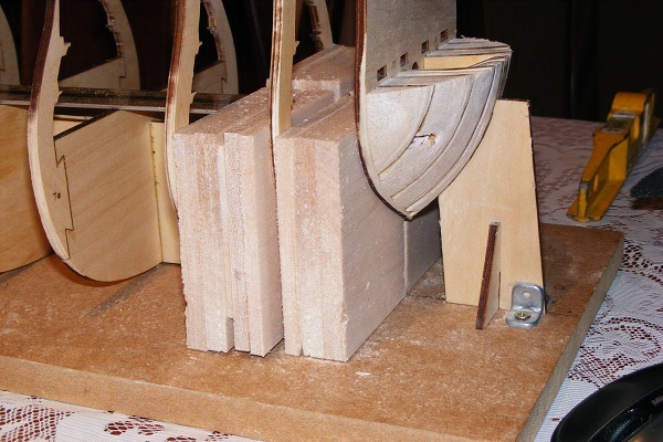

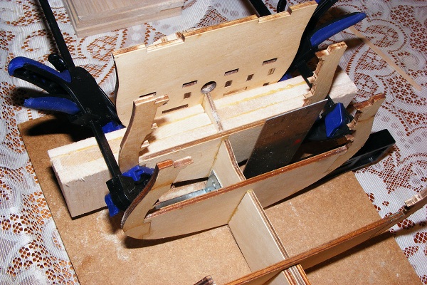

Having taken inspiration from MWG's build and excellent tutorial on using Balsa to fill between the ribs, I decided to make a start on my own build. First measuring the gap between the first two sets of ribs.

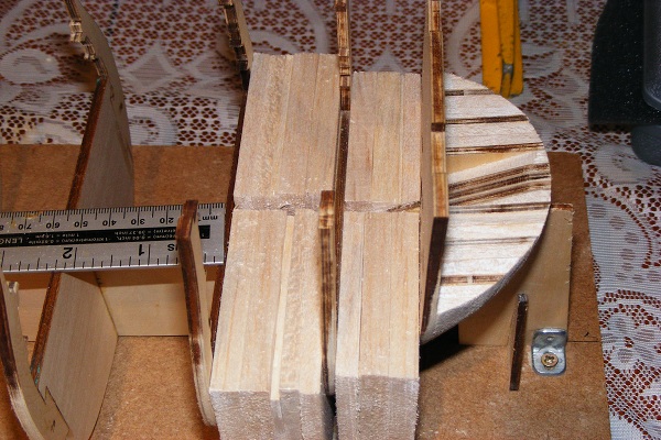

#72 Posted : 23 October 2012 21:24:29

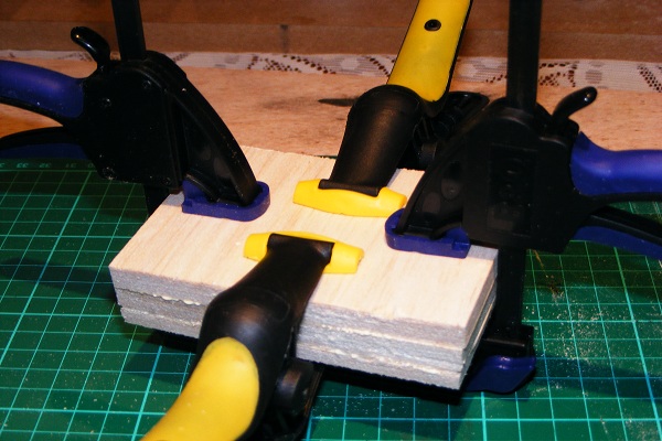

Glued together Balsa of various thicknesses to the width of the gaps, I made up oversize blocks to fill the spaces making sure the dry fit was snug and ensuring the fit was not forced.
#73 Posted : 23 October 2012 21:31:01
Trimmed the blocks down ensuring the fit was below the level of the bottom deck before setting the first blocks in place....
#74 Posted : 23 October 2012 21:36:05
Finally clamped in place and checked everything was still square and level... leaving to set before moving onto the next set of ribs...

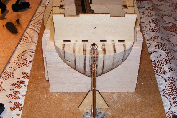

Thanks Andy. I intend to block fill the first two sets of ribs on the bow and at the stern.. the rest I will box fill... As it is my first attempt at this then anything that helps to make planking easier I will take as a bonus even though I fully intend to double plank with walnut on the lower hull and either maple or cherry for the upper.. not quite decided yet.....
