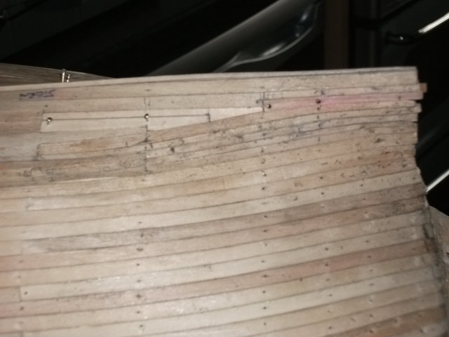

looks like some stealers/droppers are needed. there is some info in the mags.
no doubt you have full width planks in the centre and you have tapered right down at bow and stern ends.
instead of making lengths that go all the way to the stern you will need to stop at a rib two or three before the stern.
once it all lines up again you can the taper some planks to fit from whichever rib you have chosen to the stern.
i doubt if any of that really makes any sense, the magazines do tell you how to make droppers and stealers, so maybe read them again.

Hi, I do understand what you are saying,it is just that there is a curve at the stern and I am finding it hard to get the curve out, if i measure it it will just follow the curve.Should have seen this earlier doh!!!Blushing
Thanks for your input,very helpful.BigGrin

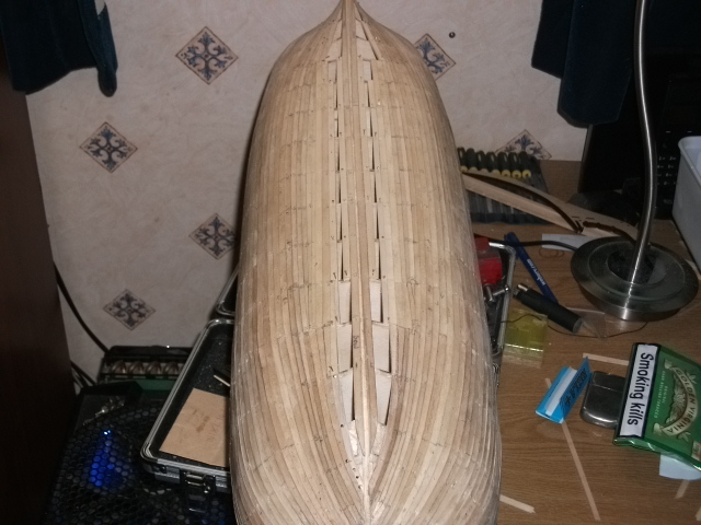

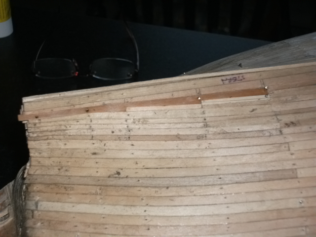

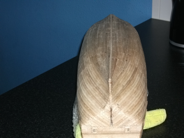

!!FINALLY!!Flapper Flapper Flapper
Just finished planking the hull, I must admit it was very thought provoking concerning ways to fit the planks at the last stages. Here are some photos of the last stages, it was not exactly straight but managed to get round it by little pieces at a time in some cases.
Now for the sandingCool Cool.

sandnesspeats I'm amazed that you got that far without tapering the stern planks,and very ingenious way of finishing it.well done and give yourself a pat on the back.Cool

Thanks Karl, I think it was all the confidence you all gave me to carry on.BigGrin BigGrin
