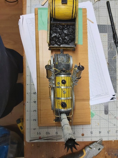

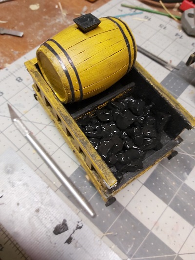

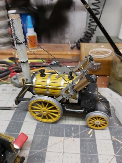

Couldn't keep away from the Rocket. Nearly finished the engine and tender, got a couple of wheels to trim, bit of rust to be added here and there. I'll finish off the stack today and place the last pipe coming out of the rh cylinder.
The build was fairly straight forward, nohing to vague. The lugs on the suspension didn't match the slots in the chassis, easily fixed with my trusty file.
The 5mm dia. 'thing' on top of the fire box, I actually drilled a hole in the top of the box and pushed some dowel through for a more secure attachment. This enabled me to use one piece of wire that went straight through a1mm hole I also drilled into the 'thing'. Made that asm easier and I matched the angle both sides on the model.
Only one additional spoke on the wheels snapped when I was shaving off the width on the remaining wheels, just needed more care and sharper chisel to fix that. Attached a couple of pics, hope you like em.
Len

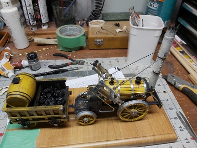

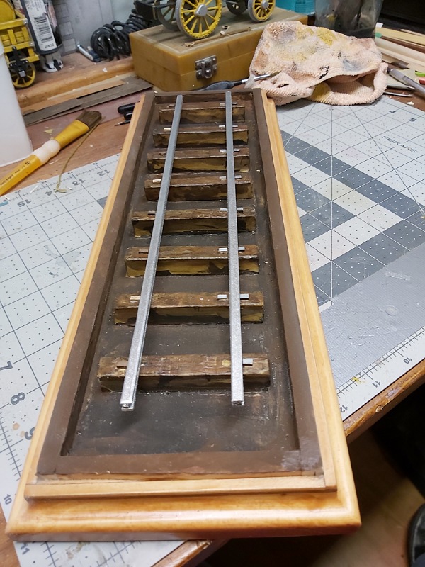

4 weeks to the day, showing a couple of pics of latest status. All but done the model, a little bit of detailing and a couple of parts to paint. I plan to continue with the log as I'm going to make a case, tracks and a background for it. Not sure if that will be worthy of following, but I don't want this build to finish.
Thx for following along, I look forward to checking out some similar builds as this is the type of kit I like. A big plus to this kit is it is fairly compact, so displaying it on top of the TV or on a shelf is not space prohibitive.
Here's this weeks pics.
Blighty attached the following image(s):

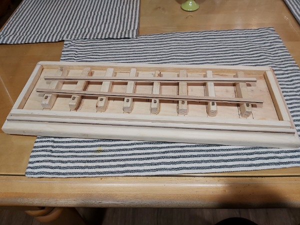

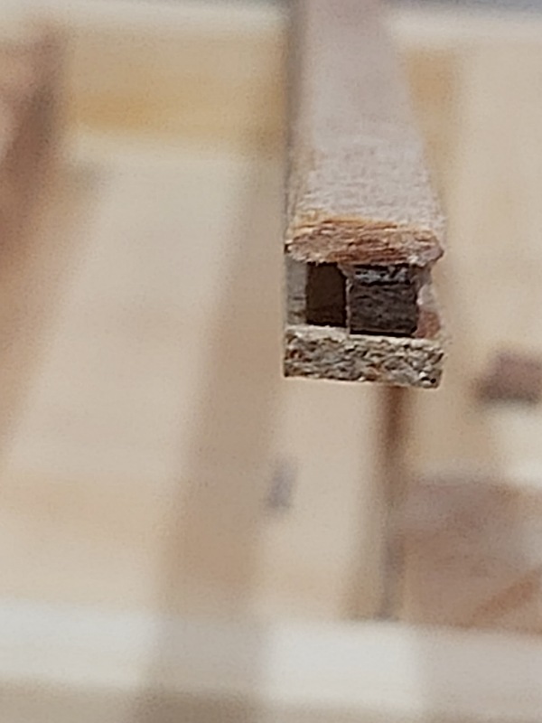

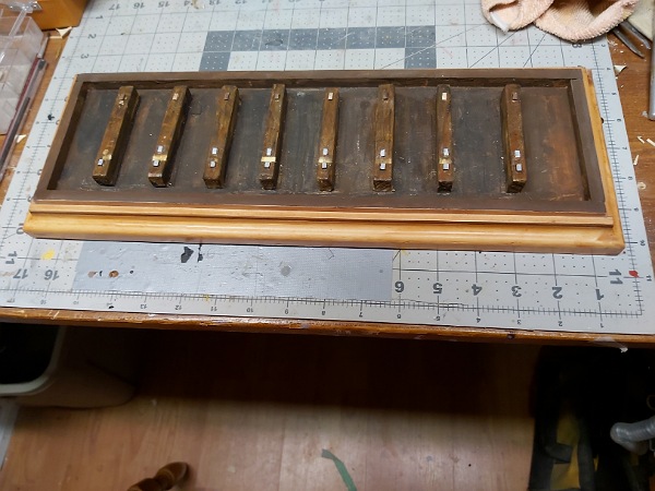

Hi,
I've been working on a display case for the Rocket, it's coming along ok. I'm building it on the fly but it's pretty basic so referencing any non existent drgs shouldn't pose a problem. I plan to purchase an acrylic sheet to put round it, that will come later............... The tracks are made from scraps and left overs from other models, I glued up 3 pieces for each track to form an offset I-beam. The actual base which I cut from some scrap planks I had in the garage.
I don't know if anyone can help me? I have been trying to find the correct scale figures, a fire stoker or driver would be ideal. Any idea where I can order one/some?
Thx for following along.
Blighty

#74 Posted : 27 April 2022 23:20:51
Rank: Semipro Level 1
Joined: 13/03/2022
Posts: 71
Points: 222
Location: Canada
Case pics,cforgot to attach.

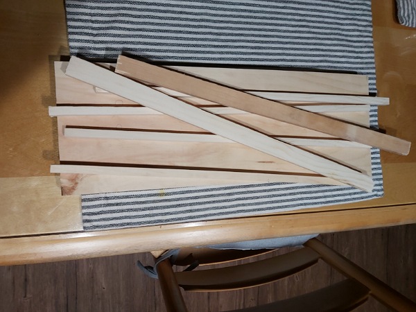

#79 Posted : 30 April 2022 15:32:12
Joined: 13/03/2022
Posts: 71
Points: 222
Location: Canada

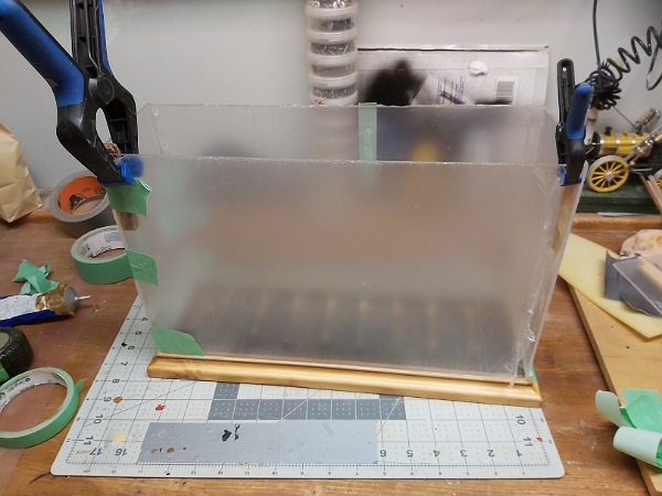

Thx for replies to finding railway figures. Found a couple of good individule figures that are time period accurate(ish), but shipping to Canada adds another $30+ so still looking for something a little less costly.
Here's latest pics of the display case, I just bought some perspex sheet but have not started cutting it up yet.

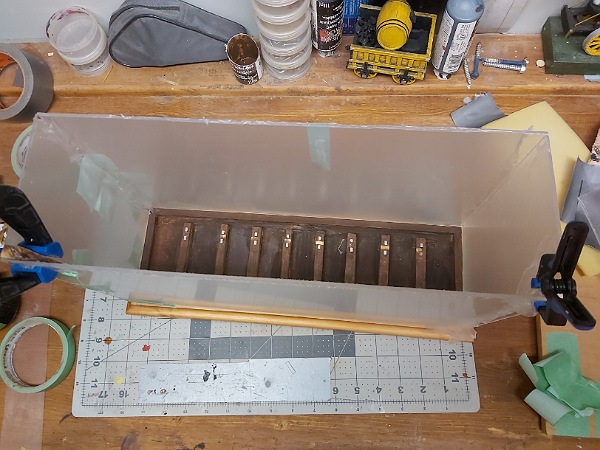

#80 Posted : 01 May 2022 18:29:27
Joined: 13/03/2022
Posts: 71
Points: 222
Location: Canada
Started cutting it up!
