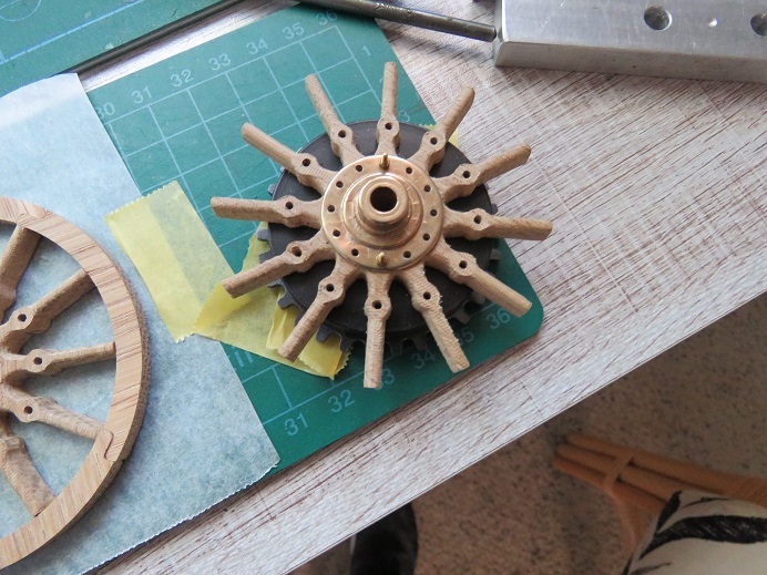

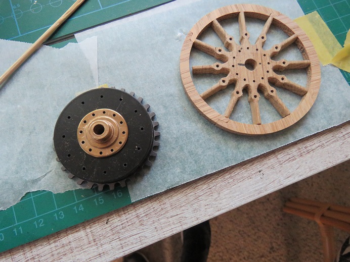

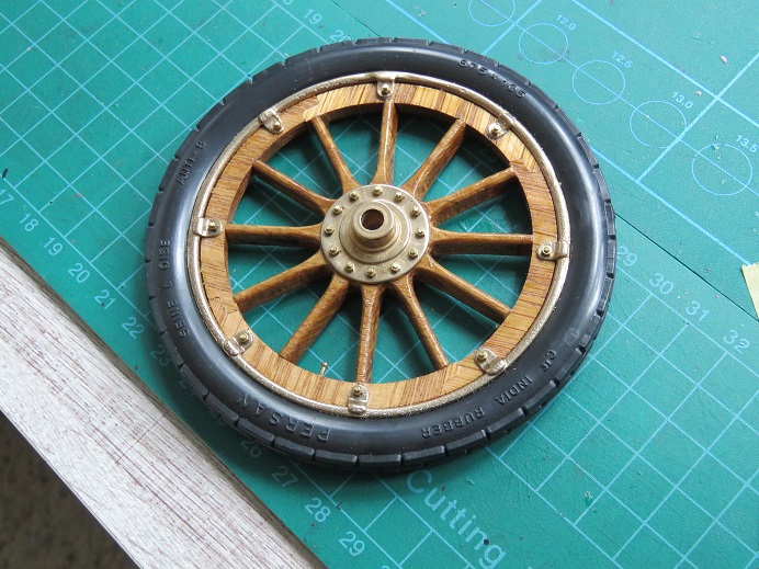

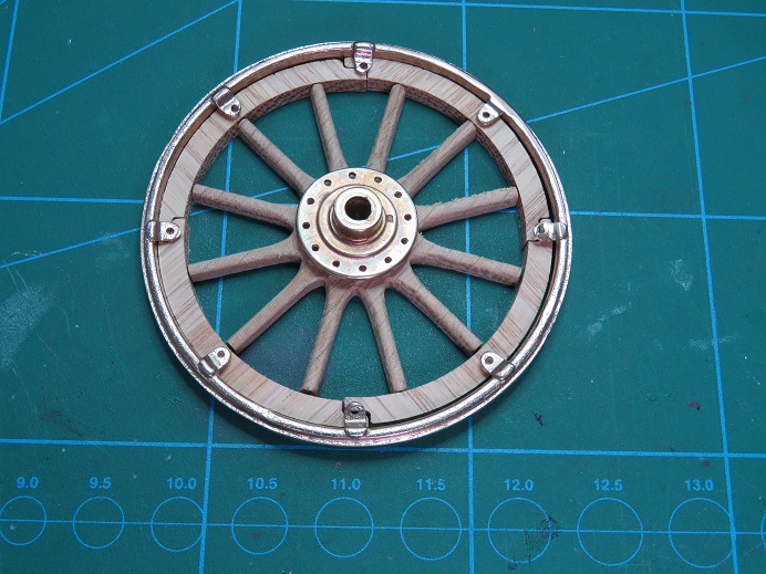

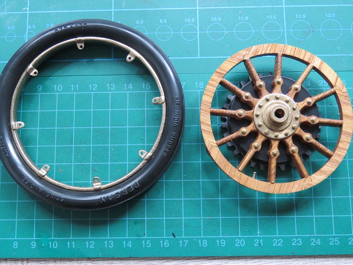

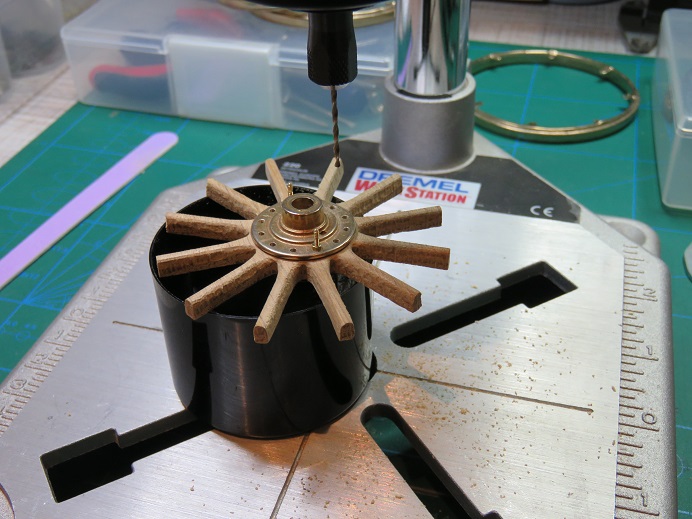

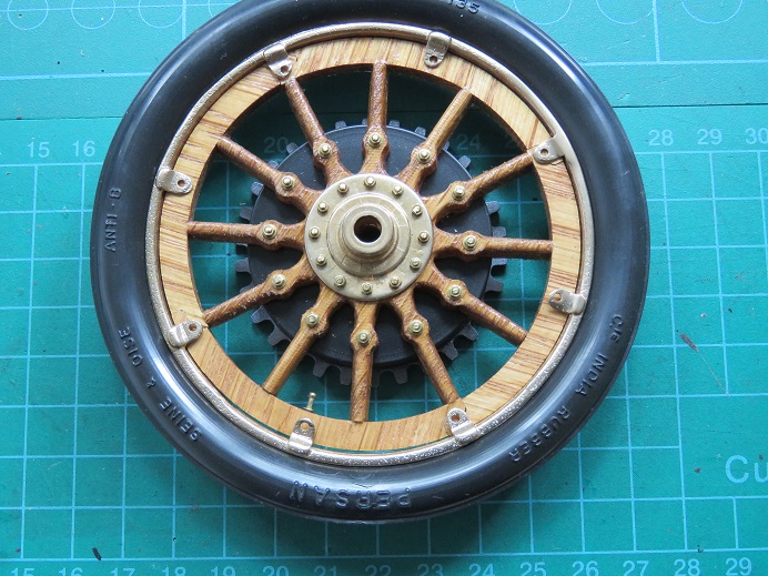

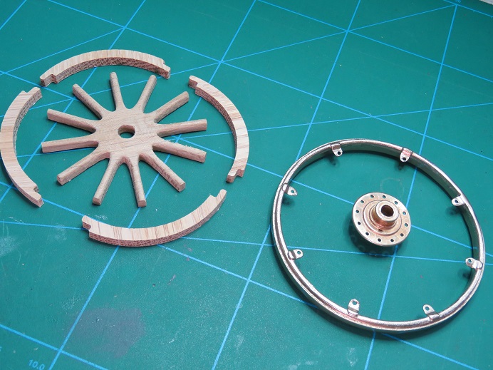

The wooden wheels are an after-market kit and comprise a central machined Hub/Spoke, four rim pieces, Brass hub plates and a Brass rim. There’s also white rubber tyres available but I felt that would look a bit odd. In reality black tyres only arrived around 1917 when Carbon was added to improve the stability of the compound.
The parts get glued together and then drilled and bolted.
#64 Posted : 14 February 2023 11:13:54
The completed wooden parts were varnished before assembly.
#65 Posted : 14 February 2023 11:15:45
Now it can stand on it’s own Legs. BigGrin

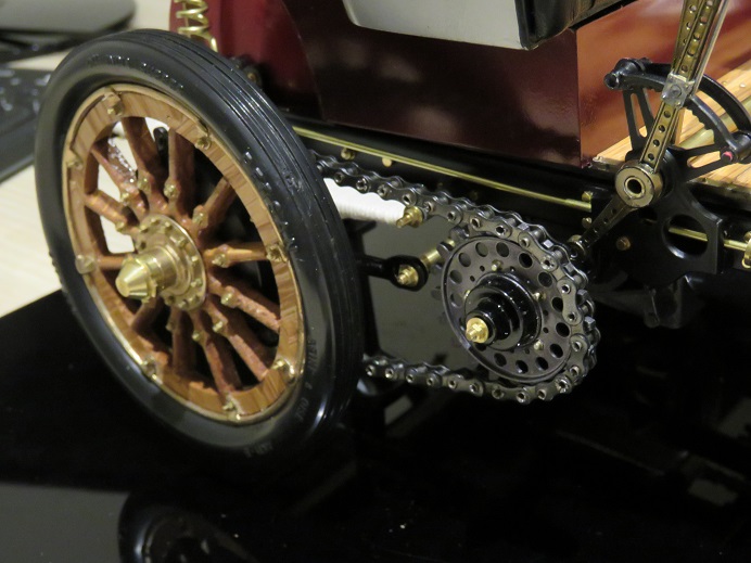

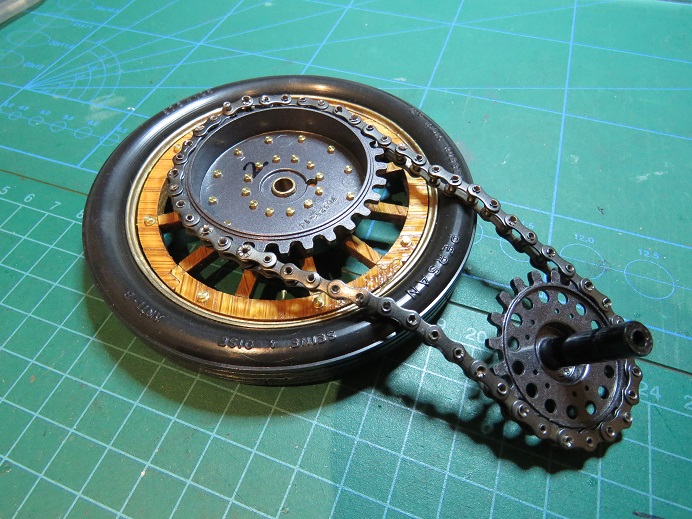

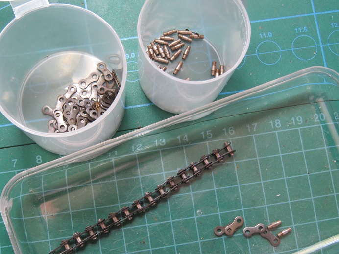

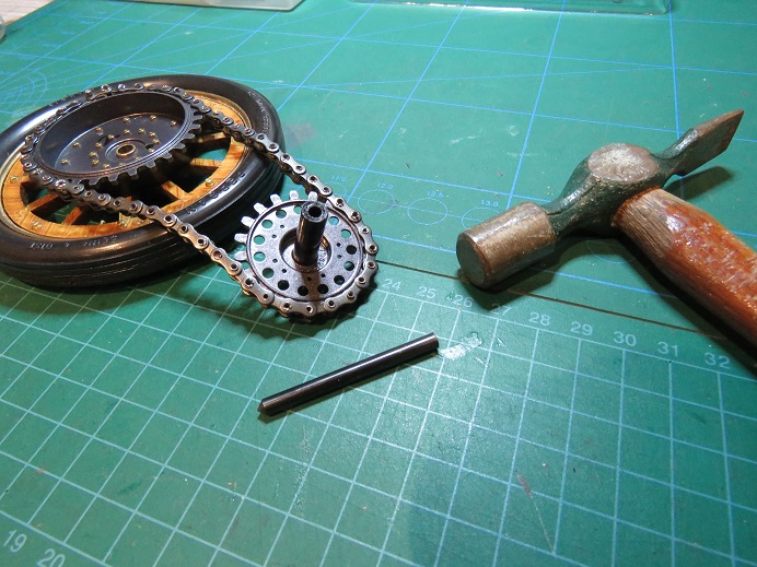

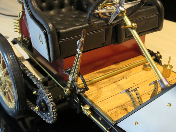

The drive chains comprise a few hundred of these “number 8” shaped steel blanks and turned rivets. The instructions illustrate a plate with holes that has to be used to hold the parts whilst the rivets are formed with the supplied tool ( A metal rod with a pointed end ) and my own hammer. The jig was however missing from the kit so I had to improvise an Aluminium plate with a couple of holes drilled in it. A bit of a fiddley challenge especially since the rivets were of variable quality but got there in the end. There were enough plates, but a couple of the rivets proved to be unusable. I closed the chain with 1.6mm x 8 nut and bolt. ( won’t be seen on the finished product ).BigGrin
Nearly finished this one now……
#72 Posted : 18 March 2023 21:03:49
Top job on that drive chain Malc, must have been mind numbingly boring by the time that you'd finished it!? A cracking result and a beautiful model too.
Very well done. Drool Drool ThumpUp
Kev

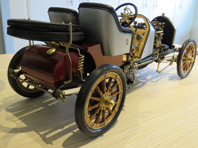

#77 Posted : 25 March 2023 07:02:59
Markwarren wrote:
Absolutely amazing work Malc.Love Love
Thanks Mark. Nearly across the line with this one.BigGrin
#78 Posted : 25 March 2023 12:40:43
Posts: 5,057
Points: 15,317
You must be really chuffed with this one.
It really looks great.Love
#79 Posted : 29 March 2023 06:59:14
Thanks Roy, I'm very pleased how it's turned out.BigGrin

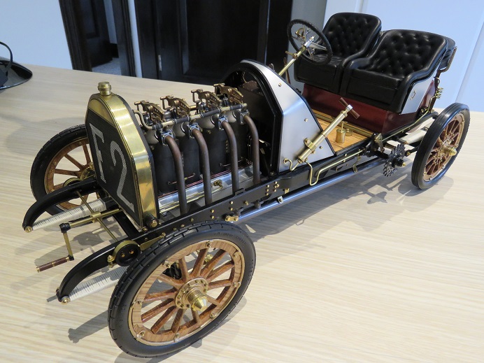

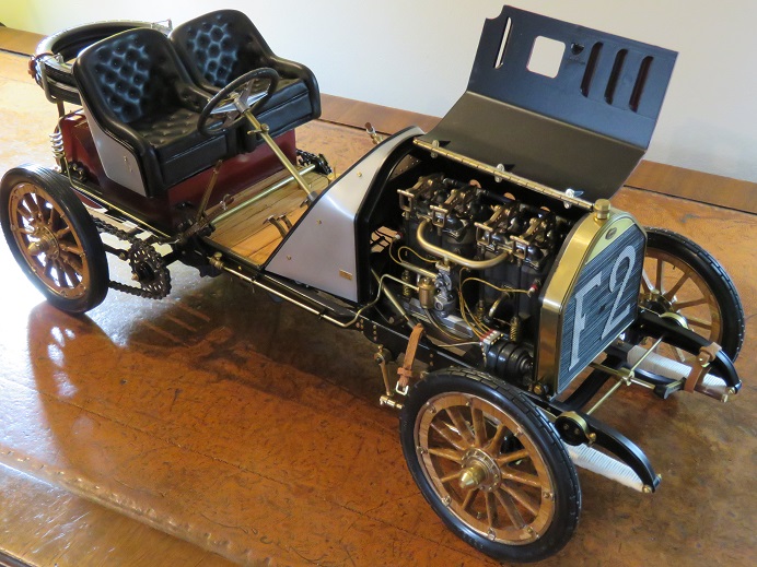

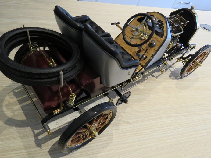

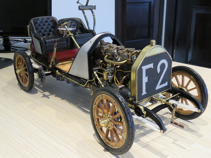

#80 Posted : 04 April 2023 15:31:31
It's finished... !!!
Quite a long build but very happy with the result.BigGrin
More in the finished gallery soon.
