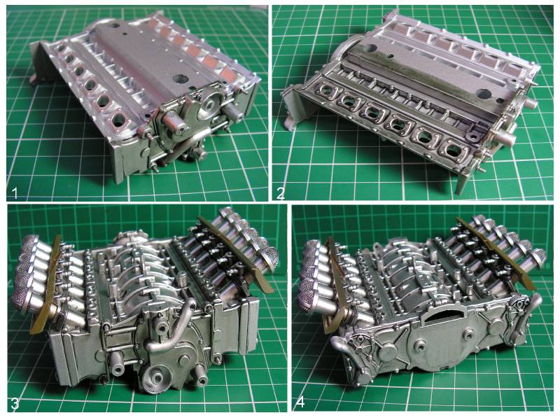

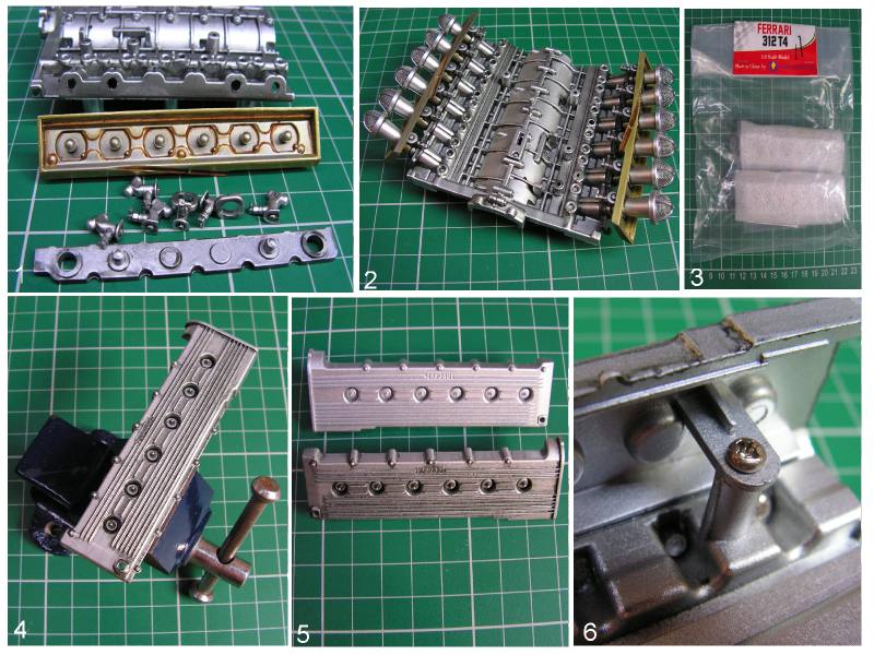

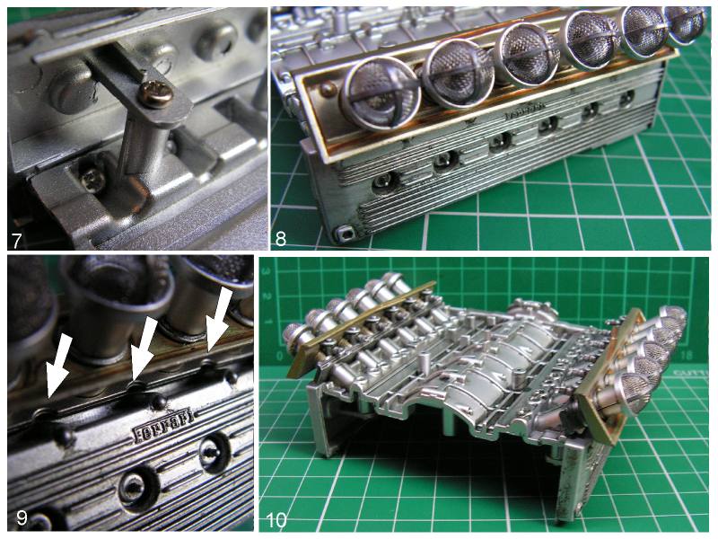

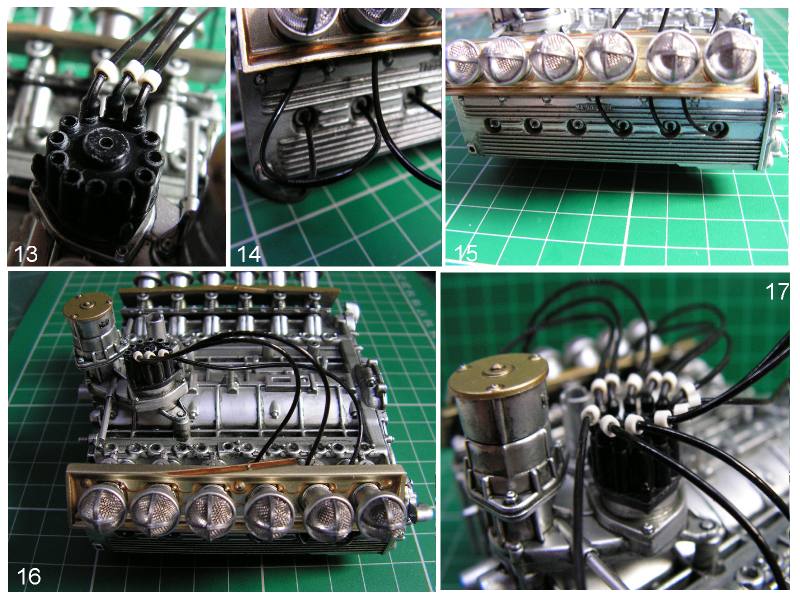

Continuing on from the crankcase top and sides, Photo 1 shows the big and weighty die cast metal crankcase bottom section. In this photo, after the initial soapy bath and dry off, the end facing the camera has just been given the Blue-Grey Enamel wash treatment whilst the rest of the casting is in its pristine chrome effect. Because of the size of this piece I gave it the wash effect in stages, so I would have somewhere dry to pick it up and hold it by, the first half of the main body has been done in Photo 2, any ‘join up’ marks on the top flat part didn’t matter as this will be completely covered by the Oil Sump which goes on next! After all three faces of the crankcase bottom had been enamel washed and allowed sufficient drying time, the bottom was carefully offered up to the rest of the engine block and eased into the slotted sides. (As you might have noticed, the 'bottom' also includes the 'front' and 'back' sides as well!) This was a tight fit as you might imagine (very tight actually)  but with some persuasion it slid down into position as shown in the two opposite ends pics in Photos 3 and 4. Once in place all that was then required was to fix it down permanently by screwing in the two Type J self tapping screws through the bottom (of the bottom) as shown in Photo 5. These screws are also hidden by the Oil Sump assembly, which will be coming in the next installment. Until then, stay safe as always and Happy Modelling to you All! Robin. Plymouth57 attached the following image(s): First wooden ship: The Grimsby 12 Gun 'Frigate' by Constructo Second: Bounty DelPrado Part Works Third: HMS Victory DelPrado Part Works 1/100 scale Diorama of the Battle of the Brandywine from the American Revolutionary War Diorama of the Battle of New Falkland (unfinished sci-fi), Great War Centenary Diorama of the Messines Ridge Assault Index for the Victory diary is on page 1

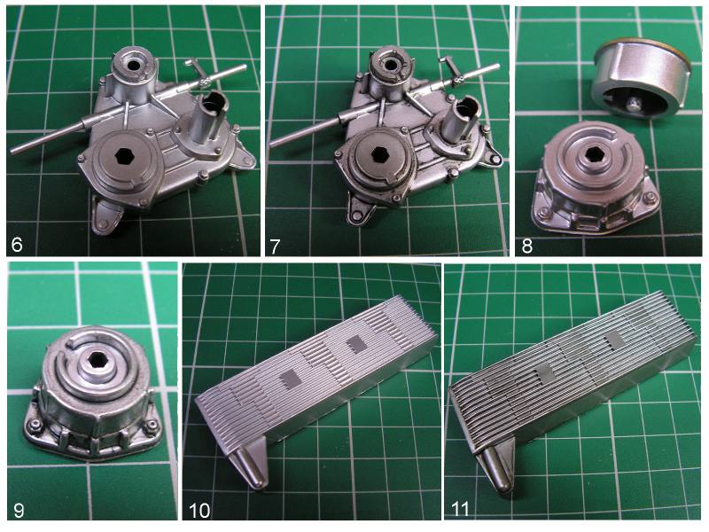

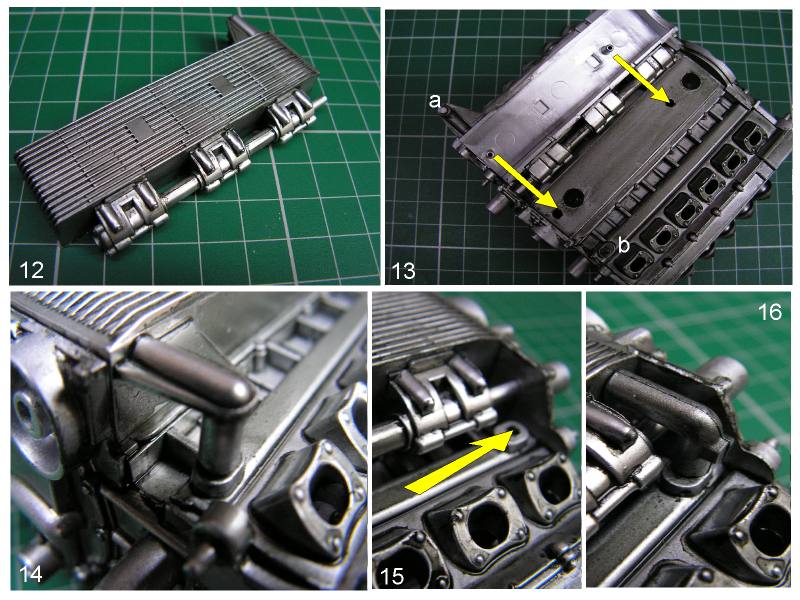

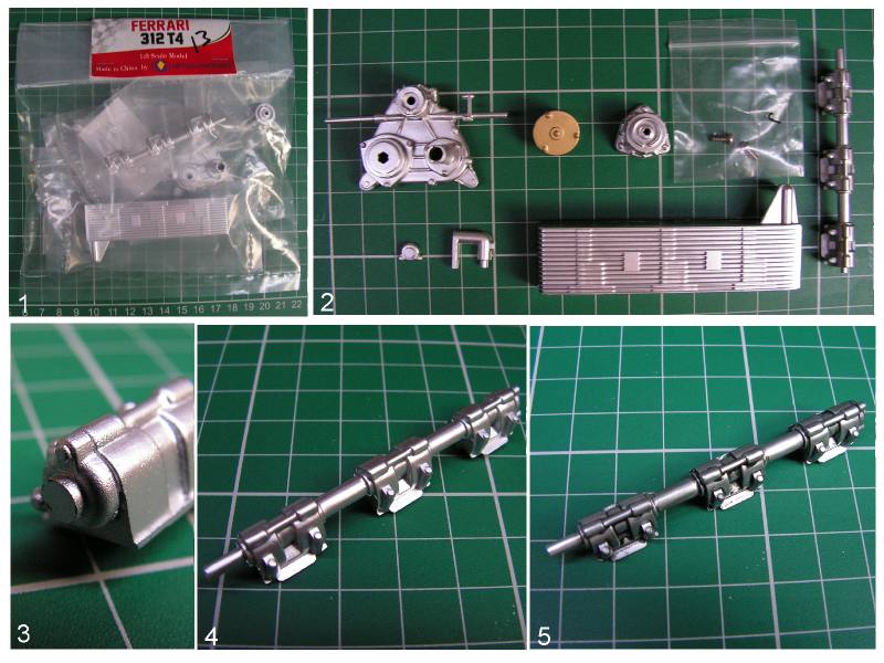

Photos 1 and 2 show the next pack of parts, number 13 which consists of plastic components to construct the Oil Sump which sits at the very bottom of the engine block, together with the Oil Pump shaft and the Alternator. The parts are shown in Photo 2 and are, clockwise from top left: The Distributor Base, The Alternator Lid and Base, a couple of Type J screws, the Oil Pump Shaft, the Oil Sump, a separate pipe from the sump and finally, the end cap of the Oil Pump Shaft. The instructions have the end cap for the shaft added on after the shaft has been fixed to the sump but I did it the other way around and added the end cap first as it would be easier to treat everything with the enamel wash that way. The end cap is shown push fitted onto the shaft in Photo 3 and then everything was washed in soapy water and allowed to dry before the Blue-Grey wash was brushed on. The effect of the wash is shown in the following photos with Photos 4 and 5 showing the Oil Pump Shaft, Photos 6 and 7, the Distributor Base, Photos 8 and 9 the Alternator (only the base part is shown washed here, the top part had some ‘extras’ added and as that part goes on later you’ll see them then!) And finally, Photos 10 and 11 illustrate the actual Oil Sump itself. Once the enamel wash had dried, the shaft was fitted on to the sump as shown in Photo 12. This is a simple push fit with two tabs on the shaft fitting into two slots on the sump but once it was fitted in tight I also applied a drop of liquid poly to each of the three ‘boxes’ at the point where they contacted the sump wall. You can make out those areas on the next photo more clearly. Adding the glue there meant it wasn’t visible on the outside of the sump. Photo 13 shows the sump laying upside down on the crankcase bottom just before being push fitted into place. There are two hollow pillars on the inside of the sump, which fit into the two holes in the crankcase (shown by the yellow arrows). Care has to be taken in the pushing down however as there is also a moulded on pipe (shown at a) which has to fit into the corresponding hole in the crankcase (shown at b), this won’t engage cleanly if the sump isn’t held level as it is pushed home! Once it is in, and the sump is fully pushed down, the pipe is fitted in as shown in Photo 14. On the opposite side from the moulded pipe there is another one, which has to be fitted in over the Oil Pump Shaft. This has a single locating peg which goes into the hole in the crankcase shown by the arrow in Photo 15. I didn’t remove the mould lines from this pipe so as not to ruin the chrome finish but I did sand the line down on the rear face, which butts up against the crankshaft as this won’t be seen and also allowed a little glue to be added to the flat face. This was the only slightly loose fitting piece so I also used a little superglue in the locating hole as well. With the little pipe added on, the corner appeared as shown in the final Photo 16. In the next installment, things get complicated – it’s Distributor time! Until then, stay safe and Happy Modelling to you All! Robin. Plymouth57 attached the following image(s): First wooden ship: The Grimsby 12 Gun 'Frigate' by Constructo Second: Bounty DelPrado Part Works Third: HMS Victory DelPrado Part Works 1/100 scale Diorama of the Battle of the Brandywine from the American Revolutionary War Diorama of the Battle of New Falkland (unfinished sci-fi), Great War Centenary Diorama of the Messines Ridge Assault Index for the Victory diary is on page 1

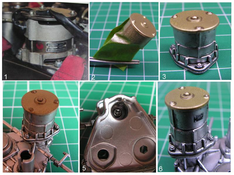

Many thanks indeed to Mark and Kev!  That blue-grey enamel wash virtually does all the work itself on the kit chrome effect, all that is required is to thin it down a little more with white spirit and either big brush large areas or tiddly brush small details! Talking of details.... Photo 1 is a snapshot from the Haynes manual on the Ferrari 312 showing the actual Alternator on the engine. This is the first part which differs in detail from it’s appearance in the instructions. In the official instructions the alternator comes in two parts – the base section which is chrome and the upper half, which is entirely gold in colour. On the actual kit part, only the top or lid is gold and the rest of the upper body is chrome. As you can see in this photo, it IS only the top which is gold (although it looks more ‘steel’ in this shot), other pictures in the manual do bring out the gold finish more – so well done to the manufacturers for changing to an even more authentic finish!  The gold colour was so close to the Vallejo Metal Colour Gold I used on other parts that I hummed and hah-ed for a long time on whether it was worth the extra bother of re-painting it at all. In the end the ‘Hapeth of Tar’ proverb won the day and so I did re-spray the gold with the Vallejo as seen in Photo 2 with its Frog tape coat on. I then also gave it a coat of the Vallejo Metal Varnish so that I could use the Citadel Shadow Black acrylic wash to accentuate the three screws and central boss as seen in Photo 3 with the upper chrome body washed with the Blue Grey as well. The two halves of the alternator simply push fit together and then the entire alternator push fits down into the Distributor base as illustrated in Photo 4. It is then fixed down permanently by screwing a Type J screw up into the body of the alternator from below as shown in Photo 5. The final ‘improvement’ was to add a tiny decal label to simulate the alternator ID label seen in Photo 1. Somewhere, probably up in the attic I have a cardboard shoe box half full of unused decal sheets – many of them bought years (I mean decades) ago from an advert in the Military Modelling magazine. They were out in the old garage workroom for many years but had survived in very good condition despite the damp winters! My next job is to climb around the attic and find them again (wish I’d left them out there now!  ) Anyway, I clambered in to the old workroom and found a box of Italieri 1/48 US Flight deck crew with the decal sheet still inside. I cut out the label that most fitted the bill and applied that to the alternator as shown in Photo 6 with four ‘dots’ of thick aluminium paint to simulate the rivets in each corner. Finally the chrome part of the cylinder including the label got a coat of semi gloss varnish as I was a little suspicious of how the decal came off the backing sheet even before I put it in the Decalfix! With the alternator securely in place, the next task was to fit on the Distributor itself. The ‘kit finish’ is shown in Photo 7, this piece is a single moulding in a black polythene type plastic (like the 1/72 scale figures from Airfix etc.) To give it a more worn or used appearance I just dry-brushed it with Vallejo Sky Grey to give the result shown in Photo 8. This was actually a little more difficult than I’d expected, the plastic has a slightly ‘oily’ finish though to be honest I didn’t first wash it in soapy water (didn’t think I needed to) and the water based acrylic tended to go on and then get rubbed off by the brush again. I think an enamel-based grey might have gone on easier but I didn’t want to over do it anyway and the result wasn’t too bad. The distributor is simply push fitted into its location on the base and this was the first such fitting that I had to adapt in the kit so far. I found it was just too tight a fit to get the thing to go right down and ended up having to carefully file down the hole by inserting a rat tail diamond dust file and gently rotating it. This allowed the distributor to go down ok but a little on the slack side so after it was in position I added a few drops of super glue around the peg from underneath the base. Although super glue doesn’t normally stick to polythene plastic it did seem to fix it in firmly here and the distributor is shown fixed in position in Photo 9. This section comes with three HT leads and their connectors. However, before commencing to fit them on I needed a little addition! Photo 10, photographed from the Haynes manual again shows the connectors on the distributor and as you can see, each HT lead has an off white ID collar down at the connector’s ‘um, connection! I hunted around for something similar and came up with some electronic wiring of 24/0.2mm with white insulation (my normal 7/0.2mm wire was actually the same diameter as the HT leads themselves so that was no use!) I stripped off a few mm of the insulation as shown in Photo 11 and sliced off thin rings to use as the collars. Now the instructions say to use a wooden cocktail stick to push into the end of the HT lead tubing to widen it slightly before sliding it onto the connector. I tried that method but found that trying to twist the stick to insert it merely twisted the HT lead around with it too. I discovered that it was much easier to use a sharp pointed metal rod like a large darning needle size. As you can see in Photo 12, I first inserted the white ring onto the tip of the needle and pulled it back down the shaft stretching it wider as it went, then the HT lead was pushed onto the metal point for a couple of mm to widen the end. Whilst it was stuck there, the white ring was pushed back down, slipping over the end of the black tube. The HT lead was then removed and a connector inserted into the end before it could return to its former size. Once the connector was on, the white ring was slid up tight to the end of the HT lead right on the connector/lead join. The first three leads, which came with this pack are seen plugged into the distributor in Photo 13. Enter my next boo-boo!  After consulting the instruction photo on the computer screen umpteen times I was convinced that the first three leads were indeed numbers one, two and three and so the ends of their leads were duly inserted onto the metal rods protruding from plugs one, two and three as shown in Photo 14. Each lead has to pass under the gold panel with the air intakes on, passing in front of the trumpet above the HT connection and over the chrome plate beneath it. There they stayed until I began working on Pack 15, which contains the rest of the HT leads and plugs. I knew that the first three leads I fitted in were each 100mm long. In pack 15, we get six more of that length, three of 80mm and a baby one of 35mm. At the end of the instructions is a reminder that plugs one, two and three are 80mm long and the other nine are 100mm – so the three 100mm ones already on couldn’t be one, two and three!  After more squinting at the photo I discovered they were actually numbers ten, eleven and twelve! So off came the leads and moved up to the other end of the head as shown in Photo 15 and 16. After that was cleared up it was much easier following the remaining positions ending up with all twelve leads on the distributor as shown in Photo 17. Later on I was to re-arrange the positioning of the connectors to closer approximate the way those leads come springing out from the distributor – even the Haynes manual describes the V12 wiring as “ an art form in itself”! With the completion of the HT leads, that completes the build from Pack 02. In the following installment, we begin Pack 03 with the fuel distribution system (and if I thought the HT leads were complicated, wait till you see this part!!!!) Until then, keep safe and Happy Modelling to you All! Robin. PS: I found this video on Youtube a few days ago – talk about some good reference material! https://www.youtube.com/watch?v=96Y1MUkq8PE

Many thanks for that Kev! Looking at the photo again, I think you are absolutely right - the alternator in that photo IS a steel finish overall, my only excuse is that the original photo in the Haynes book does have more of a 'yellowish' hue on the top than the photo here, even so it still looks more steel as you said, (I couldn't scan the photo as the manual won't open flat enough to get the page on the glass, I had to photograph the page and then crop it down!) Looking through the rest of the book and also the reference pics I've collected, the great majority of the alternators are all plain steel, of the two that aren't, one is 'goldish' (or at least the same colour as the air intake platform) and the other, just to be different is a gloss black! The blue oil filter coming soon also seems to come in a variety of colours and finishes! Funny you should mention spaghetti! In one of my less 'lucid' moments I was seriously considering having a tin of spaghetti or baked beans for tea and stirring some fuel line tubing around in the bottom of the tin to see if it would be stained yellowy-orange to simulate the fuel in the tubes. I then had visions of the engine in years to come being covered in mould growing on the tomato infused fuel lines! Fortunately after some research I came up with a more 'conventional' technique! Fuel system coming soon! Robin. First wooden ship: The Grimsby 12 Gun 'Frigate' by Constructo Second: Bounty DelPrado Part Works Third: HMS Victory DelPrado Part Works 1/100 scale Diorama of the Battle of the Brandywine from the American Revolutionary War Diorama of the Battle of New Falkland (unfinished sci-fi), Great War Centenary Diorama of the Messines Ridge Assault Index for the Victory diary is on page 1

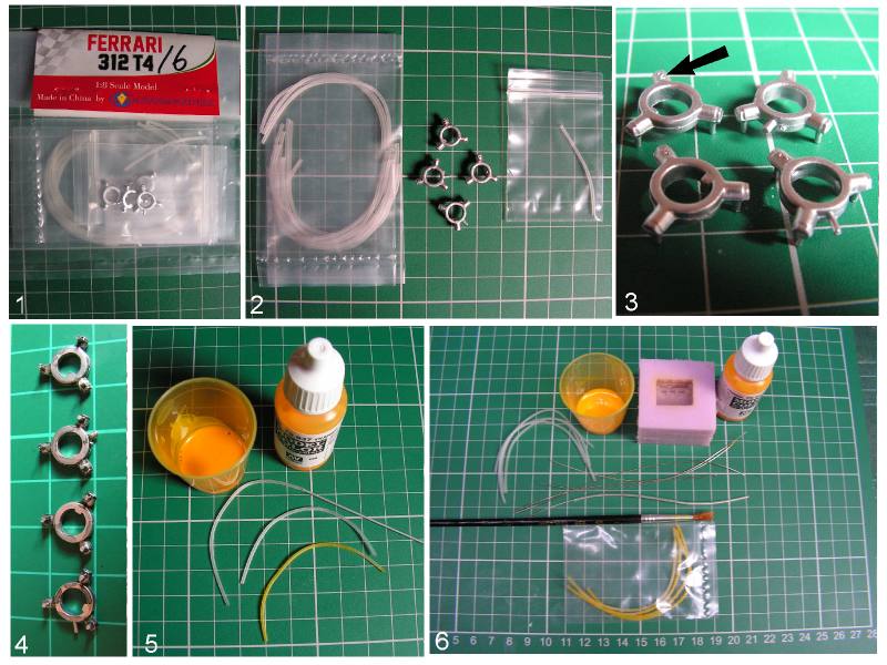

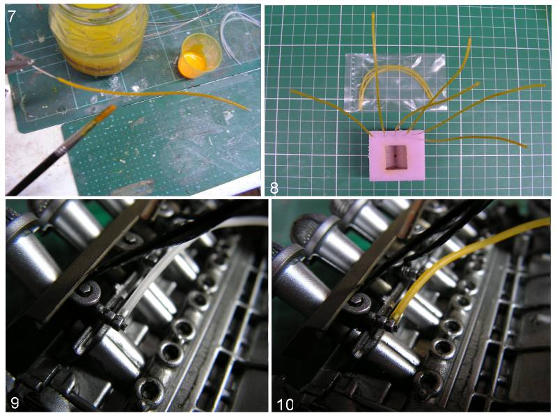

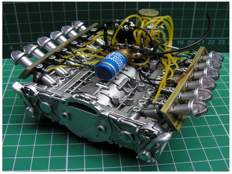

Many thanks again to Roy and Kev for those kind words! Kev, that coloured tubing is brilliant and many thanks for the info!  As you'll see below, I have gone a slightly different path but that's what I get for not having a good look through the various diaries in the car section (still stuck in the diorama/wooden ship mindset by the looks of it!) Kev's method would have been so much easier and I think the 1.0mm tubing would have been ideal, its a definite thought for others coming after on this kit though! Anyway!... Photos 1 and 2 show Pack 16 and its contents. These consist of a set of four chromed plastic fuel distributors (each one unique in shape) and three sizes of translucent rubbery fuel pipes. Fortunately, the four rings are actually numbered on their lower faces as indicated by the arrow in Photo 3. The rings were washed in soapy water and once dried, given the usual blue-grey enamel wash to leave them looking as in Photo 4. Then it was time to try some experimenting on the rubber tubing to try and simulate the yellow staining that the petrol imparts to nice clean new petrol tubes (see, even I knew that with my years of 50cc moped-ing!) After looking around the internet (everywhere except the diaries on here of course) I found a reference to Tamiya Clear Yellow. Not having any Tamiya paints I did discover that Vallejo did a range of acrylic Transparent colours, so I sent off for a bottle of yellow together with a 1m roll of clear tubing from a very useful supplier on ebay to try out the techniques on, rather than risking the kit items. I thought the supplied tubing was 2mm so that’s what I bought but it turns out it is more like 1.8mm, actually, (after finally checking it with the digital micrometer its more like 1mm)Anyhow, my first efforts using the 2mm tube was to employ a syringe from my inkjet top up set to siphon the yellow paint up through the tube, wait a little while then squirt it back into the bottle, sucking up clean water to reduce the yellow down. This actually worked very well with the clear tubing but was a bit inconsistent with the translucent, proving hard to get a uniform finish. You can see this method in Photo 5 with one piece of tubing yellowed nicely and another on the end of the syringe needle. I then discovered that it wasn’t actually necessary to suck the paint through the tube at all and a more consistent result was obtained by essentially ‘staining’ the outside of the translucent tubing instead. The ‘kit’ to perform this technique is shown in Photo 6 consisting of the bottle of Vallejo Transparent Yellow, a small mixing cup with a few drops of the paint, a selection of 0.5mm wire cut a little longer than the rubber tubing, a soft natural hair brush and one of my silicone rubber house moulds from the Sword Beach diorama!  The poly packet contains the first group of rubber tubes from before this photo was taken. The procedure is as follows: take a rubber tube and pass it over the wire (I learned to bend the end over at a right angle later to stop the tube running off the end). Grip the other end of the wire in a crocodile clip on the ‘hand’s free’ gizmo (the ones with a magnifying glass etc) and dip the brush into the yellow paint, giving the entire tube a quick coat, and using the ‘pull’ of the brush to spin the tubing around on the wire to coat all around. Then, quickly suspend the painted tube over the jam jar of water and after cleaning the brush off run all over the tube literally washing most of the paint off again and leaving just a yellowish stain on the exterior of the rubber. This is shown in Photo 7. As for that silicone rubber mould? This was used as a convenient base to push the other end of the wire into to allow the stained tubes to dry off as seen in Photo 8. On some of them, a drop or two of watery paint collected and these were removed with the soft brush to prevent a thicker yellow spot forming. The last two photos, Photos 9 and 10 illustrate the difference between using the translucent tubing ‘as is’ on the left and the yellow stained finish on the right. In the next installment, all that stained tubing gets installed onto the fuel distributor stack – be warned – there’s a lot of sickly yellow all over the screen to come! Until then, stay safe as always and Happy Modelling to you All! Robin. Plymouth57 attached the following image(s): First wooden ship: The Grimsby 12 Gun 'Frigate' by Constructo Second: Bounty DelPrado Part Works Third: HMS Victory DelPrado Part Works 1/100 scale Diorama of the Battle of the Brandywine from the American Revolutionary War Diorama of the Battle of New Falkland (unfinished sci-fi), Great War Centenary Diorama of the Messines Ridge Assault Index for the Victory diary is on page 1

Looking good Robin. An interesting method for colouring those fuel lines and they turned out fine, well done.
Looking forward to the next update!
Kev
 Rank: Super-Elite        Groups: Official Builds, Administrators, Moderator, Global Forum Support, Registered Joined: 04/06/2011 Posts: 5,183 Points: 15,698 Location: ipswich
A great way for colouring those fuel lines Robin. This is going to be a fantastic display piece.
