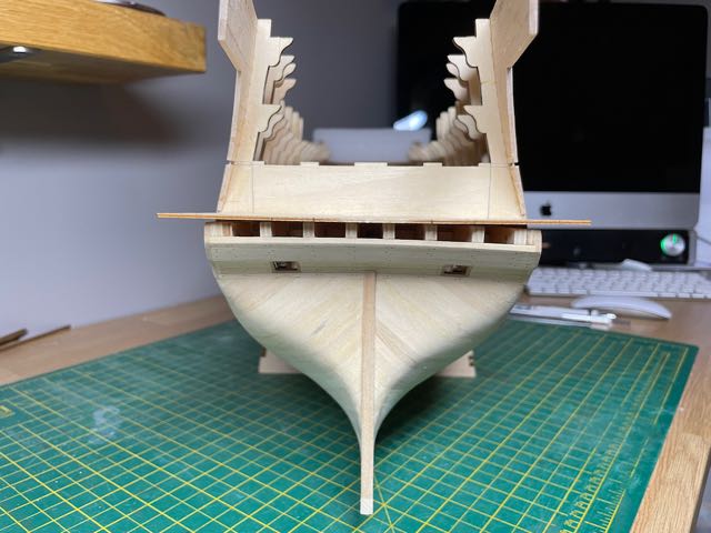

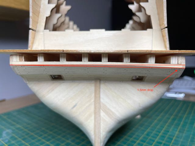

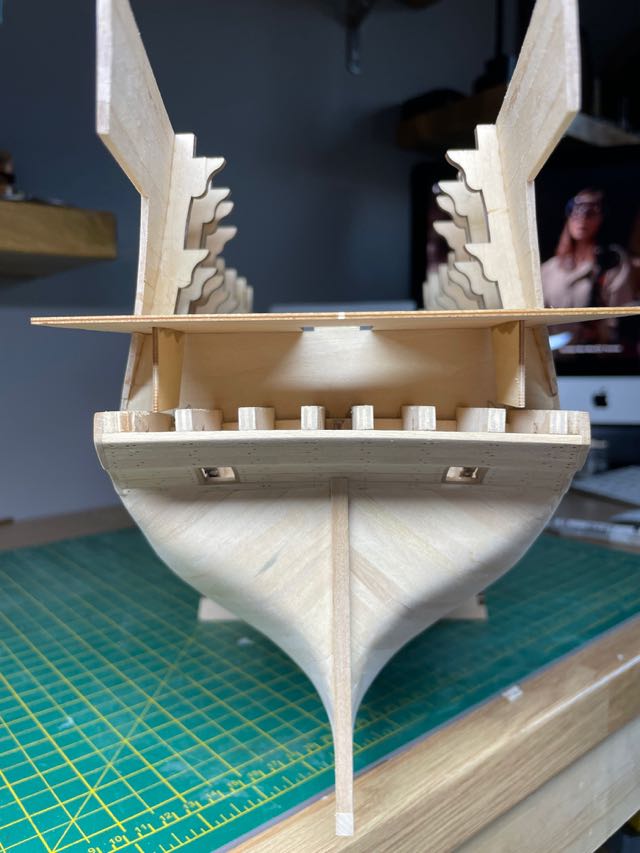

...but, I during the fitting of the decks I discovered an issue that I have completely missed until nowOhMyGod
The gallery support is not straight Scared
The starboard edge of the support sits a good 1.5mm lower that the one on the port side. It doesn't sound a lot but it's looks very obvious to me.
I remember at the time that I was quite enthusiastic finally starting the planking and must have missed to double check the proper sit of the support beams. I didn't notice the difference either when planking this bit with the frame upside down.
I'm not sure of how to rectify this. Has anyone came across a similar issue?
My current thinking is to leave it and hopefully it won't be as obvious once the gallery is completed...

Hi Odo,
I don't recall having the problem of the gallery deck being off-line slightly on my build although it almost certainly was!
What I do know is that by the time the external gallery cladding is fitted, you will not notice that the inner deck is slightly askew. My personal advice (not always the best, mind you BigGrin ) is to leave it as it is.
Incidentally, that hull cladding is probably the neatest I have ever seen. Keep it going and look forward to more build updates.

Hi Chris,
Thanks for your remark about the hull cladding, appreciate it. The question is can I keep it up. Time will tell...
The inner decks of the gallery are actually straight. It's the gallery support with the two gun ports that's sloping. However, I think you're right and for the moment I'll leave it, as I can't think of a way to rectify it. I probably gonna take the gamble and hope i'll be able to counter act the slope when fitting and cladding the gallery walls. At the end it'll only be noticeable if you look at the gallery straight on and only if you actually know it's there RollEyes

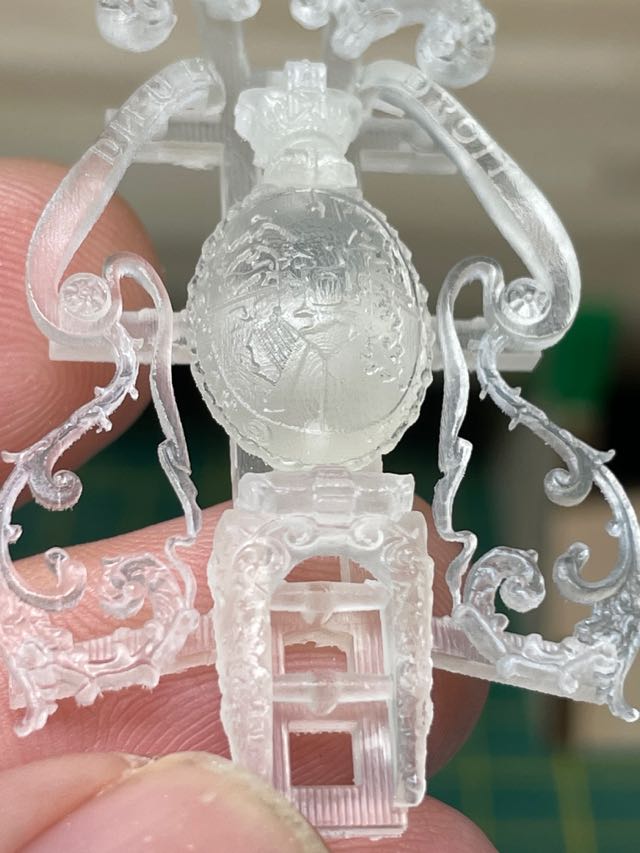

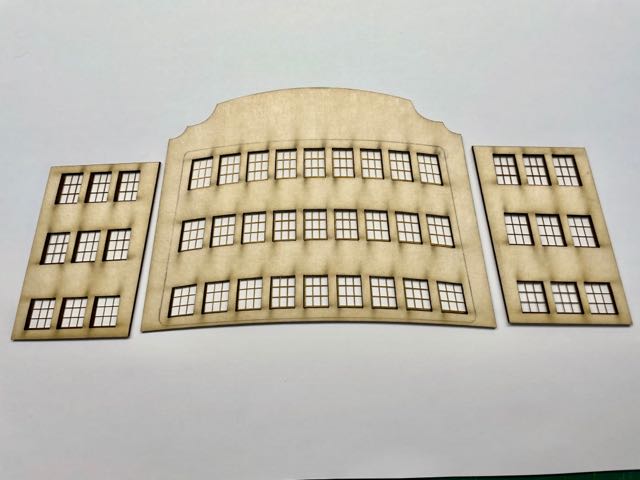

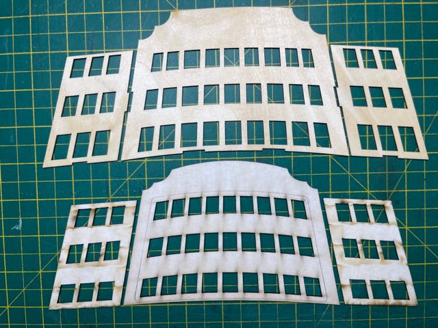

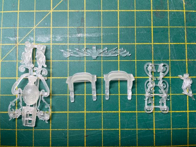

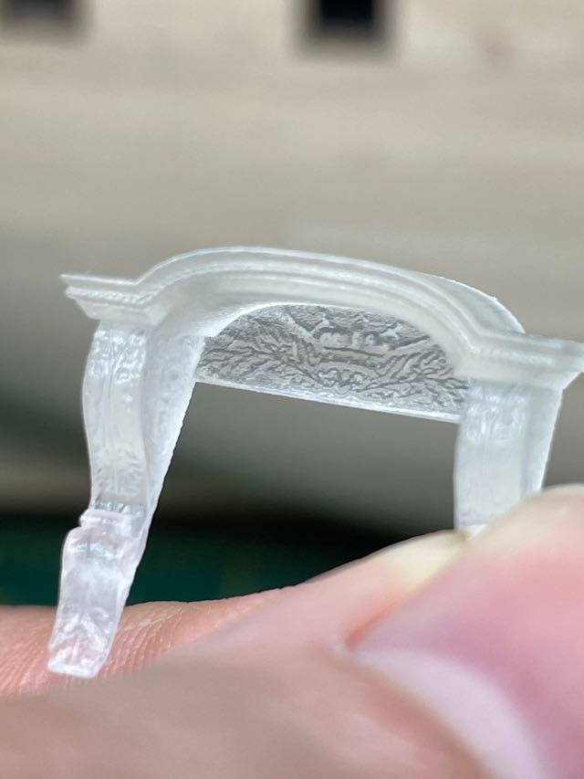

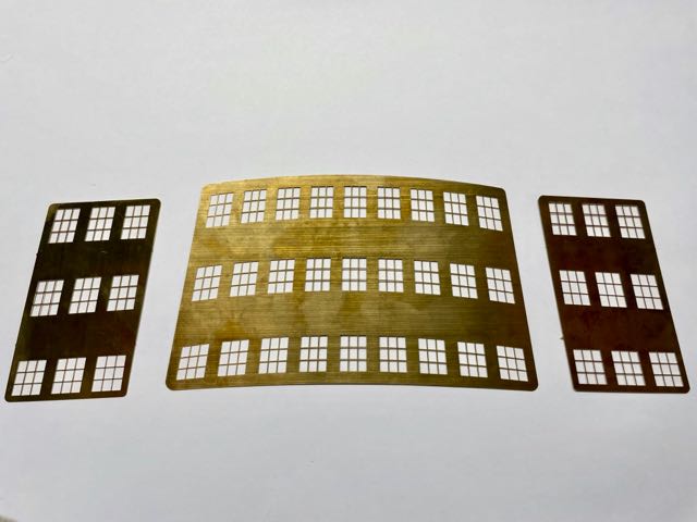

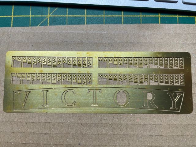

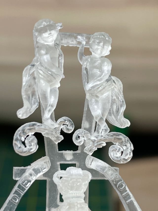

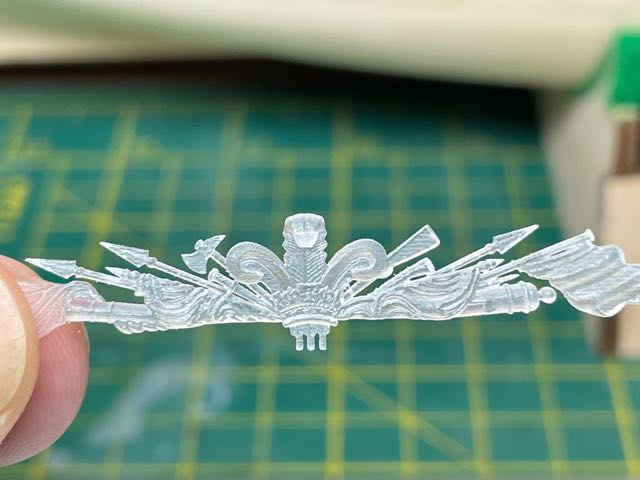

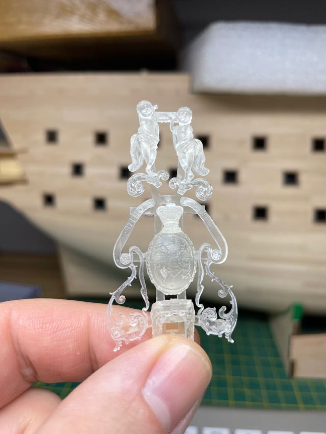

I want to give Woody's ModelWorks a big shoutout as I was lucky enough to order one of the last available gallery enhancement kits as well as the water level markers.
As so many other fellow builders I found that the provided gallery does not quite look right and really appreciate that people put the time and effort into providing enhancement kits of that quality to highlight certain features looking as great as they are on the real Victory itself.
Well done Woody's ModelWorks!
Odo attached the following image(s):
Odo

The dimensions and details of the provided gallery ornaments, figure head and side entries are also not to my liking.
And as I don't have the skills such as wizard Willz demonstrates in his build to get the details I want, I found these ones from Shapeways. After reading through Woody's gallery instruction I discovered, he used them as well.
They are not cheap but I think definitely worth the money...
admin
#66 Posted : 10 March 2023 17:42:02
Posts: 1,937
Points: 5,823
Once again, I’m struck by the planking! Fantastic job!
The detail set looks great too, and I can’t wait to see it in place.

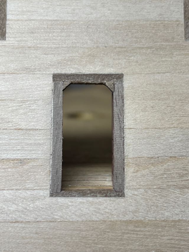

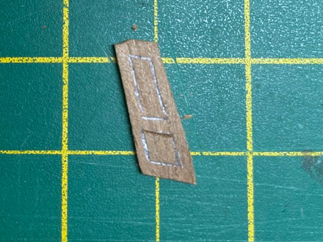

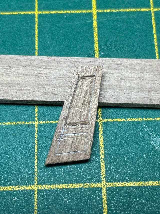

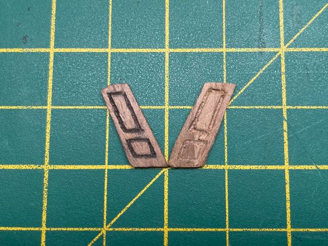

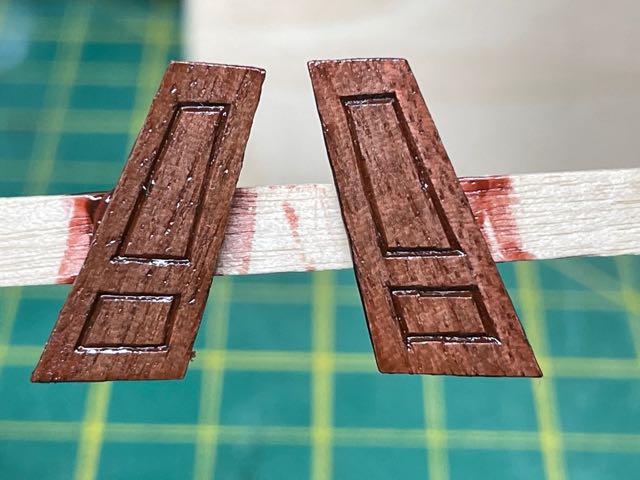

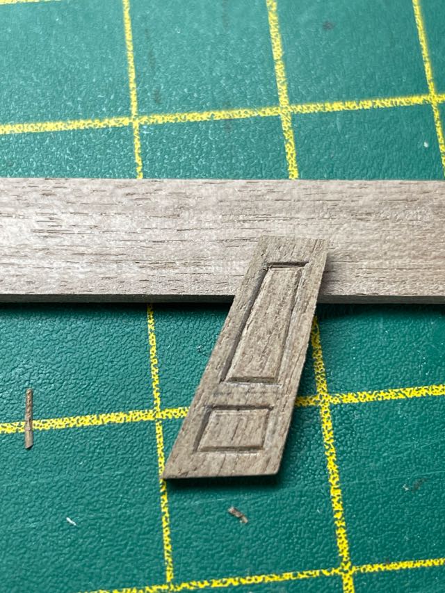

Thought to try out adding some detail to the side walls of the entry ports. The walnut strip wood I used for the gun ports wasn't wide enough so had to glue a couple of pieces together to get a width that was workable with - well, at least to a certain extend. The wood was so soft that I could get clean cuts to simulate the panel inserts...
My first attempt:
Odo
#69 Posted : 12 March 2023 00:54:54
Build-Diary Medal: Build-Diary Medal of HonourOutstanding Build: An award for an outstanding build
Joined: 13/10/2020
Posts: 171
Points: 522
Location: Hampshire, UK

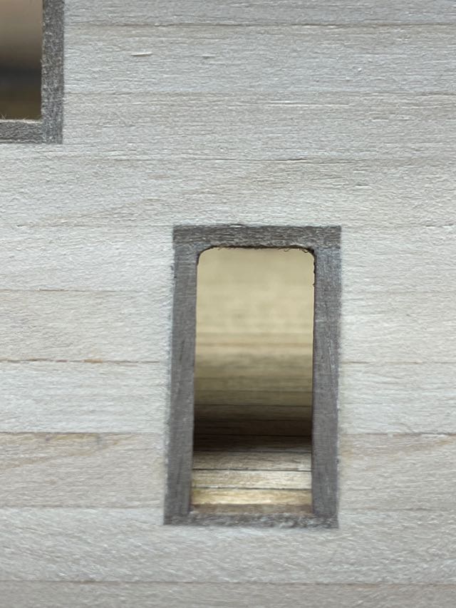

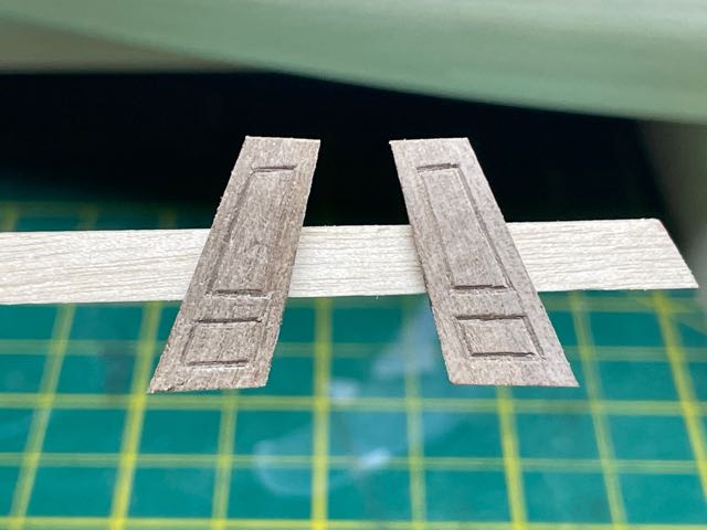

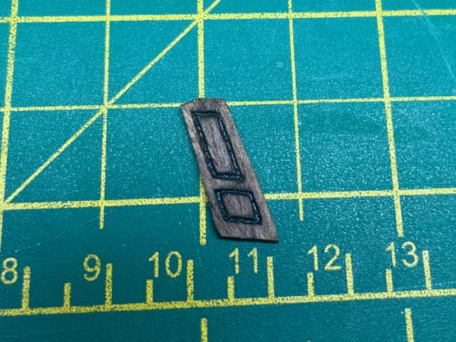

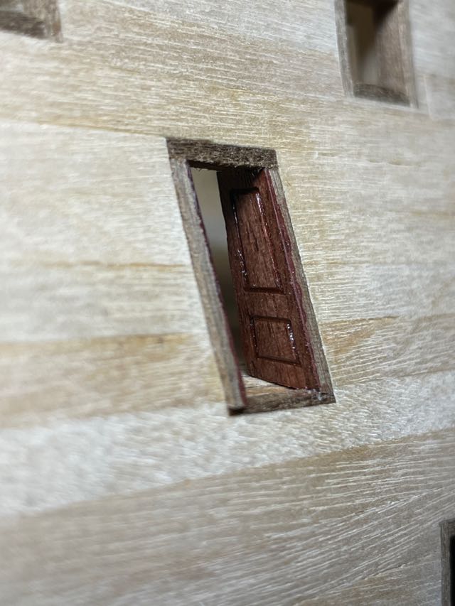

For the second attempt, I used a single wider piece of walnut that I ordered together with the strip wood for the wales. Luckily this was 'harder' and much easier to work with when it came to carving it.
After I used a few coats of deep mahogany varnish to give the side panels some colour.
Odo
#70 Posted : 12 March 2023 00:57:09
Joined: 13/10/2020
Posts: 171
Points: 522

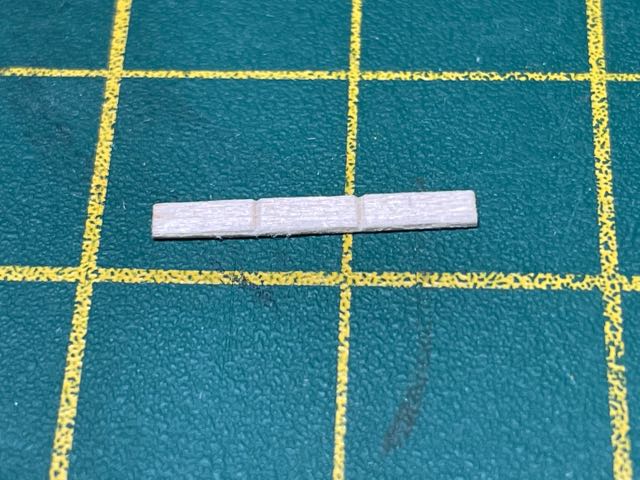

Finally, I wanted softer inner frame edges as they are on the real Victory, so I had add and shape some rounded corners.

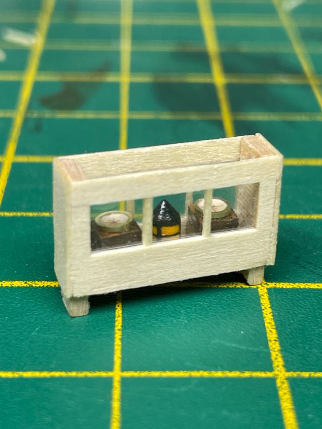

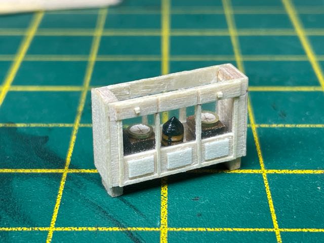

Good evening my fellow modellersSmile

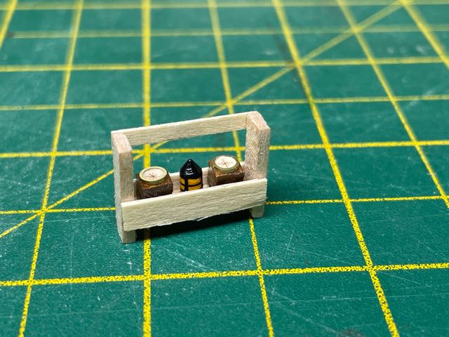

I wish, I could give you and update about the gallery, but I had to put that part of the build aside for now. I'm still debating on how I want the gallery to look and can't quite come to a definite look just yet. I'm sure, I'll settle on something later but felt that I had to take my mind off the bigger building stages and wanted to focus on one of the smaller builds.

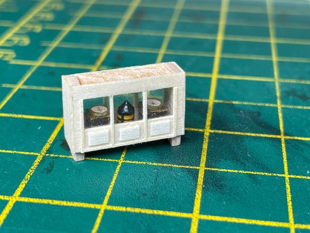

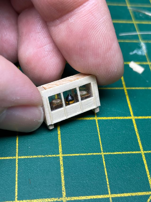

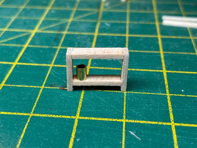

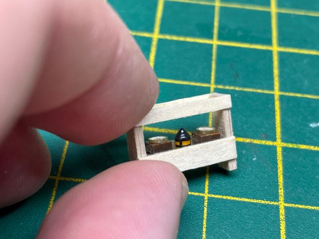

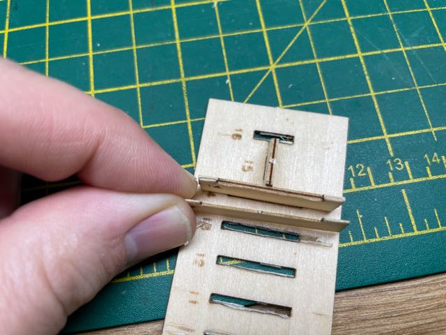

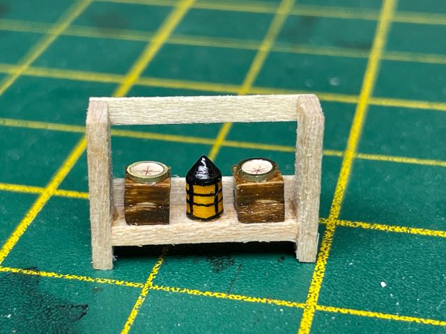

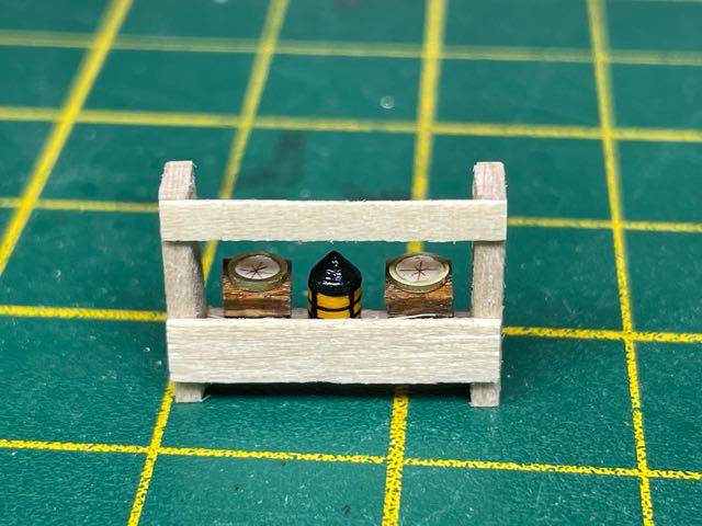

One thing that always bugged me was the by the kit suggested design of the binnacle. To me it doesn't resemble the real one at all and as it's in an area of focus, deserves a bit more attention to detail. There are plenty of 3D printed options out there which I might consider, but I wanted to give it a try making one from wood first myself.
I had no idea exactly how to, but I figured it'll come to me whilst building. And of course the first attempt didn't quite cut it...
Odo

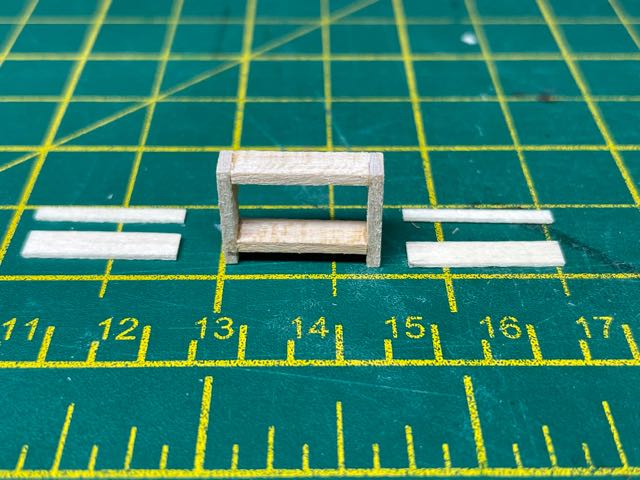

#74 Posted : 20 March 2023 22:36:08
Joined: 13/10/2020
Posts: 171
Points: 522
A couple of years ago I ordered some brass rods that I need for my cannon assemblies. In that order i was provided with a sample pack of brass, steel and copper cylinders of various sizes. I thought, I could utilise these to simulate little compasses as they can be seen in the real binnacle on the Victory. And one of the smaller brass ones with a 3.2mm diameter seemed to be the perfect option for this.
It was clear that my first design didn't allow me to incorporate these, so I had to start over as I needed a better frame.
Odo
#75 Posted : 20 March 2023 22:43:37
Joined: 13/10/2020
Posts: 171
Points: 522

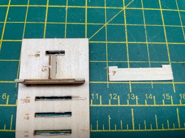

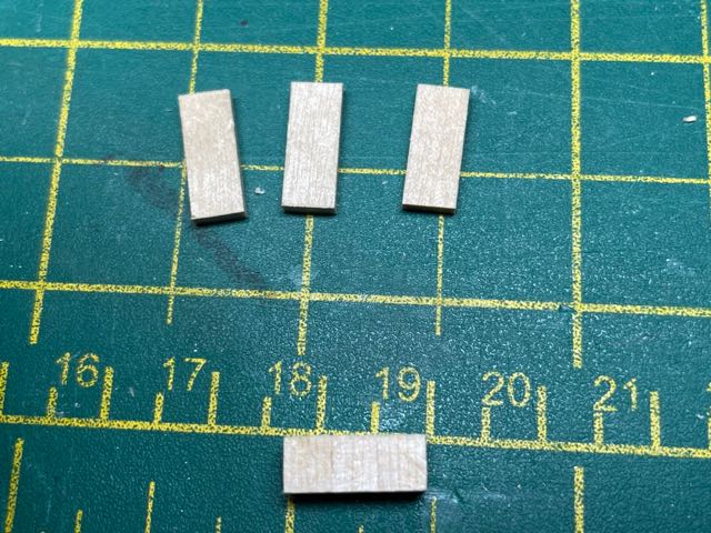

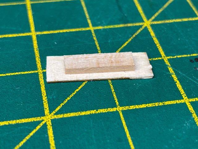

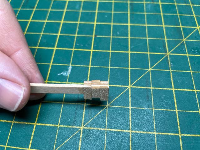

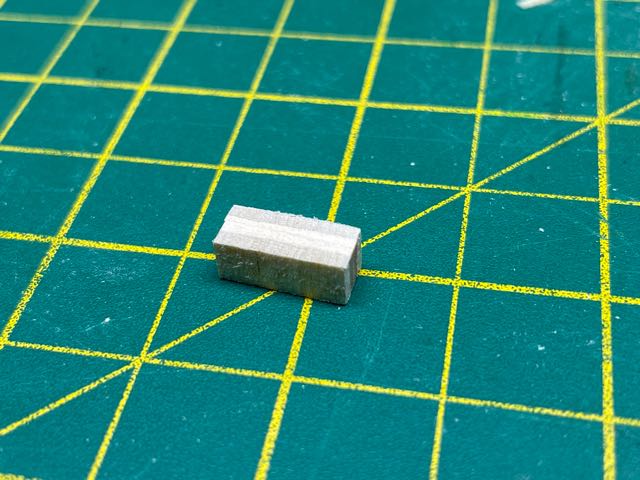

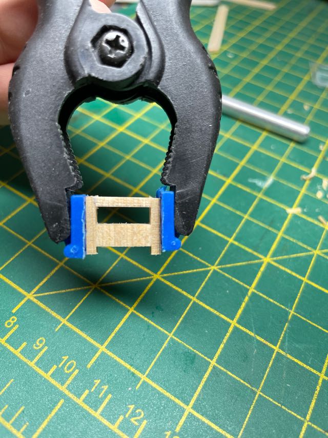

For the front and back panels I used the leftover plywood from the launch build. Using the whole piece of ply would've given me to thick panels. The ply is made up from 3 layers which are easy enough to be separated with a chisel knife. The result is a 0.5mm thick sheet of wood perfect to make the panels.
Odo

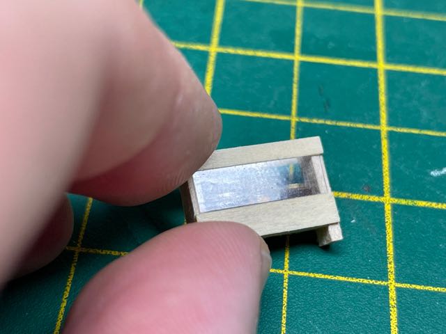

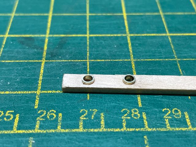

#76 Posted : 20 March 2023 22:56:52
Joined: 13/10/2020
Posts: 171
Points: 522

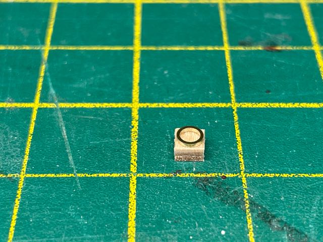

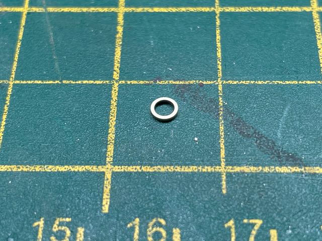

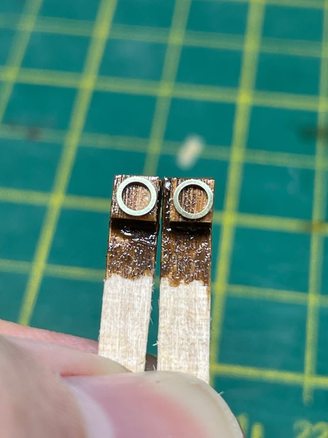

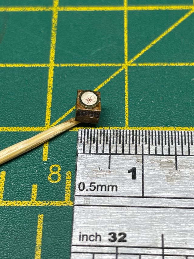

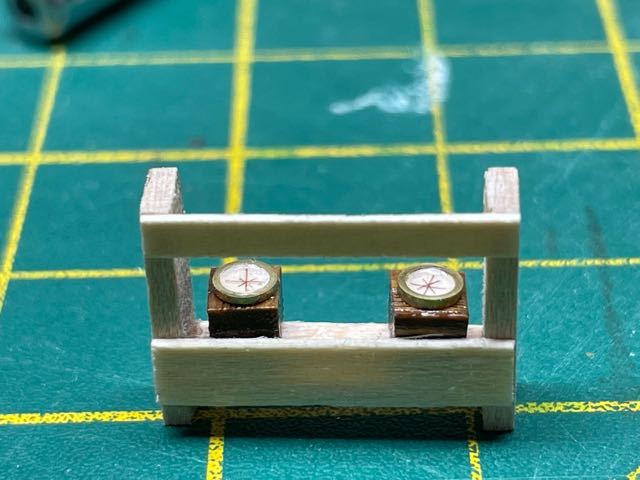

Now for the compasses:
Initially, I just cut the pipe I had in half leaving me two 2.5mm high pipes which I wanted to imbed in wood simulating the housing/box but whichever way I tried, the wood was always splitting and falling apart, since the width was only 0.3mm wider than the diameter of the pipe.
I needed brass rings! Unfortunately, I could saw the pipes anymore as i couldn't hold it in place whilst sawing, and using a vice would've deformed the pipe.
So I had to file them down by hand.
Odo

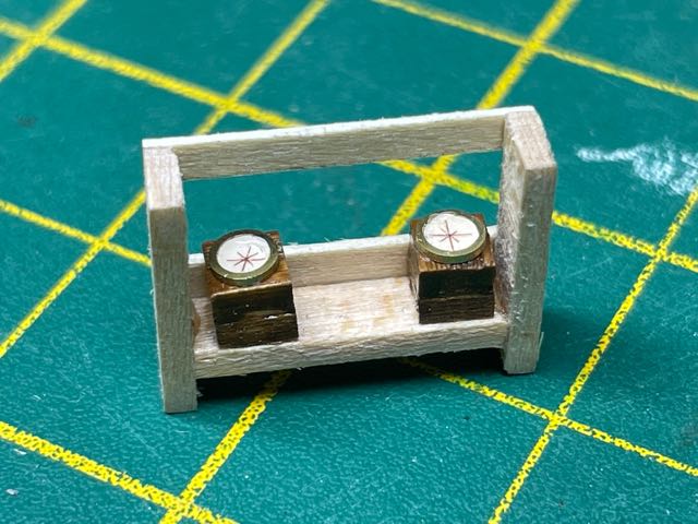

#77 Posted : 20 March 2023 23:09:10
Joined: 13/10/2020

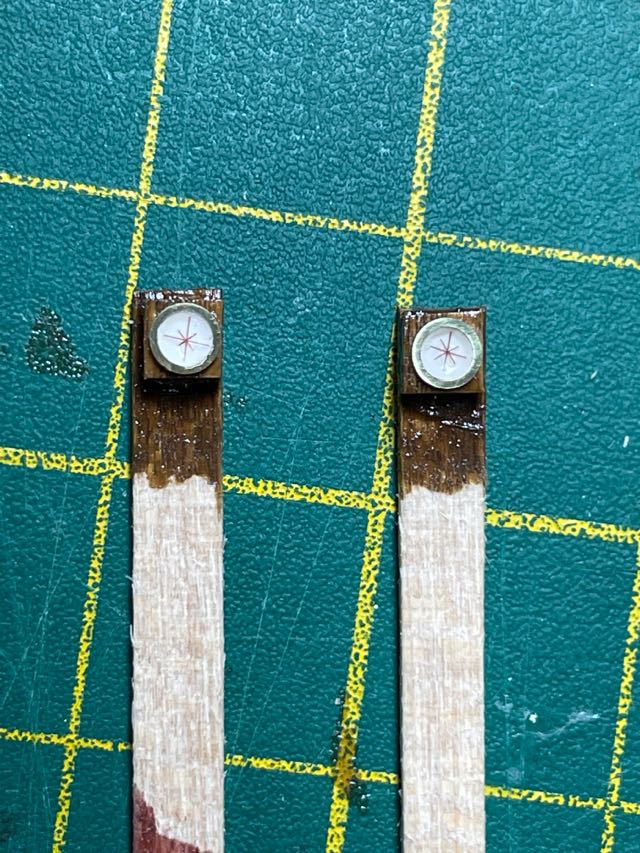

Posts: 171
Points: 522

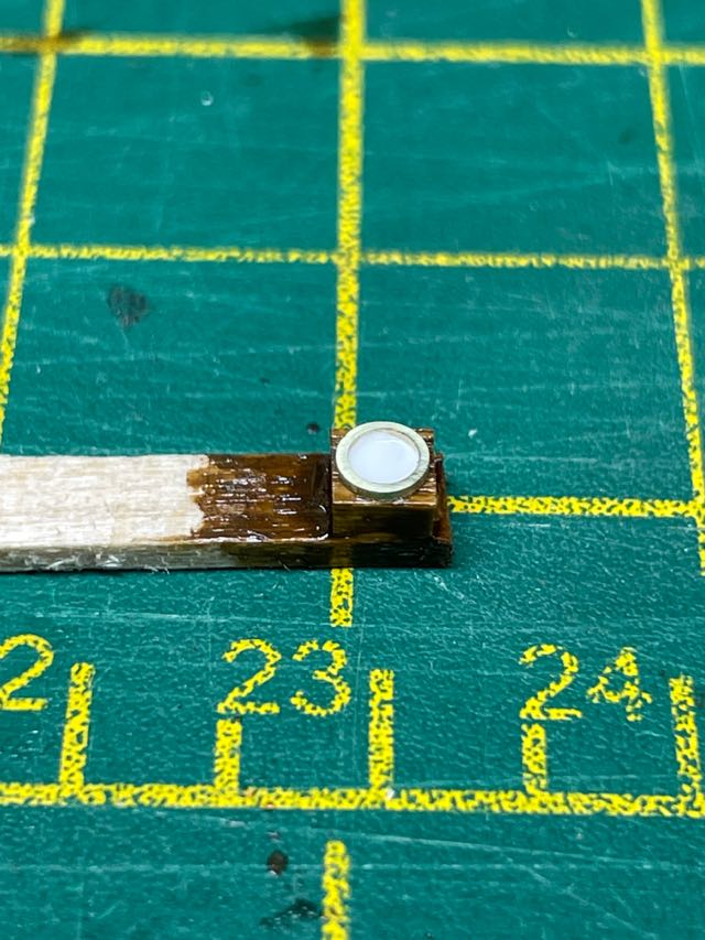

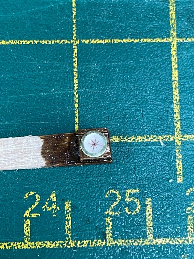

After gluing the 0.6mm high brass rings with a diameter of 3.2mm to some dark oak stained square wood blocks of 3.5mm, I filled the rings with white paint.
I then cut a few hairs off a fine paintbrush and used them to simulate the layout of a compass. In order to achieve this I filled the ring with wood glue and imbedded the hairs before the glue dried.
Odo

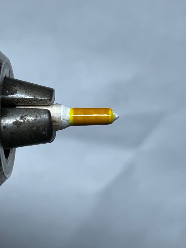

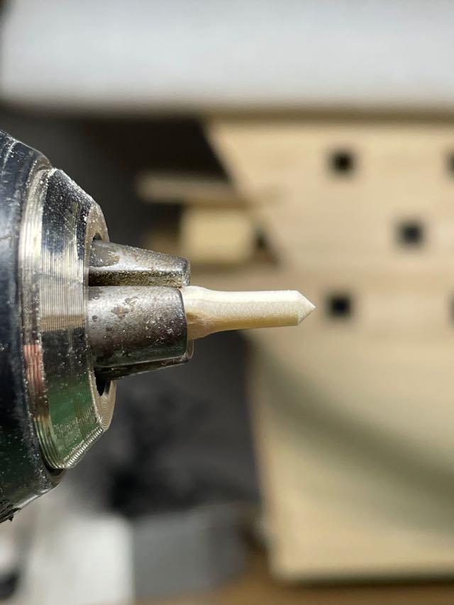

#78 Posted : 20 March 2023 23:21:23
Joined: 13/10/2020
Posts: 171
Points: 522

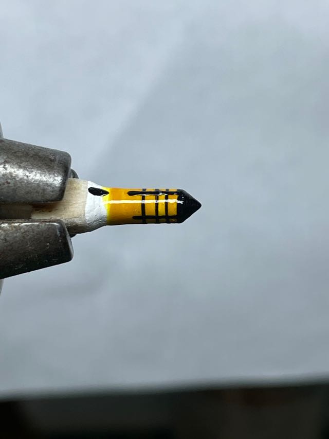

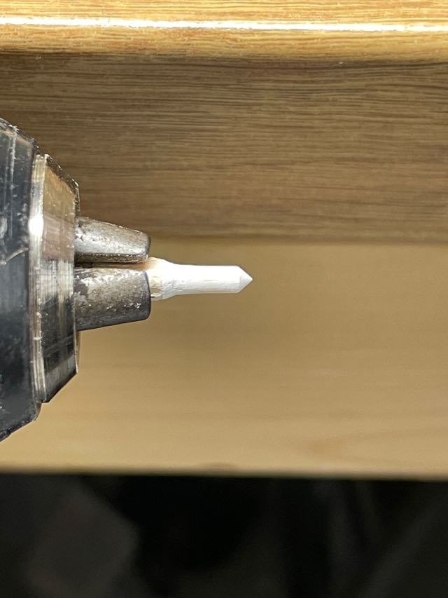

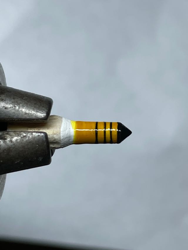

For the lantern:
I used the help of my high precision lathe, aka electric drill... I had to ask my 6 year old one for help to keep the trigger pulled at a constant speed... more like variable speed Laugh - he tried, bless him. Just goes to show I really need to get a proper lathe!
I first had to make a dowel from a square wood, which I first painted white, then then with a clear yellow and finished with black accents.
Odo

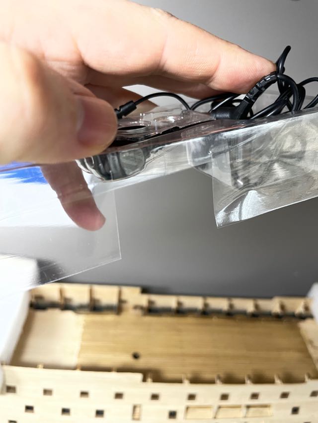

#79 Posted : 20 March 2023 23:23:10
Joined: 13/10/2020
Posts: 171
Points: 522

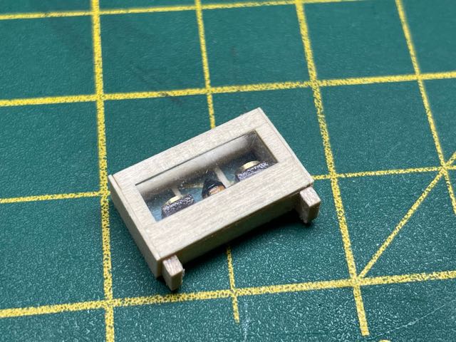

For the glass:
Odo

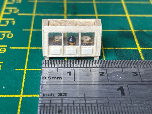

#80 Posted : 20 March 2023 23:25:58
Joined: 13/10/2020
Posts: 171
Points: 522
and so it comes slowly together...
