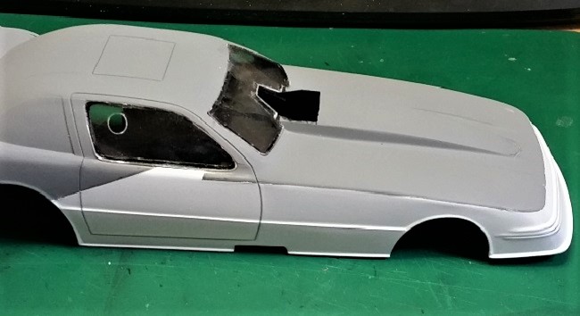

So after what I class as a successful scratch build, I`m now on the search for other figures I can transform later on for the dio.
In the mean time I`ve tackled the body masking for the first colour (white). I had to make a template to get the guide lines in the correct place as some of the decal is see through to show the second colour (blue) as a thin stripe in it.
I`ve attached a pic of the results so far.

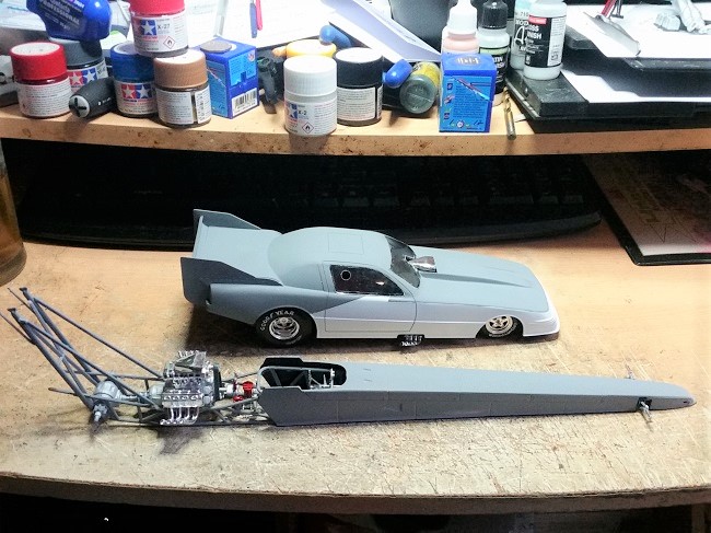

Thanks Mark BigGrin .

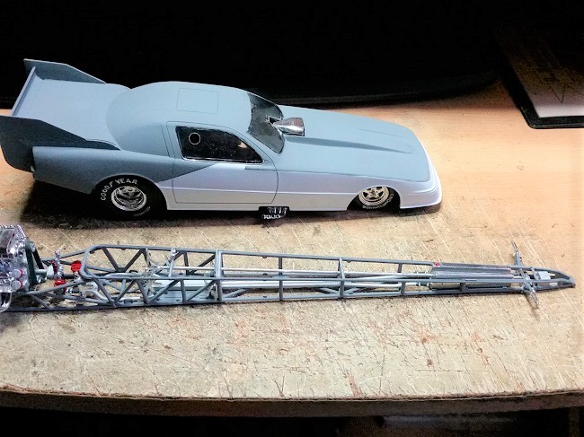

Whilst letting the first colour harden, I`ve made some progress with the Pro Fuel vehicle.
I`ve added the rear extensions to the vehicles frame. A few bits added internally that I will show later as I had to put other parts temporarily in place so that the extensions set straight to the rest of the frame. (Rear brace, Rear axle and Engine)
Three pics for this update:
1: The rear frame extended.
2:The front rail length against the "Funny Car".
3: Full view of both cars as they are. Funny car rear wheel just placed for the pic.

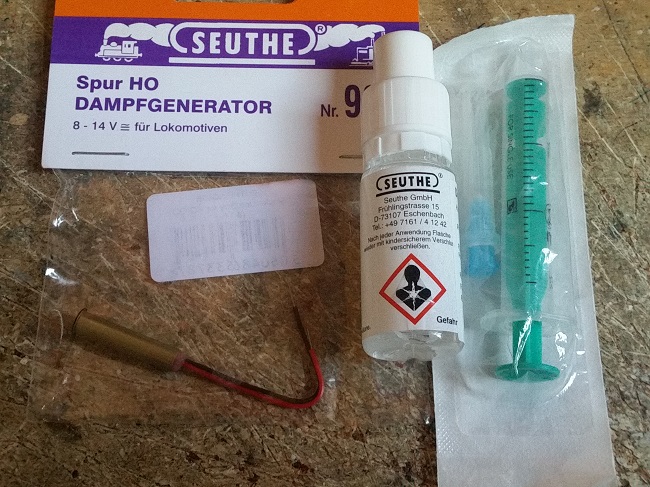

Having returned the faulty "Faller" smoke unit, I`ve ordered two "Seuthe" #99 smoke generators that are used for model train smoke stack installation. One that will be fitted under each rear wheel. I consulted with a very helpful guy at Peters Spares in Teeside. https://www.petersspares.com/
I discussed my plans and he gave advise as to how close I need to get each unit to the tyres etc. etc.
So they are on their way as is the replacement rear axle, so hopefully next week some time I should (fingers crossed) have the test bed up and running with video to follow. Blink Blink

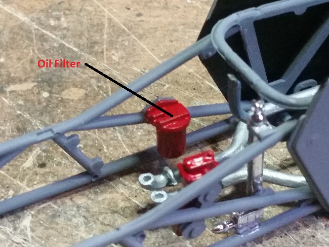

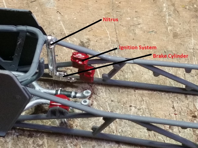

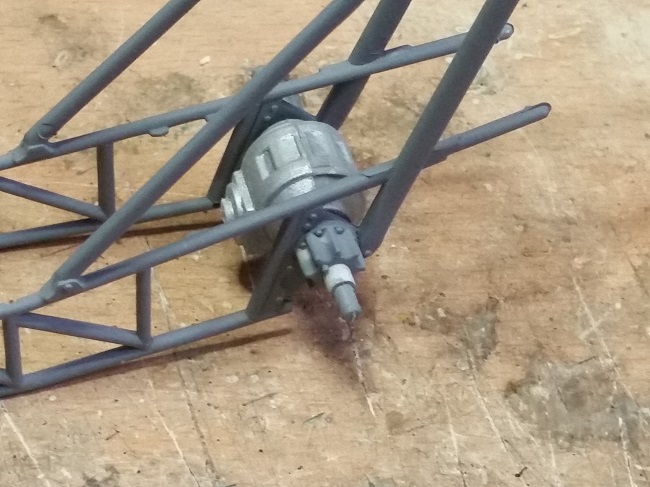

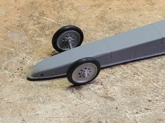

Now for the latest update:
As I said there were bits added but not glued when I extended the rear frame of the Pro Fuel car, so
Pic 1: Shows the details added to the right rear frame.
Pic 2: Shows the detail added to the left rear frame.
Pic 3: Shows the final drive (back axle) in place. This is not glued until the engine is fixed in place so the drive shaft from the engine can be fixed straight to the axle.

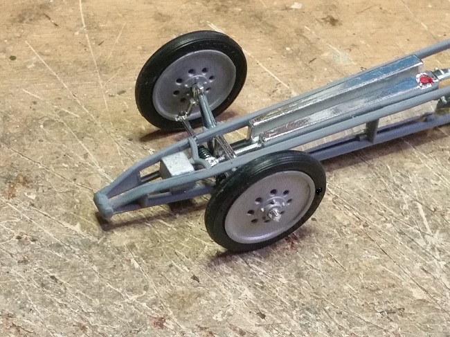

Pic 4: The front wheels now made up and attached (no body in place)
Pic 5: As above (primed body in place)

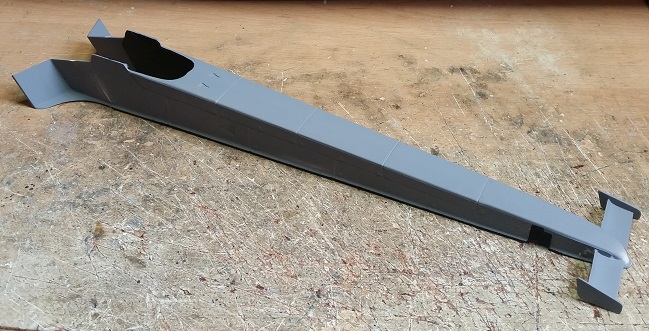

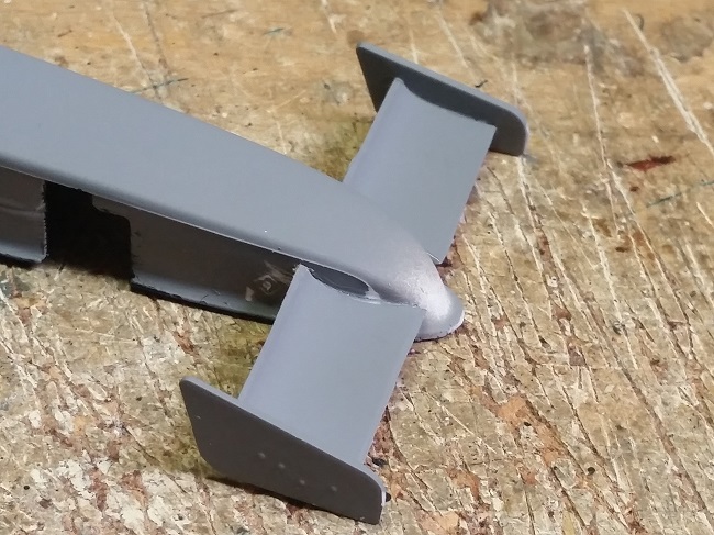

Many Thanks for the comments and those who have taken the time to look in. Appreciated as always. Cool

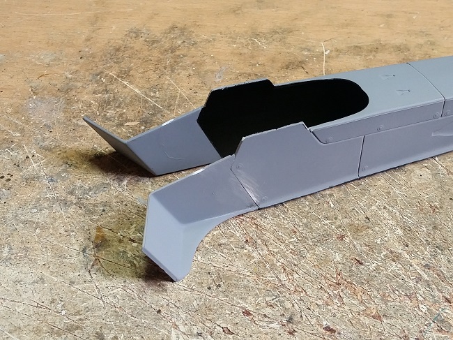

Got a little more done on the body of the Pro Fuel vehicle yesterday as shown in the pics below:
Pic 1: Front wing attached.
Pic 2: The rear body extensions attached.
Pic 3: The full body. (Small screen to fitted after final painting.
The body is now having a second base coat.

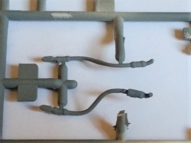

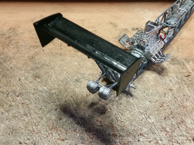

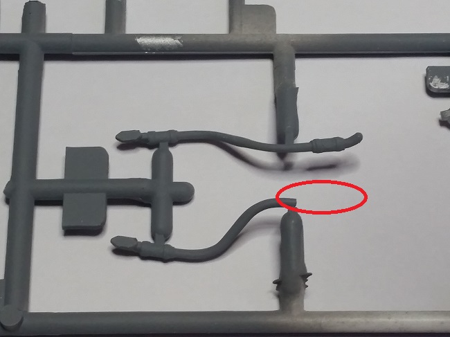

So that said I`ve had some more time today and the results follow. One not so good.Blink Blink

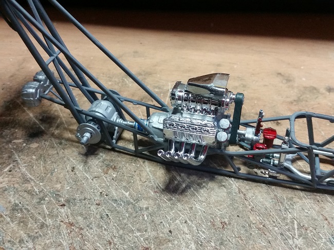

More work done on the Pro Fuel car:

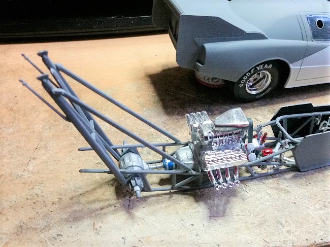

Pic 1: Rear wing and chutes fitted. You can just see one of the rear discs, but when the big rear wheels/tyres are on that`s unlikely.
Pic 2: The full power train is now in situ. (Almost - see pic 4)

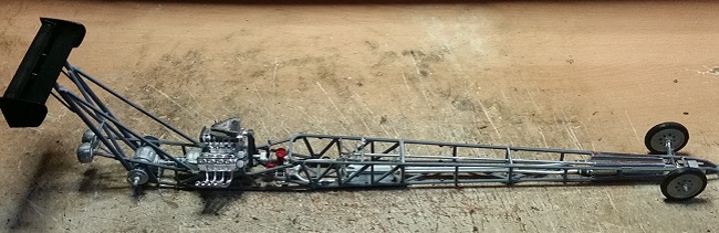

Pic 3: The full vehicle as it looks now (minus body shell)
Pic 4: Still have a rear tank to fit and the two pipes that connect to the engine. Here`s the problem, only got 1 and 3/4 of the pipes.(Working on it)

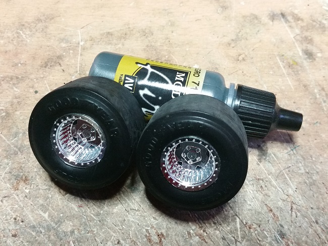

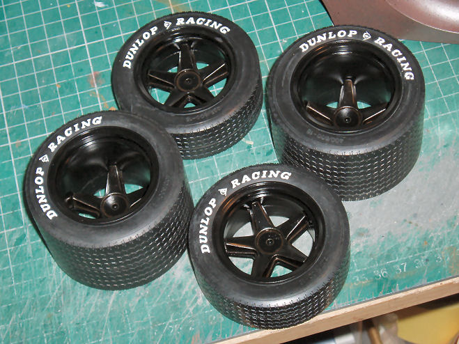

Pic 5: The big beasts of rear wheels and tyres.
Now a question. Blink
This kit comes with decals for the tyre lettering. So has anyone had success in applying decals to the raised lettering on tyres or do you have to remove the raised letters and then apply the decals? Asking as I`ve never had tyre decals before and nothing mentioned in the instructions.Confused Confused

With regards to the tyre decals, if they are of the normal 'waterslide' type that you would apply to the body of the model, and they align perfectly with the raised letters on the tyre, then just apply them as normal, preferably using a bit of decal setting solution such as 'Micro-sol' and 'Micro-set' then seal them with a thin layer of satin varnish (acrylic). There used be a type of tyre decal some years ago that was printed in reverse on the decal sheet and had a a thin layer of glue on them that was activated by wetting them slightly then with the backing sheet outermost, rubbing the decal down onto the tyre (a bit like the old 'Letraset' lettering that you could buy from stationers), so that when the backing sheet was removed the decals were left stuck to the tyre and were the right way around.
You could also use some white acrylic paint with a fine brush (and a steady hand) and just paint the raised areas. Any slightly overpainted areas between the lettering can be judiciously scraped away using the tip of a scalpel and then satin varnished as per the other methods.
You could also of course do what you've mentioned and sand away the raised letters to a fine surface then apply the decals to a bare sidewall, but you'd need to make sure the surface of the tyre wall was nice and shiny before applying or you'd likely end up with 'silvering' of the decal film due to them being applied over a rough surface and having a thin layer of air trapped beneath the decal film. Personally I wouldn't try that method as it's not easy to get a smooth shiny surface on rubber - unless you apply several layers of gloss acrylic varnish before applying the decals over it then re-varnishing with satin?

Thanks Kev for the info, Cool Cool .
Think I may stick to the paint and tidy up scalpel job. May not be perfect but less hassle if it goes badly wrong and I`ve used that method before.

So, I now have:
Brass Axle, thread cutting die, new smoke generator (X2) and a whole bunch of figures to perform plastic surgery on.LOL LOL
The smoke generators (see pic 2) are by Seuthe (Version 99) and are actually designed for fitting in train smoke stacks, so a mounting will be needed. More on that at a later date.

Regarding tyre lettering - I use a fine tipped white marker pen.
'uni-POSCA'.
I got it from Amazon. Absolutely brilliant, dense white and a good fine tip.
Just colour in the raised lettering.
#78 Posted : 14 September 2020 11:52:50
Cheers Roy, Cool Cool
Have ordered one and will give it a try.
With a 0.7mm tip it should still do the 1:24 scale tyres. Better control than a paint brush.BigGrin

In a previous post (6th Sept) I showed a part that was not fully moulded. I had made the basics of the repair before my bite episode, but never got round to fitting it.
So in today`s update:
Pic 1 is the part as it came out of the box.
Pic 2 shows the first stage of the replacement. (Made from scrap sprue)

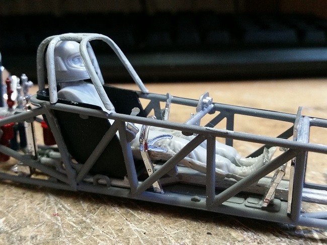

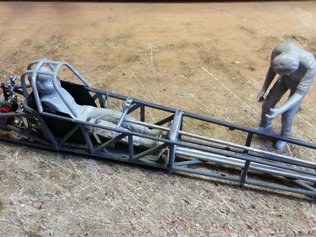

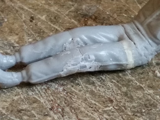

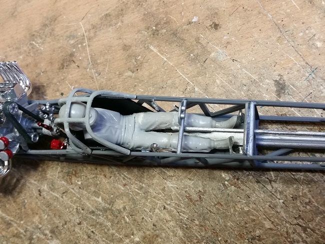

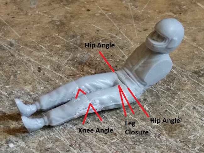

THE DRIVER:
The most troublesome one as he was designed for something like a "Rally Car". Sat more upright, hence hips and knees much more angled, plus his legs were to far apart to fit in the vehicle so re-angled one of his legs to bring them closer together.
Pic 3 shows the cuts made in the poor fellowDrool
Pic 4 shows how he looks close up. Still some fine work to do before the paint work starts.
Pic 5 A pic from above with the driver in his seat. Had to carefully remove the steering wheel/handles and thankfully had the foresight to not fit the roll cage. (Just placed for now).
Pic 6 Second view of the driver in place.

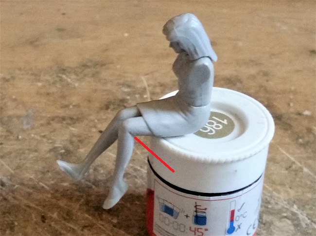

Next was one of the easier alterations. The pit girl. She will be near the burn out funny car giving the thumbs up to go for it.
Pic 9 Shows the Pit Girl and the red line indicates the knee joint that was adjusted so she stands on her right foot with the left toe on the floor.

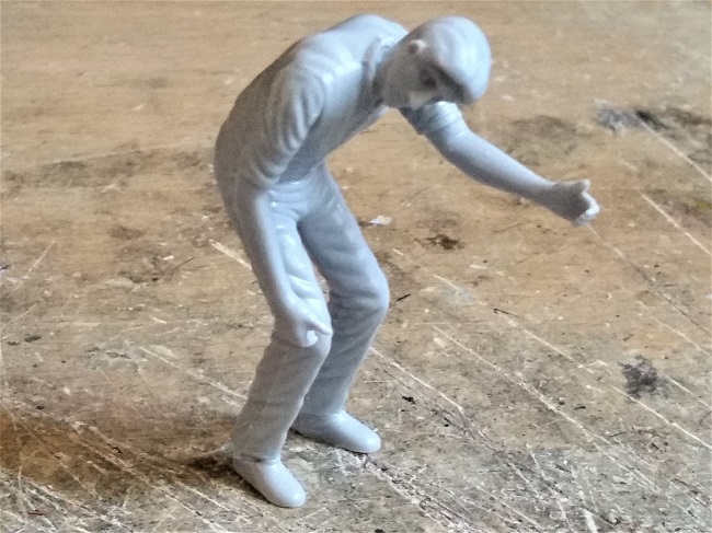

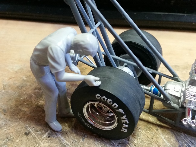

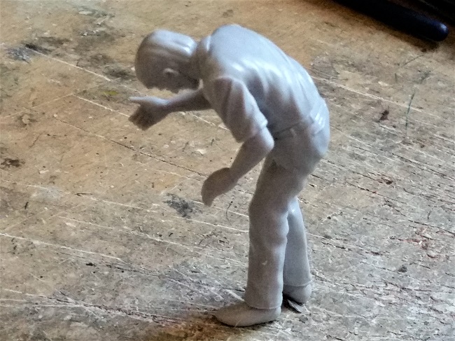

From here things got easier. Next is the "Tyre Man". He`s the one who rubs down the tyres after a burnout to get any bits off the tyre surfaces.
Pic 10 Tyre man. Only altered the angle his arms were meant to be set at so he could do his job.
Pic 11 Tyre man in place. Dirty rag to be put in his hands.

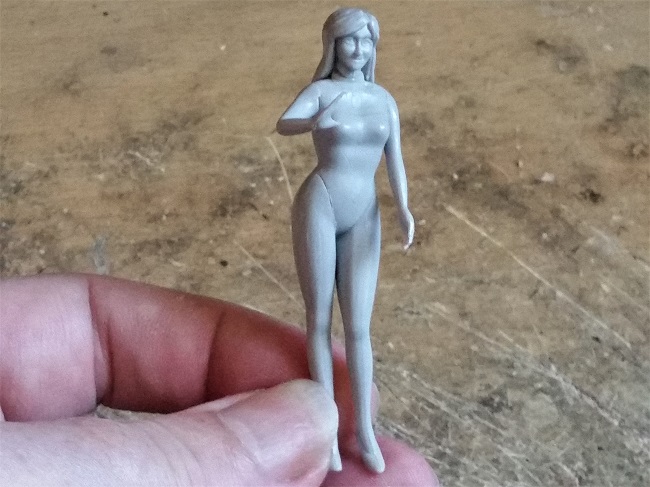

Finally "The Promo Lady". No alterations needed here. She doesn`t stand well (must be the high heels) but will when stuck to the dio. By the way she is wearing a swimming costume.Blink Blink
Pic 12 The Promo Lady.
To speed up the surgery of the figures I cut all at once, filled all where needed and left to set.

Where did you get the girl figure?
It's almost funny, but her face really looks like my best friends wife!LOL LOL LOL
