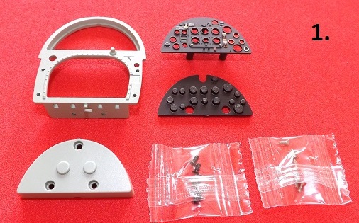

ISSUE 19 – COCKPIT INSTRUMENTS AND CONTROLS
PARTS CHECKLIST – PICTURES 1 through 4
19-01 Cockpit Frame
19-02 Cockpit Control Panel
19-03 Cockpit Control Panel Instruments
19-04 Back of Cockpit Control Panel
19-05 Six KB 1.6 x 4mm screw
19-06 Five KM 1.6 x 4mm screw

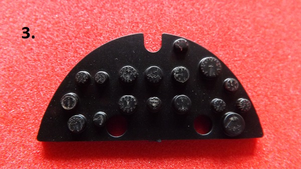

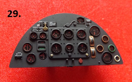

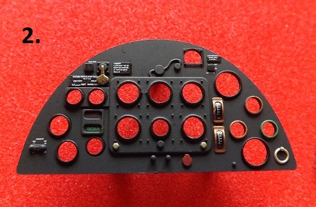

Pictures 2 & 3 show the control panel in a little bit more detail – it is very well done.

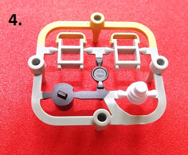

We also need frame 18-05 (Picture 4) from stage 18 of the build.

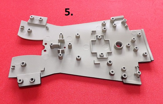

PICTURES 5 & 6

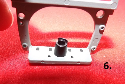

We take part J from the fret and this is super glued into place on the cockpit frame (part 19-01)

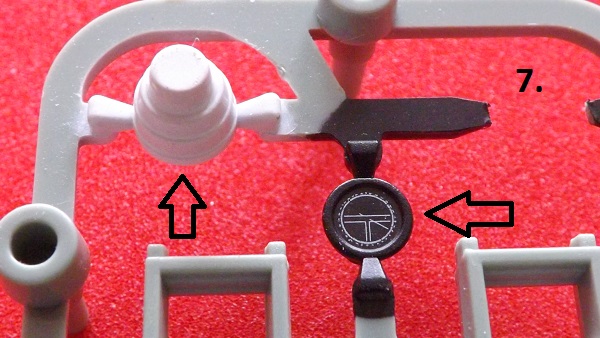

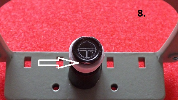

PICTURES 7 & 8
These additional parts are removed from the fret and again glued in place making up a stake of the 3 component parts.
In Picture 8 I have arrowed an area that could do with a paint touch up but to be fair once in place you are never going to see this anyhow.

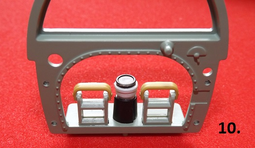

PICTURES 9 & 10

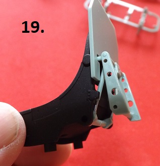

Next up are the rudder pedals and these again are just glued into place on the Cockpit Frame.

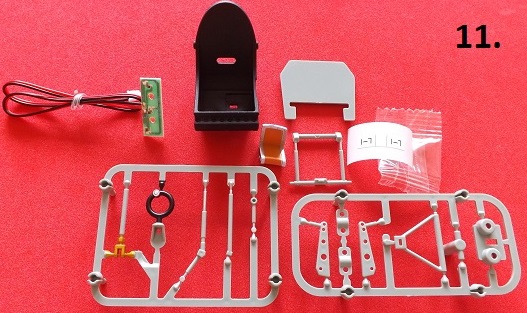

PARTS CHECKLIST – PICTURE 11
20-01 Cockpit LED circuit board and cable
20-02 Pilots Seat
20-03 Back Support for pilots’ seat
20-04 Cockpit Details A - F
20-05 Pilots Seat Frame
20-06 Cockpit Details G - K
20-07 Seat Edging
20-08 Cable Label
20-09 Three KB 1.6 x 5mm screws (1 spare)

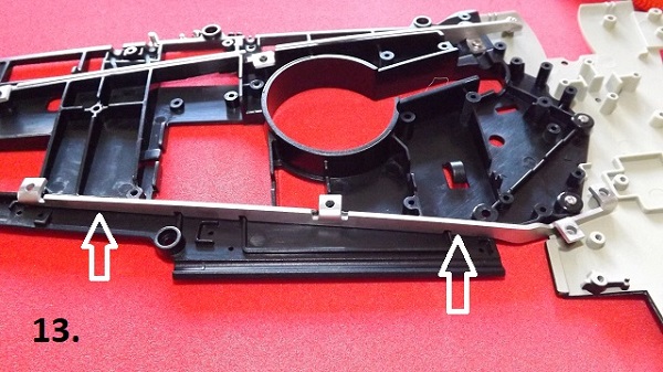

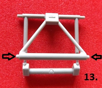

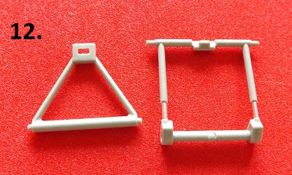

PICTURE 12 & 13
Happy with this stage as its plastic which means I can discard the superglue and use my Tamiya extra thin.
We start here making the seat frame.
Its important when cutting these from the fret that (as in Picture 13) we leave the arrowed pegs in place (it would be easy to cut these off by mistake)

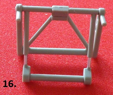

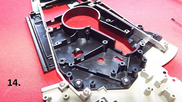

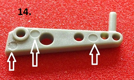

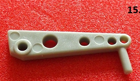

PICTURES 14, 15, 16
We then take the 2 frame support sides and these are glued into place.
In picture 14 (arrowed) its worth noting the ejector pin marks from the moulding process but once these parts are in place these are not easily seen so onwards and upwards as they say.

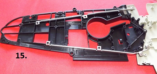

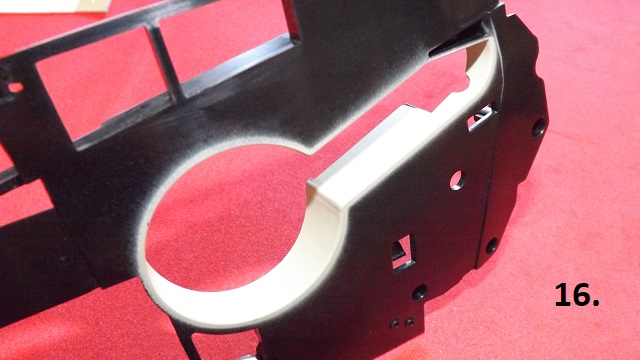

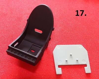

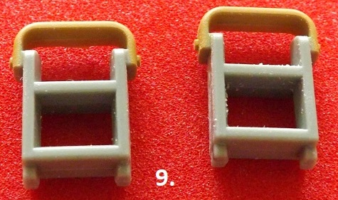

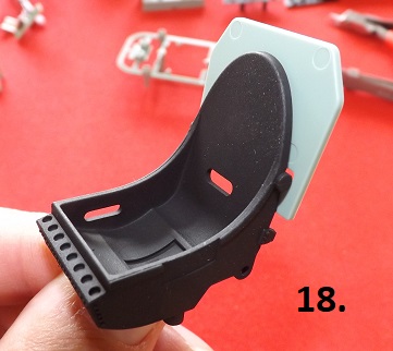

PICTURES 17 & 18
We then take the seat and the seat back support (part 20-03) and glue these 2 sections together.
There are three holes on the seat back and 3 matching pins on the seat back support that have to be lined up.

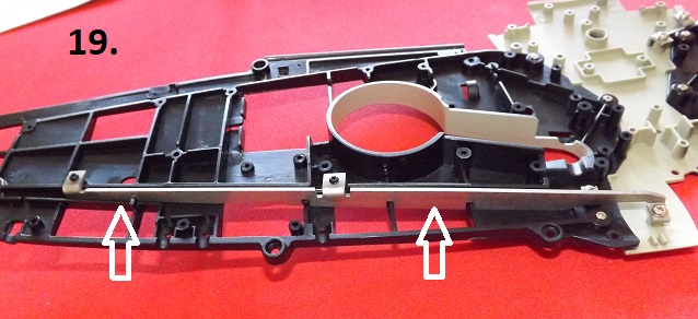

PICTURE 19
When complete we then glue in place the seat support framework that we previously assembled.

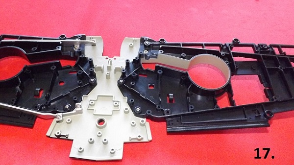

PICTURES 20 & 21
We then take the seat framework support struct (smaller of the 2 items shown in picture 20) plus the longer strut and lever and again these are glued into place on the seat assembly.

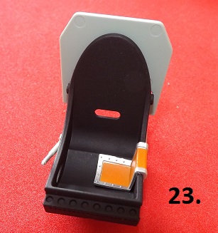

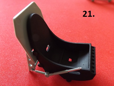

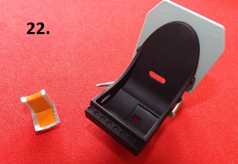

PICTURES 22 & 23
This is an interesting part as its described in the instructions as “Seat Edging part 20-07).
Its not something I am familiar with so will have to look through some reference to see just exactly what this is.
Anyhow this parts clips over the side of the seat and is held in place with a dot of superglue.

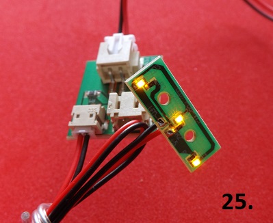

PICTURES 24 & 25

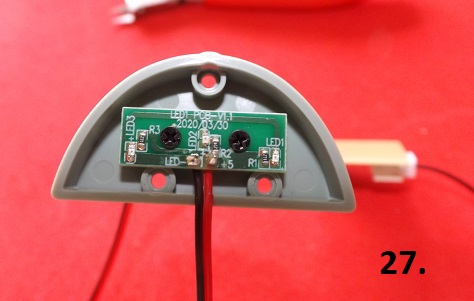

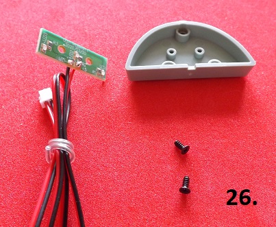

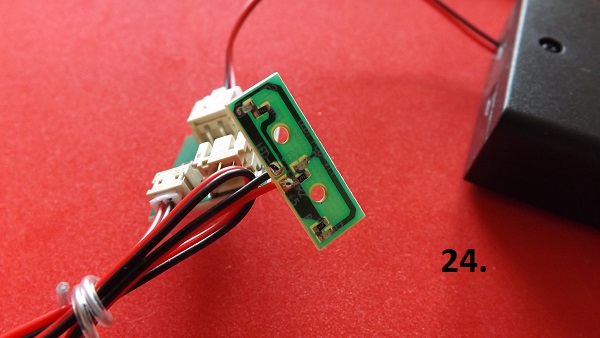

We get a tiny circuit board with this stage that will be used to back light the control panel.
The instructions would have you assemble the whole thing before testing it works.
Much better I think to test it works before putting everything together.
The board has 3 tiny surface mounted yellow leds and as can be seen in picture 25 they all light up when connected through the previously suppled test board and battery box.
PICTURES 26 & 27
So, we start by taking our working led board and the instrument panel back.

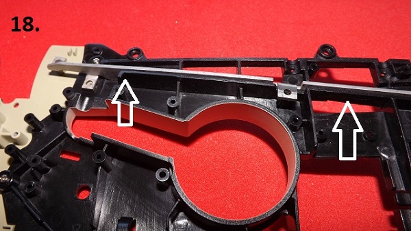

The board is screwed into place TAKING EXTREME CARE as we do not want to put ant flex into the board which has a potential to dislodge the surface mounted components.

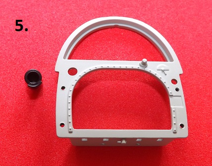

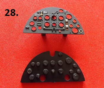

The instrument panel itself is made up of 2 parts. The rear, clear, section that has the instrument dials printed on and a front panel.
There are 2 holes on the clear part that the 2 pegs on the console press into.
PICTURE 30
The front instrument panel is then pressed into the cockpit frame and the led board and backing piece screwed on to hold everything in place.

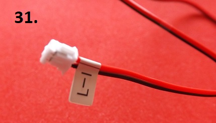

PICTURE 31
We finish the instrument console by attaching the lead identification sticker as you can see here.

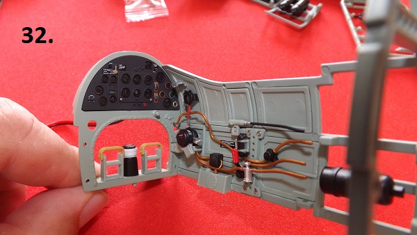

PICTURE 32
The instrument panel assembly is then secured using 2 screws to the side of the cockpit.
PICTURE 33

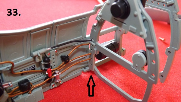

We are then told to “test fit” the head rest bulkhead to ensure it fits correctly.
The 4 cable ends I have arrowed will fit into the holes in the side of this bulkhead once it’s all in place.

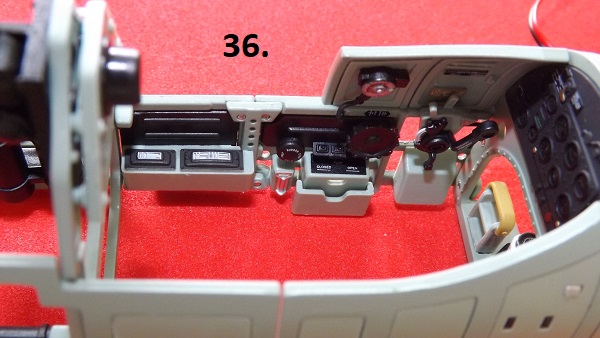

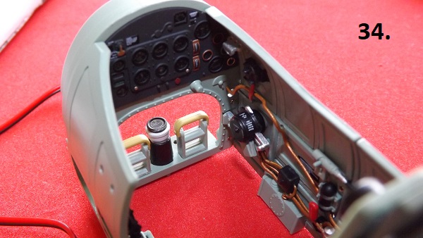

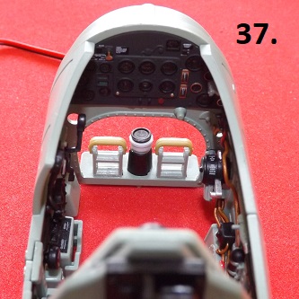

PICTURES 34 Through 37

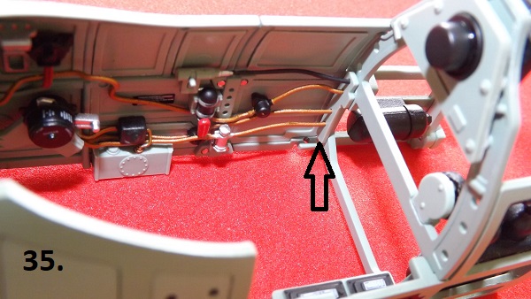

So now we bring both sides of the cockpit framing together, at the same time as sandwiching in the headrest bulkhead (this sits tight in the space allocated without the need for any glue)
In picture 35 you can see how those 4 cable ends are tidied away in the holes in the headrest bulkhead.
In picture 37 you can see that dial between the rudder pedals and hopefully you can see from my earlier comments that a little paint removal when getting the parts off the fret is never going to be seen.

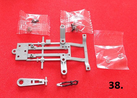

ISSUE 21 – CONTROL COLUMN AND FLOOR OF COCKPIT
PARTS CHECKLIST – PICTURE 38
21-01 Cockpit Floor Frame
21-02 Control Column
21-03 Pneumatic Hoses
21-04 Three KB 1.7 x 4mm screws (1 spare)
21-05 Five KM 1.6 x 3mm screws (1 spare)
21-06 Seven KM 1.6 x 4mm screws (1 spare)
21-07 Two PWB 1.7 x 3mm screws (1 spare)
21-08 Two M2 washers (1 spare)
Worth mentioning here is the fact the screws are packed with 2 different styles in each bag so you need to identify what you have received BEFORE you start breaking open bags as it will get very complicated for you.

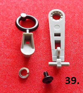

PICTURES 39 & 40

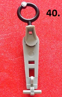

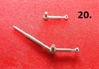

We start by making the control Column.
What is really interesting here is the fact they have designed this so the round handle with the fire button can be rotated to the left or right as on the full-size aircraft.
A detail I am not sure we would ever use, or even know existed if you are a viewer rather than the builder but an interesting aspect to the model.

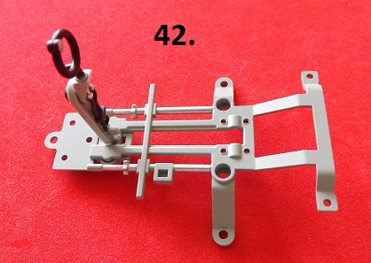

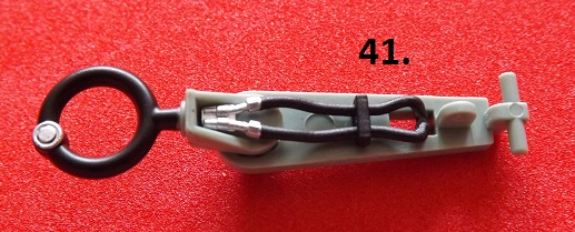

PICTURE 41
Once the control column is complete, we add the pneumatic hoses. “Sadly” choice of glue here has to be superglue.
PICTURE 42
The control Column is then threaded through the cockpit floor and secured from underneath with a plastic bracket and 2 screws.

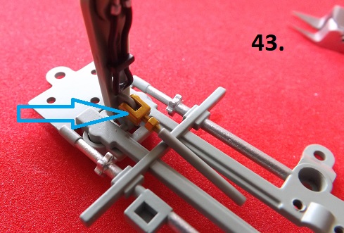

We then have a Piston, referred too in the instructions as a “Lever” that is press fitted over the base of the control column.
The instructions call for great care and that is justified.
The piston/lever has a “U” shaped end with 2 pins that have to locate in the 2 holes in the control column.
If you look at the arrow in my PICTURE 43 you can see the area between the piston “U” shape and the actual rod connected to it is very, very thin.
Apply too much pressure and you are guaranteed to snap this part (and I can imagine many builders will).

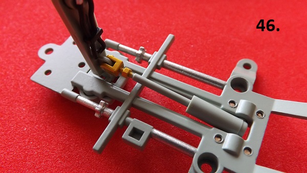

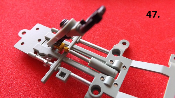

PICTURES 44 Through 47
We then take the piston housing (pic 44) and this is located in the cockpit floor (pic 45) and secured in place using the 2 brackets (pic 44) and screws.
Pictures 46 and 47 show how this completed assembly looks and works. You get the option to pull back on the control column but worth noting is the fact this does not appear to have any connection to the control surfaces still to arrive.
So again, a nice detail but maybe something you are not going to “Play” with that often.

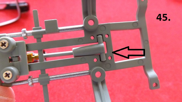

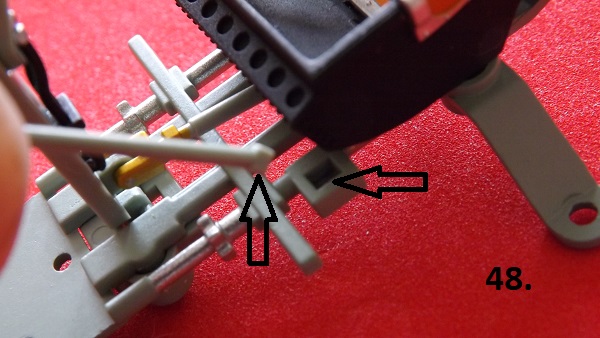

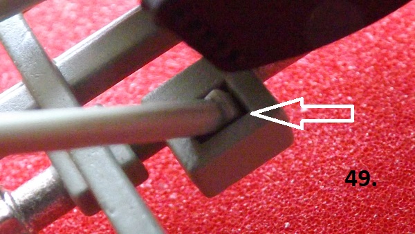

PICTURES 48 & 49
We now have to glue a “lever” into this slot and it’s the first area of the build where I have found the parts do not match very well.
In this case the square on the end of the lever is much smaller that the socket it has to be glued into so you end you with a lot of movement of the lever and it could end up glued in a multitude of positions.
Its one area to watch for as you glue this into place.

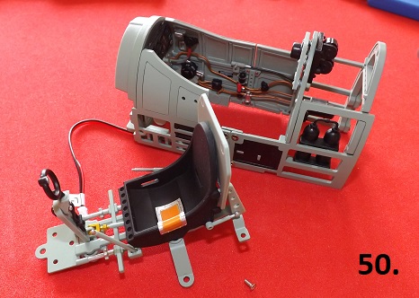

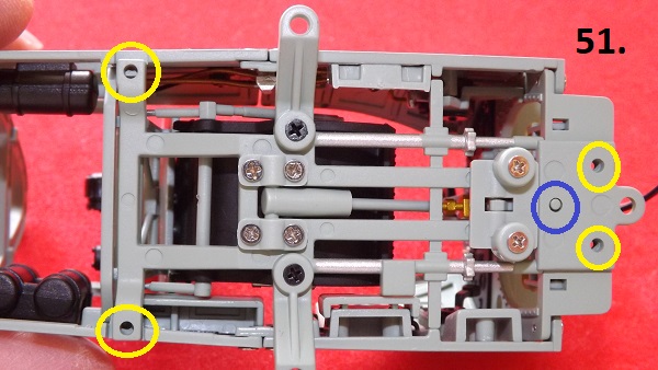

At this point we are told to join the previously assembled cockpit to the cockpit floor.
In picture 51 you can see the 4 holes that will be used to screw the 2 parts together (yellow circles). The cockpit floor is a very positive fit as it locates over a peg, circled in Blue.

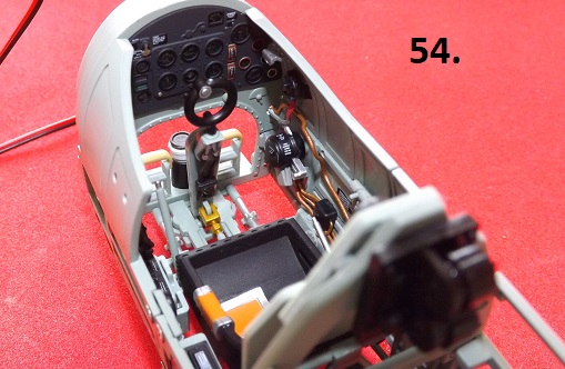

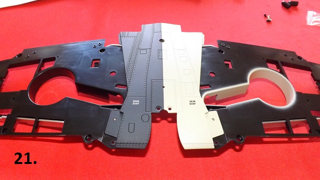

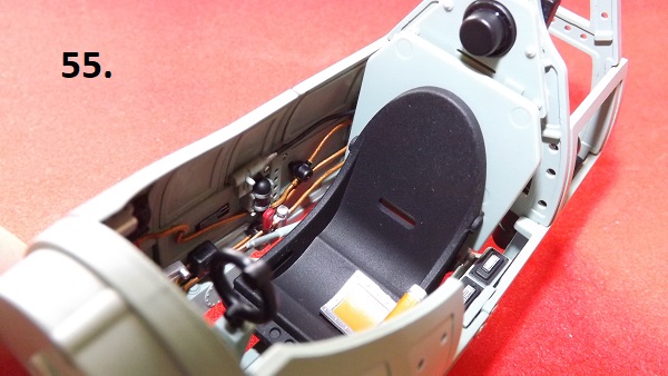

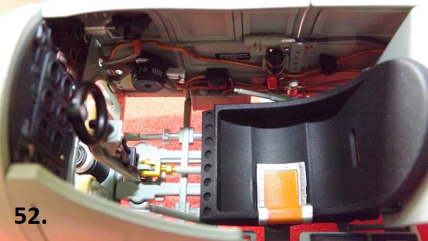

PICTURES 52 through 57

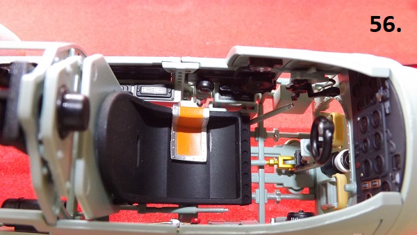

These are just some general pictures of how the completed cockpit section looks.
Pic 57 not really shown up very well on camera but it was an attempt at showing the instrument panel illuminated.

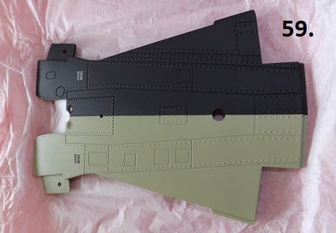

ISSUE 22 – FUSELAGE PANEL TO FIT BENEATH THE COCKPIT

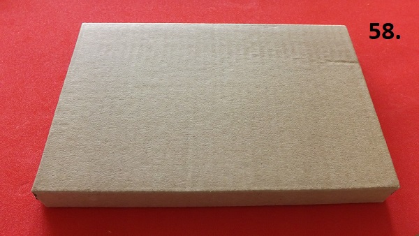

PARTS CHECKLIST – PICTURE 58 & 59
22-01 Fuselage
This is an interesting part as it arrives securely packed in its own little card box and is wrapped in tissue paper.
It’s a metal part and quite weighty.

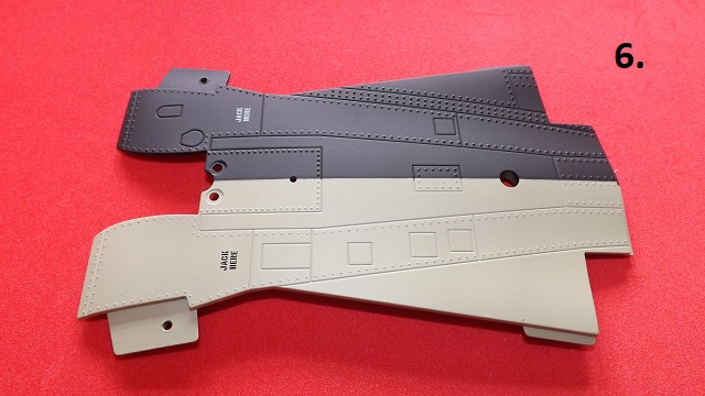

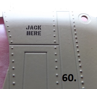

PICTURE 60
Good to see the aircraft markings (larger this time) as still being done very well indeed.

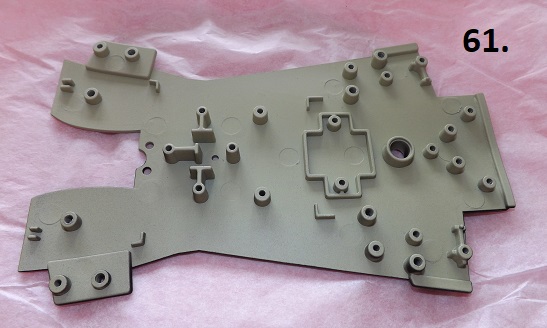

PICTURE 61
And this is what the top surface of the part looks like. Its going to have a whole lot of connections made to it looking at the fixing points.

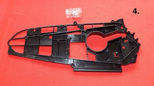

ISSUE 23 – FIRST PARTS FOR THE PORT WING
PARTS CHECKLIST – PICTURES 2 through 4
23-01 Frame for the underside of the Port Wing
23-02 Four 2 x 4mm PM screws (1 spare)
Worth noting is just how well the parts are packed this month. Card box with the part inside sealed in a bubble wrap bag.

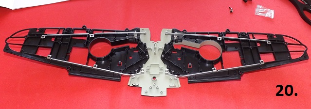

PICTURES 5 & 6
We also need frame 22-01 from stage 22 of the build.

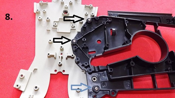

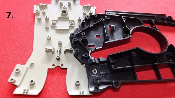

PICTURES 7 & 8
All we need to do is line up the 3 main fixing holes in the wing section with the matching holes on the wing centre frame.
As you can see there is no shortage of fixing points so it will be interesting as things progress to see these starting to fill up with various sections.

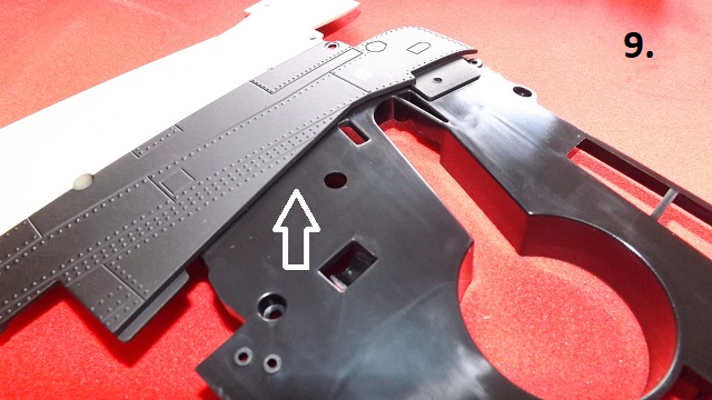

PICTURE 9
Turning the completed assembly over we can see (arrowed) the step left between the wing centre sections and the wing frame that will later be covered with the final “skin”.

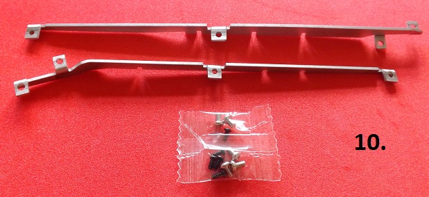

ISSUE 24 – BRACING STRUTS FOR THE PORT WING
PARTS CHECKLIST – PICTURE 10
24-01 STRUT FOR THE PORT WING
24-02 STRUT FOR THE PORT WING
24-03 FIVE 2.5 x 4mm PM screws (SILVER, 1 spare)
24-04 FIVE 2 x 4mm PB screws (BLACK, 1 spare)

We start by placing the first of the wing struts in place. Pleased that this (and the other sections) have been very well made and just drop into place.
PICTURE 12
We fix the strut into place using 2 of the silver and 2 of the black screws from those included with this issue.
