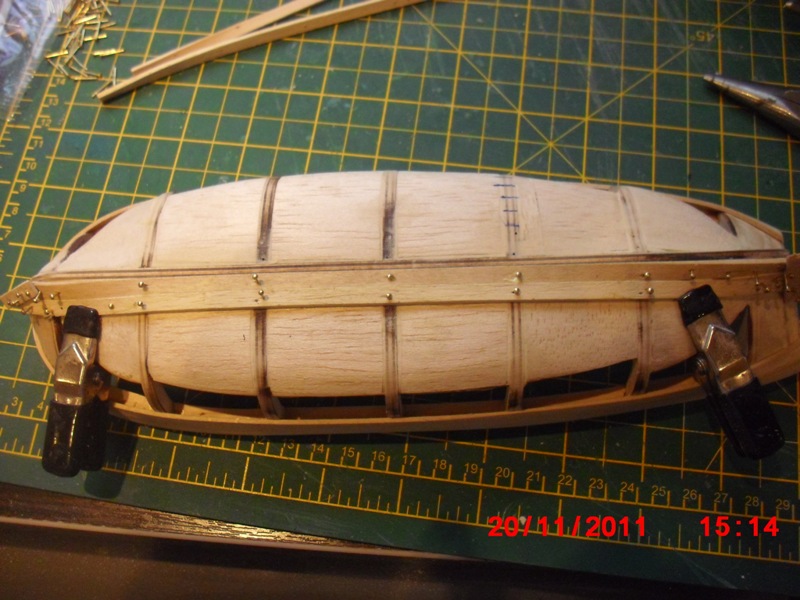

ISSUE ONE PLANKING
I numbered the planks and fitted in place with adhesive Starboard 1 and 2.
You will see the stealer fitted to the keel and two wooden supports made from offcuts of planking these give support to the bow and Keel:-

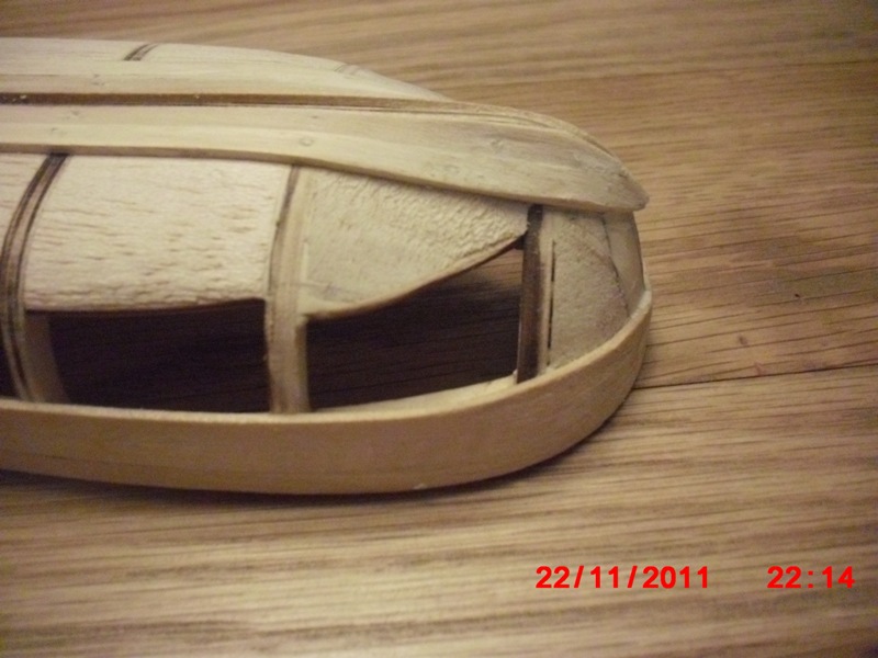

ISSUE ONE PLANKING
I have not been to critical with the ends of the planking in this proccess (you will see some splits on the ends) it is being double planked, on the second planking I will take alot more careBlushing Here are the last photos on this session questions and comments welcome:-

Hi MWG,
I found that bows were the difficult part of the planking, but the second layer hid up any defects in the first.
I fitted all the small pieces afterwards, I could wedge them in tight and they would stay in without any nails.
Plenty of soaking and using a soldering iron was my method.
(my ends split as well).
cheers Peter

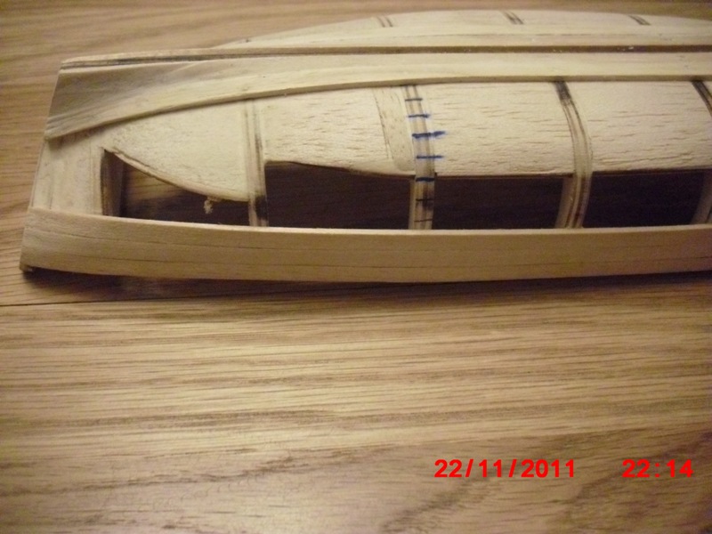

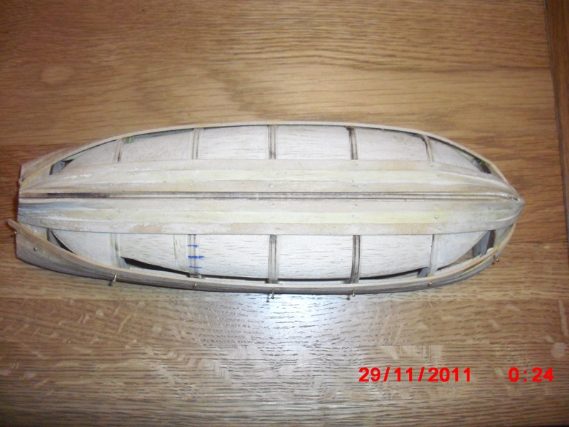

ISSUE ONE PLANKING
The 4 planks are fitted on the base of the Hull, and partly sanded:-
#69 Posted : 22 November 2011 22:23:19
The next job is to do it all over again.
The next time you see photos the Hull will be single planked.
Questions and comments weicomeBigGrin Cool

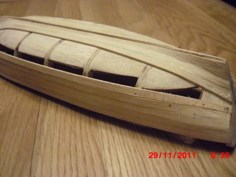

#70 Posted : 29 November 2011 00:34:15
ISSUE ONE PLANKING
Still at it, thought you might like to see progress photos:-

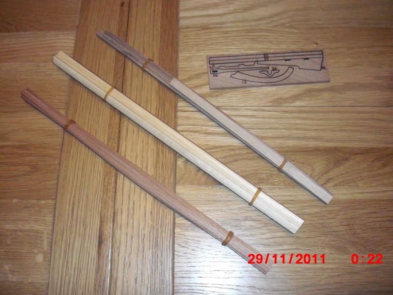

#71 Posted : 29 November 2011 00:38:53
ISSUE TWO
I received the second of three Issues today, I am very impressed with the quality of the wood (all different kinds and colours):-

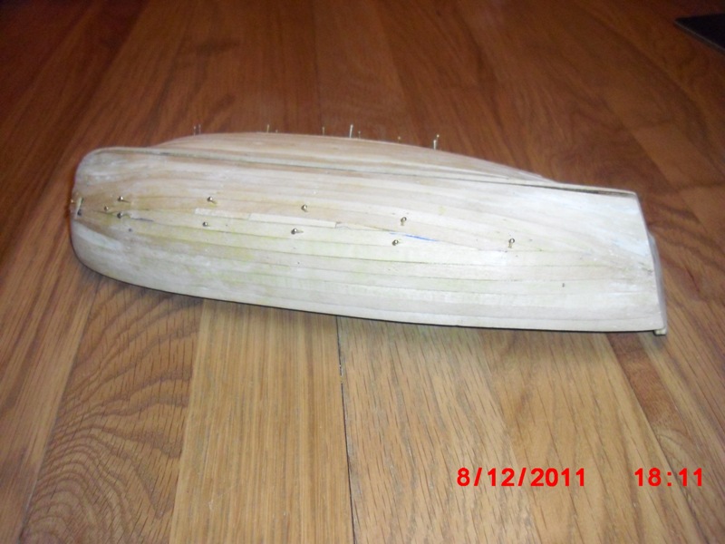

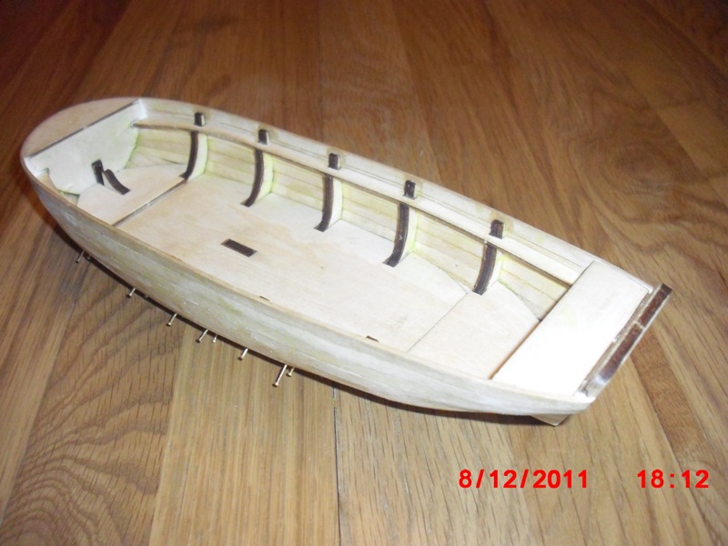

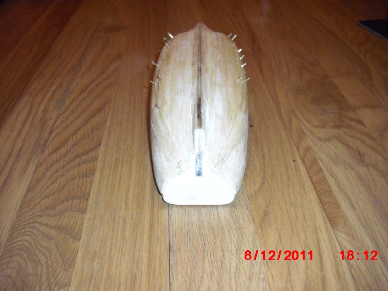

ISSUE 1 PLANKING
Hi Team I have finished the first planking, I thought you would like to see the photos before I remove the final trenails and sand the HullBigGrin Comments welcomeBigGrin

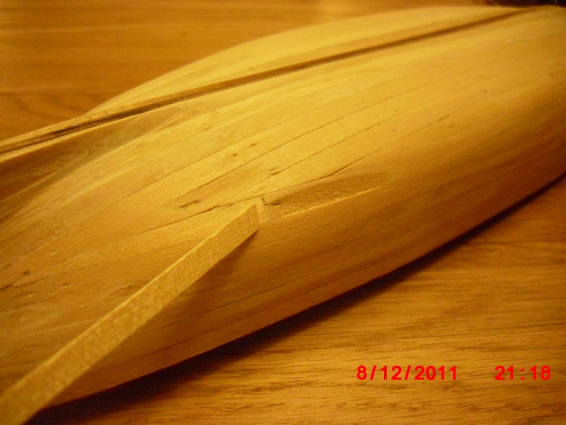

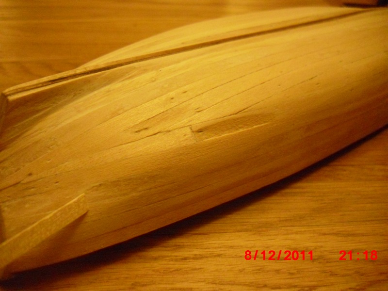

#78 Posted : 08 December 2011 22:16:29
ISSUE 1 PLANKING
I have started to sand the Hull and found some undulations:-

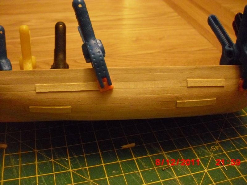

#79 Posted : 08 December 2011 22:23:22
ISSUE 1 PLANKING
So what I useuly do in a situation like this is fit a piece of planking over the undulation, as this model is double planked its not too serious,if it is a single planked model like the Victory I would take more care, but having said that it can sometimes look like a repair on the model and look authentic.
All the pieces you see in the photos have to be sanded when dryBigGrin

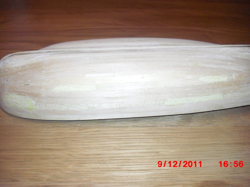

ISSUE 1
Well Team the repairs have been made and the sanding is finished:-
