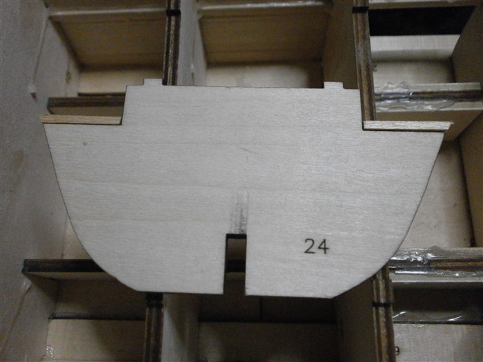

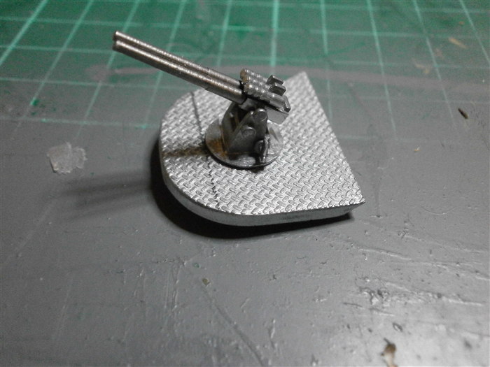

pack 5 arived over the xmass new year period, heres the progress so far but 1st u get a tool pouch in this issueBlink. dont you just love instructions in japaneseCool Crying Blink

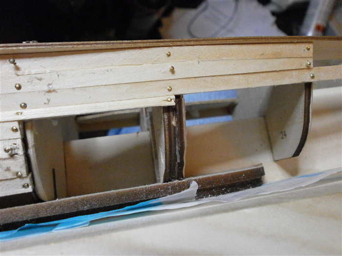

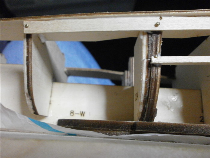

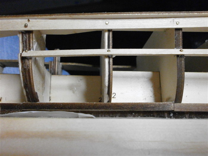

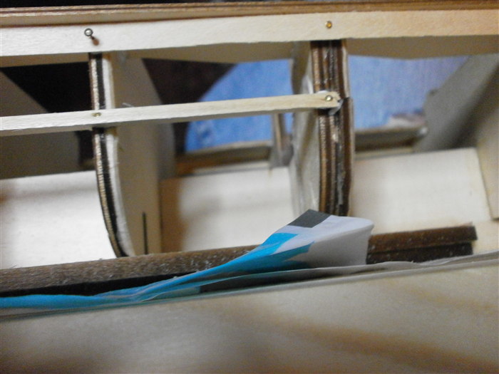

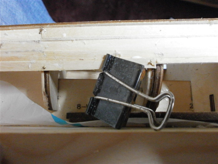

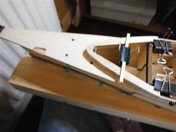

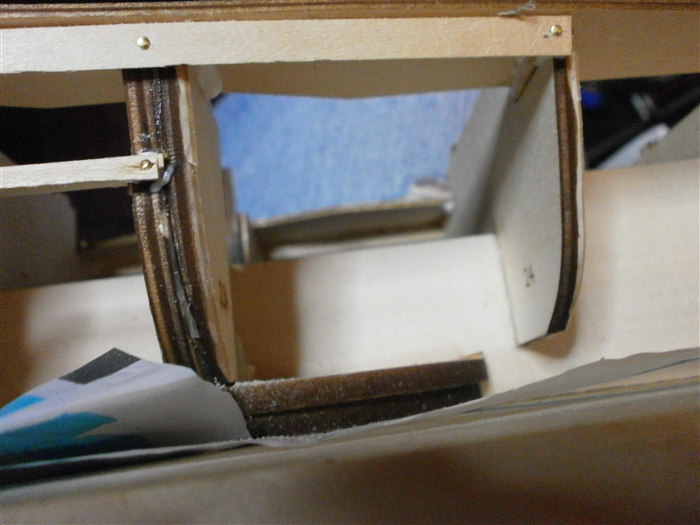

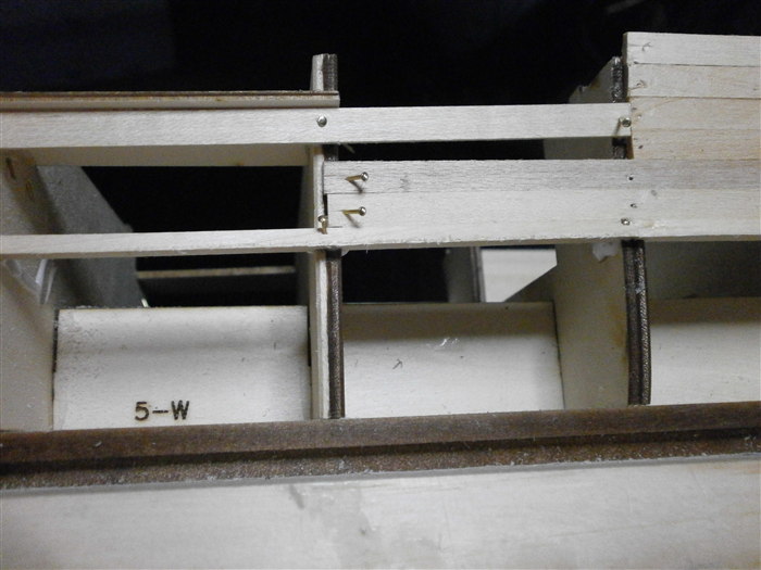

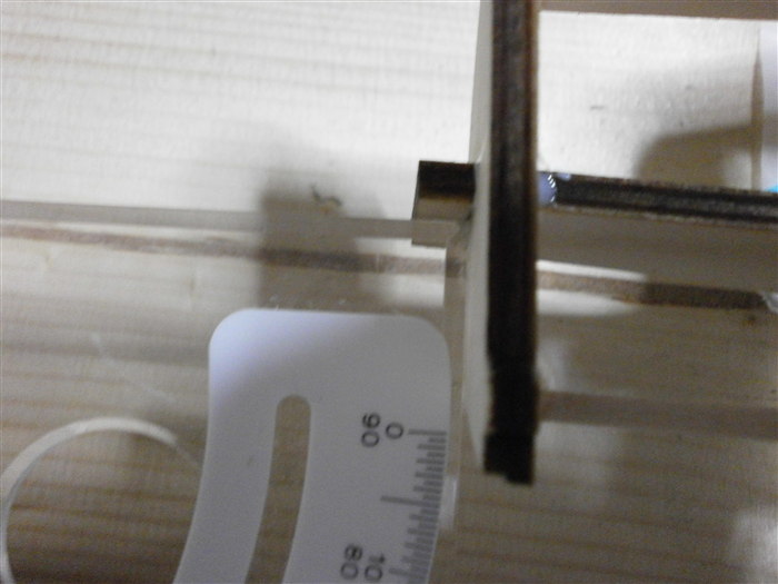

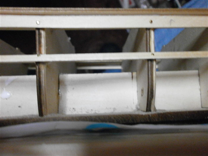

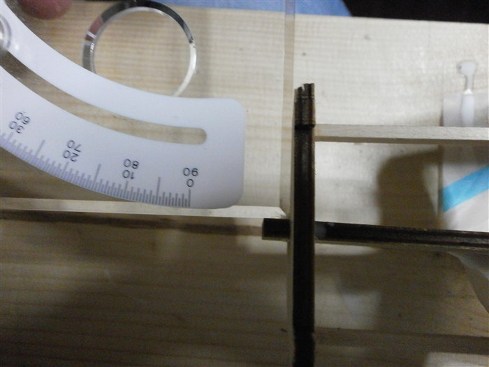

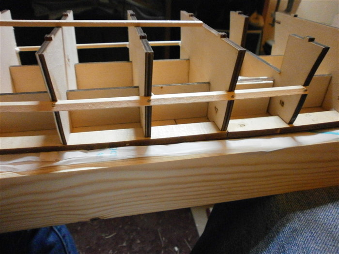

BigGrin Now for tha adding of the bow and the construction of the bow formers on the ply deck provided. I used the deck plate as a guide to get the bow in the correct position.
Now i have a question about the instructions on the fitting of the bow deck. If you follow the instructions to get a straight line /edge on the hull planking from former 9 to 12 you are left with frames 10 and 11 that are below the line of the hull planking. My question is this ok or do you follow the line of the formers here, im thinking of when we come to glue this in position there will be a floating deck in this area [ only glued to the hull planking] and the adding of the forward flight deck supports in future.I might add fillets/spacers to this area but any comments on this would be welcome

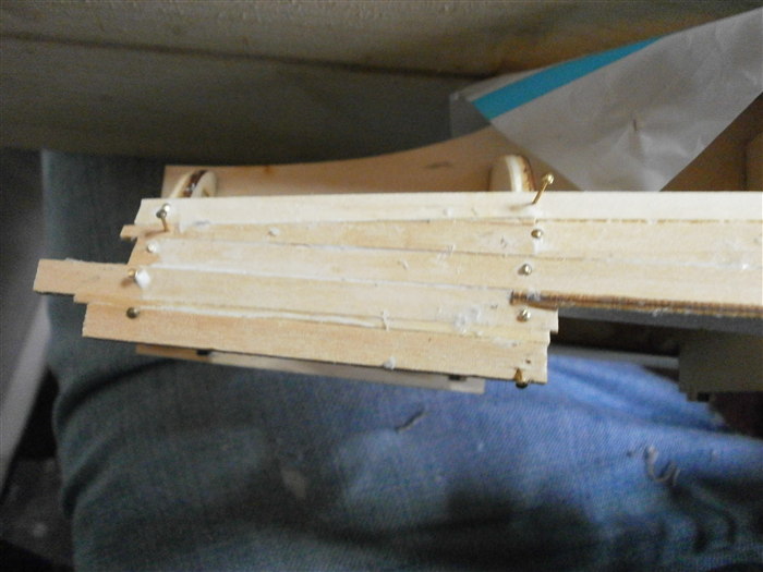

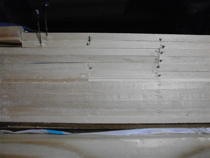

#65 Posted : 05 January 2012 19:21:16

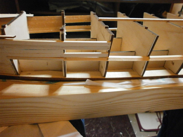

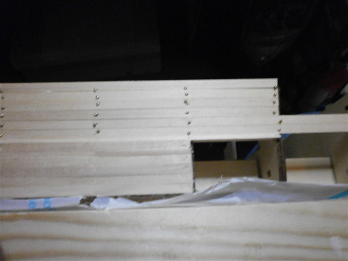

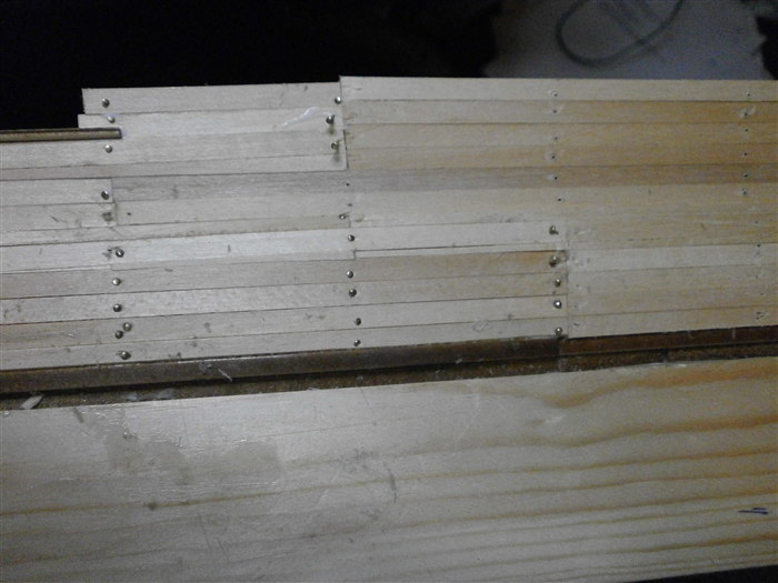

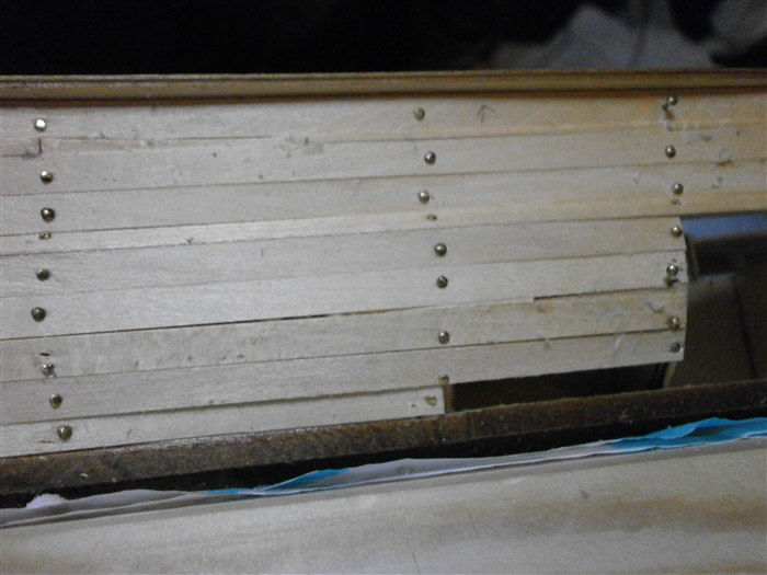

BigGrin Lower hull planking added
#66 Posted : 05 January 2012 19:24:00

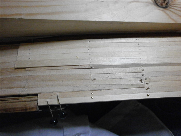

Now for the upper planking in the same area 'note this has been done on both sides'deviated a little from the official build so i had less gaps to fill and the plank next to the deck area has a higher profile than the 1mm asked for,just the metal parts supplied to do now pics will be added later, as always comments are apreciated

BigGrin Thanks Jase and Mike Blink no thoughts on the bow area query yet then ?Mellow

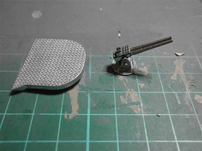

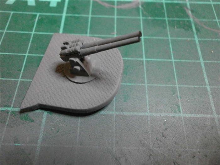

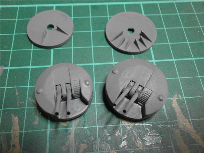

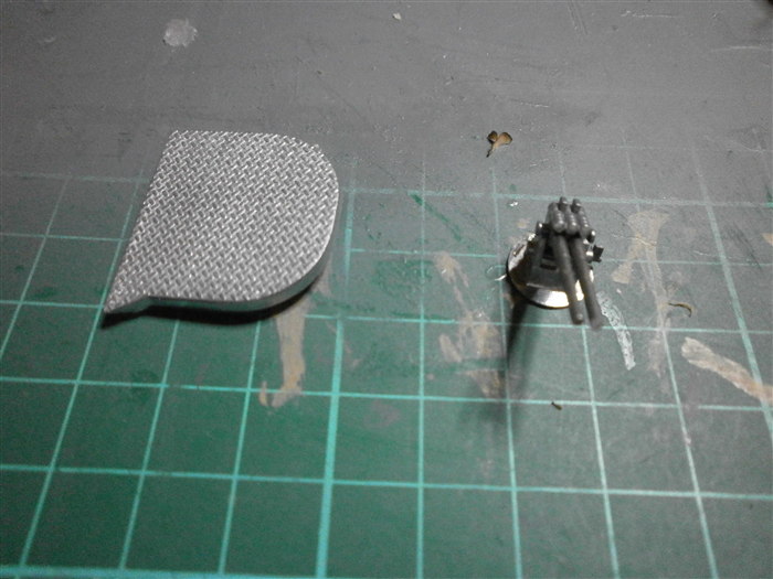

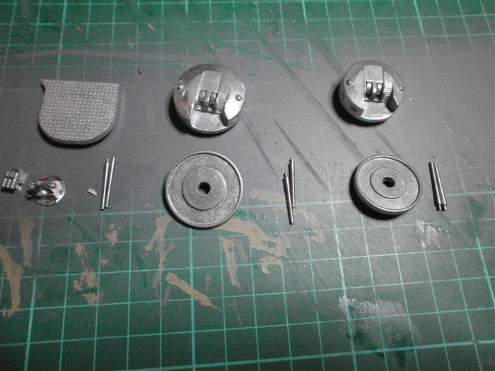

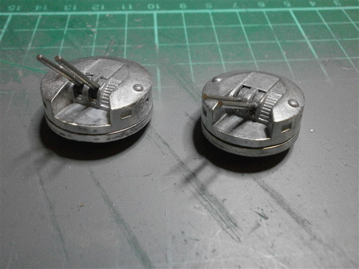

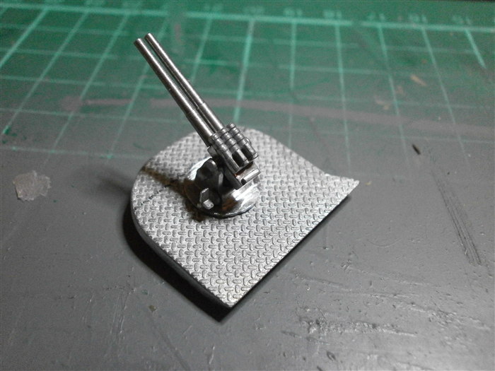

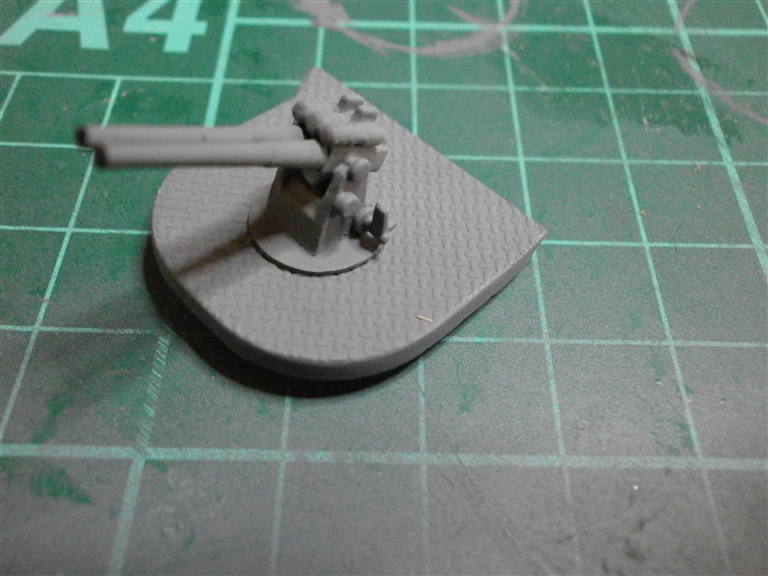

BigGrin Last update for this months parts, all the metal bits are now prepared and painted just the aircraft to prepare[filing of the burrs ect].All comments are welcome as ussual

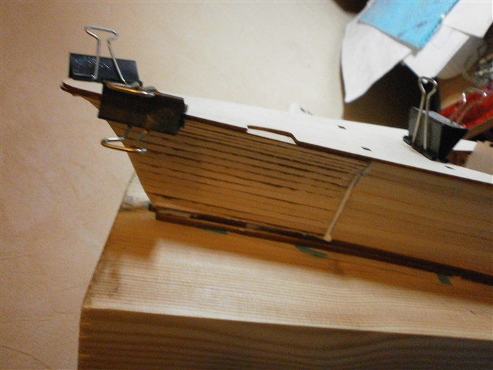

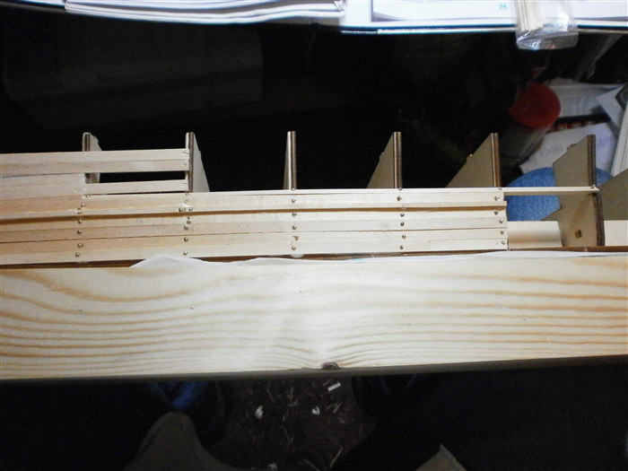

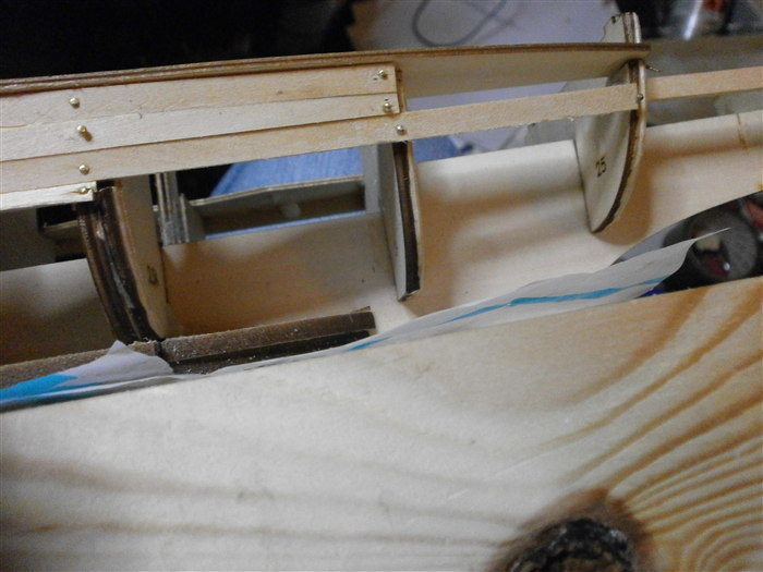

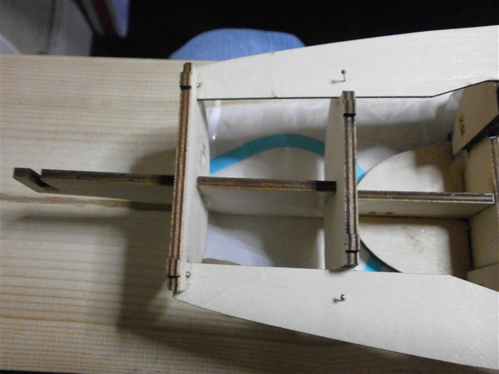

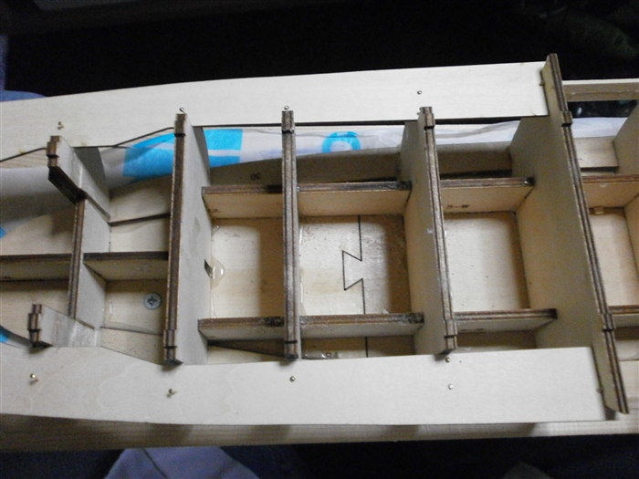

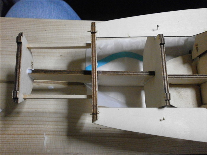

pack 6 arrived so carried on with the rear planking,Had to add packing strips aka Mr T,i deviated a little here as i had a good idea the stern former was warped. To fix this i made sure the 2 deck parts were exactlly the same length then glued theses in position,after that i cut 2 scrap pieces of wood to the correct length to brace the last former.As ussual all comments are welcome
#72 Posted : 25 January 2012 20:17:27

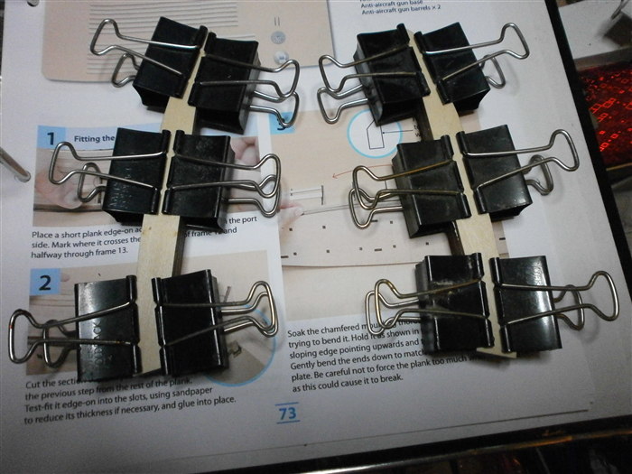

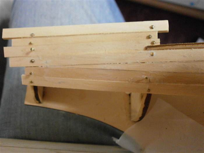

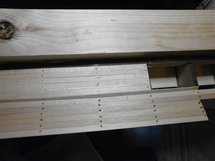

BigGrin Now for the rest i added the plank to below the deck then attached the pre shaped planking to the slots provided
#73 Posted : 25 January 2012 20:22:50
BigGrin I then proceeded to use the short strakes to fill in the lower hull then added the upper strakes,when this is all dry i will continue with the planking.As ussual all comments are welcome

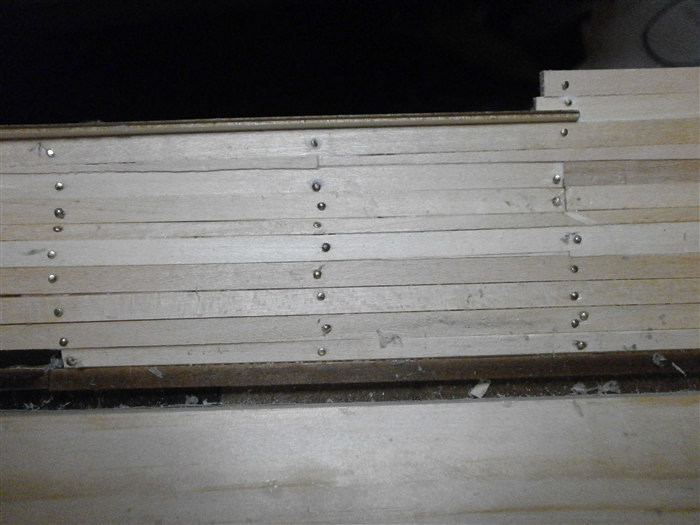

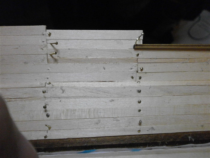

#78 Posted : 28 January 2012 13:49:05
BigGrin Hi All

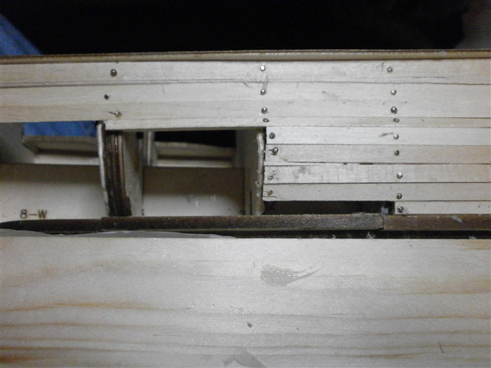

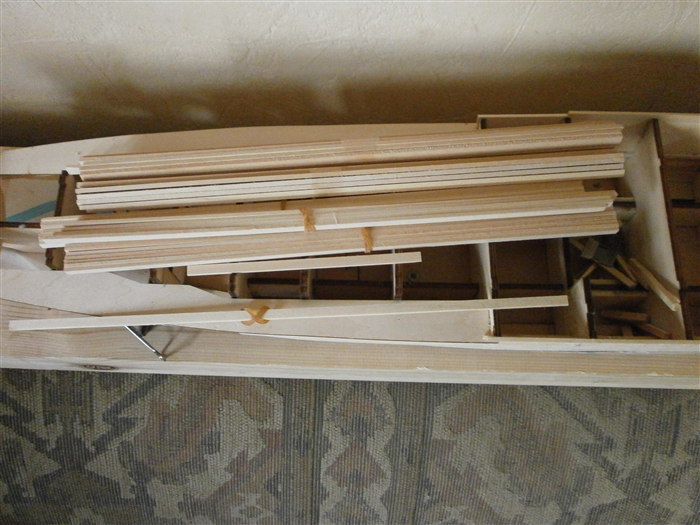

finished off the upper hull planking,once its dry il remove the hull from the dry dock and compleat the lower planking.Still have a pile of planking strips [see pics] from the Akagi and Yamato builds, the yam strips are a little wider and thicker than the akagi but i might use these around the rear of the torpedo belt armour on the lower hull.As ussual all comments are welcome
