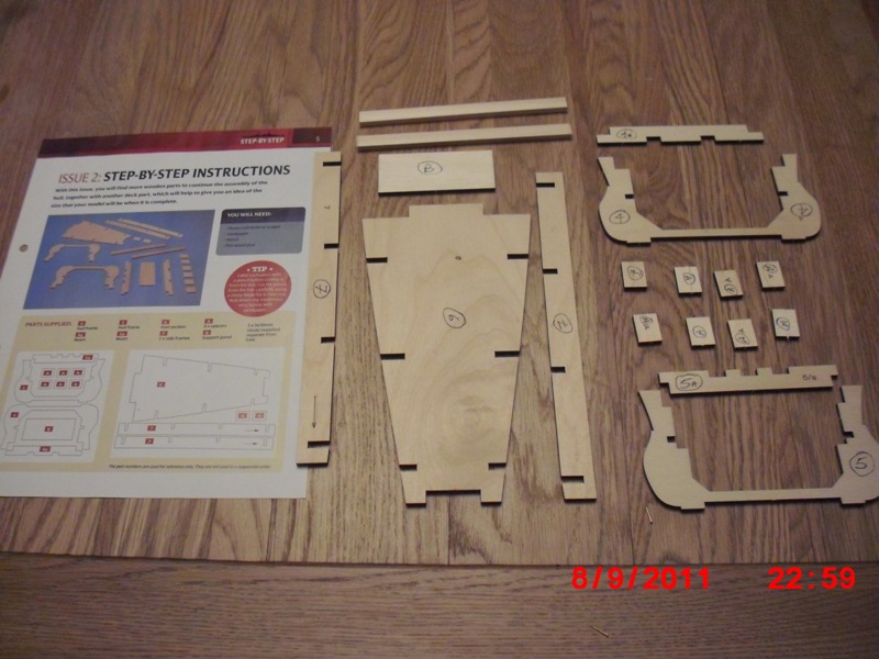

#63 Posted : 09 September 2011 00:28:03
ISSUE 2
This is what I did with the parts, I numbered them and put them away:-
#64 Posted : 09 September 2011 00:30:05
But I did put the parts of the false Keel together:-

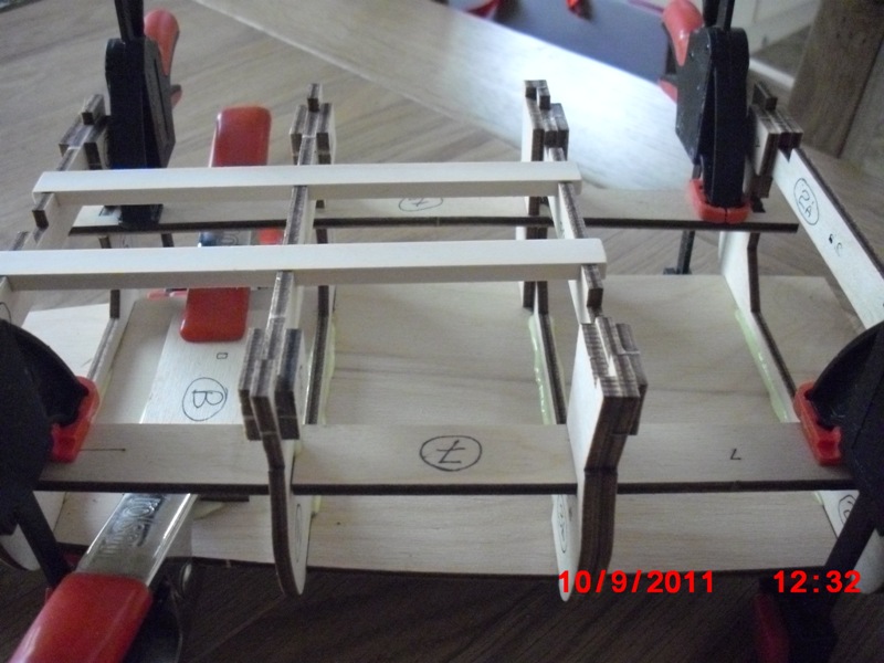

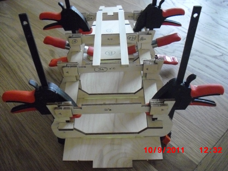

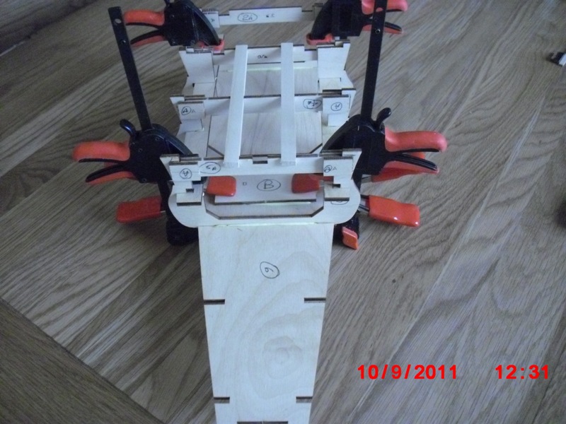

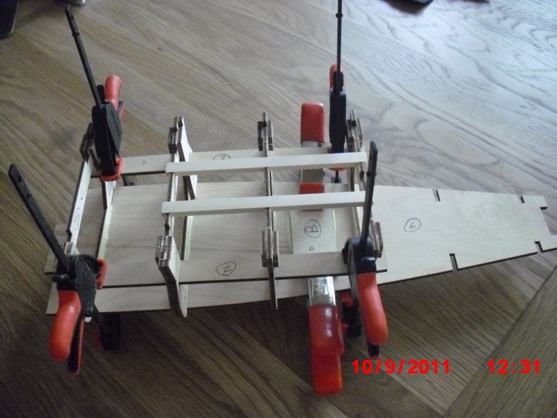

#68 Posted : 10 September 2011 13:46:05
Hi everyone,
Well I said I would not do any work on the mighty Hood untill the R/C stage.
I studied the instructions and realised the build allows for access into the Hull, so I could not resist the temtaition,so I have completed Parts 1 and 2.
I used my favourite Long bars(although these are my short bars)to form a jig to keep everything square, what do you think? :-
#69 Posted : 10 September 2011 13:49:06
Note my new large clamps holding the two parts of the Hull together :-

Mclaren MP4-23

Be very careful with clamps, if all are not equally set & pressured, you could induce a twist to the frame.
Personally would have secured the base sections to a build board and then clamp around this if need be.

oh and MWG, looking good but as Mr T pointed out watch the clamps, get it screwed to a board mate, superb stuff, I'll be doing mine after the race on sunday and updating a blog;) again!!!
#80 Posted : 10 September 2011 19:20:24
Thanks fore your comments Colin.Cool
To be fair, you know I am a big supporter of the Dry Dock system, soon after these photos were taken, this part of the build was securely screwed down on my Dry Dock base boardThumpUp Wink
