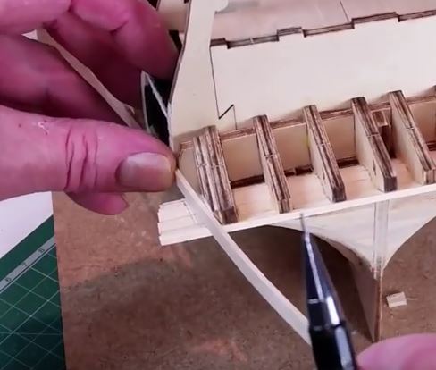

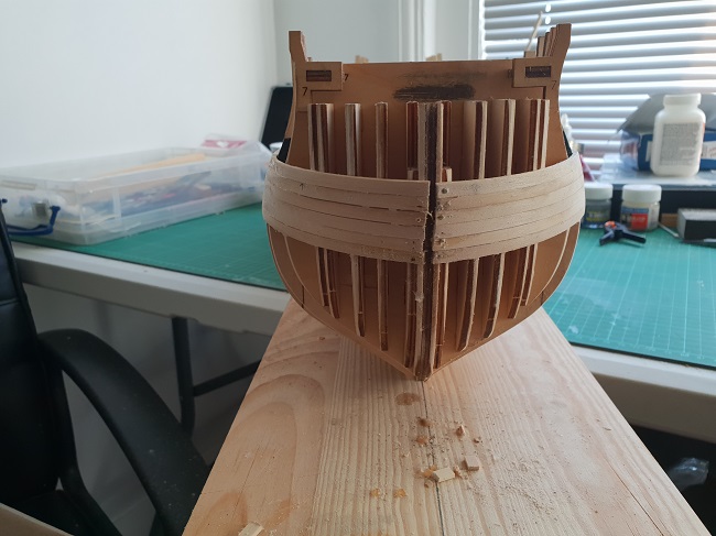

hi Alan i know you cant see from the angle of the pic but 34 are level with the false keel. i have redone the gallery planks but its hard to tell how far to trim them for the side planks to fit too, does it taper or go straight from the last rib?
#64 Posted : 11 July 2018 15:21:15
Pics below may help you here...

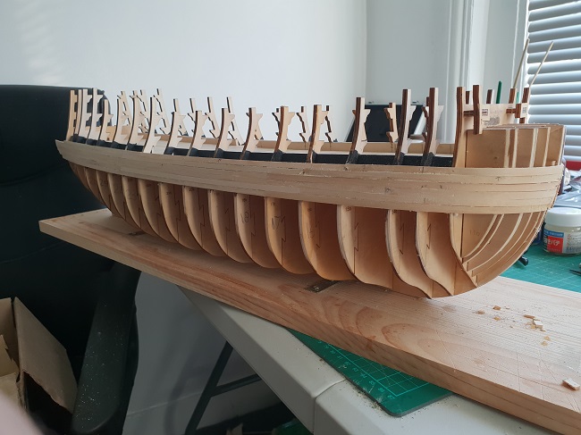

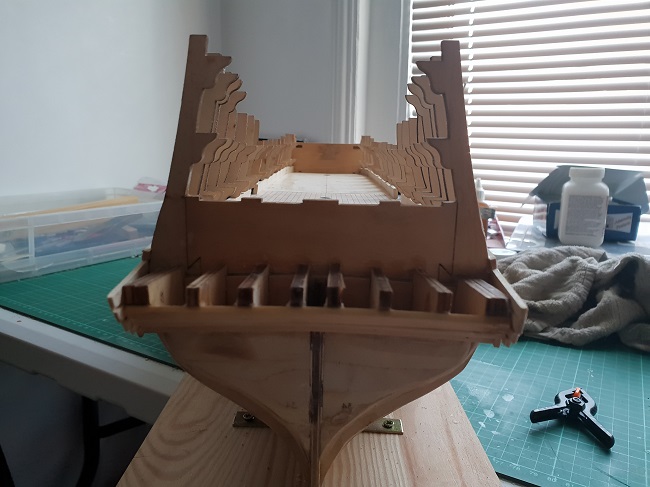

#71 Posted : 14 July 2018 18:35:51
Joined: 20/05/2018
Posts: 69
Points: 210
Location: portsmouth

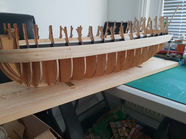

hi guys well i have just finished row 6 of planking and i think things are moving reasonably well i did put a slight gap in starb side to keep level with port side planking, as i only just noticed some planks are very slightly wider than others, so i now pair each side first, also i am a little concearned with stern gallery supports the port side was much higher than starb side even though its properly seated so i did sand it down, if i have to build it back up i can, but any input welcome anyway here are some pics.cheers
pfcdre attached the following image(s):
pfcdre

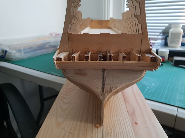

#72 Posted : 14 July 2018 19:45:00
Joined: 20/05/2018
Posts: 69
Points: 210
so i was not happy with the left end gallery support, so with the help of some hotwiter micro surgery i removed it and replaced it with a new one which sits alot better, it was annoying me and the operation was a success. i will post pics as soon as the glue has setBigGrin BigGrin

#74 Posted : 15 July 2018 10:13:53
Joined: 20/05/2018
Posts: 69
Points: 210
thankyou for the comment, i have the picture of the new gallery support on left side. hopefully im ok to continue the build now.
#75 Posted : 15 July 2018 23:03:44
From what I'm seeing I'd say it all looks good so you should continue with the next part of the build.....Cool Cool .. Will be watching....

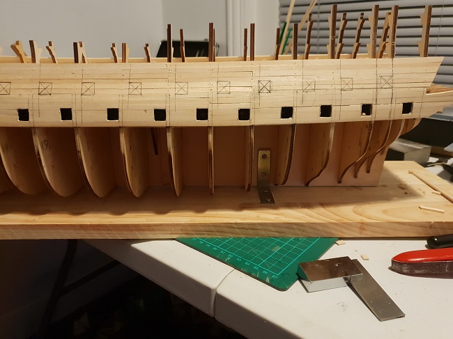

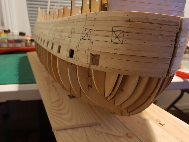

#78 Posted : 24 July 2018 00:11:07
Joined: 20/05/2018
Posts: 69
Points: 210

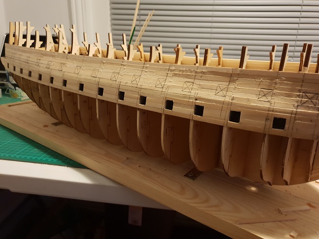

marked out 2nd row of gunports if someone could have a look at let me know i think its right but what do you guys think
#79 Posted : 24 July 2018 07:18:52
BigGrin Looks good to meCool
#80 Posted : 24 July 2018 12:02:33
Not seeing anything out of place, looks fine....Cool Cool
