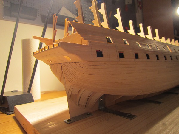

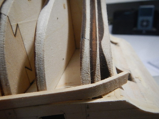

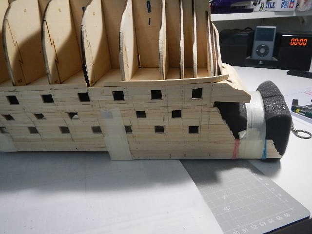

I have finished the upper planking and am starting on the bottom planking and I have two questions if I may
1) when tepering the bow planks
do I still taper the bottom edge of the plank assuming the hull is upside down
2) I have been playing around with the stern plank and I can't figure out where the first plank should end,I watched the video,I read the build log and I have read the instructions numerous times still none the wiser
Any help will be appreciated
Trevor

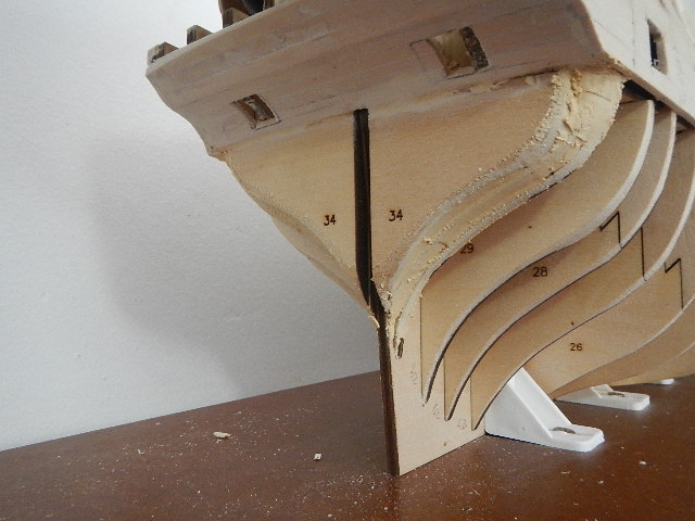

Hi Trevor, will come back to you on this however, I suggest you study the pics in the instructions, official build and video as I don't think you have faired the stern area enough. Can you post a couple of pics look straight at the stern.....Cool Cool

Hi Trevor,

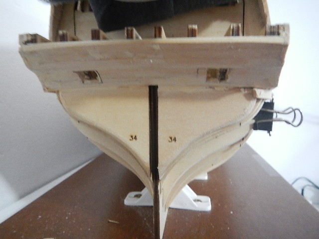

I'm not sure that's how a pro would do the first plank at the stern but see my solution on my build diary.
https://forum.model-spac...amp;m=262942#post262942
I struggled with this one too because the twist/bend and the end of the plank is basically within 7-10 mm.
I only managed to do it if the end of the plank was soaked many times in hot water to make it really soft. I also used a flat plier to twist and bend the end of the plank, while hoping that it won't split too much (because it thinned from the 2mm to nearly 0.5mm)
I think I had to re-do these particular planks couple of time because they were always splitting.
I hope this help, but you might get even better advise from the experts.
Happy building!
Laszlo
#68 Posted : 28 February 2018 22:50:57
Hi Trevor,
On the tapering of your planks, the tapered edge of the plank is glued to its ajoining plank, this then leaves you with the straight edge of the tapered plank to glue your next plank on to....
On starting to plank the lower hull, you really need to study closely the text and pics within the Official build and the written instructions. The first plank around the stern is probably the trickiest one to do so you need to take your time with it. The plank will need to be chamfered along its edge just before where it starts to curve. It will also need to be bent and twisted so it sits in the right position. Don't try to bend and twist the plank at the end, what I did was to take a full length plank, soaked it in hot water and then applied the bend and twist closer to the centre of the plank. Pinned it in position (not glued) and left it to dry. Once dry then I removed the pins, cut and chamfered to get a good fit.
Am a little concerned about your shaping at the stern and to me it would appear you haven't taken off enough material. Looking at your first pic the profile from just under the gallery planks to the keel is where I see the problem. Again look at stage 33 of the official builds and study the pics of how the stern is shaped. If you can post up more pics of your stern from various angles then I think that would help tremendously.

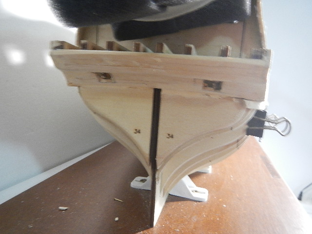

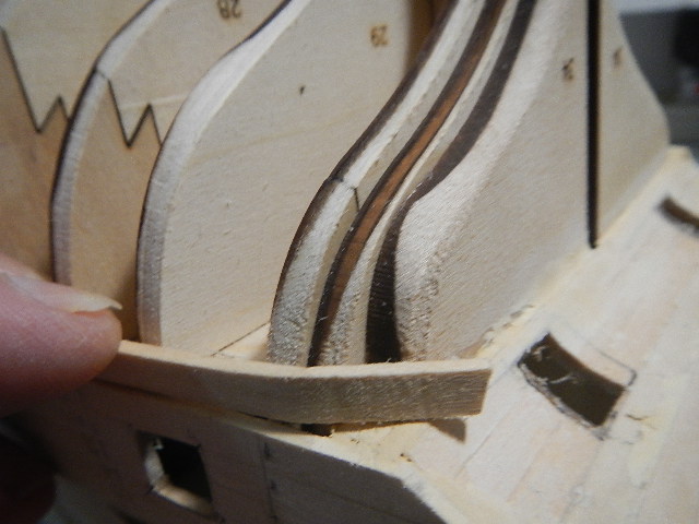

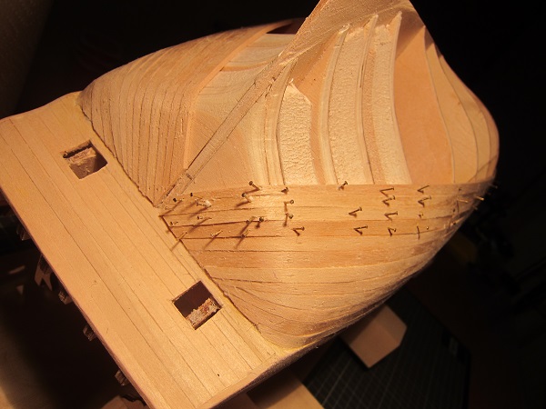

Hi all

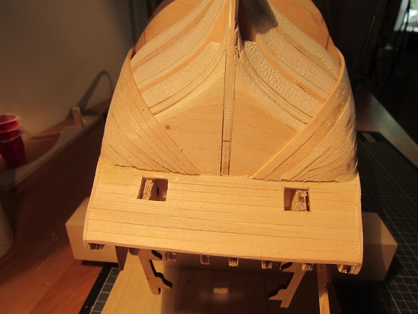

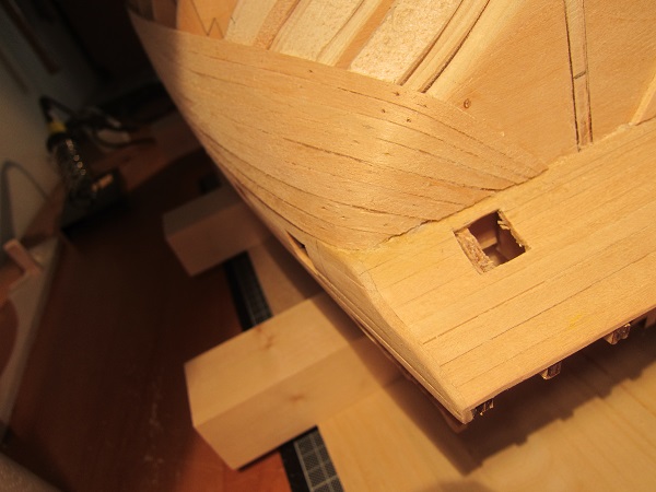

Thanks for the input,I understand I may have to do a bit more sanding but I still do not understand where the first plank should end the pics in the manual do not show this clearly in my opinion anyway I have watched the video again but ..... maybe I am stupid which is not an impossibility anyway here are a couple extra pics
Trevor
travoski attached the following image(s):
If my ship's going down,I'm bloody well getting off

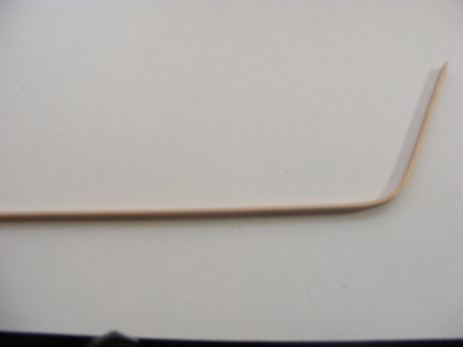

#70 Posted : 01 March 2018 10:05:11

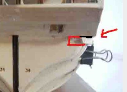

Hi Trevor,
Thanks for the pics, it helps a lot and yes, you do have a lot more sanding to do on your stern to get the profile correct.
You are not asking a stupid question, getting the planking right around the transom area has given a lot of builders tricky moments so you're not alone in that front. Your first plank around the curve needs to end right under the last plank you fitted under the transom. Your pic shows you have bent the plank around the transom so now you need to apply almost a 90 degree twist from the line you have marked at the end of the plank as per attached pic. Once the twist is applied the lower edge of the plank will need to be chamfered (indicated by the red line in pic 5) to give the best fit to cover the area you have filled with filler.
Twist the end of the plank from the marked line then post a pic.....
Hope this helps.

#71 Posted : 01 March 2018 11:24:21
Joined: 26/01/2018
Posts: 68
Points: 210

#72 Posted : 01 March 2018 12:38:13
Hi Trev,

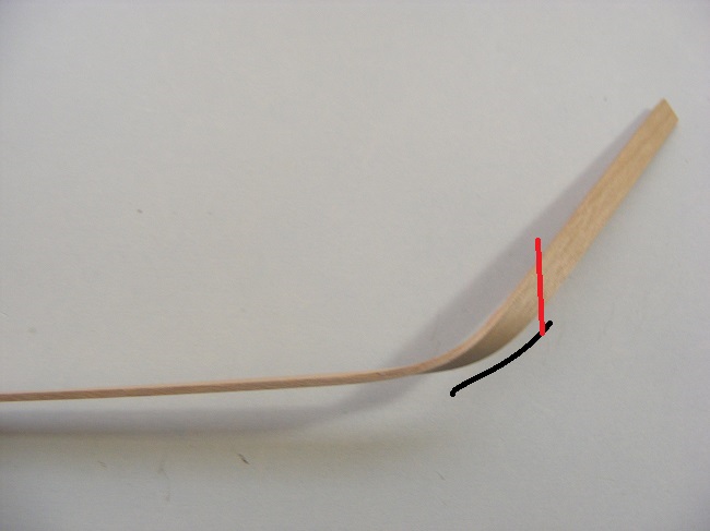

Have taken your pic and indicated where the end of the plank should sit after you have applied the twist and chamfered the edge from just before where the twist starts....
Have also taken a spare plank to show the steps a little clearer. First pic shows the bend and how it would look. Second pic shows the twist applied at the bend with the black line showing where to chamfer the inner edge and the red line indicating where to cut to match the underside of the stern.
travoski

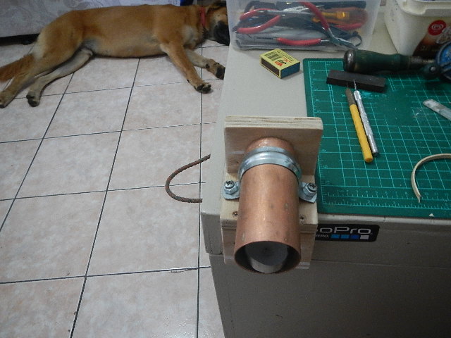

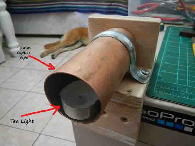

Been having a break from building today but still built something
A prototype plank bender
A knockoff of the tin can bender seen on the forum,this one uses a copper pipe which does not get as hot as the tin can version what do you guys think
Trevor

#75 Posted : 02 March 2018 09:47:22
The Problem is you did bend the plank - but you didn`t twist it.
As Alan showed in his pics there has to be an almost 90degree twist.
If you look at your own pics you can clearly see that the lower edge of the plank doesn`t follow the hull but is in the air - that`s because there is no twist.
With the right twist applied the plank will not run along the transom but go upwards - and then ending at the transom.
As to your bending device: there`s the Problem as well that you can bend the plank with it but not twist it.
There`s a much easier solution to bending:
Soak the plank in warm water (not too long - 3 to 5 minutes are enough!)
Now take a soldering iron and you can bend the plank in any direction quite easily.
And the best thing is - the plank will stay in the bent form - and you can achieve incredible radiusses (?) when doing it carefully!

#76 Posted : 02 March 2018 11:29:09
Joined: 26/05/2014
Posts: 912
Points: 2,773
Location: East Sussex UK
Very nicely done Trevor, you've taken Jack Aubreys plank bending tin can and taken it to another level, ingenious, well done.

I found some pics of my first stern-Planks - may be they help.
Also here`s a (german) link to the electric bender i use (mostly the small tip): Plank bender

Hi All
Thanks for the info guys, my bender I made just to bend the planks not for twisting as at the moment I have to get up and walk to the kitchen and use the kettle and then it's back and forth till I am done,Walter that bender looks good nothing like that is available here and the cost of shipping from overseas normally doubles the price of anything so not feasable your stern planking looks good so will keep your pic handy for reference.again thanx for the kind words of encouregment and have a great weekend
Trevor
