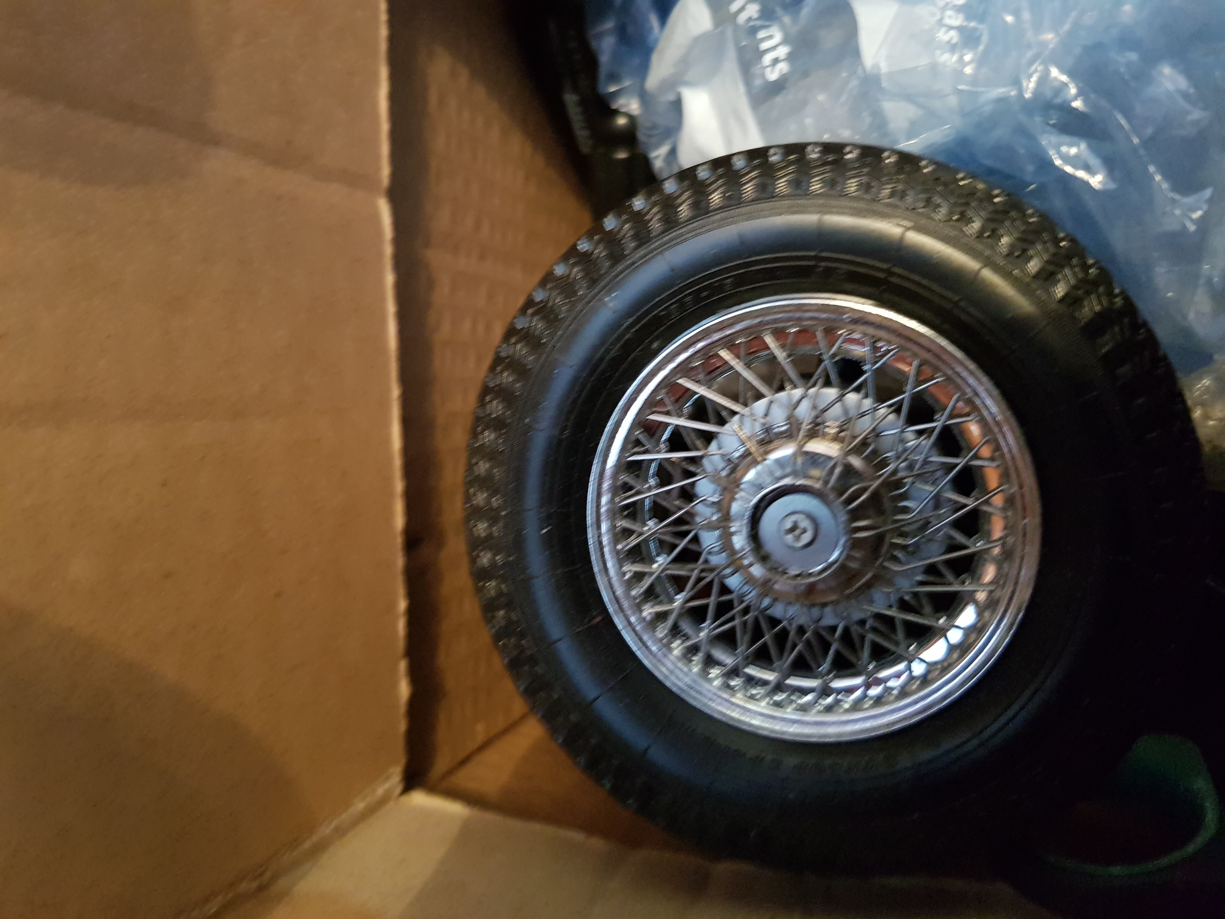

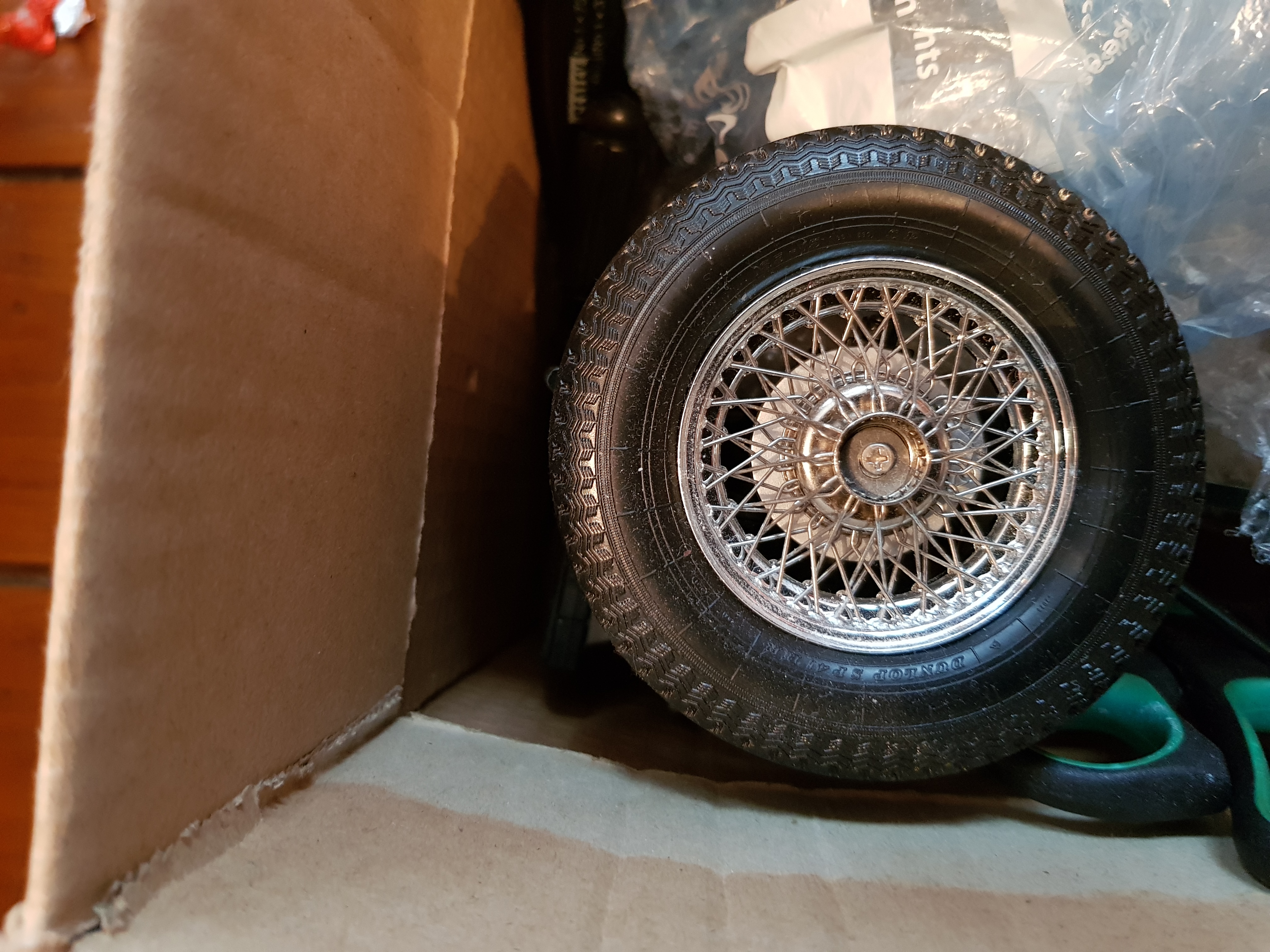

Is anyone able to build my wheels for me as I just cant get the hang of it, my patience isnt great, would be a great help please, thanks, paul
#74 Posted : 02 December 2018 12:19:19
Hi Paul happy to help have sent you PM cheers mick.BigGrin
suedehead
#75 Posted : 09 December 2018 13:19:44
Joined: 28/06/2017
Posts: 10
Points: 20
Location: High Wycombe
Hi there mick, sending pic of wheel over to you, paul
suedehead
#76 Posted : 09 December 2018 13:32:38
Joined: 28/06/2017
Posts: 10
Points: 20
Picture of Jag e-type wheel mick, paul
suedehead
#77 Posted : 09 December 2018 13:33:52
Joined: 28/06/2017
Posts: 10
Points: 20

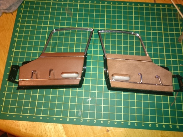

Hi got few more issues of this now, so gone back a bit, took door apart and covered it suede leather, just like the look of suede, to normal leather, probably never done on a real one, so just personal preference. The door on the right done and the left as supplied. Cheers mick. BigGrin
#79 Posted : 14 March 2019 21:12:56
Nicely done MickBigGrin looks good.
#80 Posted : 15 March 2019 09:01:59
Posts: 6,968
Points: 21,211
Nice work Mick, coming on nicely.
