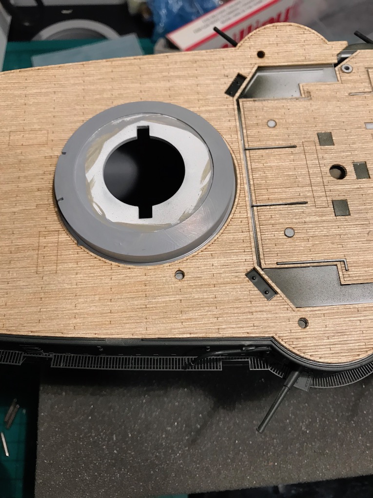

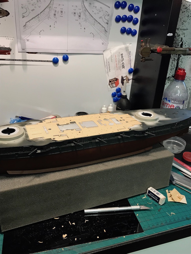

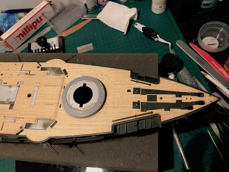

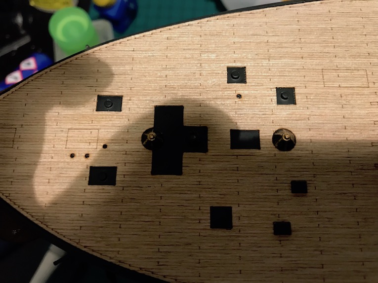

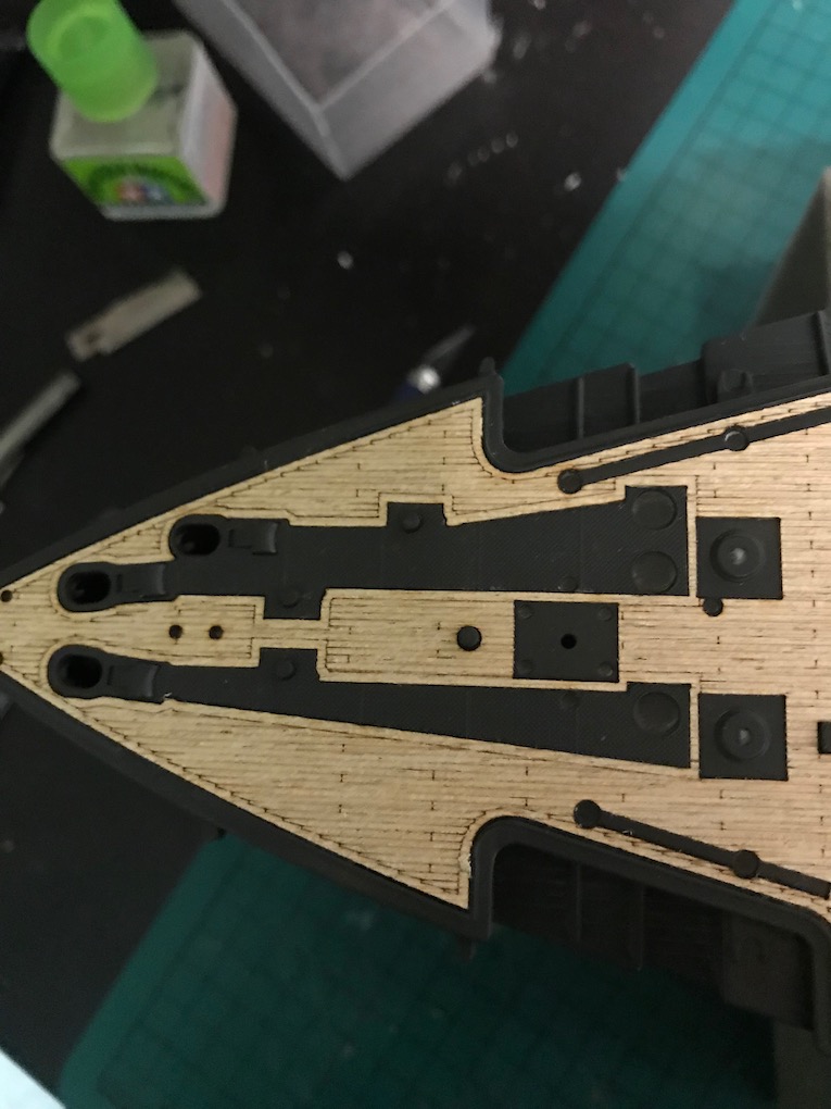

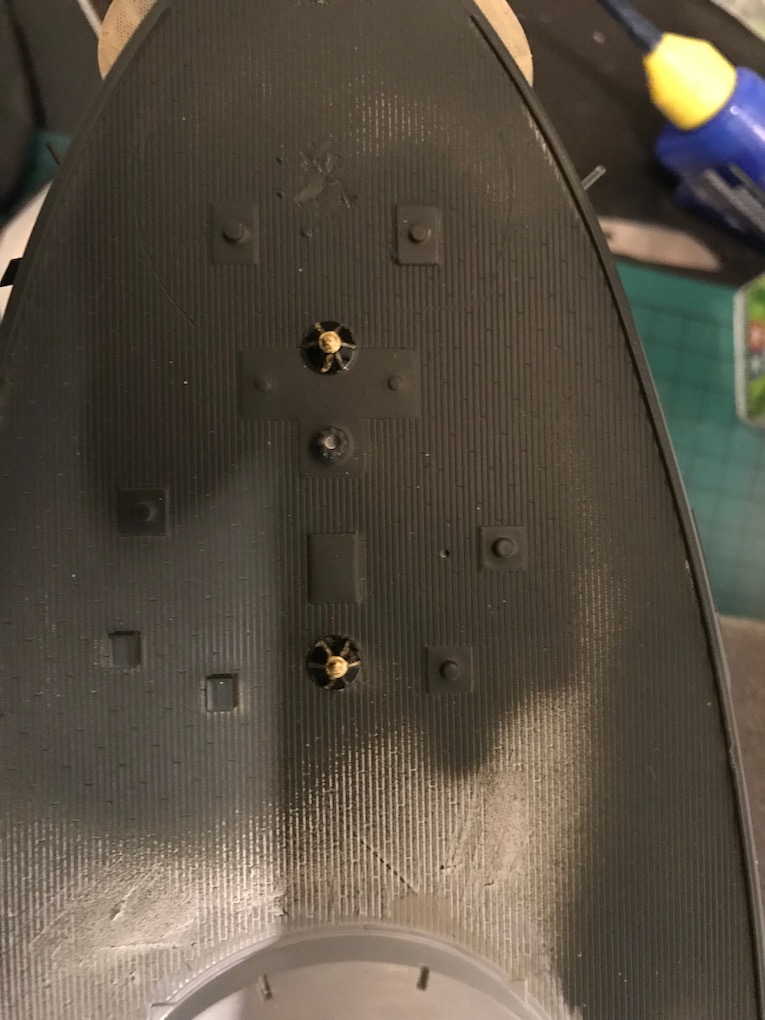

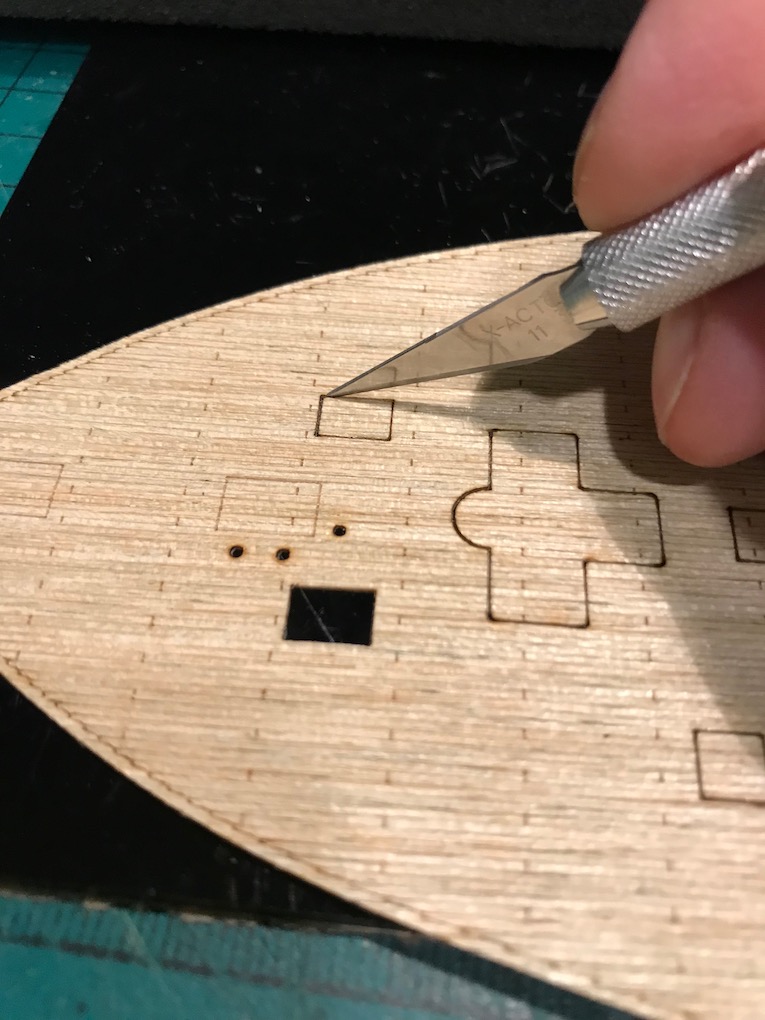

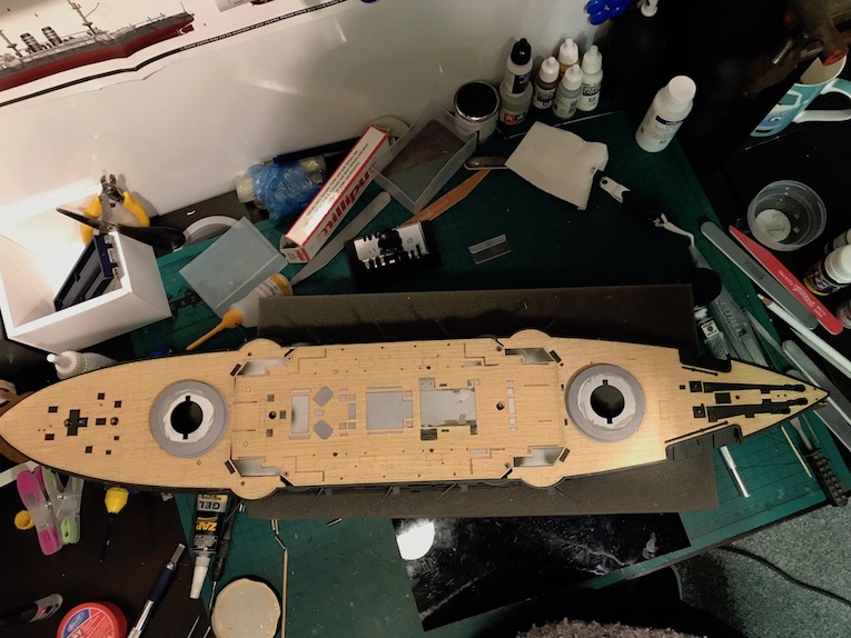

Laying the deck
the main deck has 3 wood veneer sections to overlay the deck. with all the deck fittings painted the deck could be added.
I placed the centre section down first. I was a little surprised that some of the holes in the deck were not perfectly correct despite a fit to bock edges correctly. some very fine slivers of deck had to be removed with a sharp blade to get the deck to lay totally flat. (see post 38 in Scuttlebutt for more info on fitting wood decks)
Both the bow and stern decks were a much better fit although some trimming will be required when the hawsers are fitted.

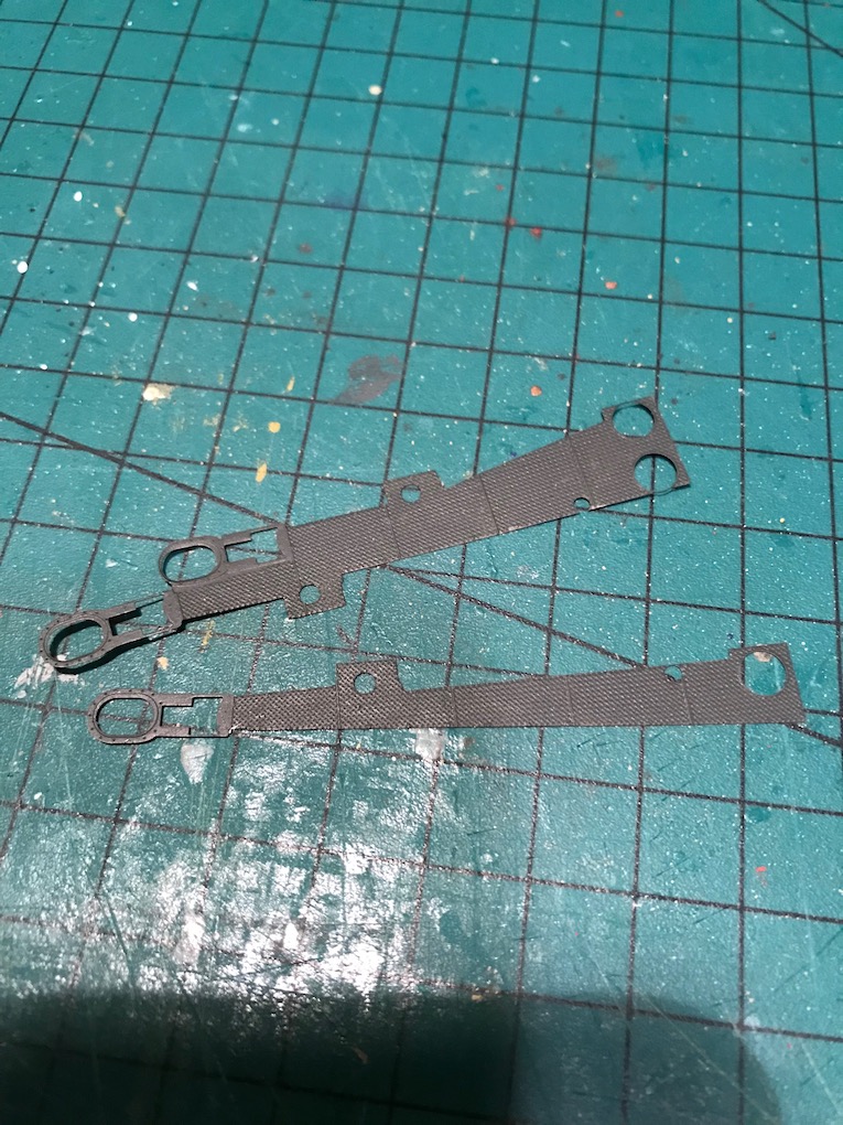

There are two etch bolster plates that cover the flat plastic moulded into the deck. these were primed and painted before fixing with medium CA.

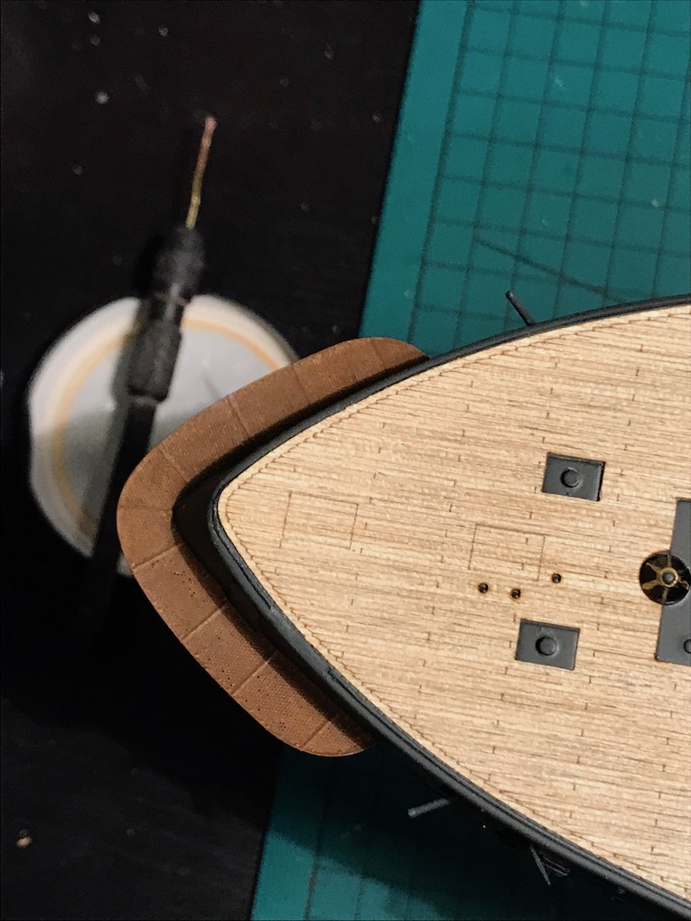

#67 Posted : 10 February 2018 16:39:56
Stern Gallery part 1.
The kit is supplied with an etch stern gallery made up of a deck and railings in two parts. the MK 1 set is just the same but offers some better detail.
the deck of the gallery is actually dark wood and not as I first assumed iron.
I have used WEM Mahogany sadly unavailable any more.

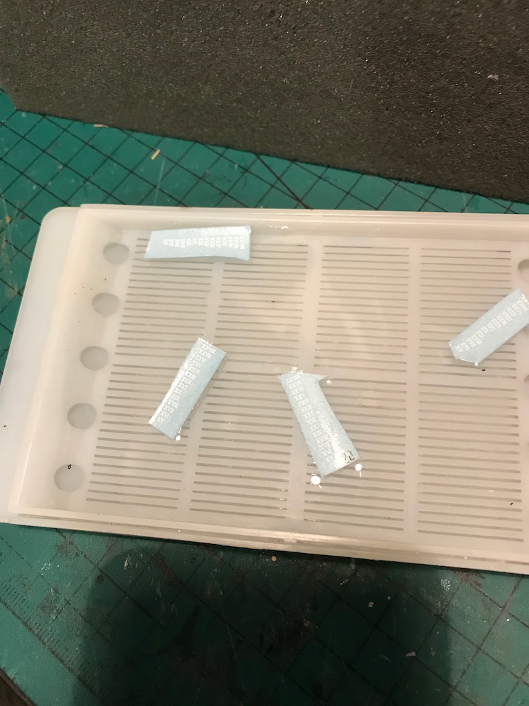

#68 Posted : 10 February 2018 17:26:49

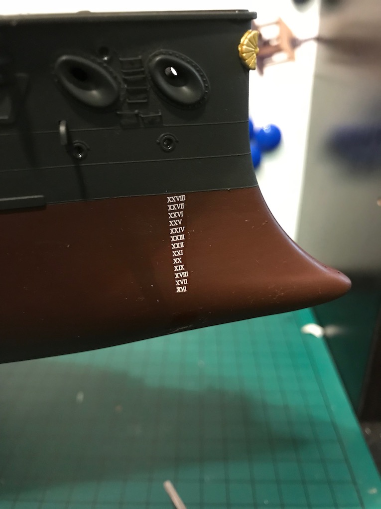

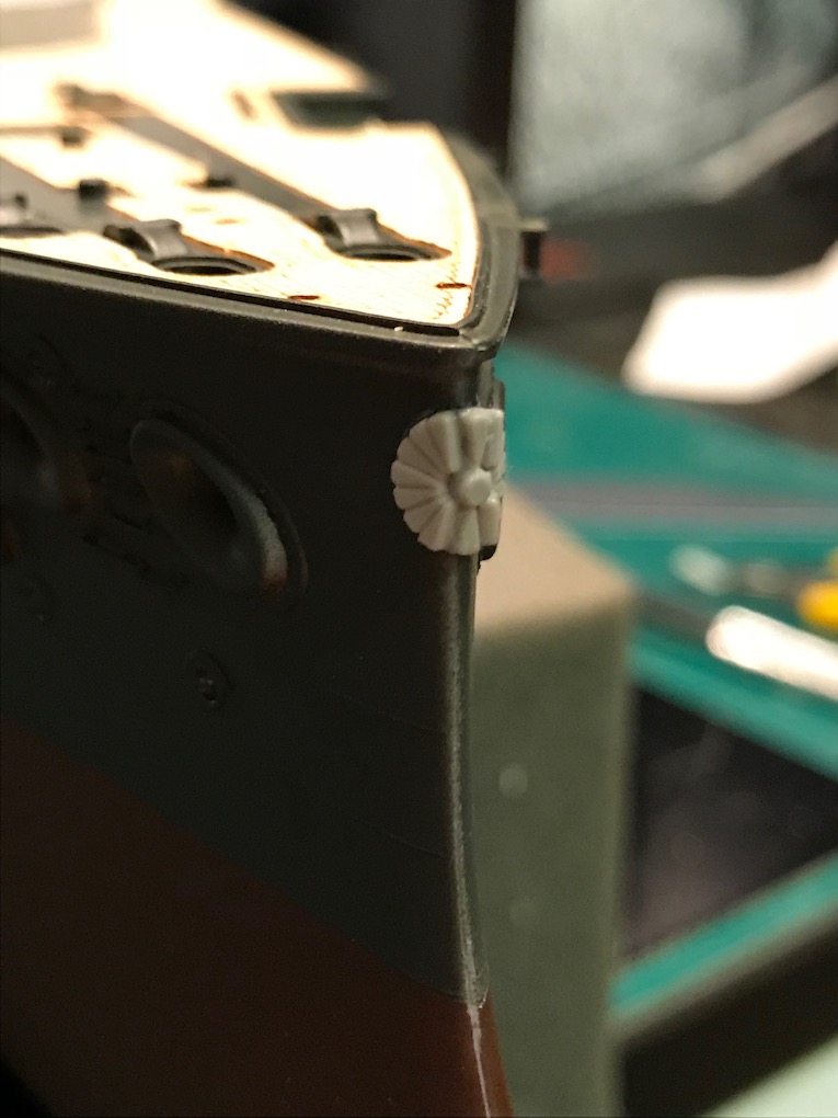

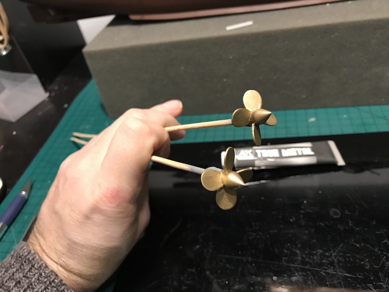

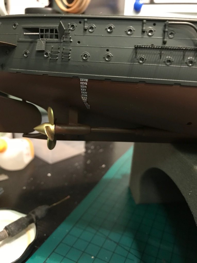

Hull Construction part 10. Screws and Bow Crest.

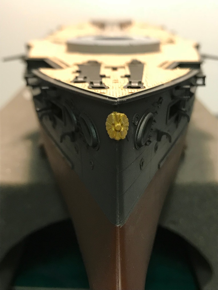

The Bow crest is the rising sun and is painted Gold. The kit part is actually three parts to allow it to form around the bow leading edge. I have painted it a pail gold as I want to give it a wash with will darken it a little at some point.

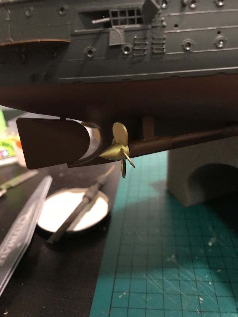

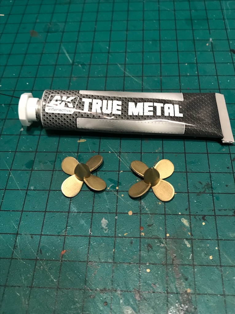

the screws were painted AK brass. the true metal paint can be polished to give a more realistic metal finish. there not as good as accrual brass but I think they look ok
the finishing touch to lower hull is to ad the depth markings which are part of the kit decals.

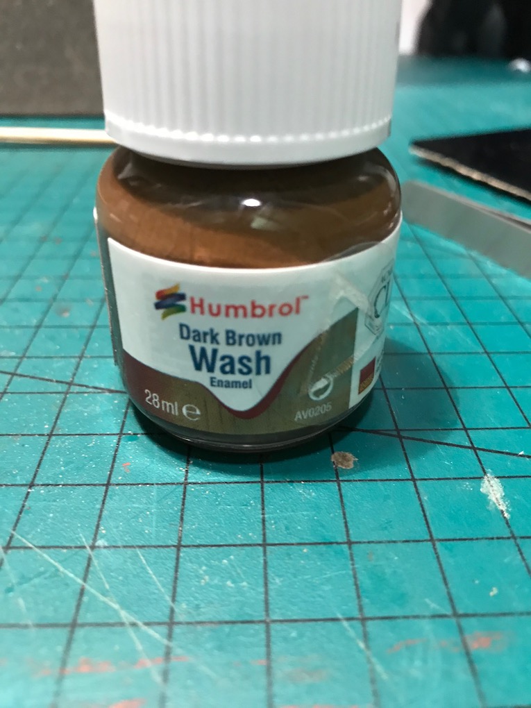

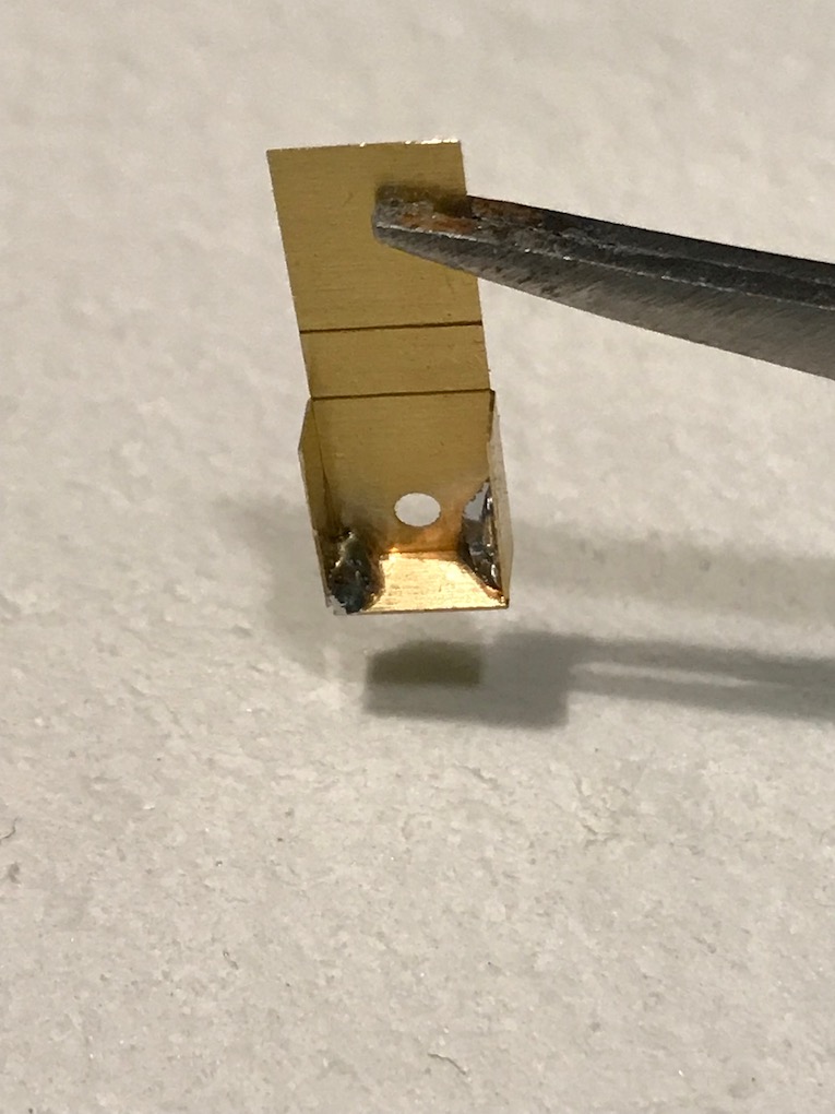

#69 Posted : 17 February 2018 20:48:20

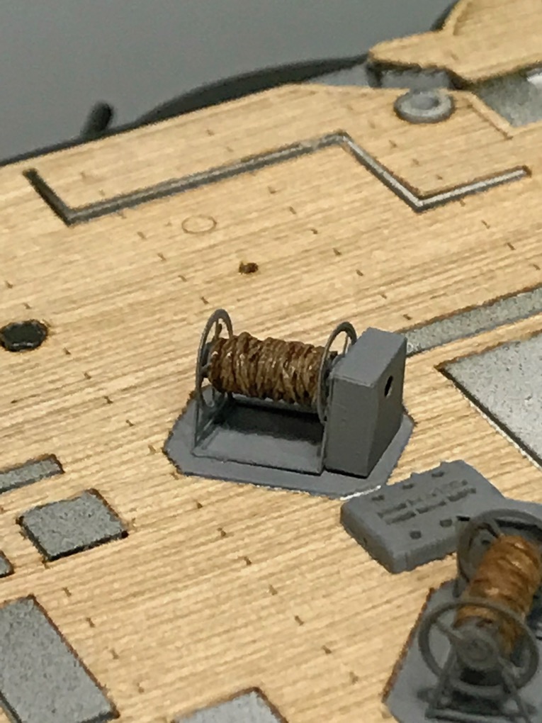

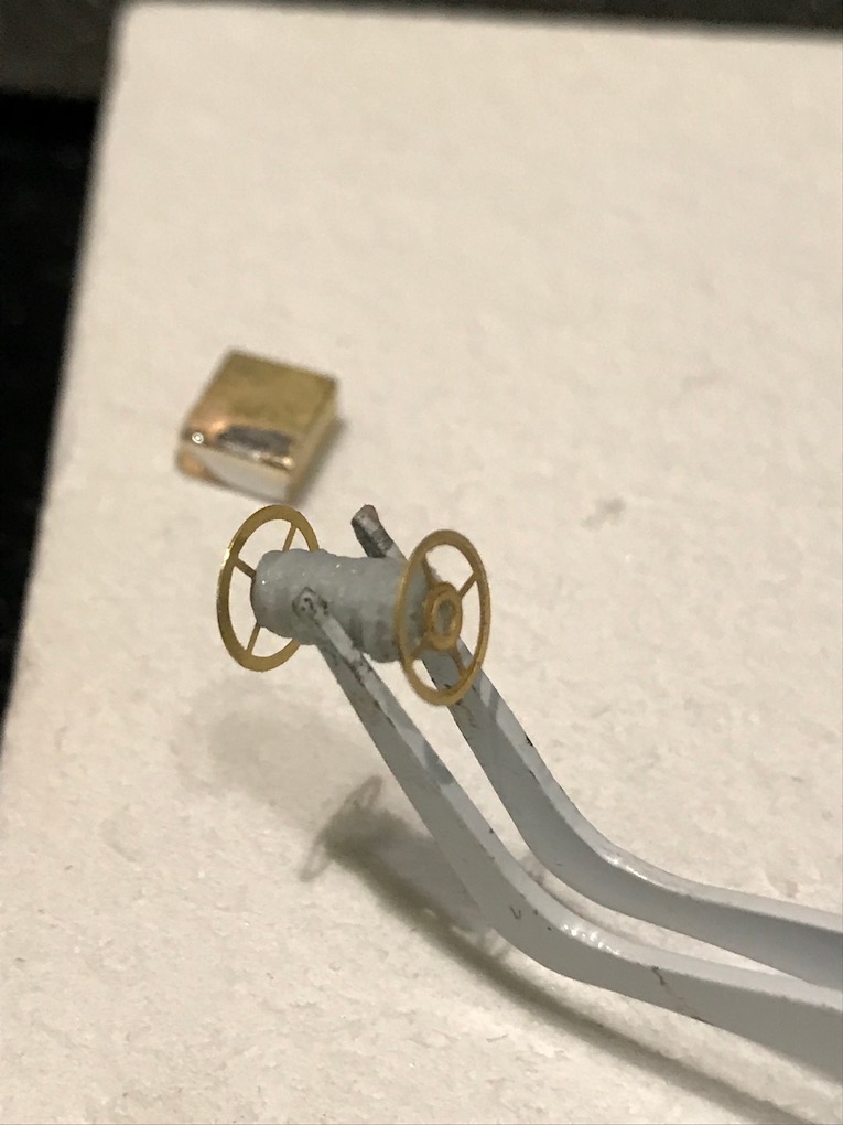

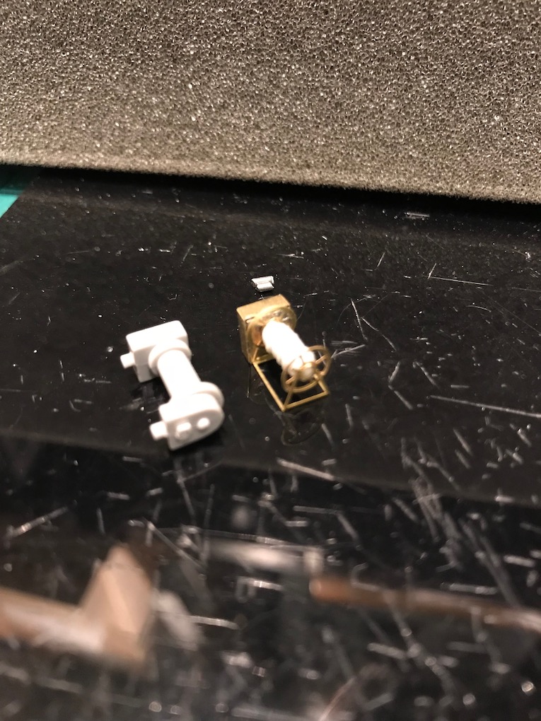

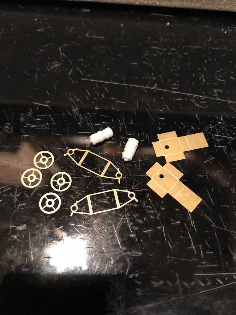

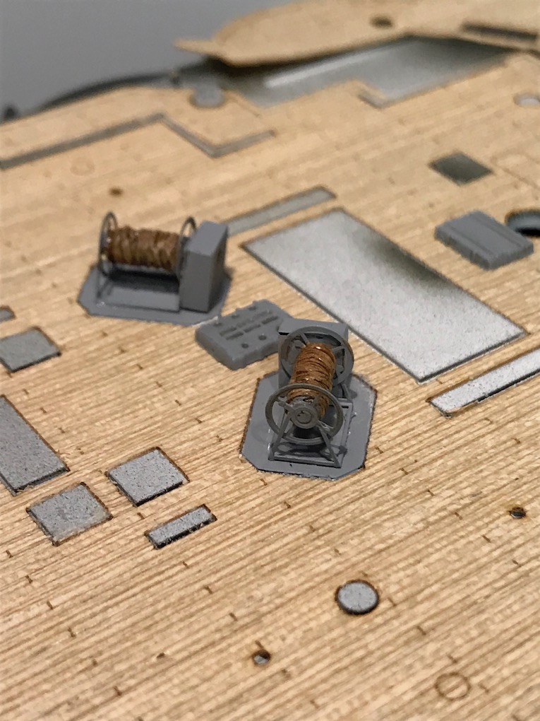

Deck Fittings part 1, large winches
The plastic winches supplied in the kit are not particularly good looking
The MK1 set brings together 4 etch parts and a very nice resin part to create something that looks as it should.
the etch box was a little difficult to keep to shape so I chose to solder it on the internal joints.
once built up the rope was painted with AK deck tan and then given a wash of Humbrol brown.
#70 Posted : 17 February 2018 21:07:06
Looking good Jase. Just how hard is it to solder your etch? Any problems with warpage?
Regards Gray
#71 Posted : 17 February 2018 21:37:37
No issues with warping if you do it right, you can solder very fine detail, I have just solders the funnel cap cages.
I am working on 4 etch tutorials one being soldering they will be in Scuttlebutt soon

#73 Posted : 18 February 2018 00:53:47
BigGrin Sorry to correct you Jase but the 'Mon' or bow crest was not the rising sun but a Chrysanthemum a symbol of the Japanese emperor which was only endowed on the most important ships like the Mikasa, Akagi, Musashi and Yamato to give a few examplesCool

Every days a school day😂🤣😂🤣
Thanks Andy
