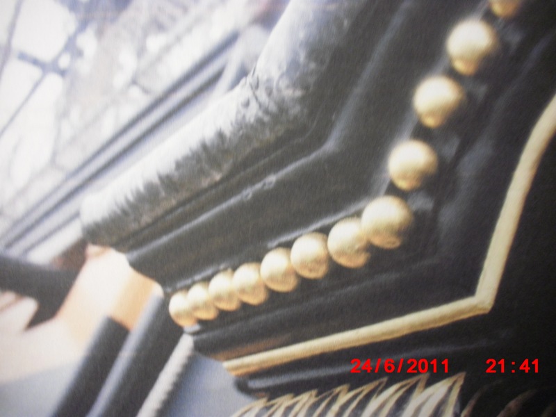

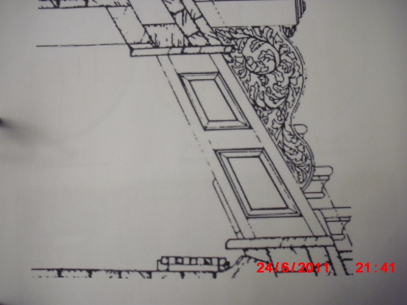

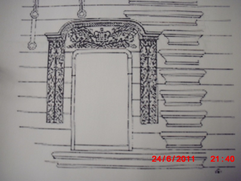

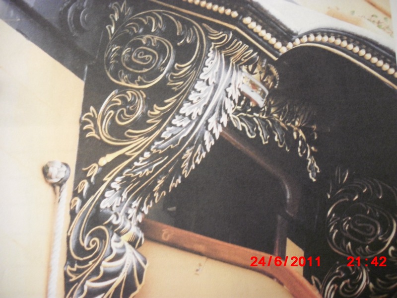

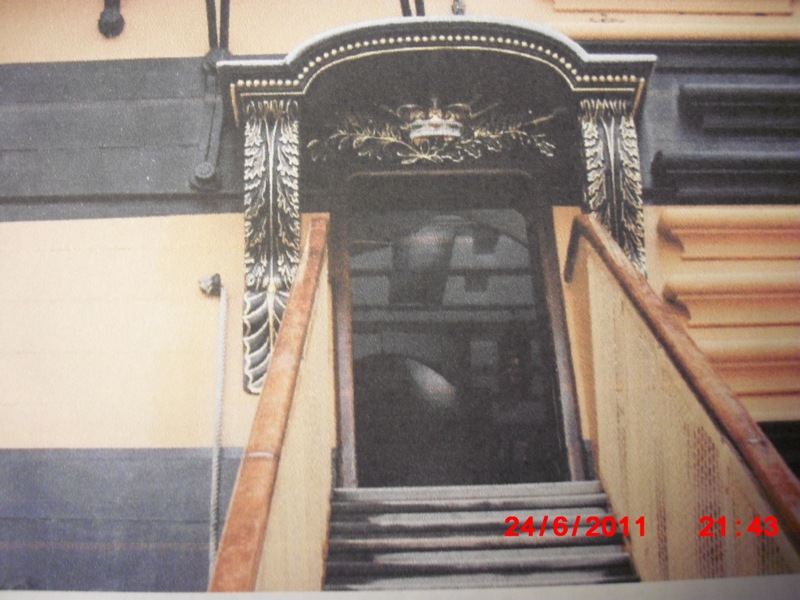

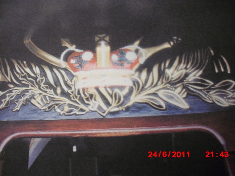

I am going to attempt to do an enhancement to my build by putting in the carved side panels to both entrances,in order to do this I needed graphics and photos of the area,fortunatly JASE has produced these and has given me permission to reproduce these on this forum for the purpose of this "mod"(JASE HOLDS THE COPYRIGHT TO THESE PHOTOS AND GRAPHICS PLEASE DO NOT REPRODUCE WITHOUT HIS PERMISSION)
First off here are the photos and graphics, the mod will follow :-
#62 Posted : 15 July 2011 08:32:10
Wink ThumpUp So this is the area we are talking about, next is what I hope to achieve:-
THANK YOU JASELOL LOL

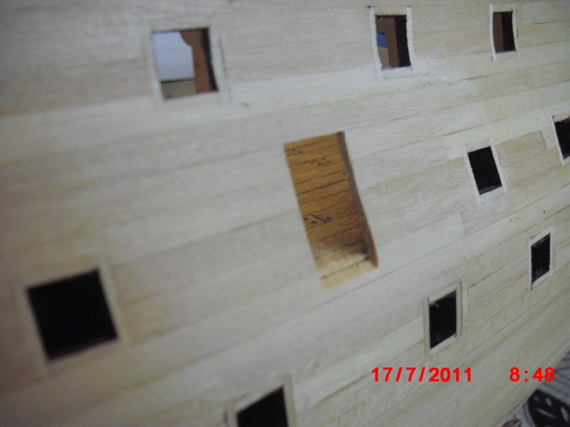

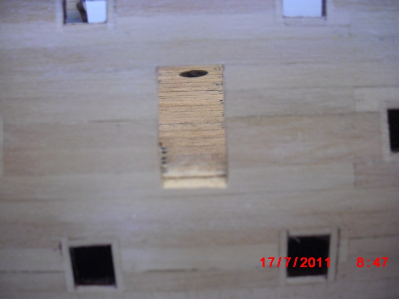

#63 Posted : 17 July 2011 10:32:04
Hi everyone before I continue with this enhancement, a note to all newbies, "THIS IS NOT IN THE INSTRUCTIONS, AND IS NOT A PART OF THE De Ag BUILD" It is a" Mod" that I wish to do on my build for my satisfaction, if any one would like to use this enhancement on their build then please go ahead.LOL BigGrin
First off, I have fine sanded the area I will be working on ;-

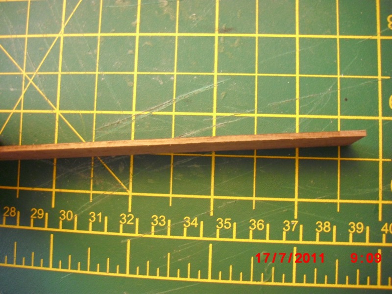

#64 Posted : 17 July 2011 10:39:40
Next job is to prepare wood for a lintel, I want to get the shape (as per the drawing) of the top of the door, so I want to make it thicker in order to file it into shape.
I have chosen dark wood as I will be able to get a good colour match to the original photo, the wood I have used is enough for 3 lintels (in case I make a mistake)Huh

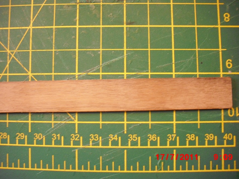

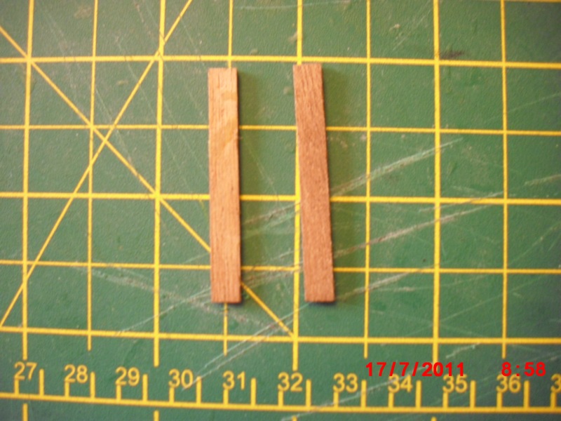

#65 Posted : 17 July 2011 10:47:43
The final job for this session (While the glue hardens in the lintel) is to choose the wood for the actual side panels and step,as you can see this is a slow process but doing enhancements always is, and as I always say MODELLING IS A JOURNEY NOT A DESTINATION just always take your time, any comments gratefully received here is the side panel wood -

#73 Posted : 17 July 2011 12:44:52
Hi Mike,
I purchased one of Stedders "GR" stamps and he sent it with a quantity of green stuff, your insigniers look great on the gun great jobBigGrin LOL
To be honest I was not planning to do the crest at the top of the door just the framework and the side panels, I did not think that crest was around in 1805 (correct me if I am wrong) so I was leaving it off.Huh
But-------- ?

#79 Posted : 17 July 2011 13:57:22
Firstly, thanks Mr `T for that brillient idea which I will adopt ( as usual we can rely on you to come up trumps)I am not doing a mod of the canopy, I thought De Ag would provide that.
Could you tell me what is the dimension of the space between the frame and the canopy, that is available to me for the crest please Mr `T
Thank you. "wheres that wine bottle" oh no its a screw cap keep drinking!!!!!!!!!!!Blink Blink LOL LOL
