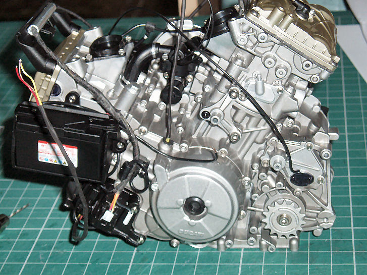

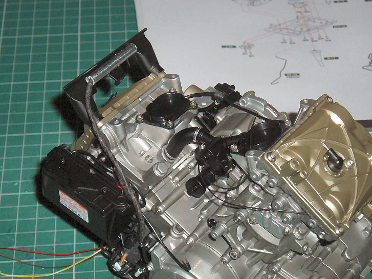

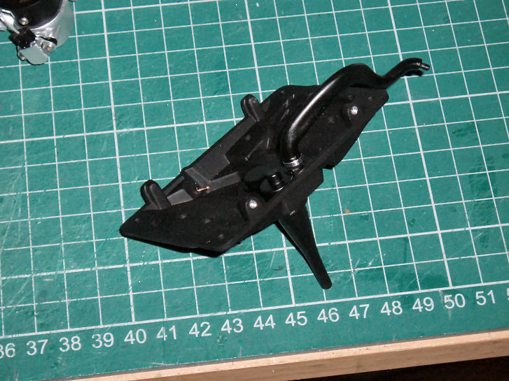

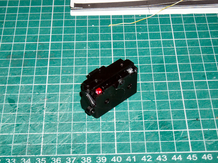

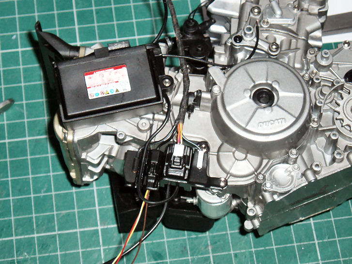

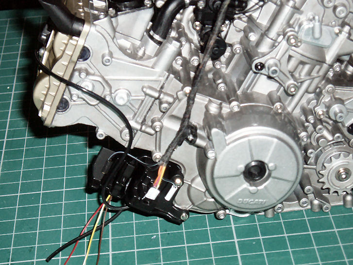

Even more scratch wires added to the relay panel and the battery has been assembled.

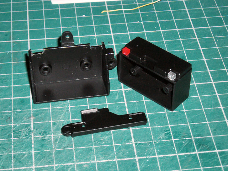

A bit of chopping needed on the battery holder as there wasn't any clearance for the battery terminal blocks (missing from the kit) or the battery leads. (missing from the kit...)
Once these bits were attended to the cables could be added.
One goes to the lower relay block, the others go into the wiring loom later on.
Also added a small sensor that feeds from the gearbox casing.
All fitted and still tons more wiring to scratch and add.

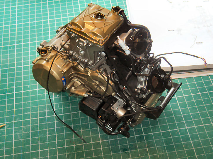

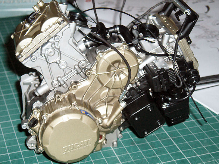

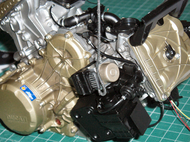

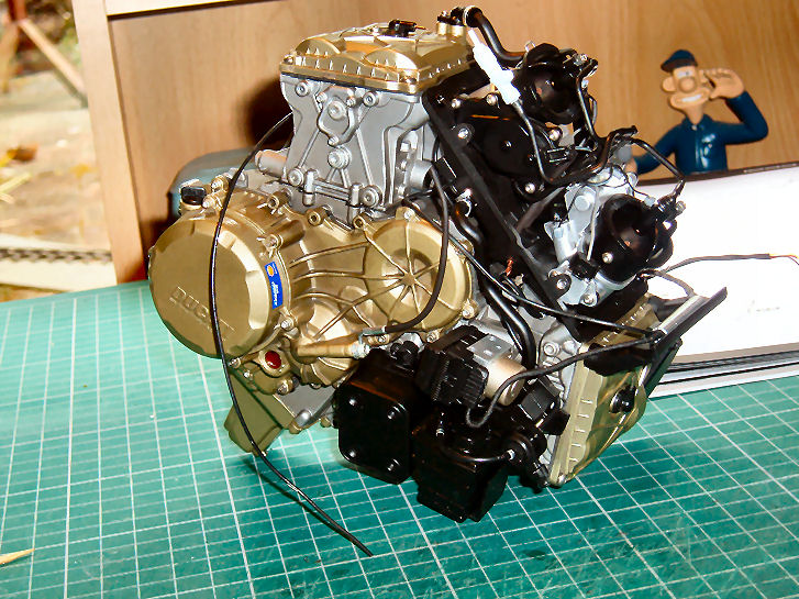

Breather pipes made up and fitted and I've added the wiring loom cross tube that goes across inside the front of the engine frame. Yes, a missing bit.
The wiring loom on one side has been cloth bound and now feeds into the tube.
The loom that will eventually be on the other side will also go into the other end of the tube to effectively create a loom that crosses from one side to the other.
LOADS more wiring still to scratch and add.

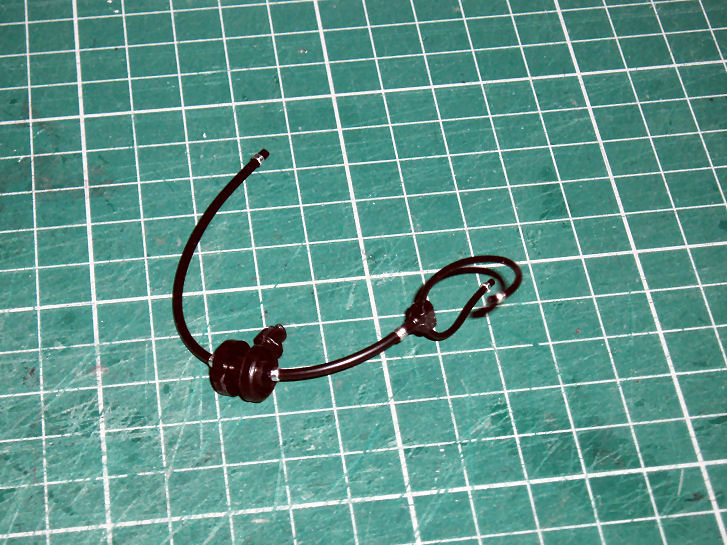

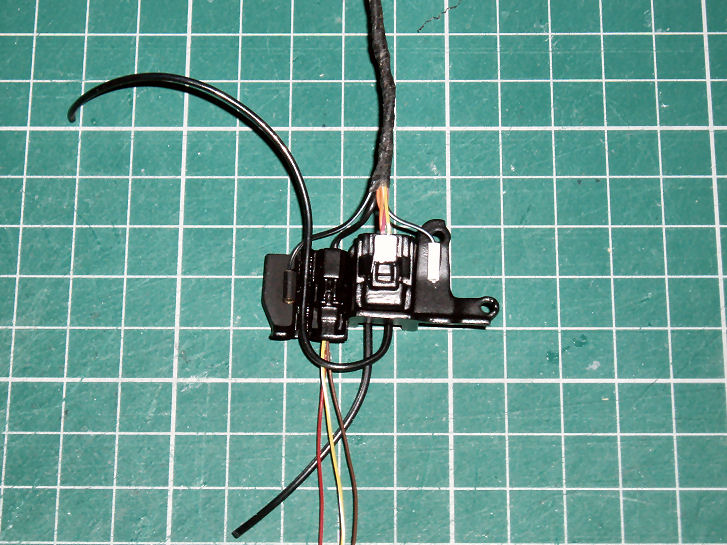

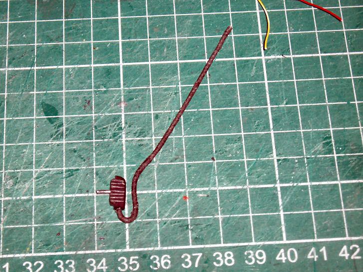

Another missing part is the connector from the wiring loom to the ABS sensor.
A plug was made from scrap plastic, drilled, and the 'cables' made from solder wire wrapped in surgical cloth tape coloured black.
The plug has still to be painted.
I drilled and added a metal locating pin between the plug and sensor as I don't want it glued permanently just yet as there are lots of other pipes/wires to add and it will just get in the way.

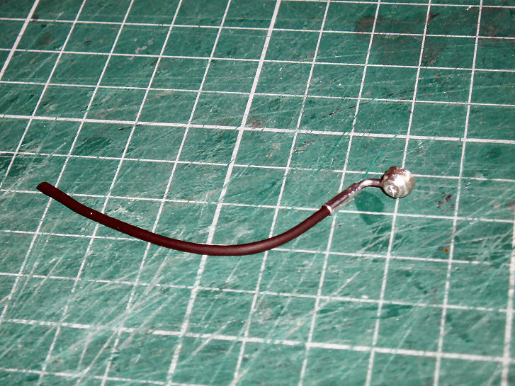

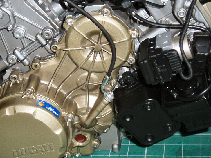

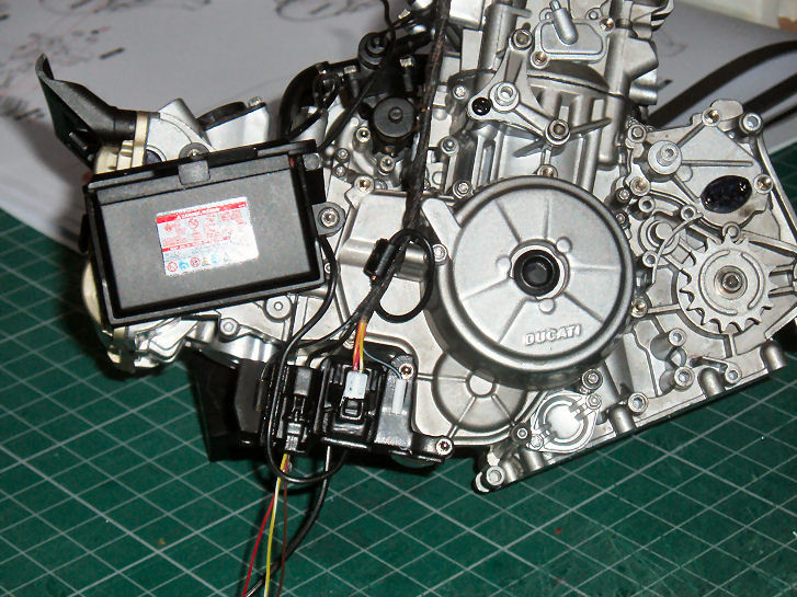

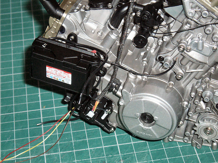

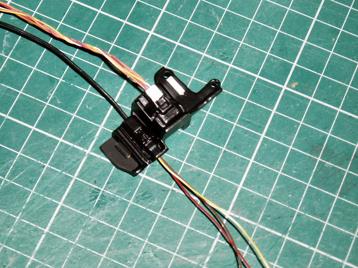

A few more missing cables etc now attended to.
The missing gearbox wiring - made from 3 fine yellow wires and shrink-tube covered.
A sensor wire from t'other end of the engine, and a missing banjo fitting and cable from the other side.
All of these will be joined up at the other ends as the build goes on.

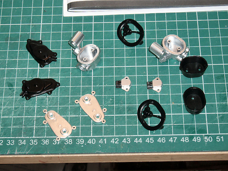

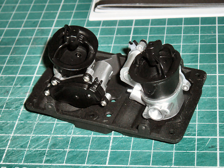

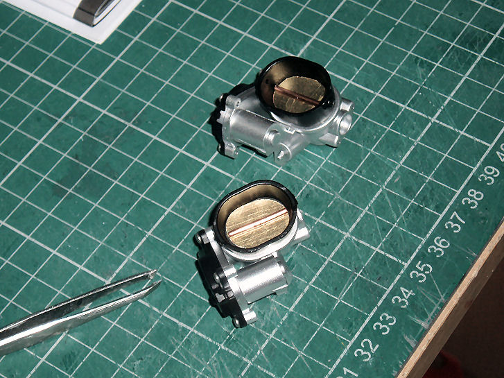

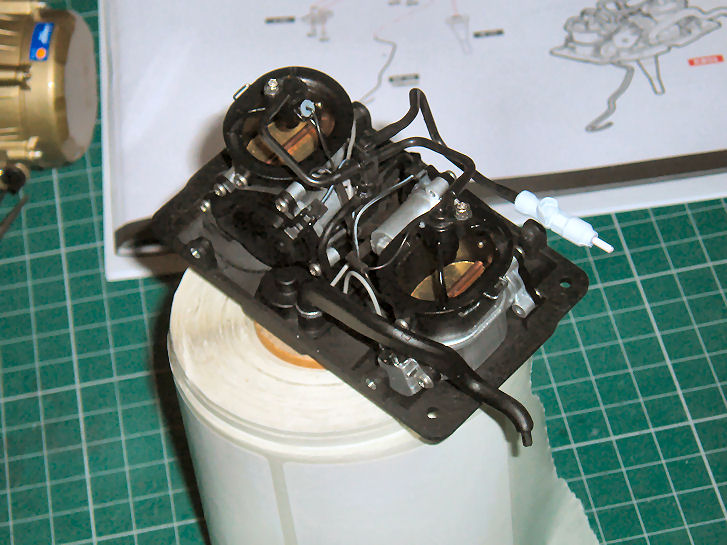

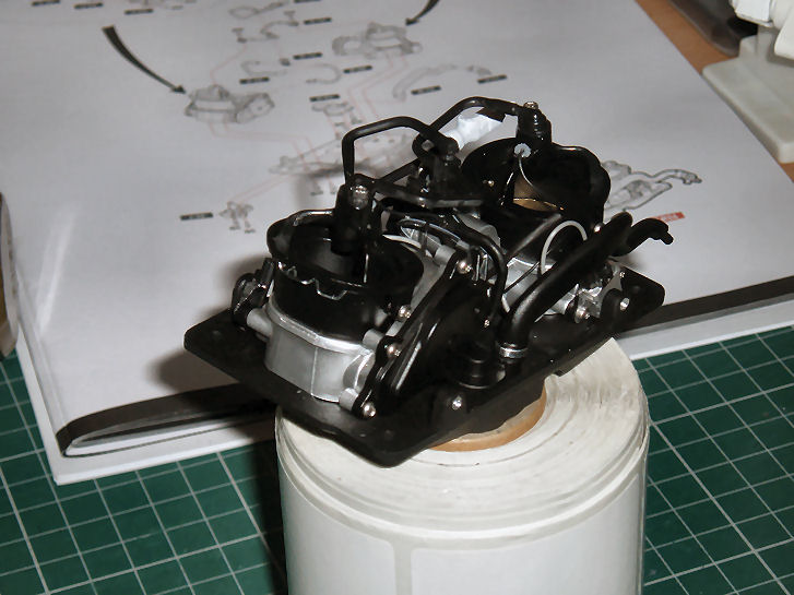

Another bit sorted over the past couple of days.

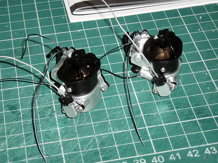

The intakes have been assembled and a huge amount of extras added.
The first pic shows pretty much how it looks if built OOB.
Each intake is missing the internal butterflies, four sensors and electrics, and a lot of wiring.
The tiny sensors and connectors were made from bits of sprue cut and shaped.
I deliberately used different colours of wiring just for the sake of variety.
A pin had to be fitted into a drilled hole in the base plate so the cables would connect, and come out on the other side - eventually.

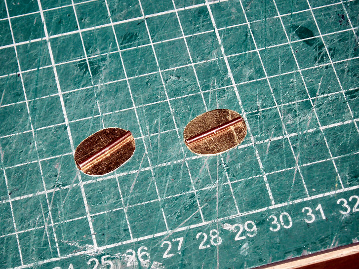

The internal butterflies were made of plastic sheet covered in brass BMF, with a small copper rod glued across.

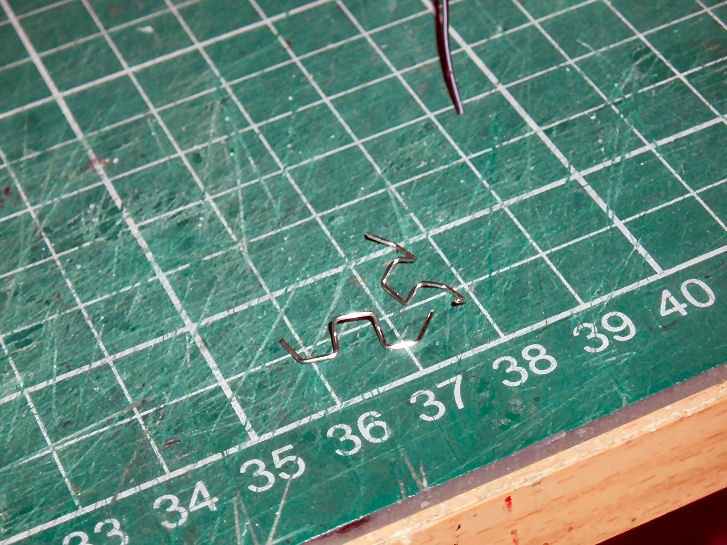

The little wire fixing clips were just folded from thin wire and glued in place.
There's more to add underneath before the assembly goes onto the engine.
A great kit, and great fun.

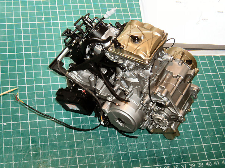

So far, so good.
Everything fits very accurately and it does all go together well.
The great thing about Pocher kits - and even the part-work cars - is there's just so much scope to add more if you want to.

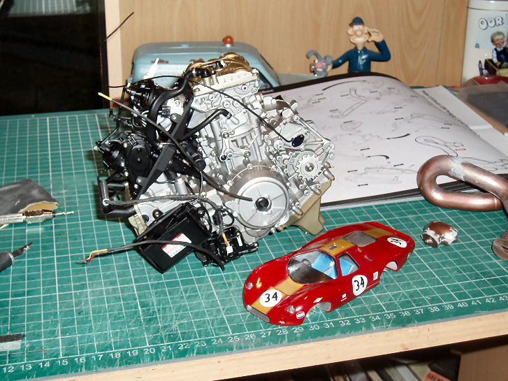

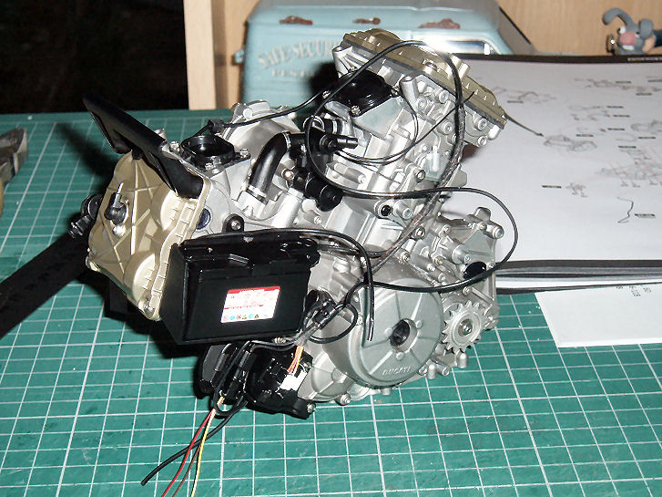

The intakes are now built up and have been fitted to the engine.
Lots of wires and pipes to connect around the assembly but they all fit neatly and with no bother.
To give an idea as to the size of this lump, the last pic shows a little 1/32 Airfix Ford 3ltr GT I'm also currently fiddling about with.
On to the exhausts next and I already know this is one part of the kit that is pretty poor in terms of fit gaps, seams, screw holes etc etc.
Quite a bit of work needed there.
