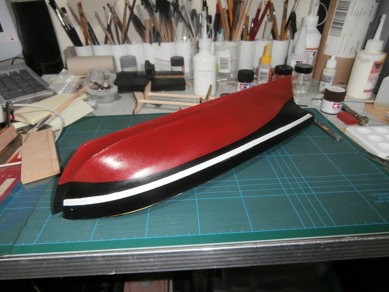

Hi, a very brief update. I gave the hull a few light coats of vallejo clear gloss via air brush yesterday and left to dry overnight.

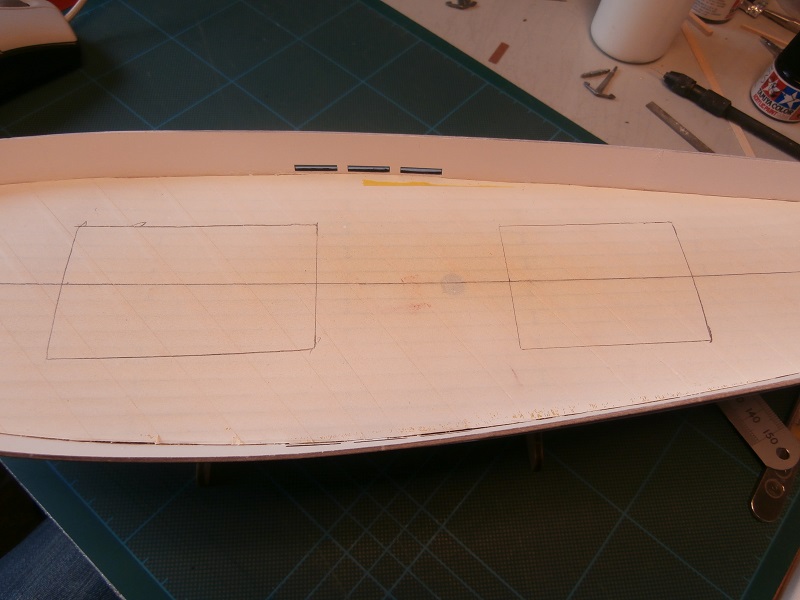

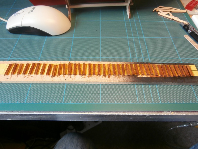

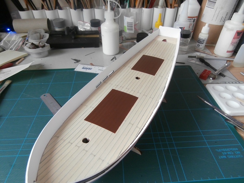

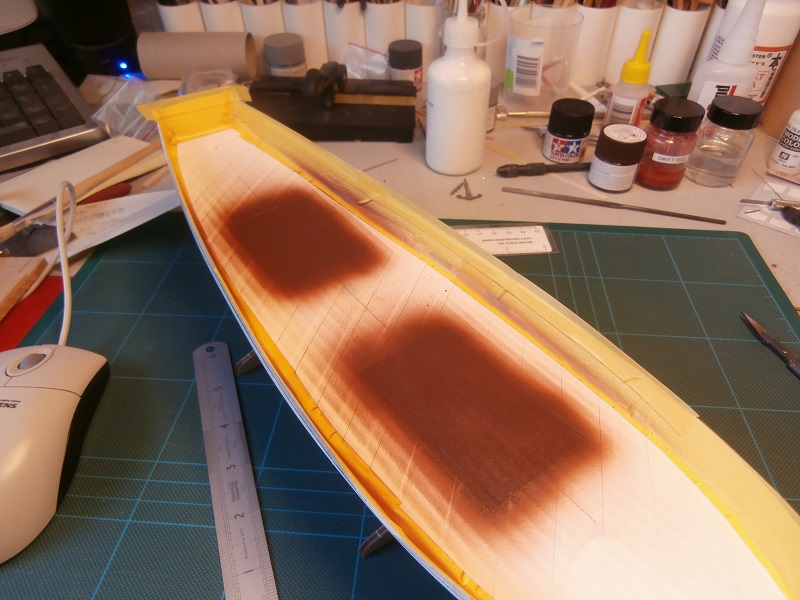

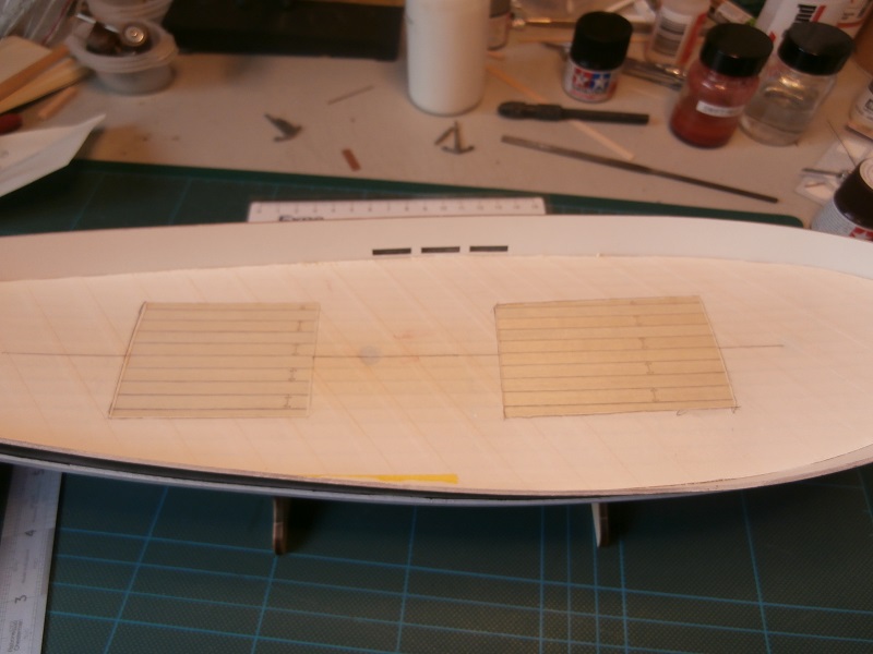

Hi, the next job was to mark the positions of the cabins/companion ways onto the masked deck. The centre line was marked and the forward position of each cabin marked. The cabins were then placed in position and a line drawn round them, Pic 1. I then cut 1mm inside the lines using a new scalpel blade and removed the inner masking tape, Pic 2.
The exposed decking was then sprayed brown, Pic 3, and the rest of the masking tape removed from the deck, Pic 4.

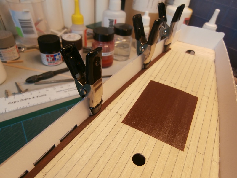

The deck edging pieces were then painted, Pic 5, and when dry glued in place. To allow the clamps to hold the centre of the strips down I used off cuts of planking against the bulwarks to push the clamps out, Pic 6.

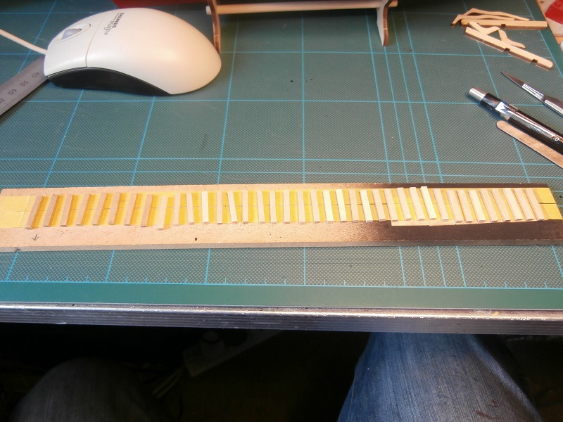

The next job was to cut 38 bulwark supports and stain them walnut. The cut pieces were held onto an mdf strip with upside down masking tape, Pic 7, and stained accordingly, Pic 8.

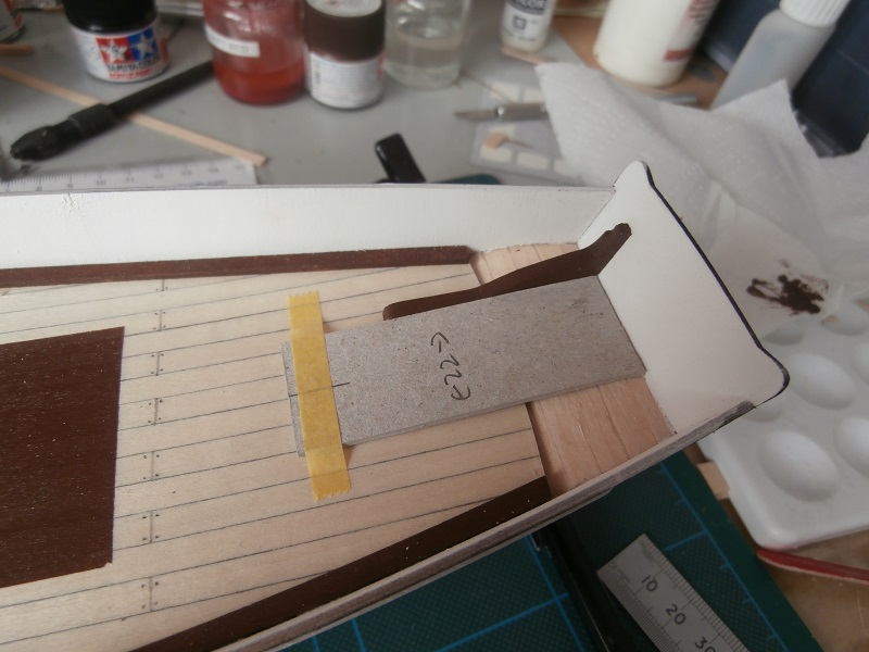

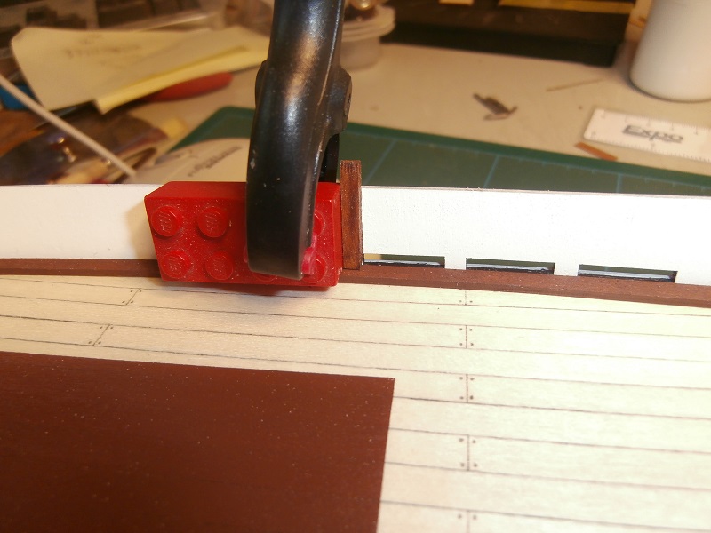

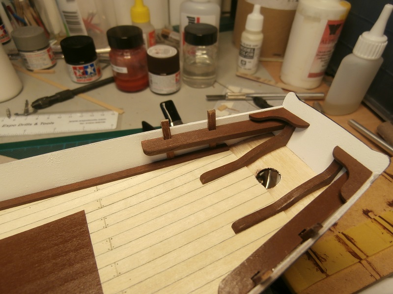

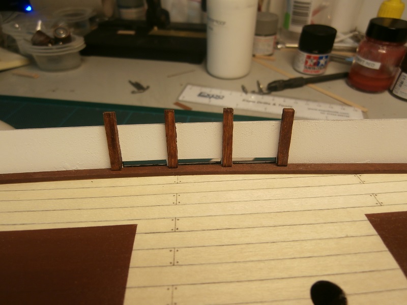

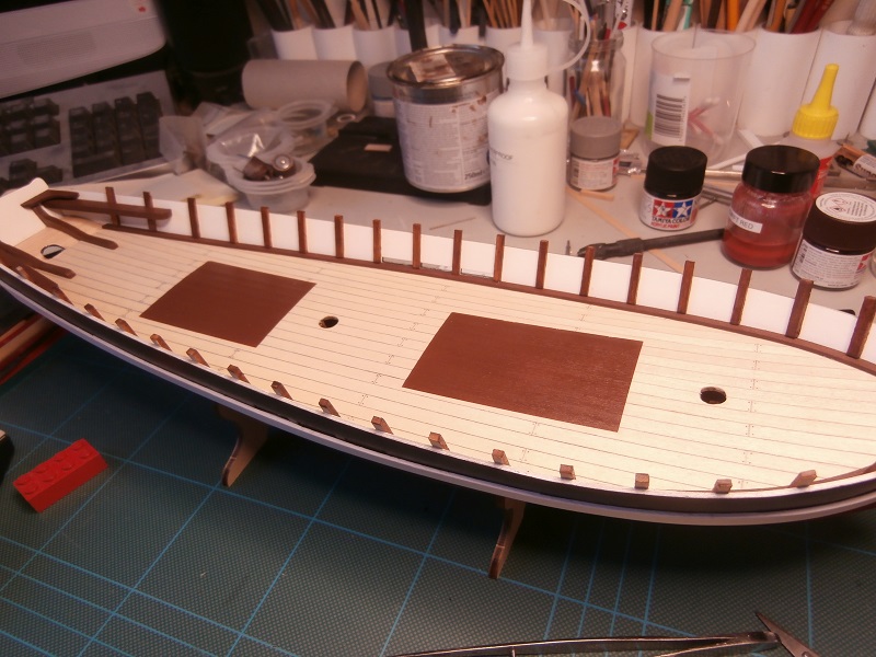

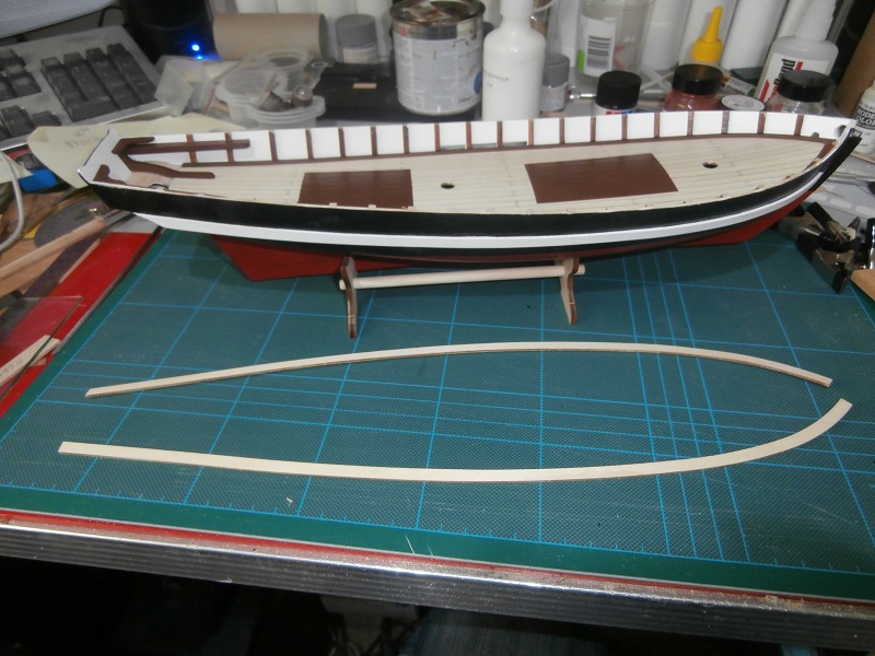

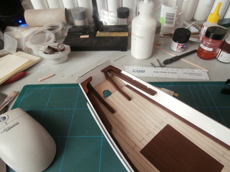

The next job is to fit the stern rails and fittings and the bulwark supports. The stern rails and fittings, Pics 1 & 2, were sanded to fit the shape of the stern and then painted brown. The stern bulwark supports are spaced 22mm apart, 11mm each side of the centre line so a piece of card 22mm wide was cut and taped across the centre line. The supports were then glued in place, Pic 3. The side rails were then glued in place, Pic 4.

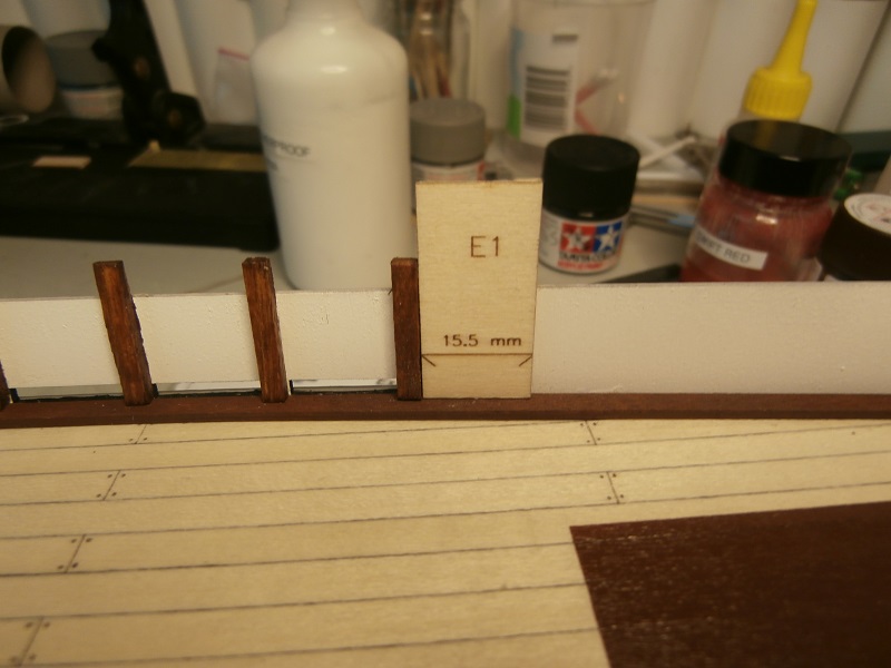

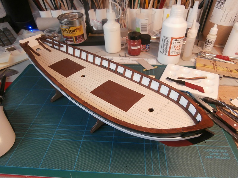

The aft most side supports were slid through the side rails and glued into place., Pic 5. The next supports to be fitted were at the scuppers and the good old lego brick ensured they were square, Pics 6 & 7. The rest of the supports were then fitted using the spacer provided to make sure the spacing was even, Pics 8 & 9. Once dry the supports were cut level with the bulwarks.

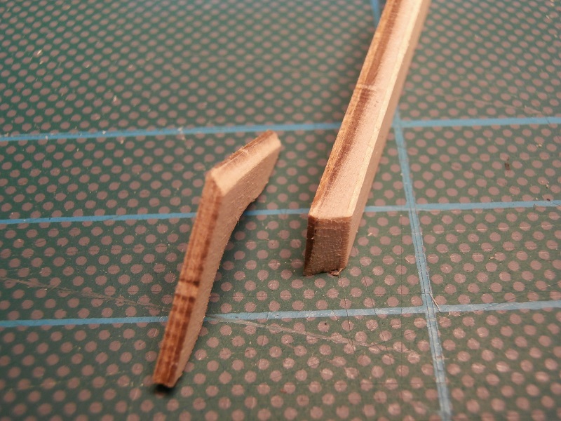

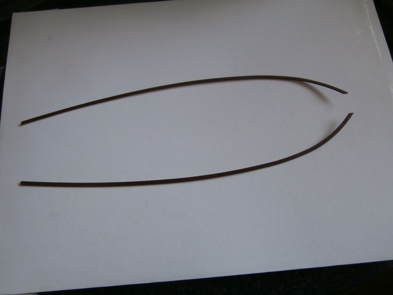

The bulwark capping rails were then removed from the fret, Pic 10, and stained walnut. I’m afraid I forgot to include the bow piece in Pic 10. The rails were then glued in place, Pic 11.

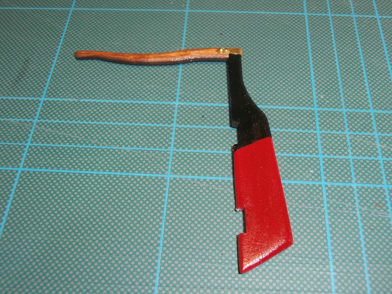

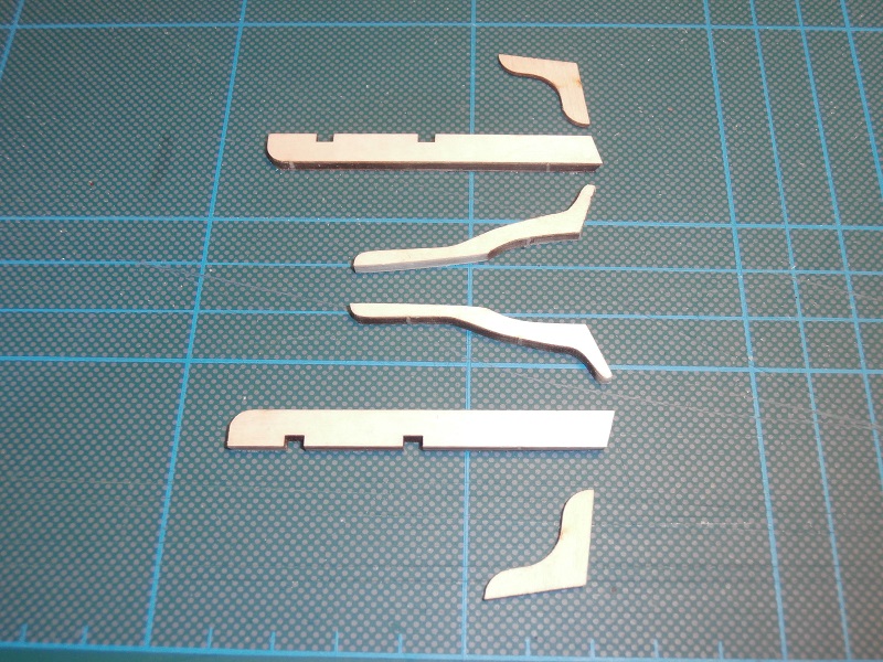

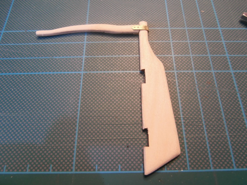

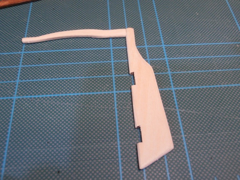

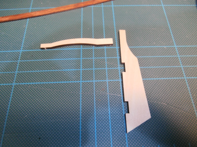

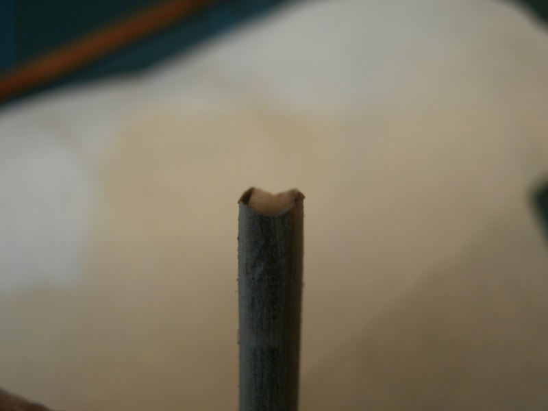

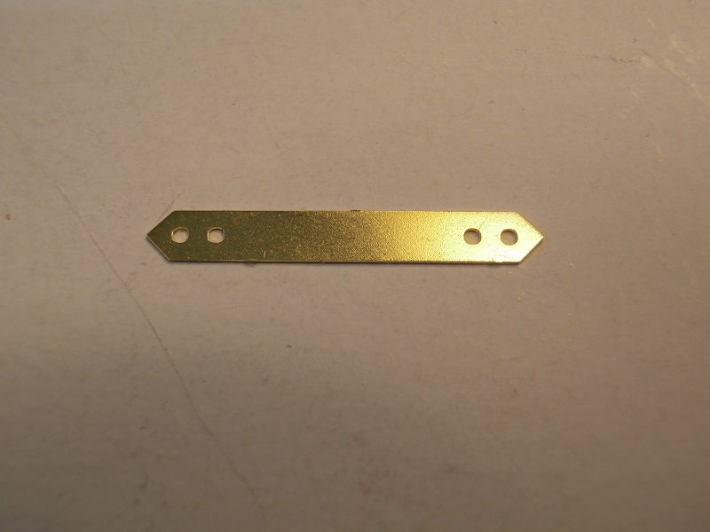

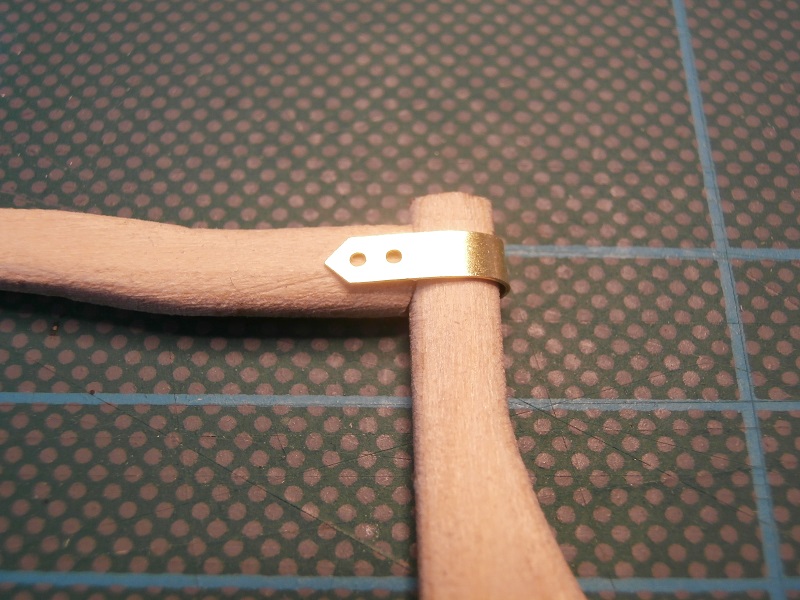

Next was to prepare the rudder and tiller. Pic 12 shows the parts as removed from the fret. The edges were then sanded round and a groove filed into the end of the tiller, Pic 13. Pic 14 shows the parts after sanding. The brass clamping piece, Pic 15, was removed from the fret and bent around the rudder, pic 16 & 17. The tiller arm was stained walnut and the rudder painted to match the hull. The brass clamp was fixed to the tiller and Pic. 18 shows the finished tiller and rudder although the arm is not fixed to the rudder yet to enable the rudder to be fitted to the hull.
