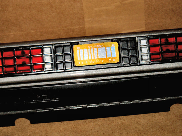

Looking once again at the engine, and that decal sheet, a further idea came to me.
Anyone with the ability to produce that decal sheet is more than one up on me, I couldn't do it to save my life. However, it seems to me they missed a trick.
Speaking personally, I could have done with just the one DMC logo, and used whatever space that gave up and I could find elsewhere to put a decal of the '2015' bar-code type licence plate. This would have allowed people to correct the fact that if you want the "Mr Fusion" on the back of the Delorean, and/or have the wheels in 'flight' mode, then the number plate supplied with the partwork is wrong.
At the end of part 1, the doc comes back from the future and has had some work done. At this time the previous numberplate has changed into the barcode variant. It stays that way all through part 2. [I'm not sure if it's still there by the end of part 3, can't remember if it comes off when Marty has his wild ride back to the wild west or not.]

I suspect a problem there would be that the bar code plate has mirror chrome bars and text. Printing chrome is incredibly difficult, even for the big boys.
Also, I wonder if the bar code plate might well be part of the kit later on seeing as the Mr Fusion is included.

Roy, I was thinking more of a decal with the orange on it.
Once the plate [or in my case, a spare.] had been sanded down, it could be painted chrome, with the decal over the top.
Or a mask supplied so that the plate could be painted orange, masked, then done with the chrome.
Either way, I don't think Eaglemoss are going to be revisiting the number plate. Everything since the first few issues has built onto what has already been done - a very logical method meaning minimal chance of losing parts because you've had to keep them for months without using them. Producing a number plate for the '2015' version of the car would seem like a step backward at this time.

A bit like this one...?
#65 Posted : 24 July 2017 11:47:15
Now that looks cool Roy Cool top jobDrool regards PhilCool

yup, that's the one.

It was something I experimented with using clear decal over a mirror self-adhesive foil.
The orange didn't come out as 'orange' as I hoped so I dropped the idea.
I have a few spare test decals and foil if anyone wants to have a go at using them.
You'll have to make a plate from plasticard or similar. It can just be stuck over the original plate with a few tiny bits of blu-tak.
If it's of interest, PM me an address and I'll send you the bits - FOC.

Thanks Roy. Decal arrived today. Look forward to giving it a try.
