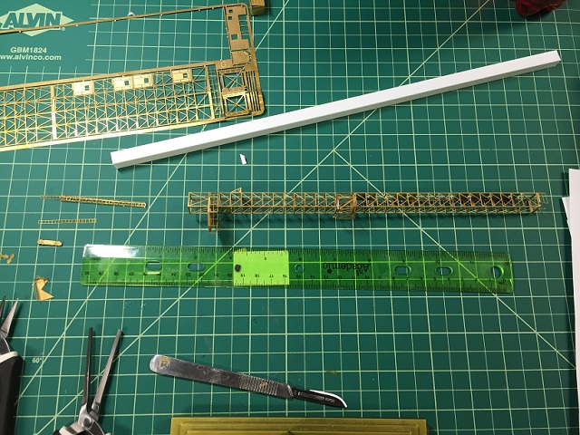

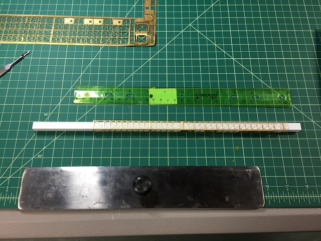

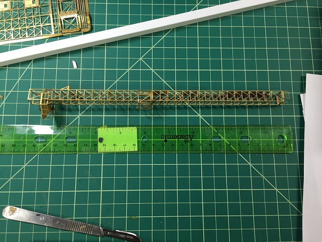

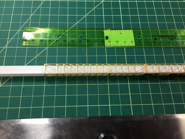

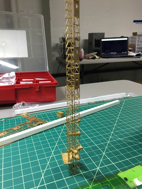

Started work on the final support towers.There are 2 support towers that allow access to the mid and top sections of the R7.Each tower has 9 platforms.

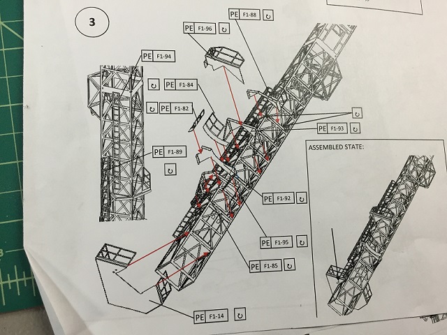

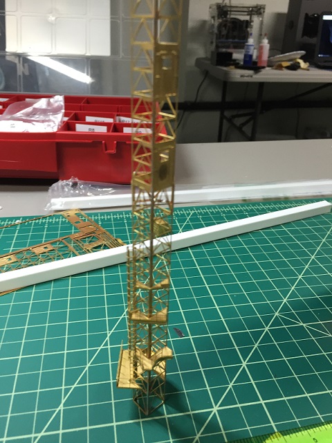

The main tower piece is quite long and fragile.It was quite a challenge maintaining a square shape.I soldered it and then use some plastruct square stock to make sure the tower stayed square. There are quite a few photoetched platforms and ladders to add to the back side of the tower and then the main platforms are a mixture of metal and resin. The instructions are a bit of a nightmare.It is very hard to see exactly where the platforms attach.There are red arrows showing the attachment points, but they get lost in the detail of the tower.it took me quite a while to figure out where everything went.I used superglue for the platforms since they are so small and delicate.
The next step is to glue the resin and metal parts that make up the access platforms and then attach them on to the service tower.

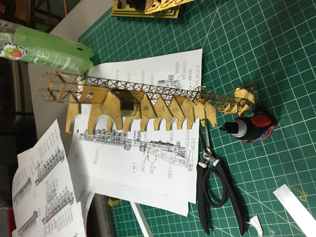

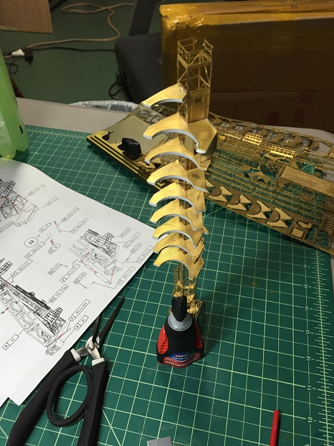

#64 Posted : 06 October 2017 17:41:45

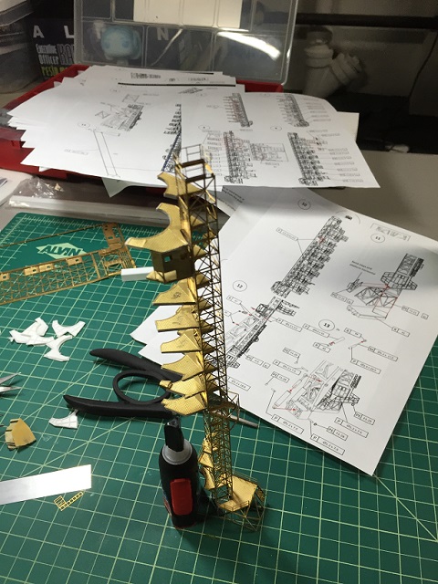

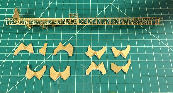

I have all 9 platforms done now and ready to be installed on the tower.it was a bit of a puzzle to figure out which resin piece fit which photoetched piece.

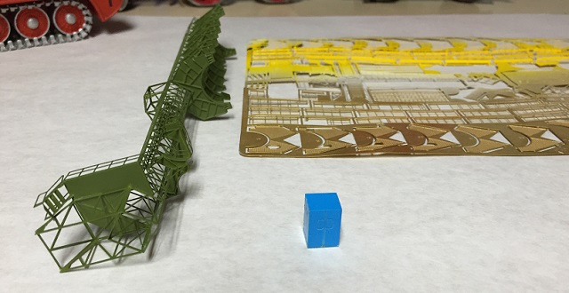

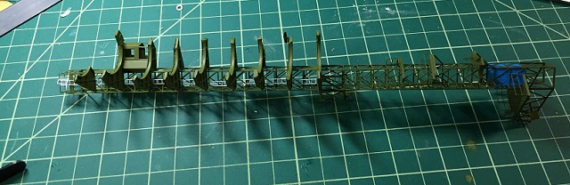

The platforms have now been glued onto the service tower with 5 minute epoxy.The next step is to paint the tower.The railing will be added after the tower is painted because they are a different color.

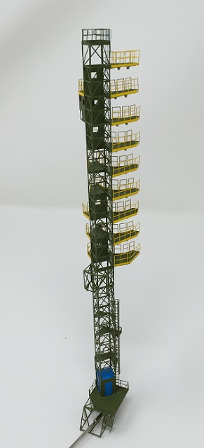

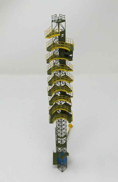

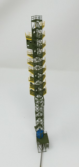

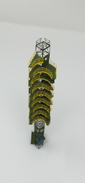

The service tower and railings are painted.The elevator is also done.next step is to add the ladders on the outside of the service tower (white ladders), add the lights under the platforms and finally put railings around all of the access platforms.

The railings have been added to the service tower.There are a couple of details to add, but it is getting pretty delicate to handle now so I will add those once it is installed on the base.
The next step is to build the second (right) service tower.This is similar to the left.It should go quicker now I have figured out where all the platforms go.
Once the second tower is done then the major construction phase is done.All that is left to do is add some small details and install the various towers on the base.
