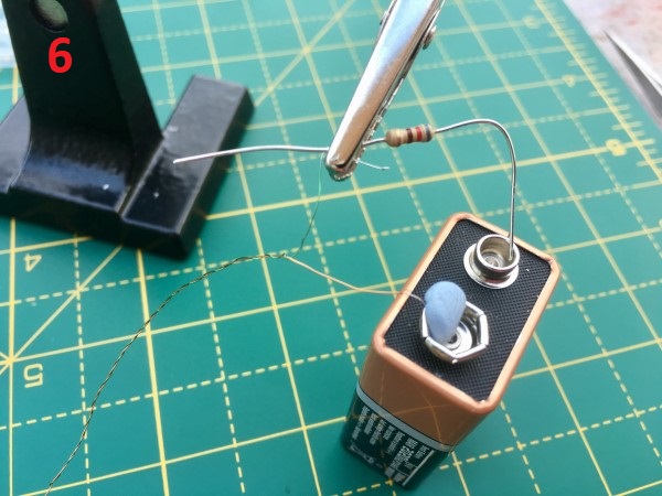

Many thanks for your kind comments guys, much appreciated. I've started C3-P0, soldering the smd's is very hard and you need a large eye glass. I've drilled out the eye piece in the centre of the model and put the smd's in, but one didn't work, as the solder joint came undone, so I've called it a day. Crying Try again tomorrow.

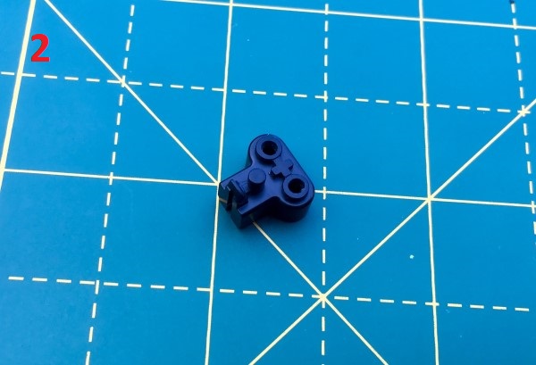

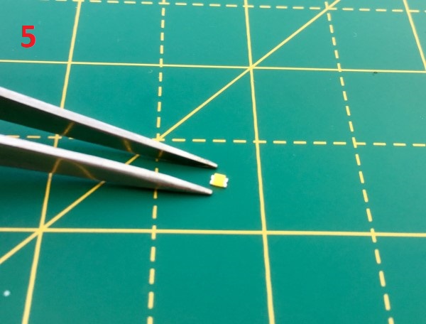

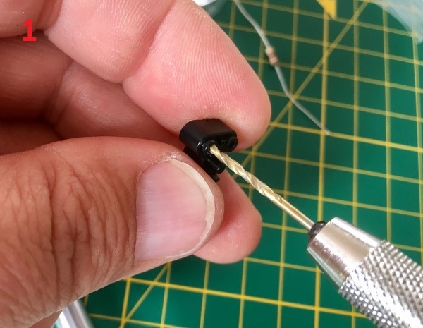

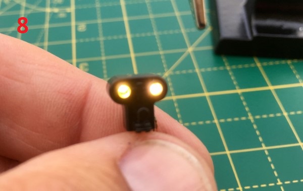

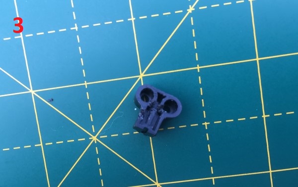

#67 Posted : 26 June 2017 22:45:02

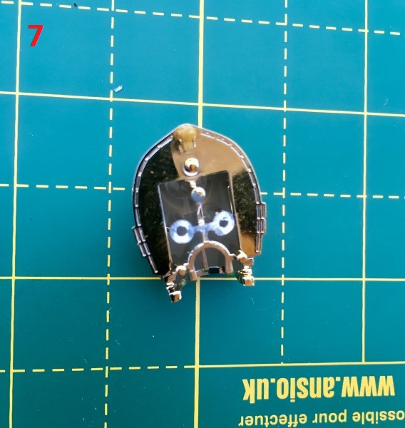

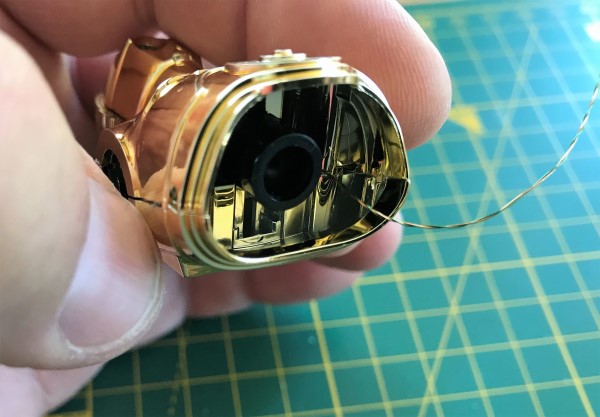

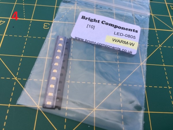

Pictures 1,2 & 3. Here, I have started C3-P0. I drilled out the inner eye piece, where I will be putting some warm SMD lights into the holes.
Pictures 4 & 5. As you can see here, I will be using 2 warm LED lights. Soldering these takes a very large eye glass as they are very small.
Picture 6. I used some fine coated copper wire and soldered it to the LED lights. I then tested the lights using a 9v battery and resistor, which will go into the leg area before attaching a cable through the foot.
Picture 7. I also cut away some of the internal rear head piece, to accommodate the altered eye part.
Picture 8. The final picture shows the LED lights in the eye section lit. A lot more to do with this area before the head is finished, as I want to tone down the lighting to make it more realistic. This will be done in my next post.
Thanks for looking.

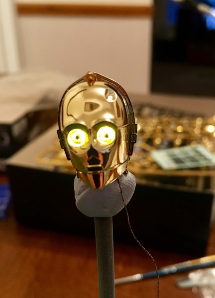

A little more to C3-P0 head. I have spent this evening just drilling out the clear eye piece you get with this kit, to emulate the eye piece. I then painted the eyes with Humbrol clear to tone down the lighting, rather than use the transfers that come with the model. The picture does look a little like a horror movie with his head on a stick, but you get the idea. I was quite pleased with how the eyes now light up.
Many thanks for looking.

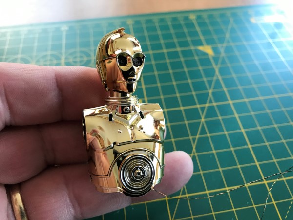

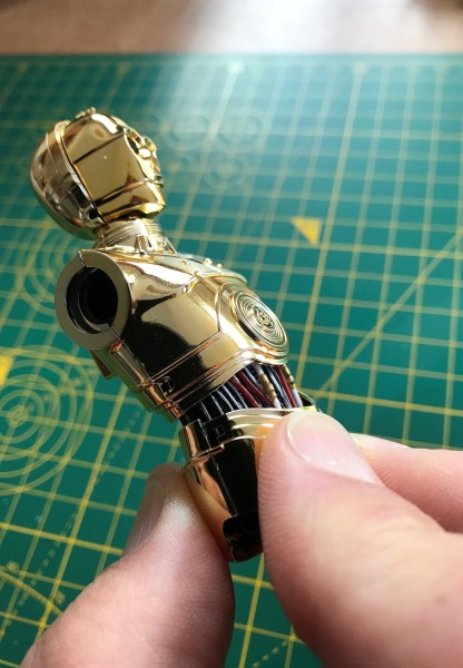

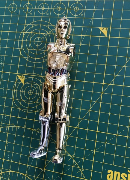

Just got back from my holiday, and I did contemplate taking something to do just in case the weather turned. As I was waiting for paint to set with the R2 and the Falcon build, I decided to take C3P0 with me to work on. The weather, unfortunately didn't disappoint. There was a moat around my caravan and no way of getting out for two days, I set too.
First, I passed the wire through the neck piece, anyone who has made this model, knows it is a solid piece with moving neck feature. I drilled a hole through the neck bolt and fed the wire through.
#71 Posted : 13 August 2017 18:22:37

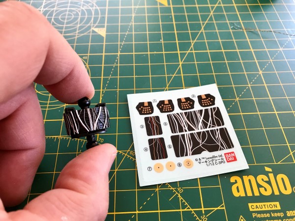

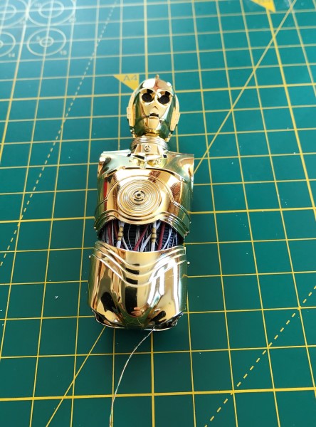

Next came the middle wire section. You have a decal to place in the middle section with the wiring loom printed. I wanted a more 3d feel to the piece, so I hand painted the wires to give a little more detail. Once this was done, I then drilled a hole to feed the wire through before connecting the bottom section.
#72 Posted : 13 August 2017 18:28:01

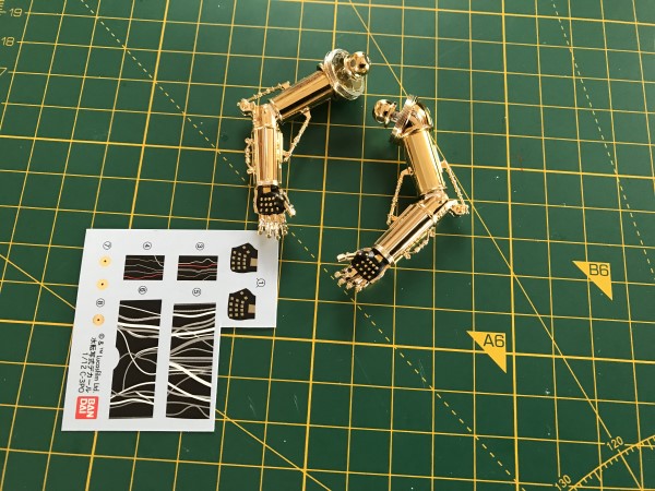

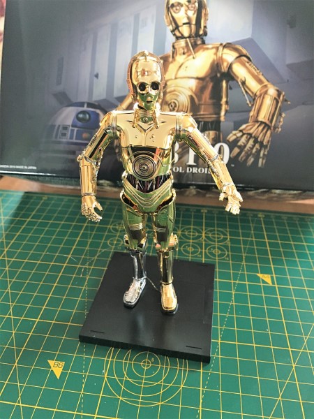

I then also decided to paint the gold pieces on the hand, as oppose to using the decals, it again gave it a more 3d detailing. Then it was onto the leg piece, this was not easy fitting the wire through and almost took me to drink, well almost. The second leg was quite easy and took a fraction of the time.
#73 Posted : 13 August 2017 18:32:35

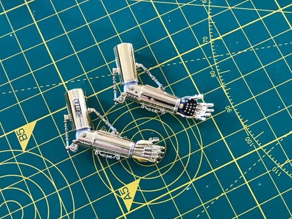

I then did the arms, painting the piston rods and the inner elbow joints silver. I also put some black wash on the arm joints to see how it looked.
The last picture is C3P0 complete before weathering.

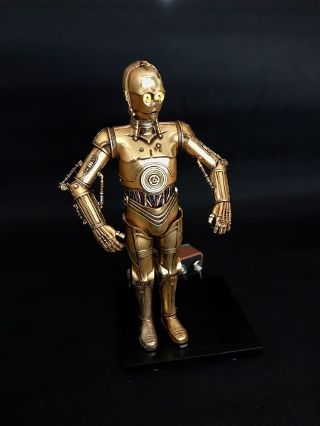

#75 Posted : 13 August 2017 18:37:00

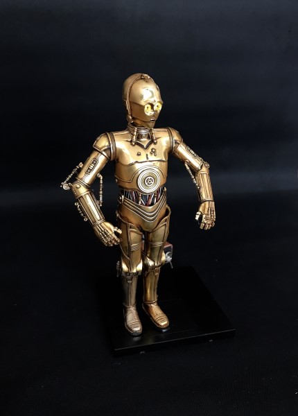

Here, you can see I have weathered him. I decided not to use the black wash, but used a brown track wash instead. I then varnished it, once this had dried and used a mig sand oils to give the final weathered look I wanted.
The last picture shows him weathered with his eyes lit as well.
So that's it for now, R2 still to be weathered and the base with the diorama.
Thanks for looking.
