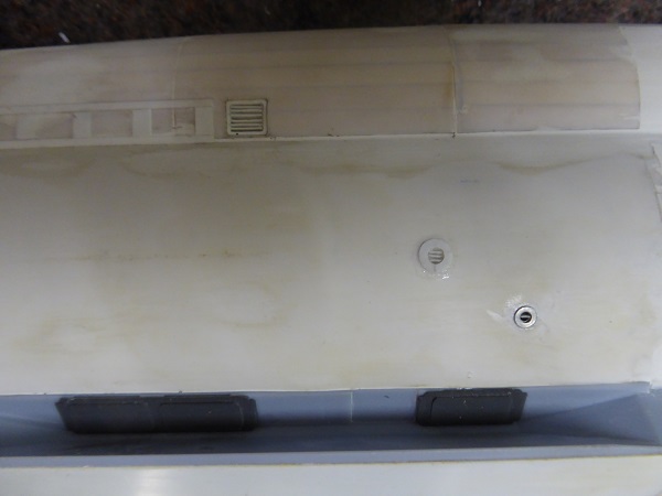

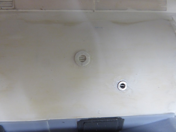

The smaller discharge ports were drilled with a 2mm drill. I then fitted one slat per discharge port and finished the outer diameter by gluing on a 2.5mm washer. I think this captures the feel/ look very feel very well.
The pics attached show a close up of these smaller discharge ports.

#63 Posted : 09 January 2017 22:31:51
These attached images show the completed Port Crash Dive Tank Vent and the large and small discharge ports situated near it. The other smaller one is near the engine room further back.

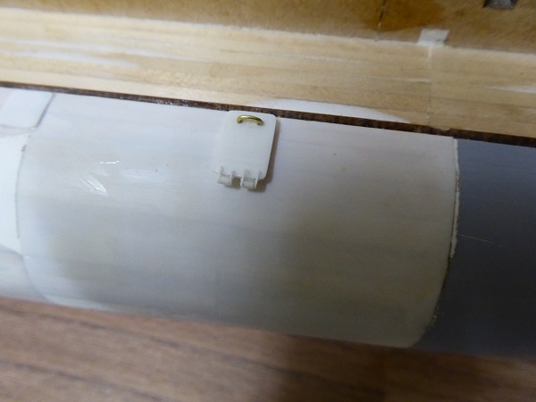

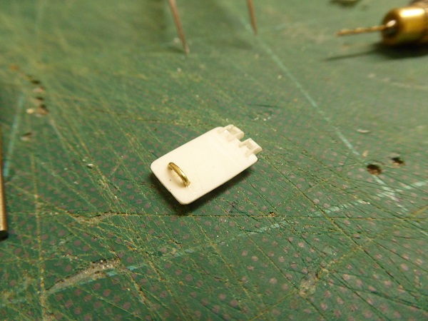

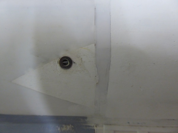

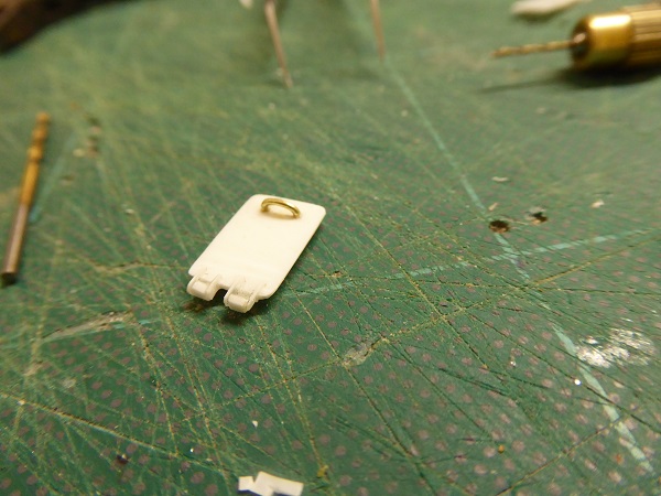

Next up is a scratch-built tank lid. Taking my references from images of U995 I fabricated one using 0.25mm and 0.5mm plastic sheet and a small piece of 1mm diameter brass rod to form the handle. Attached is the tank lid on U995 to give you an idea of it's size, location and shape.
#68 Posted : 10 January 2017 09:18:38

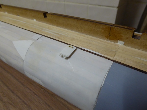

My scratch-built version took me about 4hrs to make. Very fiddly work. The miniscule hinges were all individually cut from 0.25mm thick plastic sheet. Tiny triangular shapes were all filed equal and glued to give the impression that they worked. Attached are the images of the completed tank lid.

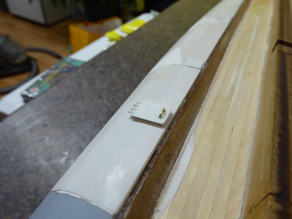

#69 Posted : 10 January 2017 09:26:02

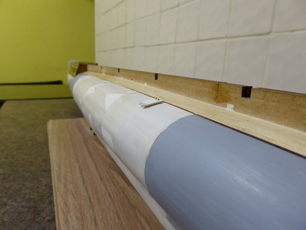

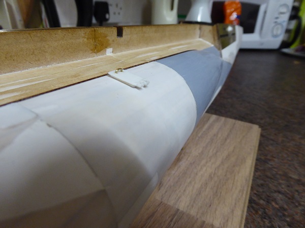

A piece of 0.5mm thick plastic sheet was cut slightly smaller than the tank lid top and then fixed underneath. This gives the impression that the tank lid itself overhangs it's opening as per the U995 photos. It was then filed to suit the slope of the port side saddle tank I was fixing it too.
Attached are the images showing it fixed in place.

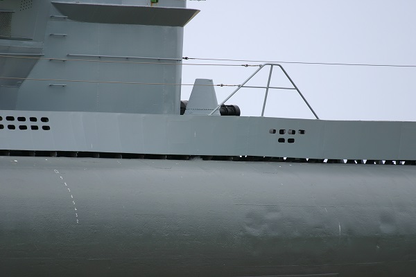

The next part of build concentrates on the removable super structure that fits on top of the saddle tanks.
After looking at the results in the partworks and comparing against photos of U995, I felt that the gap between the removable structure and the saddle tanks was too large compared to U995. Also the use of lime planking to fabricate the supports was, in my opinion, too thick. I was after a more 'fine-scale feel' in keeping with the real thing.
See attached pic of U995. See how the gap between the top structure and saddle tanks is nearly the same as the flood holes. Also note the recessed plate steel supports are lot thinner compared to the part-works.

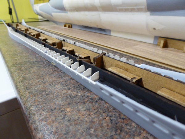

#77 Posted : 13 January 2017 00:02:54

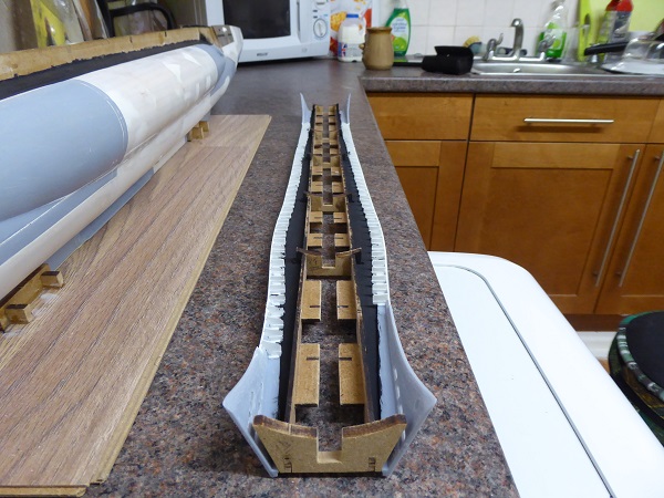

I decided to reduce the gap between the removable structure and the saddle tanks by gluing a strip of 1.5mm square plastic section to the edge of former. This reduced the gap to a more realistic size.
The plate steel supports as seen in the previous photo of U995 are recessed and of thin cross-section. For this part of the build I used 0.5mm plastic sheet.
93 individual pieces were cut out, glued in place then ALL FILED SEPARATELY TO SUIT. This feat alone took me about 40hours! A herculean task, but one i'm glad I persevered at as the results looks really good.
See attached image showing the removable structure inverted, showing the supports.
#78 Posted : 13 January 2017 00:10:24

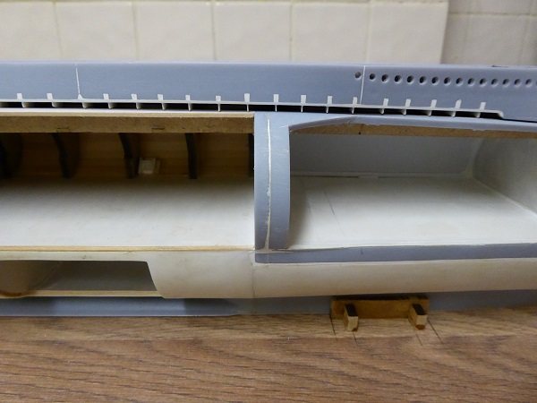

The next photos show the structure from different angles.
As a side note I built the main section of the removable structure as per the part-works. However, this required a lot of filing and fitting to get it to sit naturally without being forced into place; something i'm very keen on. If it doesn't go there must be an obstruction somewhere that requires attention until everything lines up correctly. A dry fit should be how it will be; glue is just a bonder, it won't make the parts fit together any better.

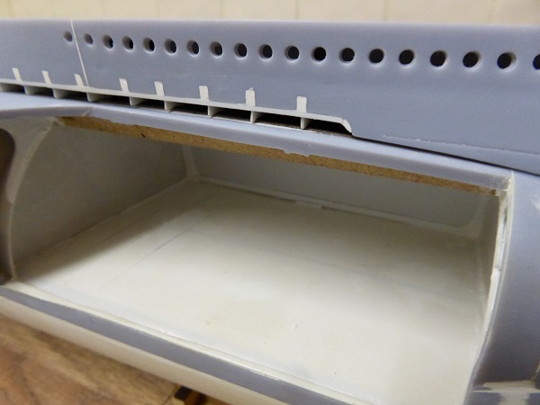

#79 Posted : 13 January 2017 00:13:19
The next image shows a close-up when the structure has been glued into place. If you compare it to the image of U995 earlier, you can see how I managed to reduce the gap and also create that 'fine scale feel' I was after by using 0.5mm plastic sheet.
