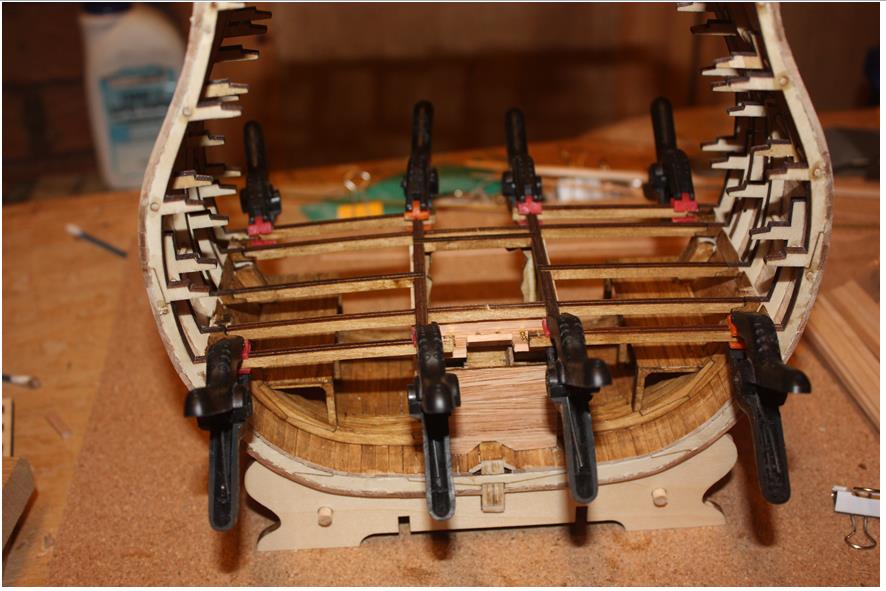

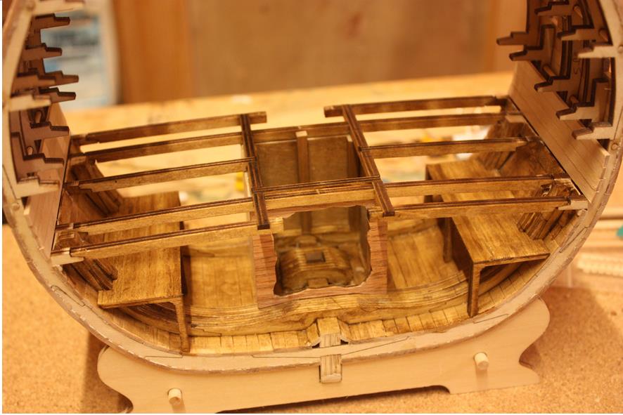

131 Contd - Adding the beams
As this build progresses there is no doubt that space to work will be an issue. My sausage fingers do not help. With that in mind I decided to assemble Parts 22,23,25,and 27 before gluing them to the ribs. It was easier to clamp the parts to ensure the glue would set without the parts moving. The assembled beams where then attached the ribs. The remaining beams where then added.

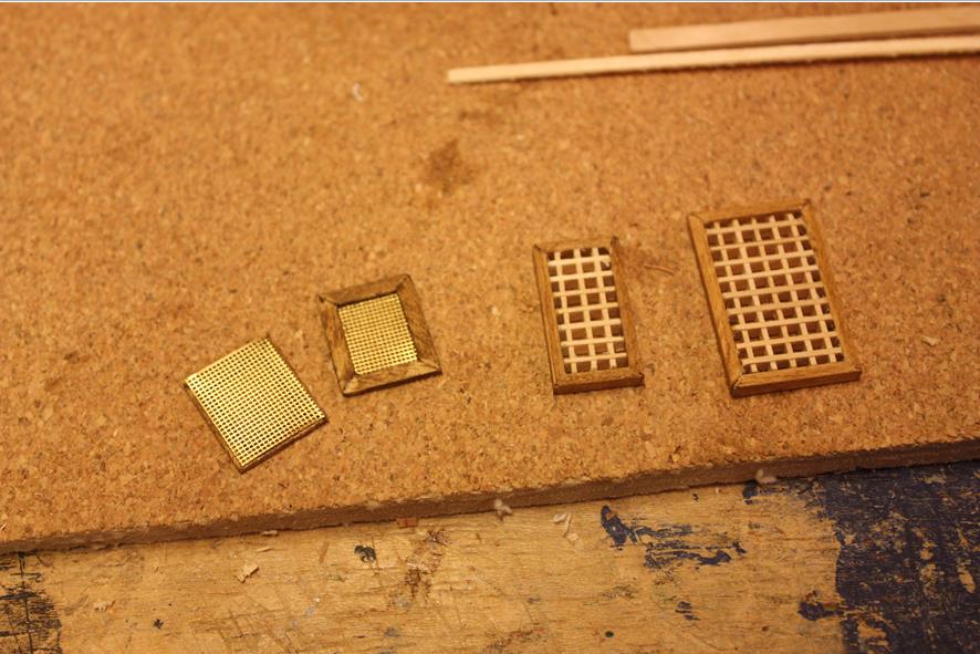

Deck gratings
With both the brass grating and the wooden grating i used mitre joints for the corners of the frames rather then butt joint, more fiddly but I prefer the look and no end grain to stain.

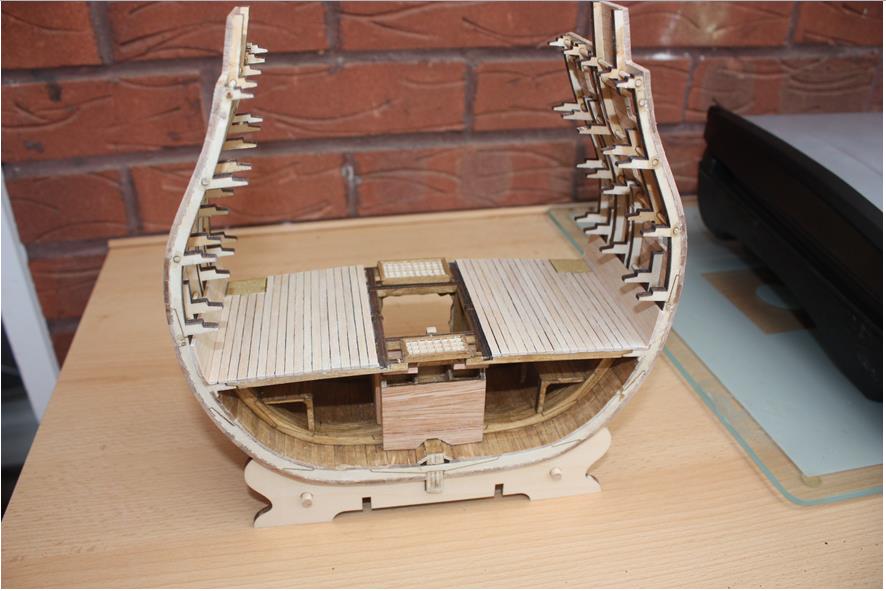

Issue 132 Contd :-
Been on the back burner for a while whilst Grandparent duties took precedence
The gratings have been fitted and the orlop planking added, using the supplied 1.5 X 4 mm (not 1 X 4 mm as printed in the instructions). I followed the instructions here and have not stained the underside of the orlop, but will be staining the deck itself. Not sure whether to add the effect of nails in the deck planking and will have to decide soon as once the next deck is added there will be very tight access to the orlop.
Issue 133 involves fitting frame reinforcements, Cutting the lower gun deck ports and completing the orlop planking
More to follow
