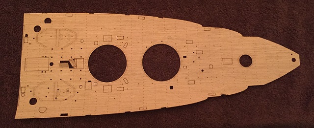

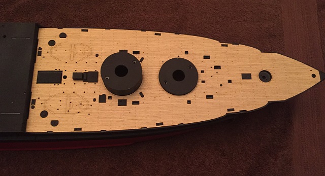

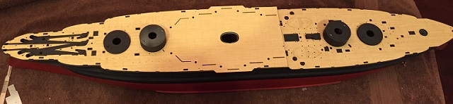

Now on to the decks.The detail set came with printed "wooden" decks with an adhesive backing.I have read nightmares about getting these decks to stick so it was with some trepidation that I started this.The first job was to remove all of the cut outs on the deck for the deck furniture. I then peeled off the adhesive backing cover and slowly stuck the deck down.I had to us a toothpick to make the deck lay flat around the raised deck details, but it went pretty smoothly and it looks really good. The next step is to put the main deck piece on.I am doing a bit of weathering on the holes for the anchors first and then I will apply the deck and add the MANY small details on the deck.

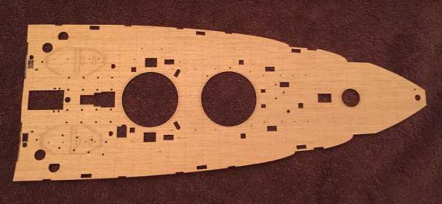

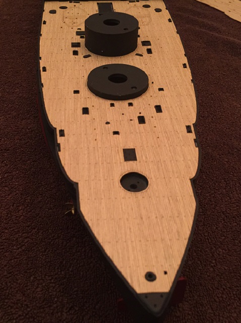

So the forward portion of the deck is now applied.This was a bit trickier than the aft section because of the anchor chain races.I had to go really slowly to prevent the deck from breaking as I was applying the decking around the anchor chain races.This decking material is actually a bit stronger than it looks.I am now in the process of painting the deck details (tons of them) and I have started work on the main turrets.
