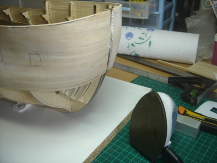

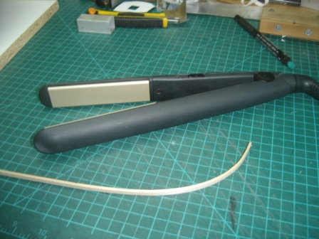

So here I am showing off my building efforts to my wife and she says "how do you bend those bits of wood like that?" so I says "I soak em in water for a couple of hours then run this nifty little iron I have over them then bend em over a cat food tin..smugly"
Then she disappears and comes back with this little gadget, "why don't you try this hair straightener?", quick as a flash I say "because I want the planks bent" "just try it" she says in a voice an octave higher.
So I soak the plank for a couple of minutes and realize this is a Eureka moment, not only does it do it in a couple of seconds it's also easy to control the shape of the bend.....awesome, and I get to keep it 'cos she doesn't use it any more...Bargain.

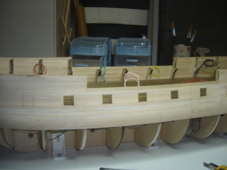

Busy cutting out the gun ports....managed 5 this evening, probably take me a week at this pace. Also installing the wiring for the LED's...

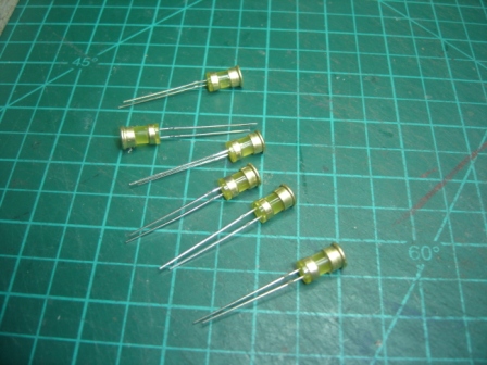

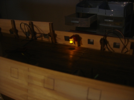

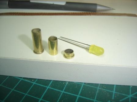

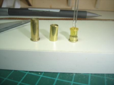

Then I was busy with the wiring and had a thinking moment...the interior lanterns, what if I obtained some 22cal brass bullet cases (5mm ID) cut them up a bit and fitted them onto 5mm LED's....
Barry

Looking really nice, keep the pictures coming. hope you enjoy your new plank bender.
Ian
#71 Posted : 20 June 2016 19:42:52
Ingenious work on the lantern.
WTG

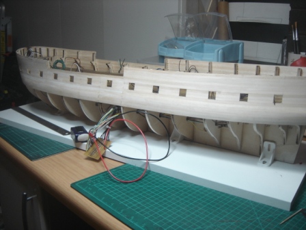

Thank you gent's, I'll put the lamp away for awhile and concentrate on the gun ports, got 10 cut out on the port side three to go and then start the inner planking, not sure whether I should line the ports at this stage?? Think I will just make me feel better....then off to the starboard side.
Barry

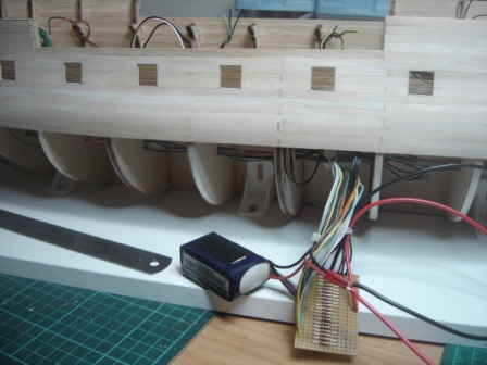

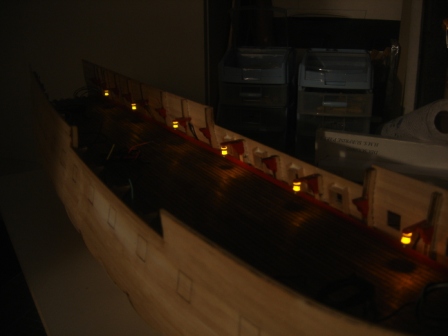

Managed to get all the Port side gun ports cut out today then a change of plan, finished the LED wiring (lots of it)and resistor board (borrowed a couple of ideas from Johncal)..just got to tidy it up a bit..managed to take a couple of pics even the lantern glowing with my trusty old Sony Cybershot...amazed it still works..had to read the book again though..
Barry

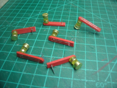

Here's about the sum total of my endeavors today, enough lamps for the port side, decided to do them now as fitting them at a later stage may have proved quite difficult..
Barry

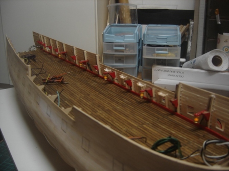

Fitted the lanterns on the port side, fitted the first plank on the inboard side after painting and also a few licks of red on the top deck supports, also started lining the gun ports...managed four of them tonight..
Barry
