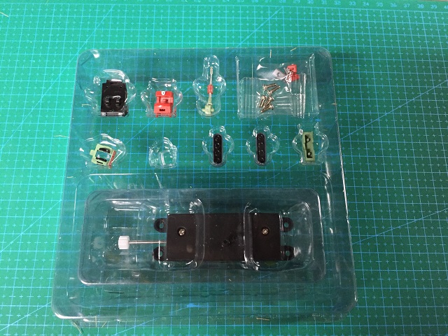

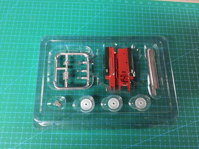

#64 Posted : 24 May 2017 15:27:12
Week 42.The motor for the legs in this pack and another thunderiser with a different attachment

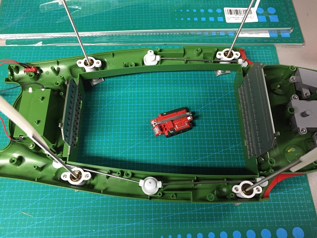

#65 Posted : 24 May 2017 15:36:33
Week 43.Installation of motor and final gears

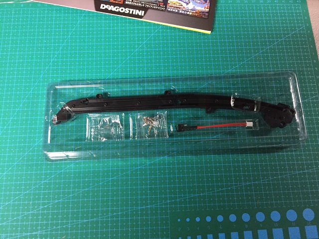

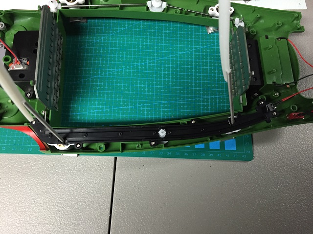

#66 Posted : 24 May 2017 15:39:48

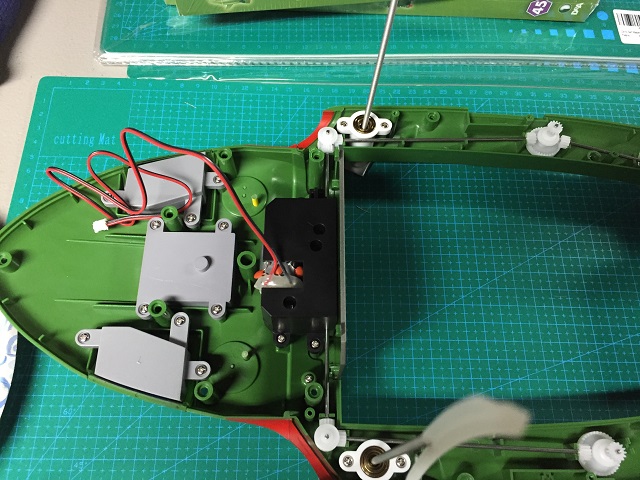

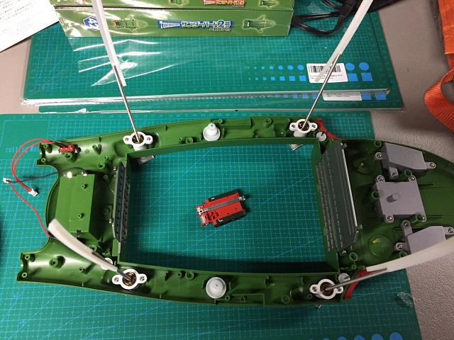

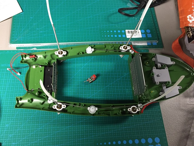

week 44
Here we install the final parts of the landing ear mechanims.This is a very clever design.There are geared strips attached to each leg which is actually a flexible tube.The gear strips are laid into the black channels.The re is a gear in the center of the channel that meshes with the gear strips so as the gear turns the strips push the flexible tube through the hole in the frame and extends the legs.There are sensors that detect when the legs are fully extended and retracted.
#67 Posted : 24 May 2017 15:41:29
week 45
The second black channel is installed for the right side landing gear.
