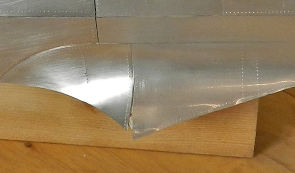

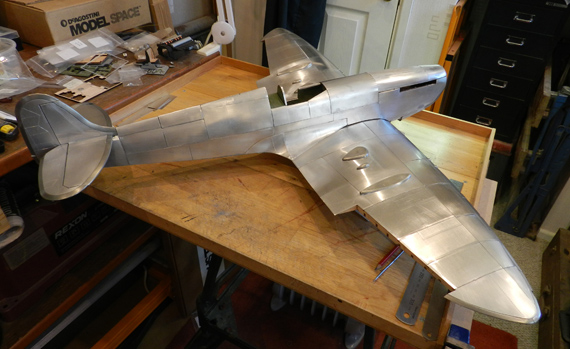

Hi Everyone,
Many thanks for your kind words.
Here is my latest update, all upper panels fitted to fuselage now, I have a problem with the over wing panels in that there is a tapering gap between them. Still thinking about the best way to deal with this and not sure that I have enough spare panels to remake them. Anyone else had the same problem?
Alec

#67 Posted : 29 September 2016 20:06:15
Well done Alec it takes a lot of hard work to achieve this stage, very neat and clean now looking to your next post, can you send a picture of the tapering gap.

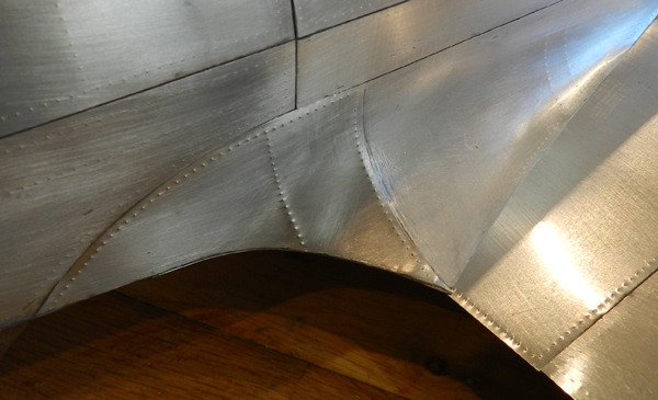

Thank you everyone for you interest and comments.
Trev I have at the moment put filler in the gap and will see how it looks when sanded down, I am concerned about replacing the panels as I may cause a lot of unwanted damage as this CA Gel really sticks well. Your policy of using screws is probably the right thing when problems occur.
Picture shows starboard side but is virtually the same on the port side I think that perhaps I should have shaved off a lot more of the formers underneath and increased the curvature.
I will send another picture when I have cleaned it up.

#75 Posted : 01 October 2016 11:10:22
Alec,
This is a difficult part with all the curves and trying to get it all to match up,but looking at your picture if it was me I would cut another panel the smaller one, but as for the gap, if you are painting your Spit with primer and paint it may hold in, only time will tell, depending on what type of filler you use, but this is only a very small gap Alec and with paint it would be hard to see.
Trev.
ALW

Hi Alec
I had the same problem. I made a new one and with a bit of filing and patience it fitted perfectly!

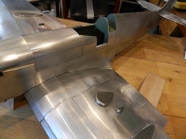

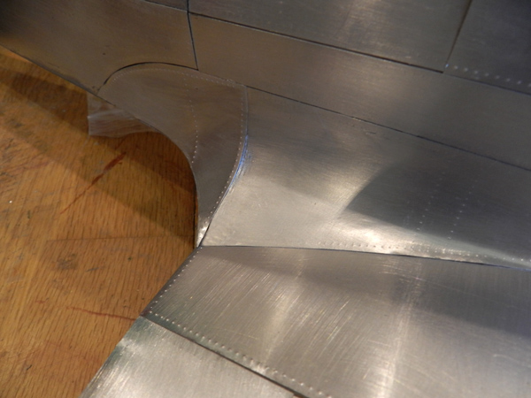

Hi Everyone,
Well I have sorted the over wing panels remade three of them and the final picture shows where I am at the moment.
Still a little more to do before I get the paint going.
Alec

#78 Posted : 05 October 2016 17:37:04
Great job alecBigGrinDrool lovely panel workDrool regards Phil
