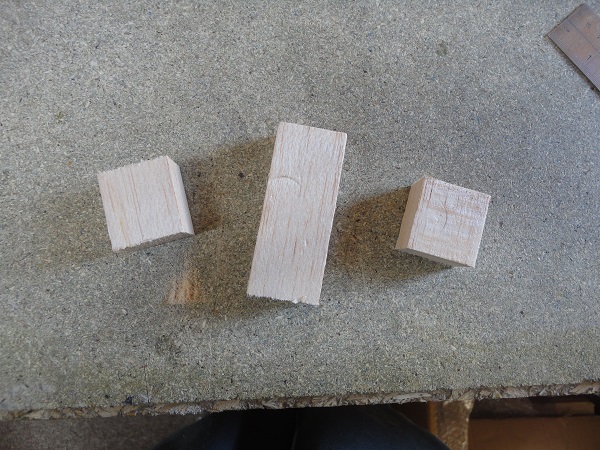

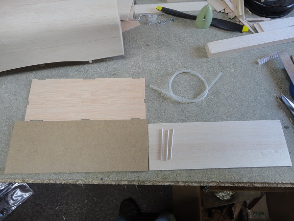

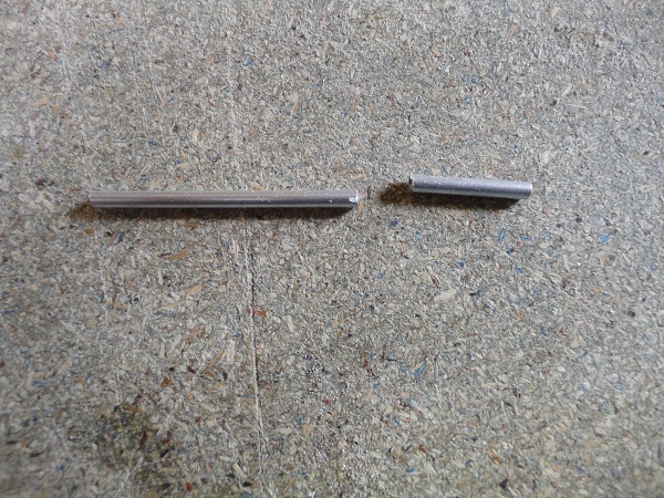

Parts supplied with this issue are balsa sheet 2x100x300mm, mdf base for wing jig, plywood base for wing jig, 3 aluminium tubes and silicone fuel pipe. (Pic 1)

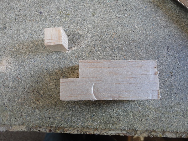

The first step is to cut using a razor saw one 80mm long and two 35mm blocks from the 20x32x310mm balsa baton supplied in issue 13. (Pic 2)
Next a 15mm by 15mm notch in the 80mm long piece. (Pic 3)

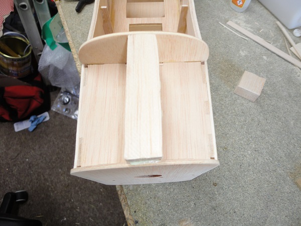

This piece is then glued to the centre of the fuselage base between bulkheads 1 and 2 with the notch to the rear of the plane. (Pic 4)

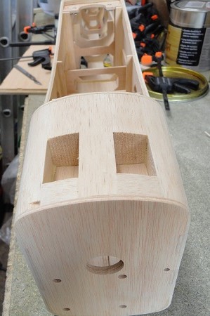

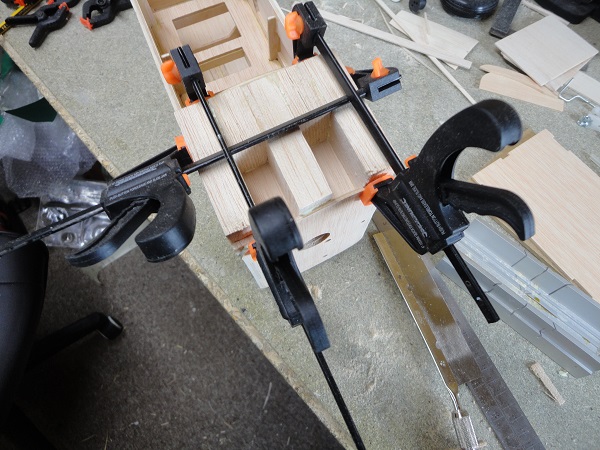

Next one 79mm and one 81mm long pieces are cut from the 20x32x310mm balsa baton. These are then glued and clamped in place along with the two 35mm long pieces to the fuselage base. (Pic 5)

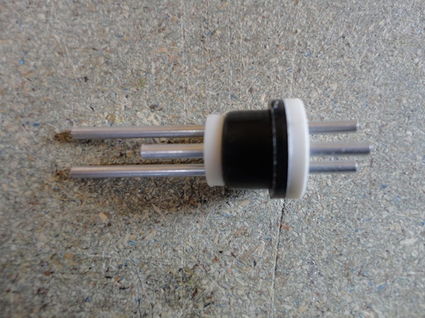

While the glue sets one of the aluminium tubes is cut to 45mm long and then he fuel tank cap is assemble.(Pics 6 and 7)

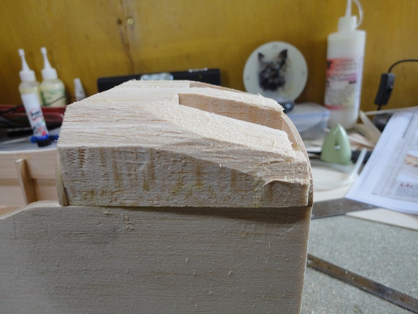

After the glue has set the clamps are removed and two 20mm long 13x38mm baton are glued in the gap at the front of the fuselage. The majority of the batons then cut away and the sanded back lever with the bulkheads. (Pics 8 and 9)

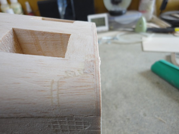

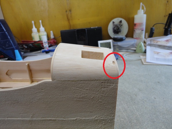

When cutting back the batons a piece of one broke off leaving a notch which can be seen in picture nine. I filled this with a piece of 4x4mm stringer and sanded flush. (Pics 10 and 11)

I notice that your clamps are leaving indents in the balsa. Have you considered using small pads of sacrificial balsa between the clamp faces and the model parts, it would save a lot of sanding/filling? Just a constructive thought that might help. Cool

Kev, thanks for the advise on using pads to stop the clamps marking the balsaCool.
