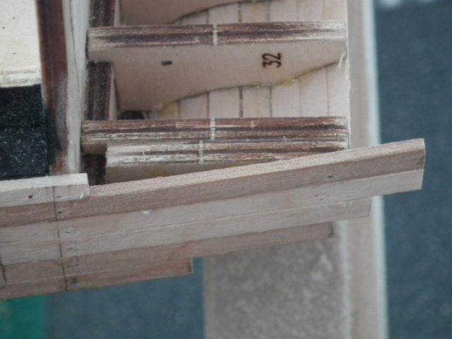

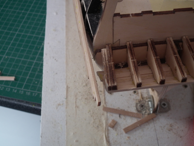

So after having my PC fixed and returned to me a week later than scheduled I discovered that I had managed to lose all my documents - including my Victory photos.
Thankfully I managed to recover virtually everything using a wonderful piece of software called "Recuva".
I am therefore able to post a few pictures of the port aft quarter where I had to cut away the planking from the ribs to make the por and starboard sides level. I still need to take some pictures of the completed repair and the start of my porthole cutting.
More pics soon!

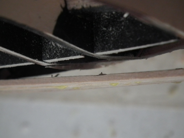

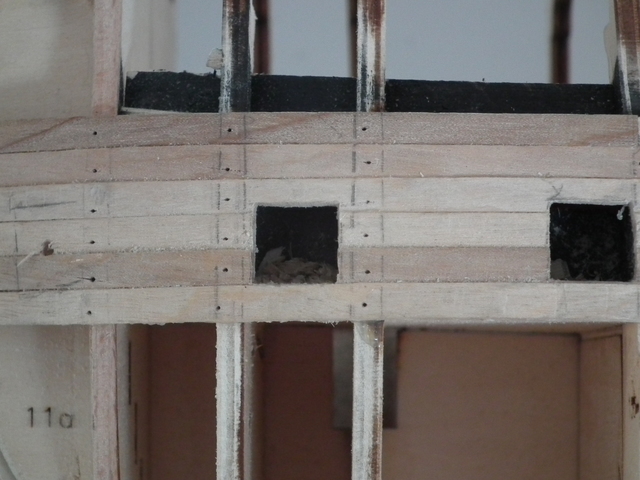

Not much progress on lower deck gunports but I have started several with the intention of trimming and finishing them all. I'm drilling a series of 2mm holes inside the gunport outline; cutting between the holes with a knife and finishing with a file of sanding stick.
I have attached a couple of photos showing the intact port aft corner and the beginning of gunports. Pack 4 is due this month so I had better get my act together.
Will keep you posted.

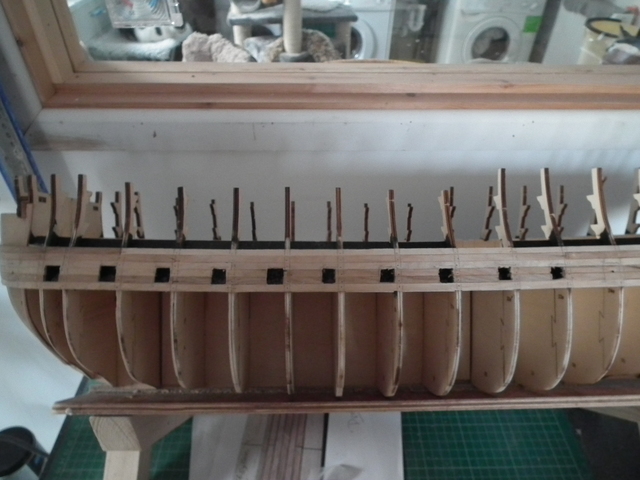

Hi everyone!
It's been a long time since I have done anything to the model but tonight I cut out some more of the lower gunports so we're back in business!
However, I noticed that when working on some openings the adjacent planking seemed to be flexing so I made up a thin PVA solution, put the model on her side and brushed it over the planking around the gun ports. It should get into any small gaps between planks and provide some reinforcement.
Well boxes 4,5 and 6 are stacked up and 7 is due at the end of this month so I have plenty to get on with.

Glad you are back with her!
It`s generally a good advise to apply diluted wood-glue throughout the inside of the hull for more stability - not just around the gun-ports.
Keep up the good work!
