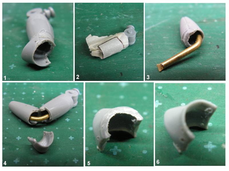

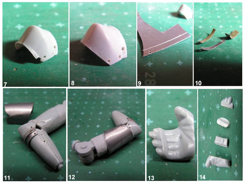

Moving on to Frederick's right arm!
In Photo 1 the entire right arm from the shoulder to the forearm has been glued together and after sufficient time to set hard the forearm section has been sawn off leaving the elbow joint still attached to the upper arm, (as in the left arm, the wrist and hand is a separate section again). As you can just make out in this pic and a little clearer in the following ones, we have the same ‘universal joint’ at the shoulder, this was kept moveable to allow final positioning later and the flange or rim at the extreme end will be sanded away in order to allow the ‘plug’ to fit into the torso. If I’d been building this out of the box of course, that flange would have been secured between the two torso halves to allow some degree of movement (as would similar fittings on the legs). You can just make out the ‘chain mail’ effect beneath the elbow joint, this is also found under the forearm piece as well and both parts of the arm have had the mail trimmed back at about 30 degrees from the moulded on strap around the elbow, this will allow the arm to be bent to almost a right angle as shown in Photo 4. Before we get to that point however, once the elbow joint was removed completely I used masking tape to cover the upper arm plate known as the “Rerebrace” and to mark out the outline of the plate, this will be replaced by a tuna tin version to match up with the left arm. More on that piece a little later on! With the Rerebrace marked up and cut out of the tin, the next job was to fix the two, now separate halves of the arm back together in the new bent position. In Photo 3 the thick brass rod, bent at ninety degrees, and cut to fit the hollow arm sections has been super glued into the forearm. You can just make out to the left of where the brass rod enters the arm how the mail has been filed back at that steeper angle mentioned earlier. In Photo 4 the protruding brass rod has been super glued into the upper arm, securing the limb in the bent position. As well as the super glue, the two mailed parts of the plastic are also touching each other so polystyrene glue was applied there to fuse the plastic parts together as well. In the foreground is the elbow joint removed at the beginning, however, to get as it looks here, there were a couple of extra jobs to do as you can see in Photo 5. That photo shows the elbow piece as it was immediately after cutting it away from the arm sections. There are a couple of plates to be made from the tin, which allows the elbow to flex in real life. Unfortunately, these plates protrude from under the elbow and to allow those to be put in, the thick plastic of the kit part has to be ground down to as close to a scale thickness as possible as illustrated in Photo 6 (and also Photo 4 which was taken after this was done!) Apologies for the focus on that one! Unfortunately for me, the thinning down process revealed a little flaw in the moulding on the inside of the elbow piece which resulted in the loss of the extreme bottom of the little flange which runs around the edge of the elbow as shown in Photo 7. This left me with two alternatives: either to try and fill in the missing bit or to remove the entire flange and add a new one out of the tuna tin. Trying to fill it was probably going to be a heap of trouble, not only was the missing section really thin but it would need a hole drilling through it for the rivet as well. As you can see in Photo 8, I opted to remove the entire thing and make up a new replacement. After cutting a couple of strips and trying to drill the rivet holes into them I came to the conclusion that the strips were too thin to take the drill bit without spreading the edges out of shape. The method I came up with to solve that deformation problem is shown in Photos 9 and 10, put simply, I just cut the initial strip twice as wide as it was supposed to be, drilled the holes and then trimmed it back to size in width and length as seen in the second photo.
In Photo 11 things have moved on a little with the new flange super glued to the elbow, the elbow itself glued into the gap between the two ends of the arm and the second separate hinged plate glued in place under the flange. The elbow was super glued on the new metal flange side and polystyrene glued on the plastic to plastic side. As you can see there is a fairly large hole or gap below the elbow which I was all set to fill with Milliput but in fact there’s no need as there is another piece of armour called a Couter (which I’d forgotten all about until I looked at the instruction sheet again) which covers up the whole gap! There is a much smaller gap on the other side, which will need filling however. In the background is the new metal upper arm plate which will be glued over the plastic moulded original, this is shown sprung in place in Photo 12, it butts right up to the elbow piece as you can see here and the edges of the moulded original plate will be sanded down and blended into the mail so that the ‘proper’ mail effect will be able to go in tight under the new plate later on.
Finally, in Photos 13 and 14 we have the kit right hand which, as mentioned much earlier will need more ‘adaption’ than the left one which was only gripping the shield straps. Frederick’s right hand will be holding the hilt of his Battle Sword and will therefore need to be cut into four parts at the knuckles as shown in the final photo. These pieces will be glued back together after some sanding off at the joins to impart a bent grip. More on this and the even more complicated Gauntlet in the next instalment!

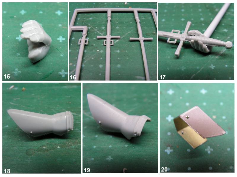

Carrying on with the right hand Gauntlet ...
Photo 15 illustrates the right hand re-glued back together after sanding the edges of the individual parts to create the ‘clenched’ hand. This angle does fore-shorten the thumb unfortunately but it was still the best pic I took! In Photo 16, we have the kit supplied parts for Frederick’s main armament still on the sprue, namely his Battle Sword. This is one part of the kit where I can’t help question the thinking that went into the design of the components. On the left is the empty scabbard, in the middle is the sword inside the scabbard and on the right is the ‘naked’ sword. As far as I have found so far, this is the only kit in the series which supplies both the sword, sword in scabbard and an empty scabbard. Most of the other kits have just the sword and the sword in the scabbard, the instructions showing how to make the empty scabbard by cutting off the sword hilt – which, of course is a perfectly logical way to do it! As it happens however, the way that this kit is supplied is a Godsend to me – just as the Samurai always carried two swords – the Katana and the shorter Wakasashi, the European Knights of this period always went into battle with their Battle Sword and a (usually) matching long dagger. Sometimes called the Misericorde, this dagger was both a secondary back up weapon and also the means of administering the ‘coup de grace’ to a fatally wounded enemy – literally putting him out of his misery! So for me, the inclusion of the sword in the scabbard is great – I’ll be using it, shortened down a bit to create the dagger, but it would have been an even better use of the kit plastic to supply either a second right hand in the same ‘gripping’ position as I’ve had to create or even the sword with a hand already moulded on the hilt. Still, where would we scratchbuilders be if everything were done for us!!
Photo 17 shows the effect of the re-animated hand using the scabbarded sword as a test (this is the one which will become the dagger further down the line). Those square extensions on the scabbard are supposed to be used along with the kit polythene belt material but I’ll be removing them later and building a more authentic leather and brass scabbard suspension system. With Photo 18, we are moving on to the steel right Gauntlet. This will be explained in two phases – Phase 1 being the initial plan and Phase 2 being the additions added because Phase 1 didn’t work, actually Phase 1 did work – it just didn’t work enough! Unlike the left Gauntlet (which I didn’t need to alter from the kit) the right hand one has three hinged plates (the other one only had two). These are all overlapping in the ‘lobster plate’ fashion and in the first photo here the kit halves have been glued together and the end plate, like a steel mitten has been cut away from the rest. You can see the two moulded in plates here and my initial plan was to file down the outer plate, replacing it with a tuna tin version together with a tin mitten to replace the previously cut off plastic version. Photo 19 shows this in process with the outer plate reduced down to the level of the inner one whilst Photo 20 shows the first stage of creating the metal replacement plate. A strip of the tin has been cut to size, the ‘V’ shape bent into the centre and the two side panels bent down to fit over the plastic section before the two holes were drilled in for the brass rivets to follow later. The holes were carefully placed to match up with the moulded on rivet heads on the plastic part which were then sanded down and drilled out as well. The next stage was to create the outer-most plate as illustrated in Photo 21, here the tin has been bent to the basic shape to fit over the preceding section and the outline of the edge has been marked in prior to cutting out. The first plate has been super-glued to the plastic kit section in this photo. The basic shape of the plate has been cut out in Photo 22, the rivet holes drilled out and the two plates fixed together temporarily with a simple ‘hinge’ of brass wire. The edge of the new plate is still in need of some gentle sanding down to round off the angular bits. All of the tin plate is being cut to size with my pair of trusty scissors – I’m probably ruining the poor things as I go but in any case, they were part of a multiple set of scissors in the Pound Shop – so not the end of the world (although it still makes me feel guilty spoiling any tool!)

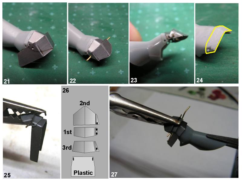

In Photo 23 we come to the transition point between Phase 1 and Phase 2. This picture shows the gauntlet with as much bending as it can do without a great gap appearing between the two metal plates. Unfortunately, since the right hand is much more shortened in the act of holding the sword hilt, this just isn’t enough to follow the shape of the fist. The reasons are obvious enough of course; the middle plate is glued in place and cannot move and also, it’s glued to the first plate, which is still a part of the plastic kit part, which also cannot move! The only answer is to return to the plastic original and remove that plate too, replacing it with a third metal plate which can be used to begin the flexing of all three moveable parts. After carefully removing the super-glued middle plate I was left with the kit part shown in Photo 24 with the moulded on bottom plate outlined in yellow. This section was then sanded down until flush with the surface of the rest of the gauntlet and then I could begin to design the third metal plate replacement. This one was a nightmare! Unlike the other two plates which are basically parallel in plan view (see Diagram 26), this one is angled slightly at the back to match the moulded original, it’s bent over at the top (as are the other two) but more importantly and more difficult to get right, it’s also angled outwards from front to back where it follows the shape of the back of the gauntlet. I eventually managed to get the shape right as illustrated in Photo 25 where the third plate is being gripped in the helping hands crocodile clip so I can make an initial mark through the rivet hole to drill out the hole in the new plate (incidentally, I’ve just realised the little side view of the third plate in the diagram should have two holes in it, just like the middle plate!)
In the final photograph Photo 27, the now drilled out third plate is pictured set over the plastic gauntlet for a final test fitting before the excess side plates are trimmed back to size. As you can see, there is now a second brass wire hinge joining all three moving metal plates together.

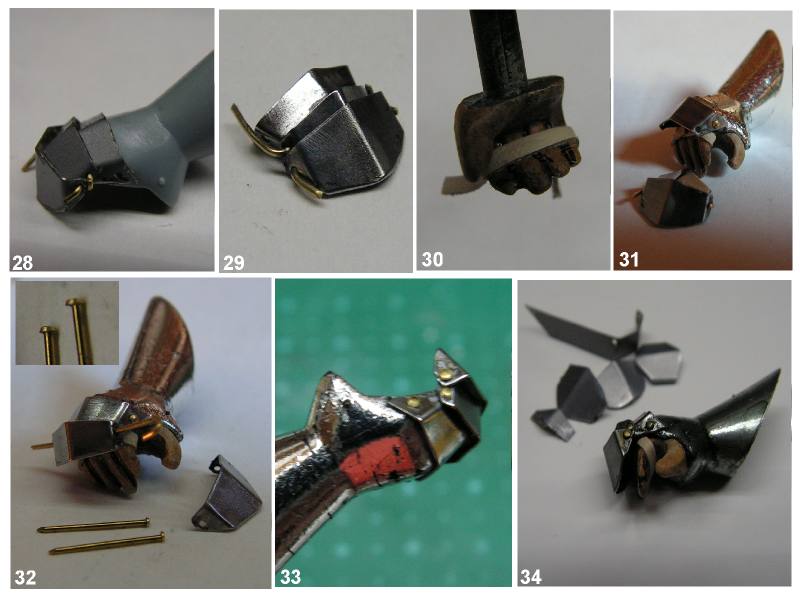

Posts: 2,083
Points: 6,244
Thanks again to Martyn, Kev, Paul and Dave, gratefully received once more! This has been the most fiddly bit up to now, unless you count the ongoing experiments into scale chainmail - that's not just fiddly, it's the cause of more swearing than I'd care to admit to! I'm on my third variation at the moment!
Anyway!..
Photo 28 carries on from the last posting with the additional plate now trimmed to size and test fitted to the plastic gauntlet. You may have noticed in some of the earlier photos that there is a moulded rivet as shown here down at the bottom right, which seems to have no purpose. In actual fact this one did have a purpose but no longer, (at least not according to the current suit of armour in the museum). The box top art does show this rivet still in use however – it was originally used to secure additional armoured protection for Frederick’s thumbs! At some time during its history, the armour has lost that piece – either discarded for some reason or else removed and not replaced when the leather straps throughout the suit were replaced during a museum ‘re-furbishment’. Either way, they are not visible on the armour as currently displayed in Vienna. I may well add them back in during the build, the little (tiny!) thumb bits can be simply glued on afterwards. Following Kev’s advice, the individual plates were given a good going over with the rotary steel brush and polishing felt do-dahs to remove the factory ‘tuna finish’ and bring them up to a good shine as shown in Photo 29. This was done with the plates still joined together by the brass wires and before the final ‘riveting’ the individual second and third plates were taken apart again and the sections previously covered over and still tuna-ish were also polished up. Before fixing on the new plates, the hand was first primed and then painted in a mixture of Vallejo and Admiralty paints to match the previously made left hand and the leather gauntlet strap was super glued across the palm and to the back of the hand (seen halfway through the process) in Photo 30. The rearmost plate has been fixed to the kit parts in Photo 31 whilst the second or middle plate is being test fitted using another brass rod in Photo 32. Also shown in this pic are the next two brass rivets to be added on. These are standard brass pins from Amati, they are obviously way too long and are trimmed down to size before being passed through the drilled out holes through the metal plates. Unfortunately, they are also slightly oversized when it comes to the pin-heads which eventually become the rivet heads once in place. It was necessary to place each pin into the pin-vice (ironic!) and then gently run the heads along the flat diamond dust file, all the time slowly turning the pin vice between thumb and forefinger to evenly file down the diameter of the brass head. The finished rivet is about half the diameter of the initial brass pin when finished. I did try to photograph a cut down rivet for comparison but even my macro setting wouldn’t focus on that! Note the last of the three plates sitting in the foreground which has been fixed into position in Photo 33. Unlike the shoulder armour which I tried to actually rivet to keep the flexibility of the plates, the gauntlet plates were just too small to attempt to do that, instead, each plate in turn was fixed on using the brass wires, then bent into position and secured there with a drop of super glue placed into the joint from the inside. Once set in place the rivet was cut down and super glued into the lined up holes now vacated by the wire, so in this instance, the brass rivets are solely decorative – not functional. Placing the super glue on the inside of the joints wasn’t as difficult as it might have been, as you can see in Photo 33, the hand is no longer inside the gauntlet – not exactly planned I have to admit, I stuck the gauntlet back onto the end of the bamboo skewer to photograph it and forgot the hand had been glued over the hole through the wrist – pop, out it came again! You might also notice in Photos 31 and 33, the silver gilding looks pretty banged about. That was my lack of advance planning, I silver leafed the plastic cuffs first and then completely mucked up the finish with the constant handling required to fit on the metal plates. Fortunately I had the excellent tutorial on gold leafing by Ken (Kpnuts) to follow and, with careful use of a drop of methylated spirits and my old toothbrush I scrubbed off the dilapidated silver back to the untouched matt black primer spray and then re-sized and re-gilded the plastic again. Once repaired, both the new silver leaf and the polished tin components received two thinned down coats of the Humbrol Blue-Grey Enamel Wash, given 24 hours apart and the result is shown in Photo 34 – the silver leaf and the metal parts have blended together really well with a very pleasing ‘polished steel’ effect overall. In the background are some of the metal plates which weren’t ‘quite right’ (all right, they didn’t fit!)

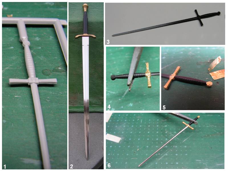

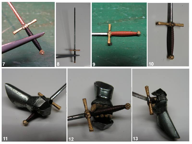

The Battle Sword
In Photo 1 we look back to the picture of the Battle Sword still on its sprue. This is a type of sword commonly known as a “Hand and a Half”, larger than the swords wielded by the likes of the Normans a few centuries earlier but smaller than the true ‘Broadsword’ which was a two handed weapon. For comparison in Photo 2 is my own Battle Sword (combat ready with a tempered steel blade). Mine has a slightly wider blade although she is leaning back in this photo, which makes the blade seem wider than it really is, but still a ‘Battle Sword’. In actual fact this type of sword was also known by a slightly more basic name – its also called a “barstool”! The term barstool was used for many items of medieval weaponry – it simply meant that the weapon was in between two other classes of weapon, ie, not a one handed sword but not quite a two handed either. Once the weapon had been removed from the sprue and any flash carefully sanded away it was time to prime the plastic. Again, I’ve used the matt black auto aerosol paint from the Poundshop, the first thing to decide however was how I was going to hold the thing during the painting and gilding. The obvious answer was to grip it by the hilt as this was the only part which would be hand painted: (thicker paint) and half of it would be hidden in the hand anyway! The top half of the sword was therefore sprayed black first as shown in Photo 3 and once that was dry I could use the spring tweezers to grip the hilt to complete spraying the blade.
With the sword primed the next task was to gild the cross guard – this time using the little pack of 24 carot gold leaf. The cross guard was given a coat of the gold size and forty minutes later two little strips of gold leaf were applied and brushed into place as shown in Photo 4. This was before the leaf was given a slightly stiffer brushing and a smoothing over with a cotton bud to flatten it down properly. This was followed the next evening by gilding the brass pommel (with a couple pieces of the leaf shown beside it) in Photo 5. For the last bit of gilding it was back to the silver leaf again to cover both sides of the steel blade as illustrated in Photo 6.
If you look again at Photos 4 and 5 you can just make out a slight difference in the colour of the cross guard – Photo 4 is the raw gold, (admittedly before it was smoothed down) and Photo 5 is the same gold with a light wash of Humbrol Rust Enamel Wash. I actually removed most of what I put on but the slight tinge of reddy brown serves to change the gold leaf to a more brass looking colour. I’ll probably find out later on that Frederick, being a Prince of the Rhineland had gold furniture on his sword! The ‘brass’ then received another going over with the Humbrol Enamel Wash, this time with a simple thinned down Black just to accentuate the detailing on the cross guard and pommel as shown here in Photo 7. This was then followed later with the Blue-Grey wash to tone down the ‘shiny silver’ of the blade itself. The finish shown in Photo 8 was found to be a little bit ‘over the top’ after it had dried, (and also seemed a little ‘lumpy’ too so I took it off again by just dipping a largish soft brush in white spirit, running it over the blade and then carefully wrapping a piece of toilet tissue around and gently pulling the blade out of the tissue, removing the initial Blue-Grey wash in the process. After that I simply repeated the application with the wash thinned down a little more. The rest of the photos show the later, improved ‘steel’ tone. With the metal work completed, all that remained was to work on the ‘leather’ bound hilt. I did try a few experiments using the very thin brass and copper wires, binding the hilt with them but a) It didn’t look as good as I thought it should and, b) with the wire wrapped around, the ruddy hilt wouldn’t fit in Frederick’s hand any more! So leather it would have to be! The first task was to give it a good coat of Vallejo Red Leather as shown in Photo 9. As soon as that was dry I decided that I preferred it in the black!Blink Never mind though, after a couple of hours to dry completely, the overly bright Red Leather received a wash with Citadel Skaven Brown Acrylic Ink Wash which, as you can see in Photo 10, brought it back to an ‘almost’ black with a quite pleasing tinge of brown included. The last three photos, Photo 1113 illustrate the finished article with Frederick’s Battle Sword super glued into his right hand. I included the three views mainly to illustrate how well that Blue-Grey Enamel Wash has blended the silver leafed plastic parts into the polished metal sections to create an overall metallic effect.
In the next instalment, a part I’ve been secretly dreading for a while now – blending the up-graded arms into the torso with Milliput epoxy putty (left arm is virtually done now and it wasn’t as bad as I feared!)Cool
(Oh nearly forgot to mention both Frederick’s sword and parts of his armour will be sporting some drippy red stuff in the future!)
Robin.
