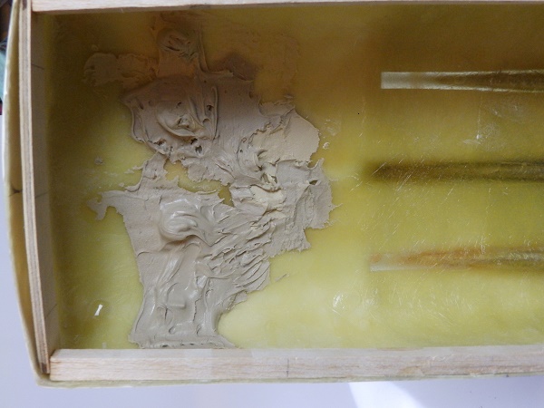

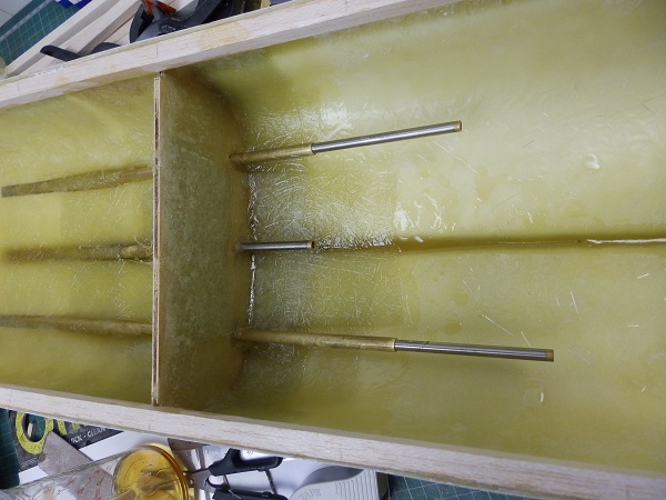

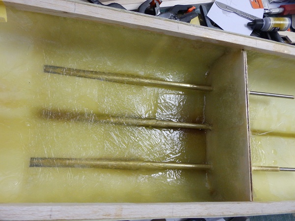

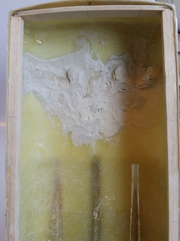

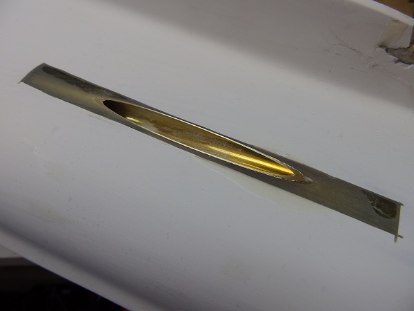

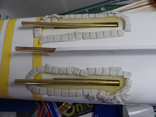

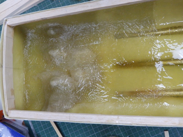

BigGrin Hi All
More done the shafts have had more glass fibre cloth added to the hull along with the bulkhead being permanently fixed using more resin and glass fibre. After the resin had set the inner two shafts [no's 2 and 3] from shaft 1 and any resin removed and all was checked to see that they still assembled correctly.

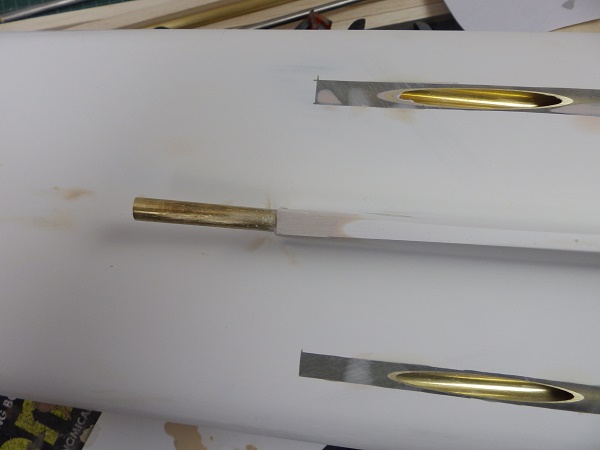

Next a dam was made around the shafts on the outer hull and resin poured into the hole cut for the shafts to go through again once the resin had set the excess brass tube was removed from the outer hull. Now its a case of sanding back the resin/brass till it conform's to the hull shape, the dam leaked a little on one side but the two hollows can easily be filled with P38.
Next job will be to fit the three A frames to the hull and shafts but that will be done after the P38 is used to restore the centre keel and any other things that may need filling. More soon.

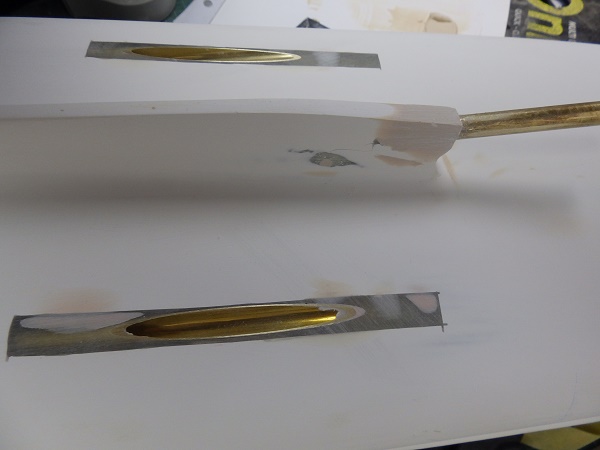

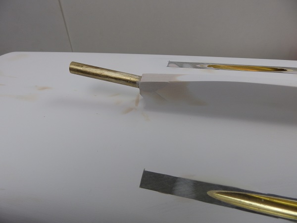

BigGrin Hi All
The keel has now been built back up and sanded back and any small marks on the hull around the stern filled and sanded. The rebuild still needs a little more attention but Im quite happy with the result so far.

#72 Posted : 01 February 2016 22:18:59
BigGrin Hi All
The repair is now fully done on the keel the dark patch on one side is where I found quite a large air bubble in the gel coat now filled and rectified. More soon.

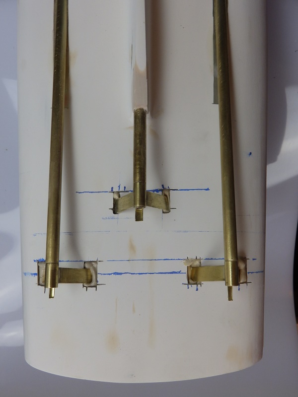

#75 Posted : 02 February 2016 12:47:23
That is some very neat and tidy work.
Very smart way of using tge card jig to make sure all of the prop shafts lined up correctly.
#76 Posted : 02 February 2016 21:09:12
BigGrin Hi Tony
Thanks for you comments and looking in,
@ Kev there will be no need to add anything to the keel in this area, all it will need now is sealing and painting as the three 50 mil dia props and the three rudders will prevent this area from contacting anything that could damage it again.

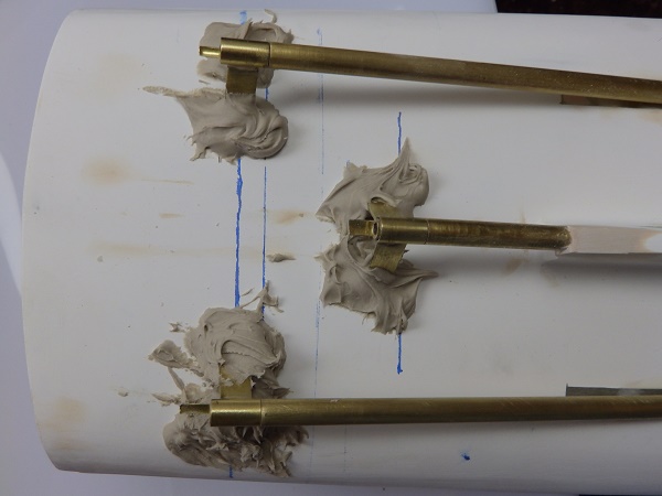

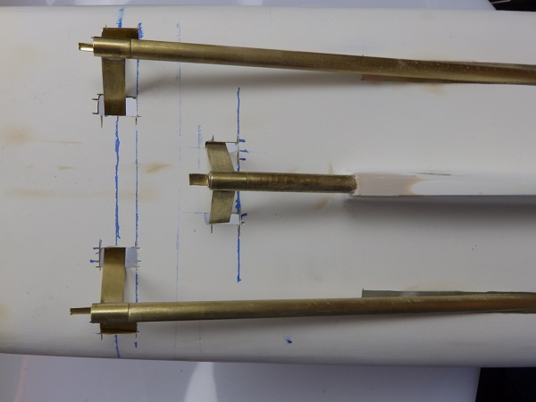

#79 Posted : 06 February 2016 17:19:11

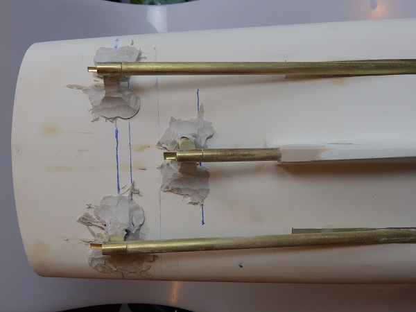

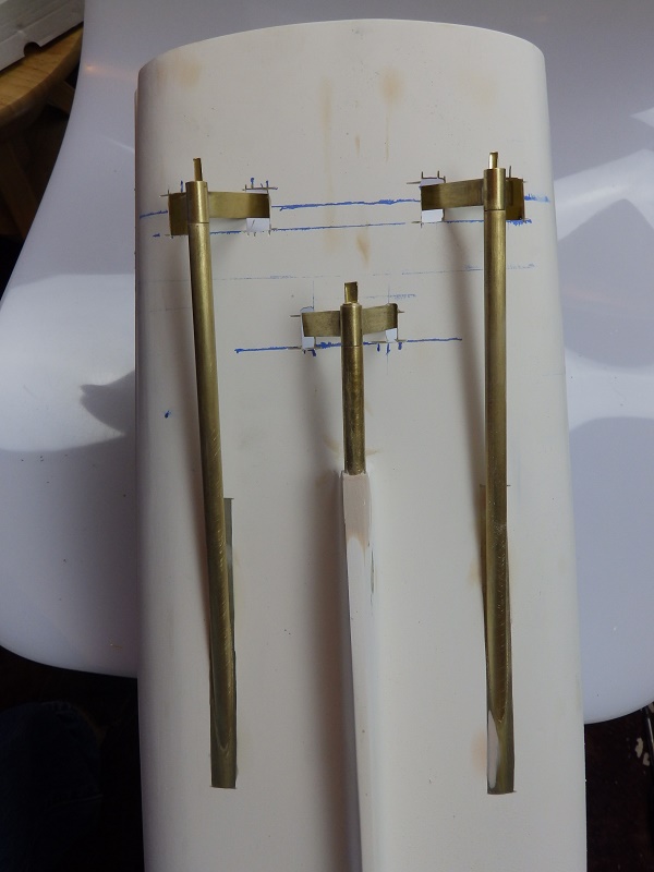

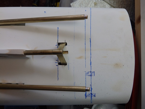

BigGrin Hi All
This is the part where the 'A' frames are fitted so more chopping holes in the hull. The central A frame was firstly cut to size then the hull marked out for the cuts in the hull, then using the prop shafts to get the correct height the A frame was placed in position. The two outer A frames were positioned in the same way the more observant of you may notice the brass fillets in the ends of the A frames this is because the A frames are slightly bigger than the 6mm prop shaft these fillets fill prevent end flex when finally fitted in place.
Once the A frames were in position P38 was used to fill any holes inside and outside, once this had set the proxxon grinded away the excess on the inner and outer surfaces. Lastly more fibre glass and resin was used to get a water tight seal on the inside hull. Next it will be the shaping of the outer hull P38 to blend in with the hull. More soon.
