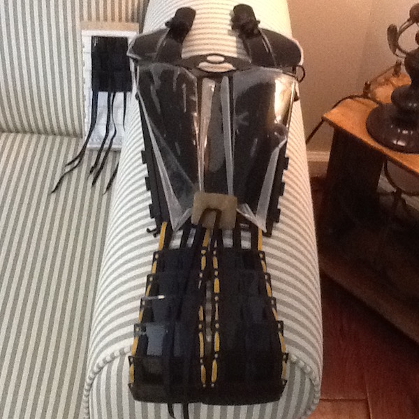

#65 Posted : 21 May 2016 00:08:37
Joined: 22/12/2015
Posts: 246
Points: 776
Location: Birmingham, AL, USA

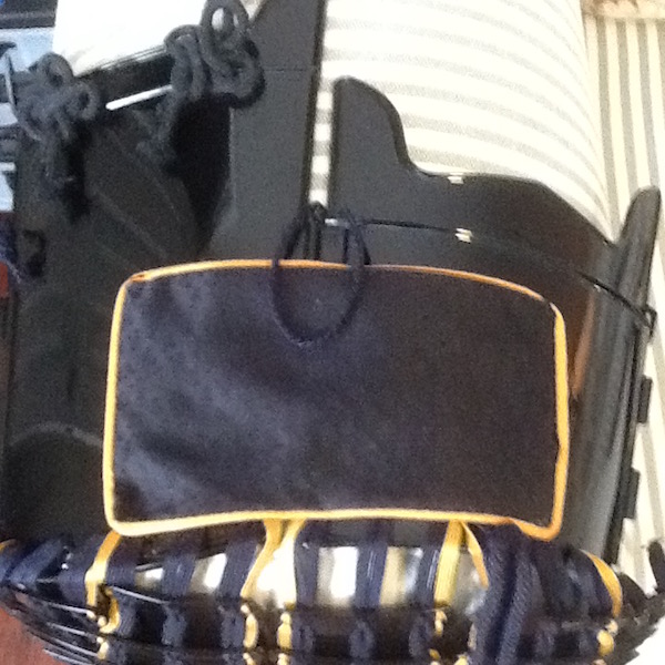

Greetings to all,
Back in business again. Received Pack 6 on Monday and managed to work on it a bit through today. I have completed the pad and tasset as the photo shows. i will do the other tasset and a half, and attach a second one to the back plate of the curiass before reassembling the armor. Then we'll tackle the helmet and the beard.😀
tnequette attached the following image(s):
#66 Posted : 21 May 2016 07:36:43
Looking good, when you get too the beard you will at first try to get too much of a bundle through the holes but you soon get to know the right amount.

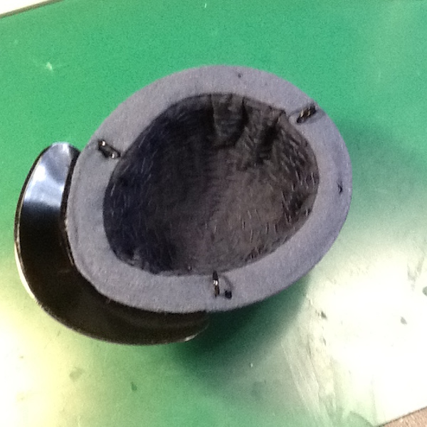

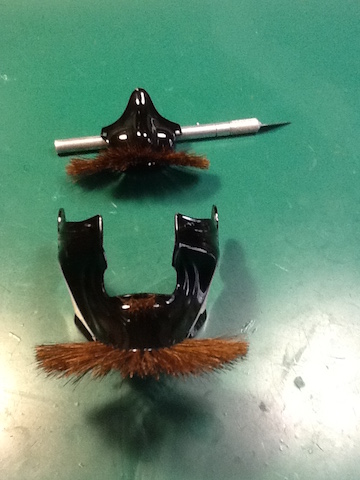

Slow progress as the weather is causing green stuff to grow and THE BOSS issues instructions which must be followed. 😒 OK, have finished another tasset set and attached it plus doing the remaining half set in this stage. Pad has been attached per instructions and without problems.😊

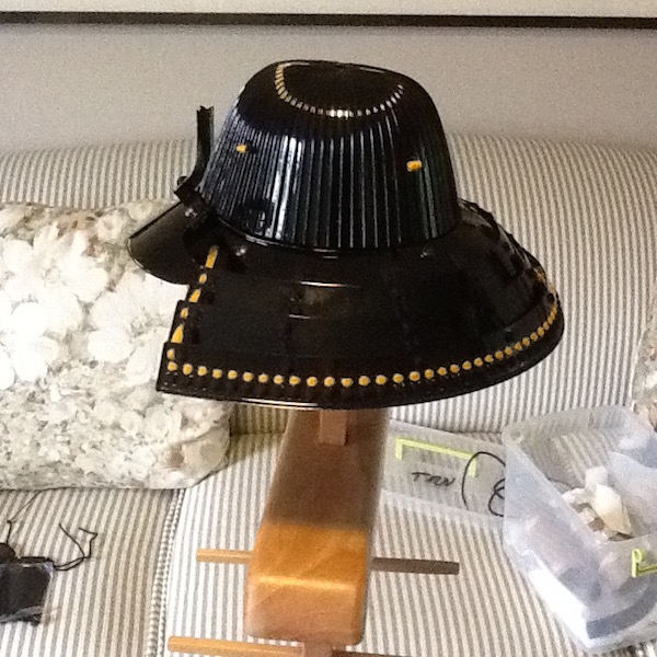

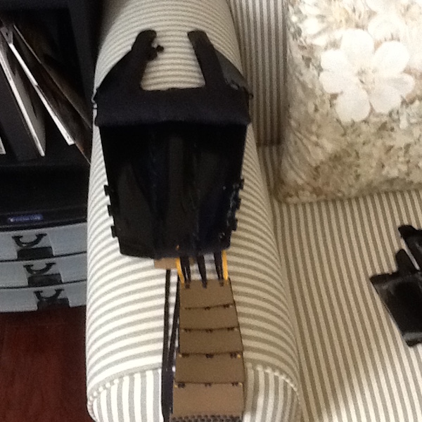

The helmet is finished and it was a challenge. Not difficult but just so different. When doing the liner per instructions do not be shy in pulling the bottom strings, then modify as you work up. Use fingers to shape it as a cap. Not difficult. I tied off the longer threads with each other so not to interfere with mounting it to the helmet. The supplied stretchy lining strip works without a problem.
When mounting the neck guard assembly to the helmet I did have attaching it. The lacing folds on the top ring prevented the mating of the ring to the helmet. I found the large rivets to be too short and the small rivets just would not mate so as to hold the ring. I reverted to CA and all was good. Frustrating and very time consuming.👎

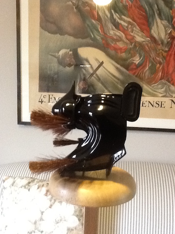

Finished up Pack 6 today. The beard and mustache were also a challenge. as I was advised, be careful about how many strands of hair you try to put through these holes. 40 to 50 is way too many. When you try to pull them through the mask they double to 80 to 100 strands. Cut it in half and you will end up with the 40 to 50 total. I was advised to try fishing line and it worked very well. Be careful on what diameter you use. A 50 lb. pull line is way too thick. I used 25 lb. test pull (0.015) and it was fine. Do use leather gloves to protect your hands. A good small bent nose smooth jaw set of pliers also helps.
i am happy with the result.😊
41 hours spent on this stage and now total to date is 219 man hours.
