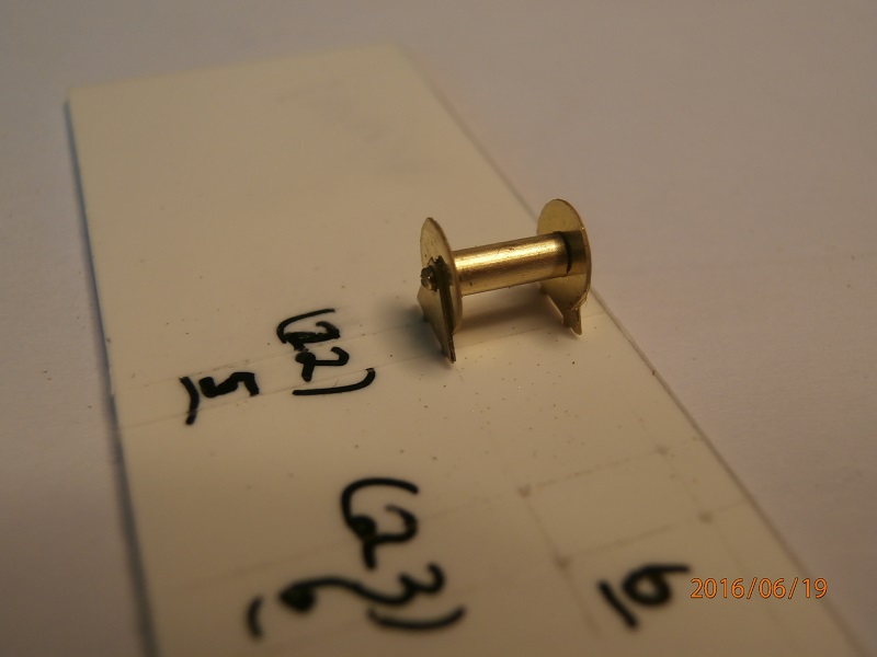

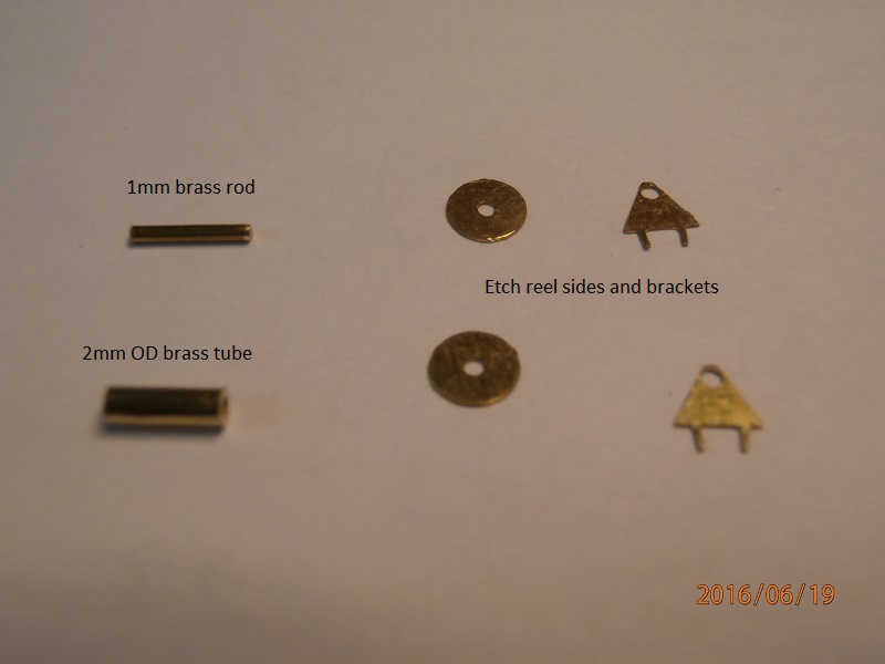

Just a brief update. I have made one of the cordage reels as a test.
Pic 1 shows the components parts.
Pic 2 shows the parts assembled in a very simple jig - a piece of plastic card with 2 pairs of holes drilled the correct distance apart for each different size reel.
pic 3 shows the finished product. It would be possible to make them so the reels could turn but its not worth the effort as they are inaccessible on the finished model.
Once all the reels for the sub shelter deck structures have been completed, they will be primed, painted and suitable thread wrapped around the reels to simulate the cord/hose.

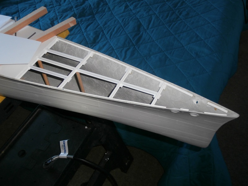

Another brief update. I have installed the support structure for the bow under deck and drilled out the anchor hawse pipes, Pic1.

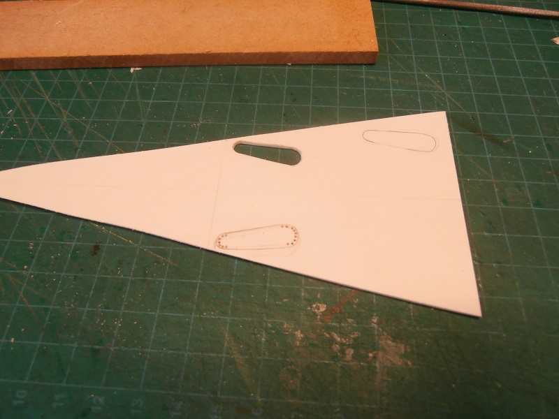

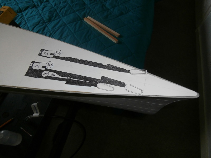

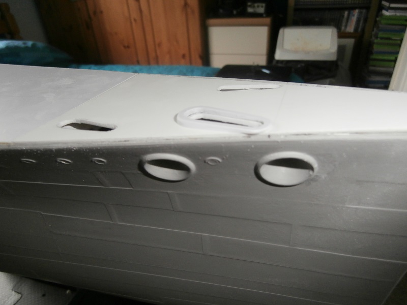

I then glued the aft part of the forecastle deck in place and placed the bow part in situ. I then printed the drawings for the chaffing plates and hawse pipes to scale, cut them out and positioned them on the deck to mark out the hawse pipe positions, Pic 2.
The haws pipes were then stitched drilled and cut out of the plastic deck, Pic 3.
The deck was then fitted in position and a hawse pipe lip fashioned from plastic card was made, Pic 4.
It was only after gluing the deck in place I discovered that the drawings (and most kits of the Hood) were wrong and the hawse pipes are not pear shaped as shown but more like a rectangle with rounded corners. I should have paid more attention the 'The Anatomy of the Ship' which shows the correct configuration - just shows you can't do too much research!!
Luckily this can be easily rectified before the deck planking is applied later in the build - I will also have to make new hawse pipe lips.

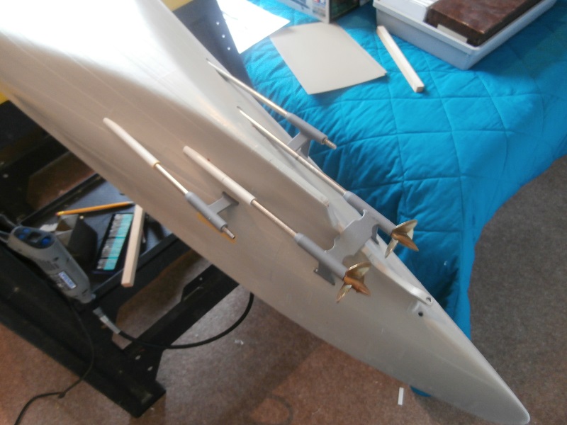

I then turned my attention to the prop shafts and made the foundations for the bulges where the shafts enter the hull. This was done by sanding plastic tube at an angle so that it fitted along the hull at the point of entry, Pic.5.
These still have to be cut to their correct length at which point they will be glued to the hull and the bulges fashioned from milliput.
The rudder was then fitted before the stern sections of the deck were glued in place, Pic 6.

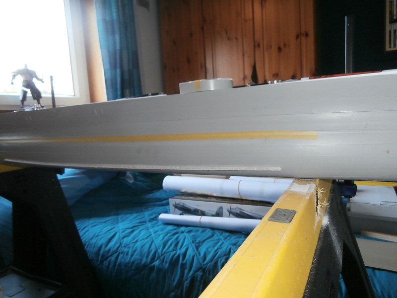

A very brief update. I marked the position of the rubbing strakes on the hull and ran a length of masking tape along the position of the upper edge, Pic 1.
I then fixed plastic strip in position using thick superglue, Pic 2. The bilge keels still need to be sanded smooth and the after (molded on ) water tight doors need to be detailed/replaced, I have not checked their accuracy for size and position as yet.
