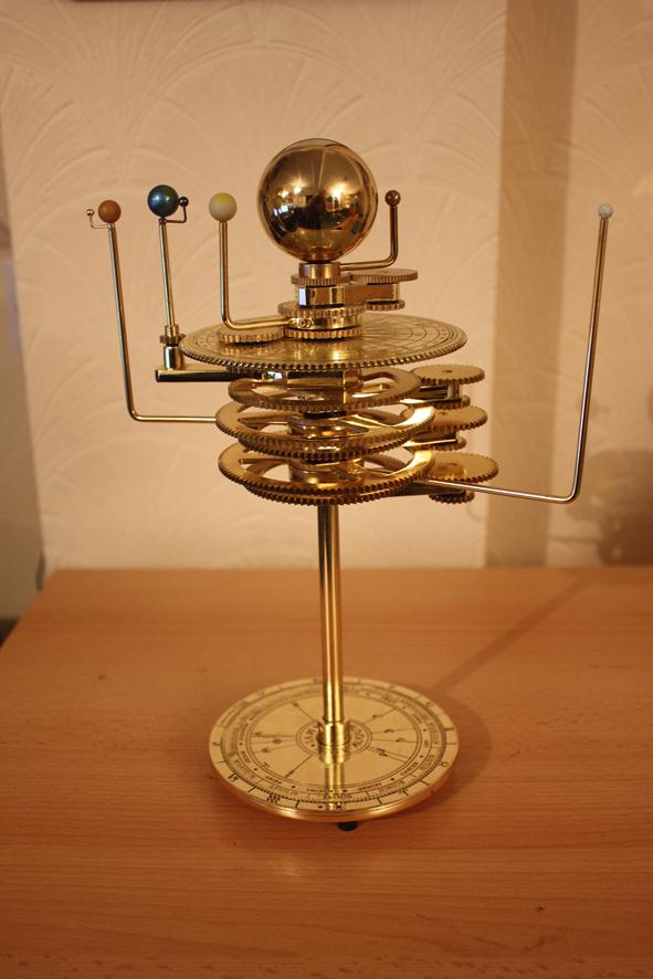

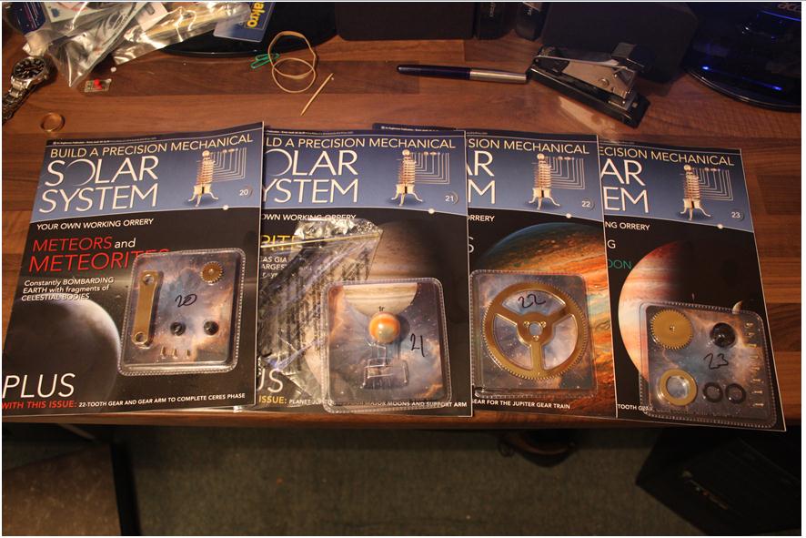

Issues 20-23 arrived today. Issue 20 is required to complete the installation of Ceres. Issues 21 - 23 need to be stored until the next delivery of parts before I can add Saturn to the display.
I am happy with the quality of the components and the build instructions are clear but it is one of those rush and wait builds. Still gives me time to complete the Arab Dhow and I have started on my RB7 build, up to issue 40 out of 100. No waiting here as I purchased the complete kit

It is possible to partially build the next stage - I have used rubber washer to hold up the section that needs support.
The orrery rotates as normal, the only piece I have left over is a 42 piece gear, the previous month I had the 45 tooth gear left over which is now part of the Ceres gear section, which was installed early December
It just helps to keep the packets of parts down.
I have also run into a few problems.
1) The Sun and the long main drive shaft did not screw in properly, threads were damaged - now glued in place.
2) One of the grub screws in the 2 large cog sandwich part of Ceres did not screw in - glued the sandwich together.
3) The planets are all wobbly and don't sit straight - so glued in place. I have the extra planet set but these are quite heavy so will fit them last to ensure all the arms are straight.
It all rotates freely.

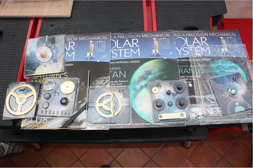

#67 Posted : 06 March 2016 16:54:32
Joined: 10/10/2010
Posts: 690
Points: 2,133
Location: Dorset
Now up to issue 31 although I am missing isssue 28 from my last delivery. Another phone call to CS who have ordered a copy for me but this will take up to 4 weeks. Oddly the parts for the issue where included with my package ??????!!!!! so I have not been delayed in the next stage of construction, but it will be nice to have the full set of magazines
Construction of the Saturn gearing and arm are as before. Just have to be careful to install the completed gears and support arm the right way up. As always RTQ.
Have had to file down some of the plastic parts (70 and 71) as the fit seemed too loose which allowed the gears to move too much.
I have yet to glue any of the planets in place as I like to remove them at each stage of the construction to avoid any damage. This kit is getting top heavy now and I was glad to see that Eaglemoss have provided replacement feet for the base to provide additional support
Pictures attached
BigGrin BigGrin BigGrin BigGrin BigGrin BigGrin BigGrin BigGrin
Current Build:-

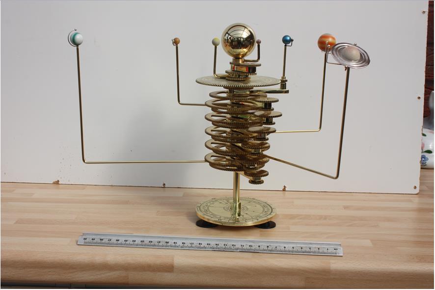

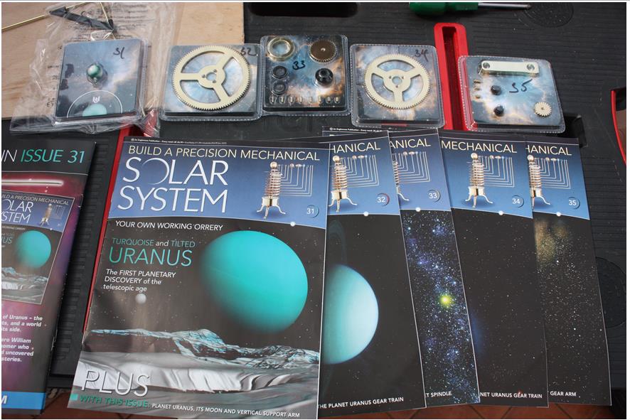

The next phase of this build is now complete. The planet Uranus (Please keep the jokes to yourselves) has now been added to my Solar System only Neptune Pluto and Eris to go.
At the rate the parts arrive that will be about another three months. Seems to be a Planet/Dwarf Planet each month.
The Ruler in the picture is to give some ides of the size of this model and it is getting heavy.

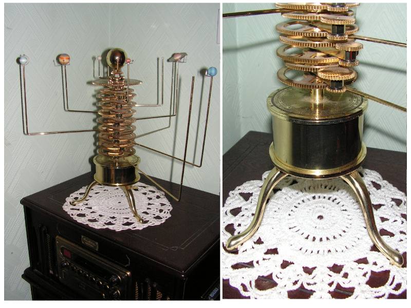

Derek and Tony, you do indeed get a set of very elegant legs for the base as shown below (hope you don't mind Gill)! There isn't any dust cover provided (it would need to be huge!) but you do get a couple of dusting brushes in the tool set, similar to the things photographers use on their lenses. As for keeping it shiny, mine was the first edition from a few years ago and the brass is just as shiny today as when it went together, it comes with a really good lacquer finish.
Unfortunately as you can see, Eris never showed up again! I'll be getting a map pin soon and painting it up as a replacement!Crying
Great job Gil!Cool
Robin.
