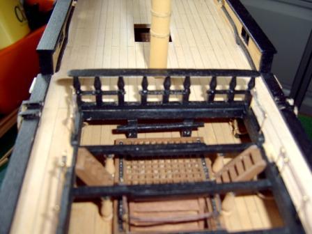

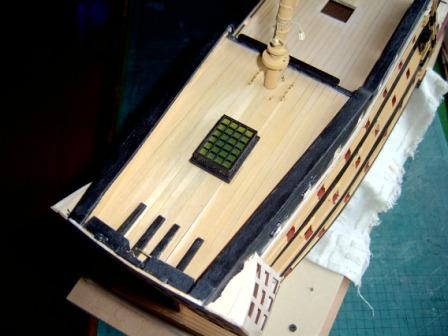

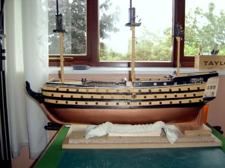

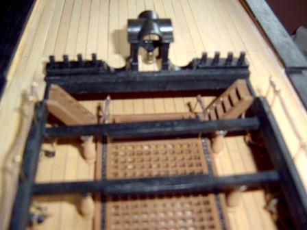

Hi Shipmates,
Well here we are in July2012 and I am about halfway through the build.
Spent the last few weeks tidying up the paintwork and fitting the first of the deck fittings
All three masts completed and rigging fitted together with the yards which are safely stored away until required. I have decided to fit the sails as “she who must be obeyed” has decided that is the way to go, but may have a go at furling some as a full set may be a little cluttered, only time will tell.
Pictures of my progress to-date are below, feel free to comment good or bad as your input and feedback is very useful.
Happy building to you all

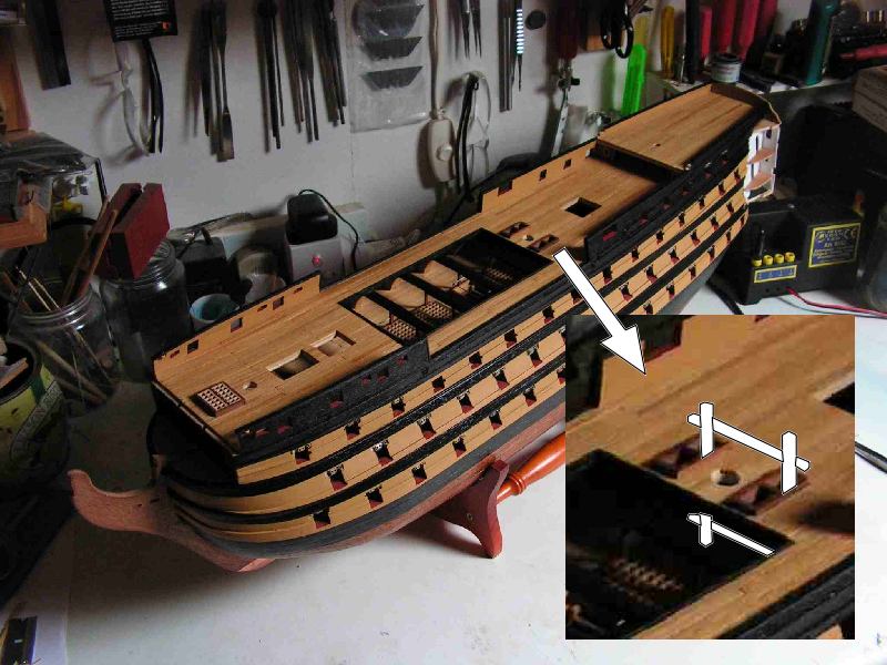

#72 Posted : 28 November 2012 19:42:09
Posts: 2,083
Points: 6,244
Hi there CMB

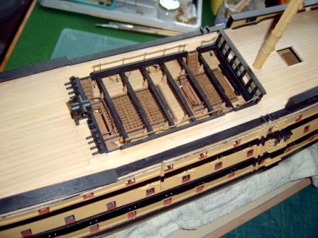

I've added some quickie graphics to one of my pics from my build below. the white shapes show the main fore brace bitts where they come up through the quarter deck. My own DelPrado kit does include these holes but still only supplies a basic metal moulding for the bitts themselves to be glued to the deck (I won't be having any of THAT milarky!!)BigGrin
On the actual ship the vertical 'pillars' go down through the holes and through the upper and middle gun decks as well with the upper gun deck having a second horizontal 'shelf' support like the one above, (going to be fun trying to get THAT in!)
I've noticed since that many other build diaries haven't got this feature in the quarter deck either, it may be that at some stage this area was decked over? Mine is open as per my two reference books on the Victory but I've also seen other models with the holes either grated over or covered in netting so there might be several variations, all correct at some time.
