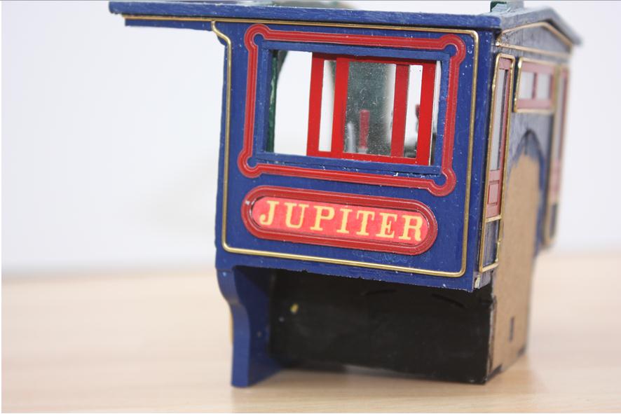

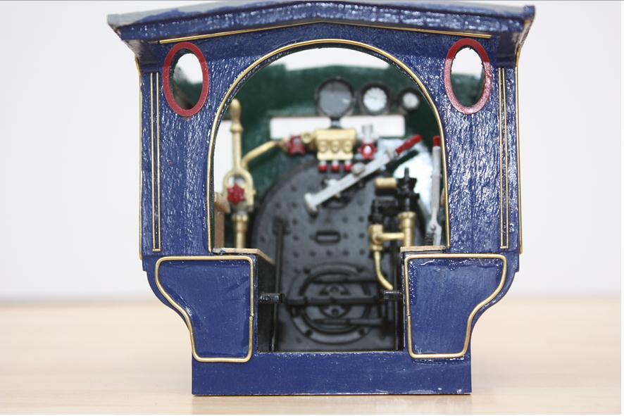

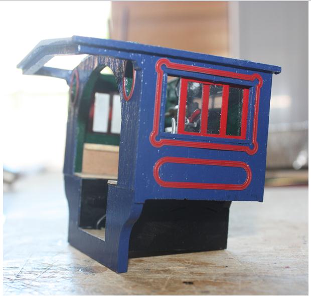

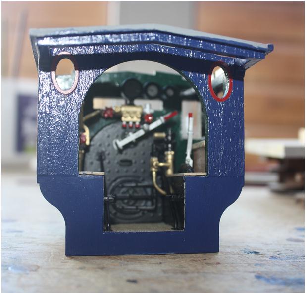

Pictures of the Cab so far.
I have modified the side windows so they now can be open and closed
The roof is not yet attached. It is my plan to leave this as a removable item so that the inside of the cab can be viewed. Will have to modify some of the pipework but not to much. Seemed a shame to hide the inside of the cab when there is so much to see.
I have not yet attached the transfers, will leave this for later to avoid damage
Now to continue with the tender and smoke stack. Been leaving this as I intend to use a ponce wheel to create the rivet effect where required. Not used one before so this will be interesting/challenging. I have been trying out the wheel on some offcuts from the model. The Trick seems to be make sure the item to be marked is firmly attached to the bench or else the row of "rivets" tends to wander. Also make only one pass with the wheel and don't rush it
More later

#66 Posted : 27 June 2015 16:11:16
That is looking great Gil.Superb work on the boiler plate and dials.I think mine is going to be a lighter blue.I am now second guessing if I should go darker.I will hopefully be spraying the cab today if I can think of a good excuse not to clean the basement prior to asbestos removal.

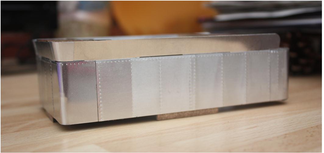

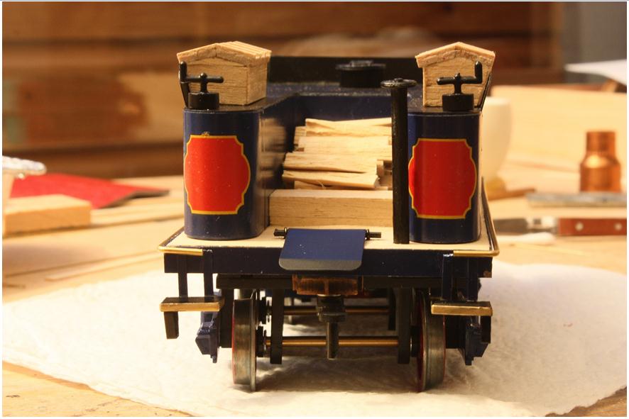

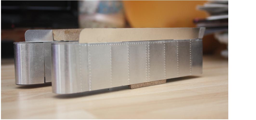

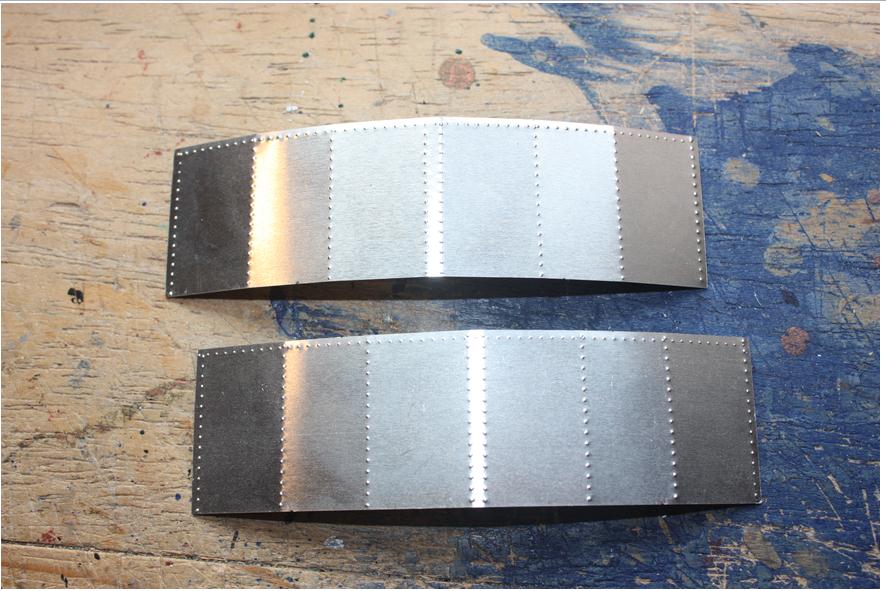

Been working on the Smoke Stack and Part of the tender
The smoke stack has some 38 components Wood for the frame and metal and plastic for the covers.
The metal needs the addition of "Rivets" My first attempt with a ponce wheel
and the small handles on each side have to be made up. The Kit includes brass wire which needs to be straighted out so I have put this away and am using brass rods.
The tender also has a wood frame which needs to be covered with metal sheets. again "Rivets" need to be added (ponce wheel again) Some minor filling will be required before I proceed to paint
Happy with the results so far. have been prevaricating with this part of the build as my practise attempts with the wheel did not go well, but as they say practise makes perfect, well better
Current Build:-
#73 Posted : 29 June 2015 11:54:38
Looking good Gill and the rivets are also looking great Cool
#74 Posted : 29 June 2015 15:19:09
Looks great Gil.I have started applying the rivet decals on the chimney.They are a bit fiddly to apply, but I think they will look OK once overcoated

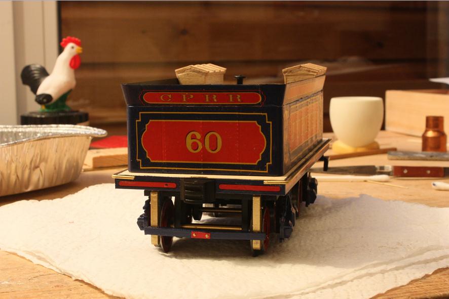

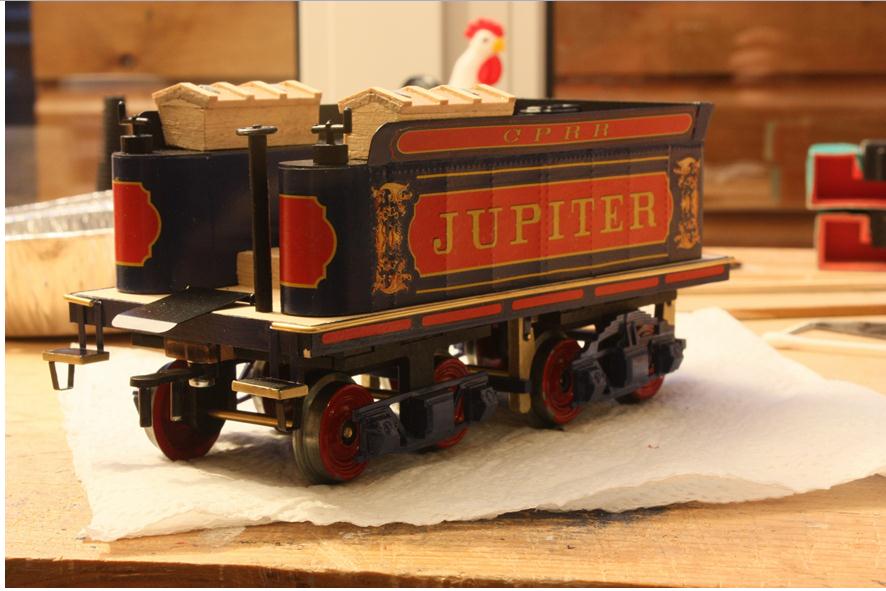

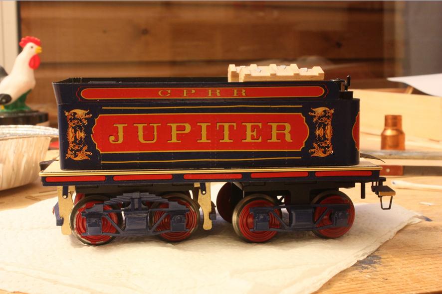

Been busy painting and applying the transfers supplied with this model
Not the easiest of jobs. The larger of the transfers where easier but the thin lines are fragile and after several attempts and damaged transfers I went to plan B, that is to replace all the thin lines particularly on the cab with home made lines of brass rods, took longer but was easier on my blood pressure.
Will need to touch up the paint work particularly on the cab as the attempt to add the transfer and their subsequent removal and caused some minor damage to the paint work.
Some of the transfers are also "home made" as the original logos did not show up too well against the paintwork.
Once I am happy with the paint job on the cab I will be adding the boiler to the cab and installing both on the train chassis, lots of fiddly bits to add then

#76 Posted : 13 July 2015 15:32:24
looking GREAT Gil. I really like the metal rod for the detail parts.I may do the same on mine.You did a great job with the large transfers.
I am STILL waiting on a delivery of cobalt blue paint.I guess it is manufactured on Pluto or something since it is taking so loing to get here.

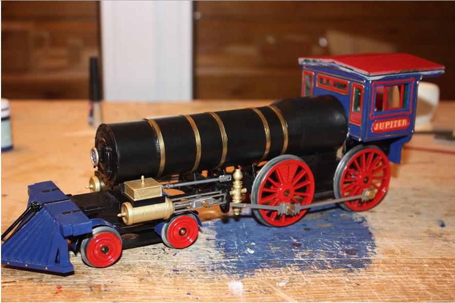

Starting to look more like a train now

Now that is definitely starting to look like a train.Those piston rails were are real pain to work with.They bend too easily.
