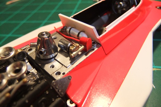

The area on top of the tank is a bit sparse in this kit so I'm adding a few things.
I made an electrical isolator switch from some 0,1mm steel and a piece of plastic sprue, cut to length and glued on. Drilled a small haole in the rear and added a wire.
#63 Posted : 08 August 2015 16:03:20
It will fit something like this. BigGrin
I need to add a black spot to resemble the hole with the switch handle.

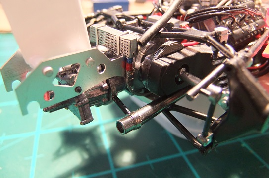

#64 Posted : 08 August 2015 16:06:47

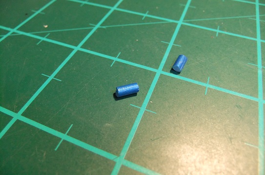

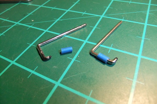

The water pipes that run from the back of the engine have hose connections clamped on. I cut a couple of bits of plastic sleeve, sprayed blue and fitted to the painted pipes. Haven't decided how to do the hose clamps yet.
#65 Posted : 10 August 2015 10:43:23

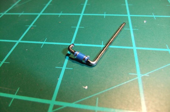

Some self adhesive aluminium foil cut into a thin strip and wrapped onto the tubes to look like the hose clamps.
#66 Posted : 10 August 2015 10:45:06
The pipes get positioned at the rear of the cylinder heads.

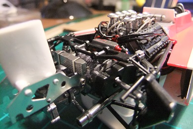

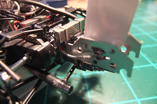

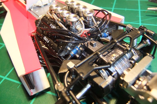

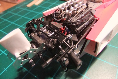

I've added the electronic ignition box plus some wires and the oil cooler which I strapped on with PE hose clamps.

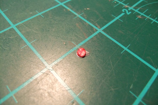

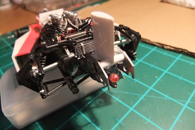

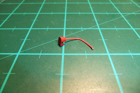

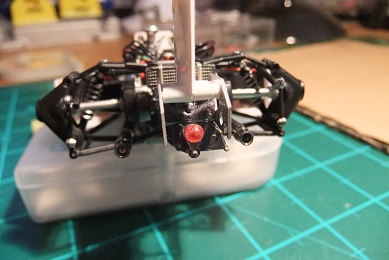

#72 Posted : 15 August 2015 16:27:25

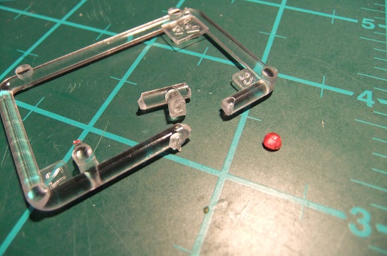

I had to make that light to prevent ferrari having James disqualified again !Angry .
I cut the spherical sprue end from a clear moulding runner. Gave it a quick spray of metallic red and mounted on a thin metal plate. BigGrin
The only pictures I could find of this car show a light mounted on the wing post but I think that may be a more modern addition? Anyway I'm happy with my effort it's 3.5mm dia so to scale about 70mm which seems about right.

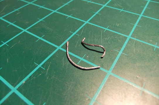

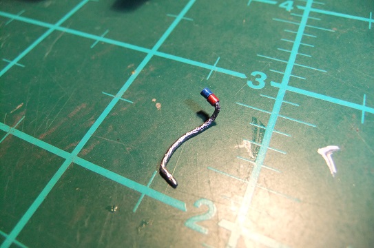

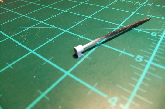

Another bit of improvisation.BigGrin Saw this on the uk Senna 4/4 build. creating a braided hose by rolling a solder wire under a file. I put some painted tube on the end for connection. Not too bad.

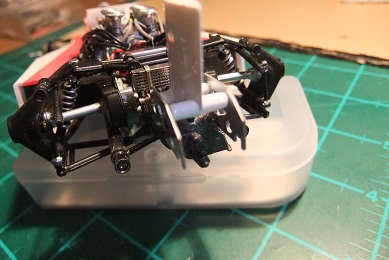

#76 Posted : 22 August 2015 16:43:55
Fitted those hoses to the underside of the oil cooler.

Some very nice scratch-building there Malc and I love that tip for making the braided hoses from solder. They look great done with the file though I was just wondering if the effect could be made even better by using a medium coarse sandpaper or nail file? Might be worth a try maybe?

Hi Kev, thanks for the suggestion. I tried a couple of different file cuts before I got one that is reasonably coarse so as to give an almost knurled look.
