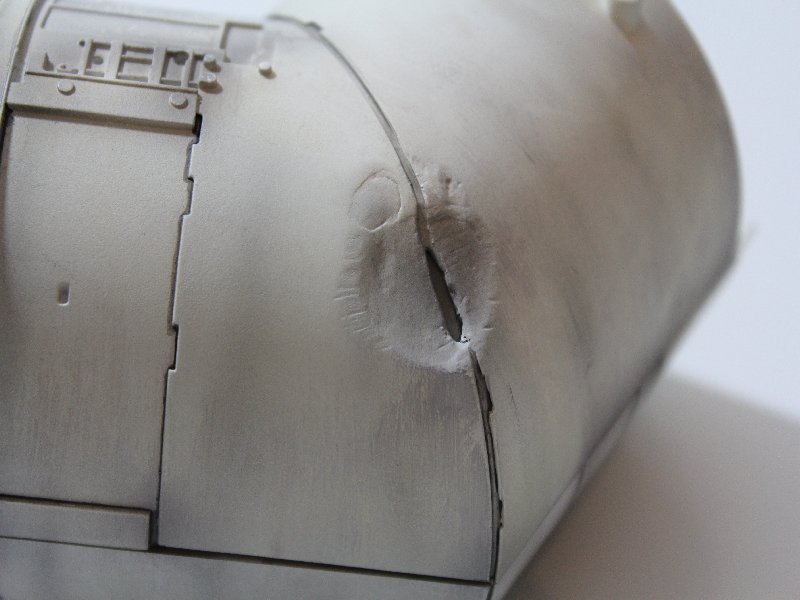

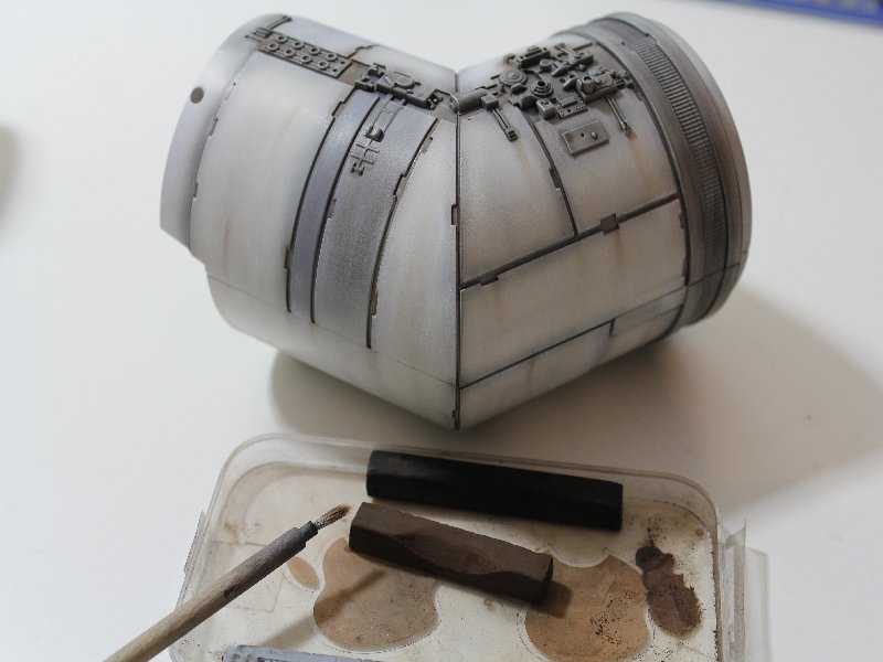

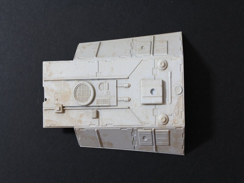

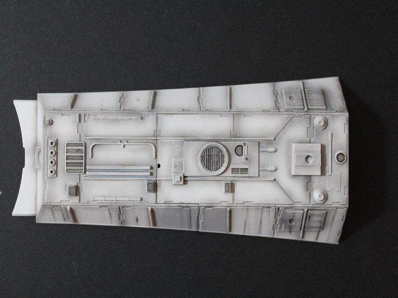

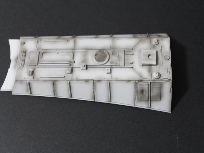

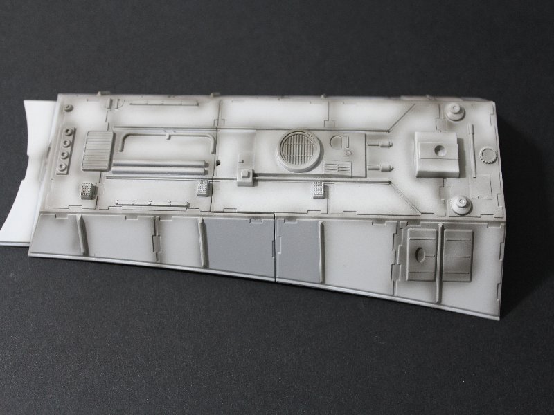

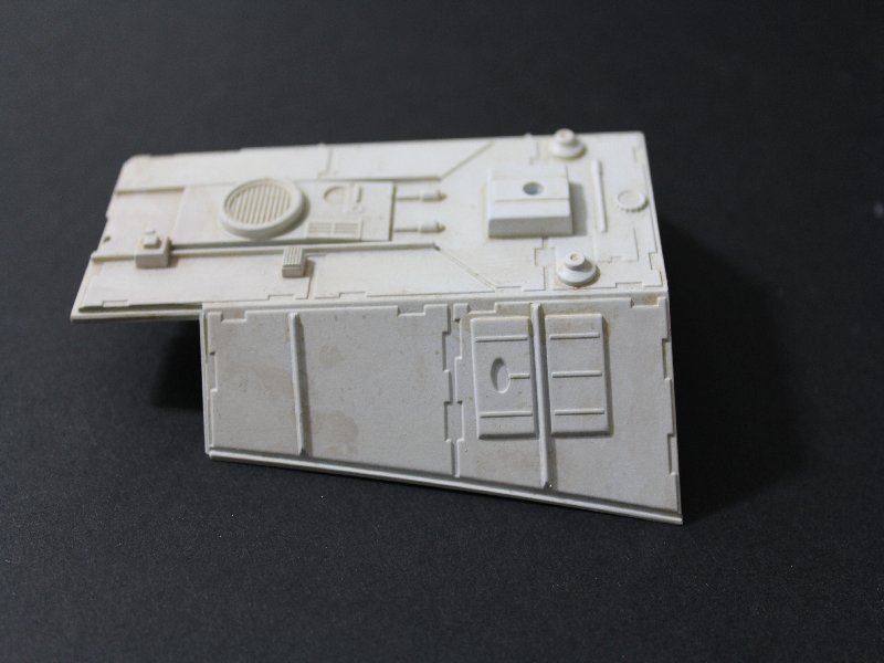

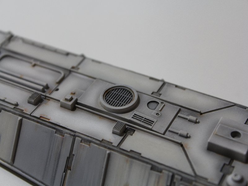

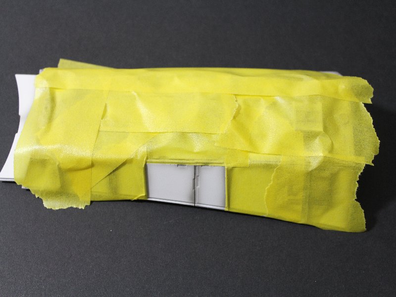

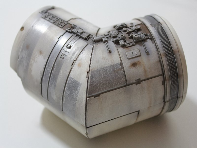

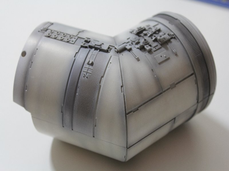

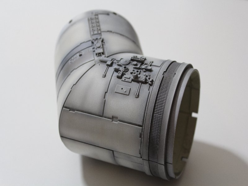

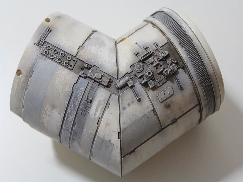

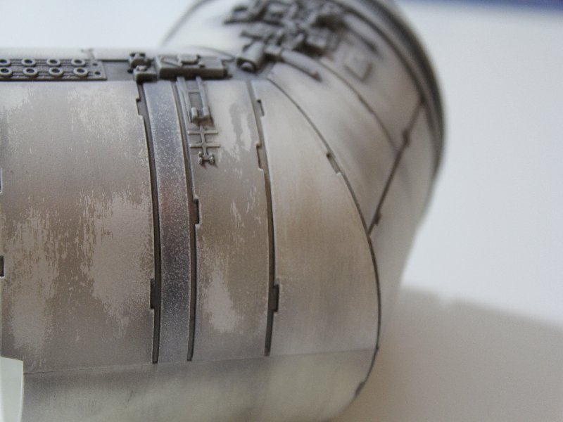

Once again using techniques with different applications from Airbrushing and pastels, to an idea that popped into my head while having a cup of Tea!

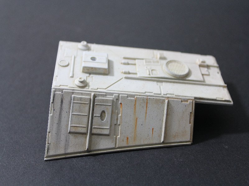

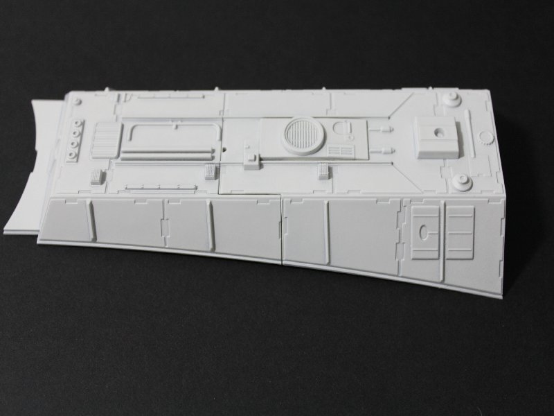

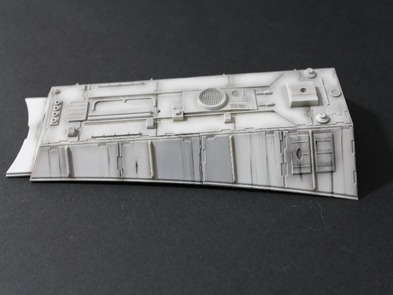

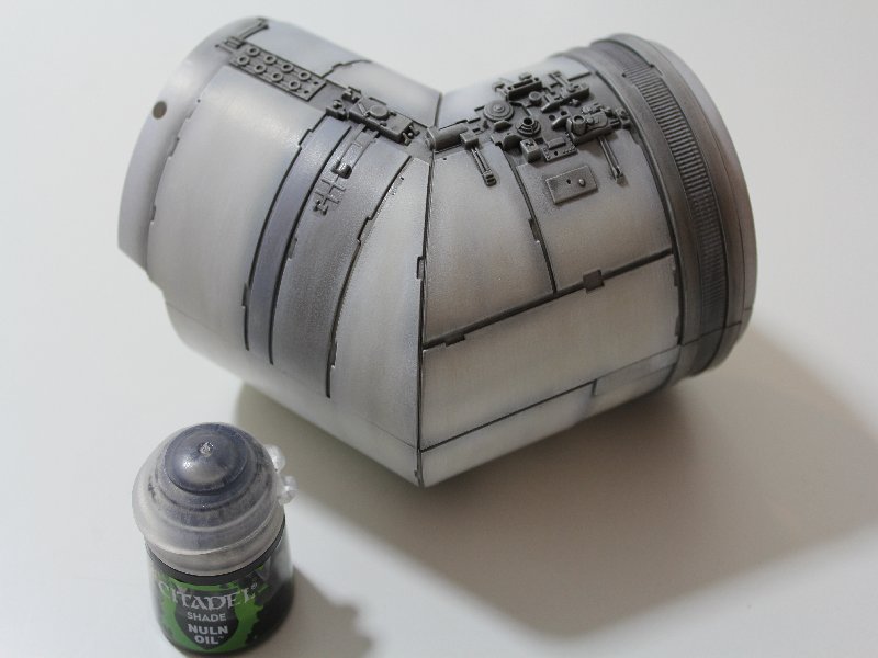

Picture 1 shows the test pieces primed once again with Tamiya White fine surface primer. This was then given some shading around the panel areas with Alclads Exhaust.(picture 2)
Picture 3 shows an area masked off and given a coat of Vallejo Medium Sea Grey.
Picture 4 shows the parts given a good dry brushing using Vallejo white to blend out the Airbrushing.
Pictures 5&6 show Winsor and Newton oils added for rust and streaks (Burnt Sienna and Black)
Picture 7 shows some detailing added with a Nuln Oil Wash
Pictures 8&9 show the overall effect with more rust and weathering added.
Tea Weathering (what!) Pics 10&11
Brainstorm! Ok this was purely experimental but seems to have worked and looks ok. I placed to 2 bags of the best (Yorkshire) tea into a bowl and filled it up with boiling water. (as if to make a very very strong cupper) and then left to cool down until lukewarm. I then placed the newly primed parts into the bowl of strong Tea and gently removed them allowing the “Scum” of the tea to settle on the surfaces. Allowed to dry and “Voila” some nice staining! (Maybe not to everyones taste though..

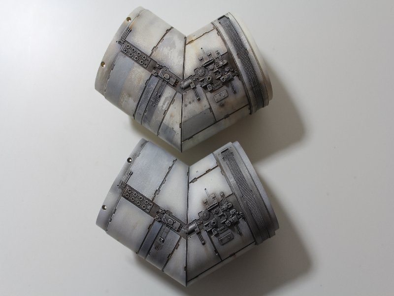

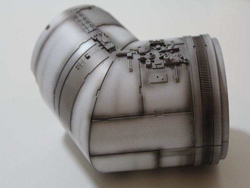

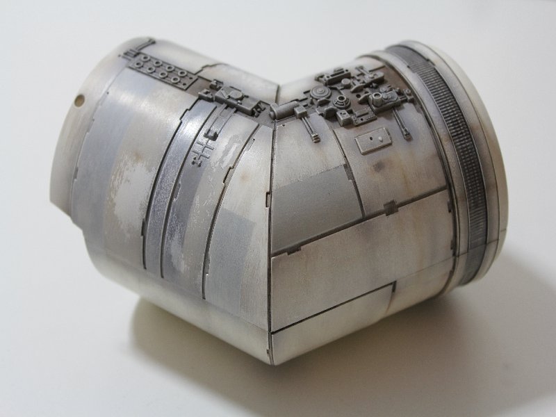

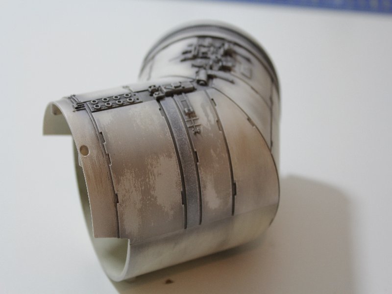

Cockpit Tube Paint Test

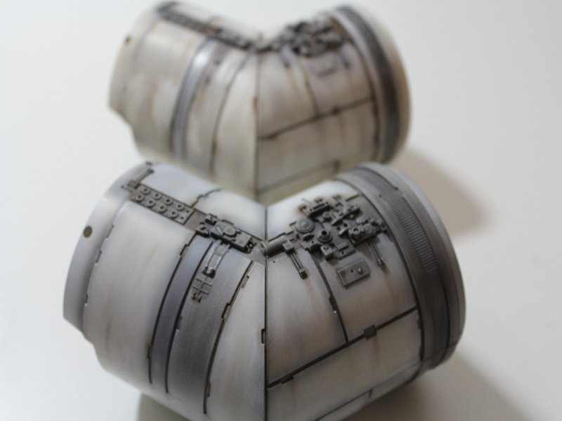

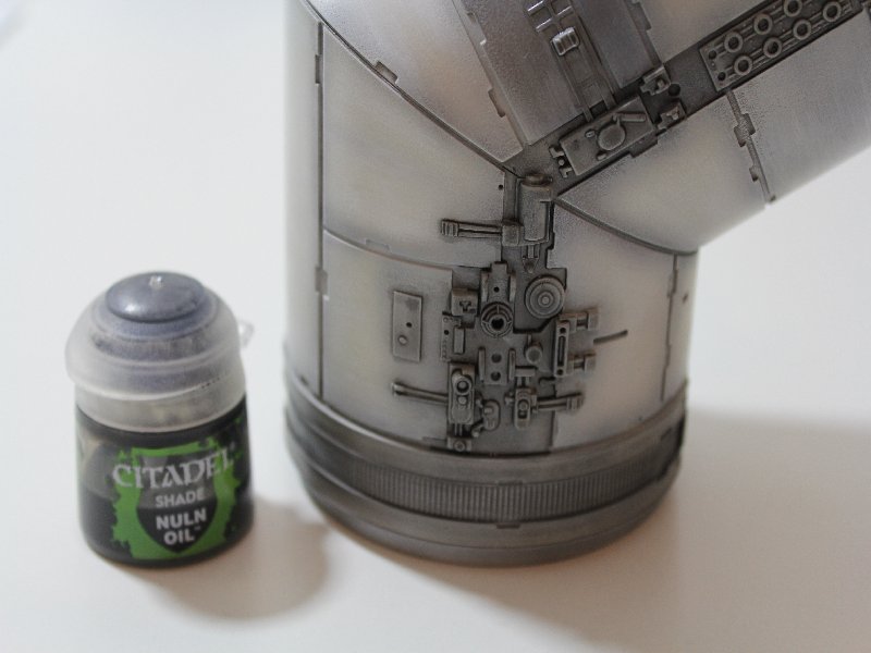

The cylindrical cockpit tube was first given a coat of Tamiya Fine Surface primer white before the panel lines where highlighted using Alclads Exhaust and Stainless Steel using an Airbrush. Certain panels where then picked out and given a coat of Vallejo Silver Grey (152)
Once completely dry the sections where run under a tap of warm water and extensive rubbing with the thumb to “Wear” away the paint in certain areas. Once allowed to dry (on the radiator was a good place) dry brushing was done all over using a mixture of Silver Grey on some areas and Pure white on others.
More panels where picked out and details added with pastels and more dry brushing until I had got the final effect I was looking for. Oils where added for the rust and the panel lines picked out using the Nuln Oil from Citadel.
The second Tube shows the same process but by changing some of the colours to a more “White” base coat and less weathering but at the same time getting a good effect.
