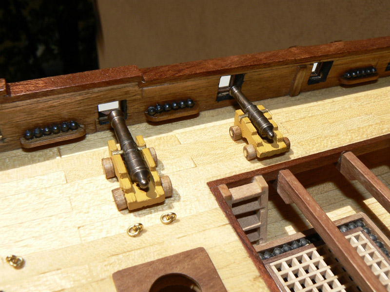

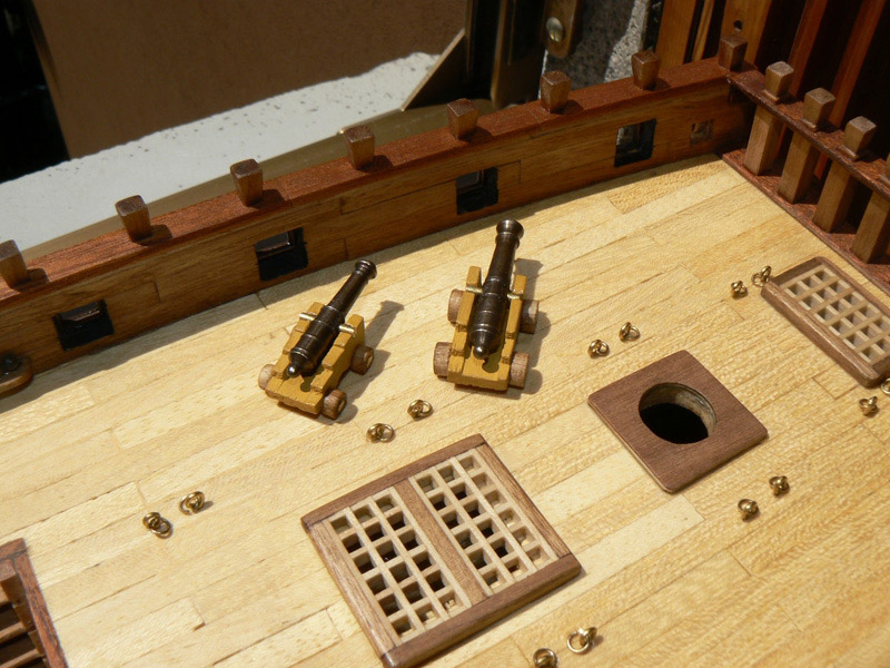

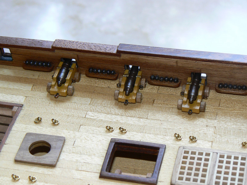

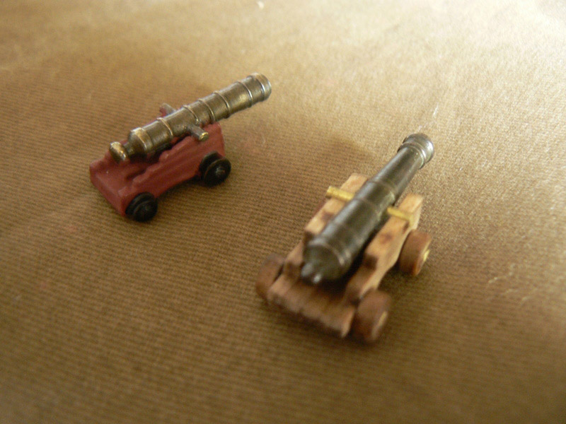

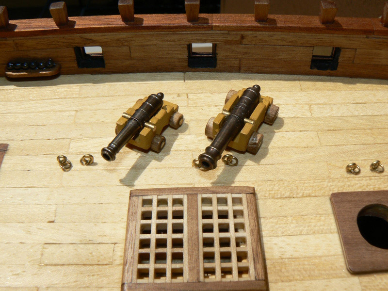

Some messages ago I published one photo of the ship guns, to be installed on the fourth deck (quarterdeck+waist+forecastle).
I probably said that I was not too much satisfied by the guns provided with the kit.
For this reason I watched several modelers shop in order to look for alternatives. The next two photos are showing a gun, partially acquired on the market but strongly modified by me, mainly for maintaining the right dimensions.
This gun is a prototype, mainly focused to obtain a sample to check on the model for the proper sizing and positioning. Now I'm building the final model, where the carriage is painted with an ochre acrylic paint. I will keep the weels in natural wood.
I have found two other similar guns and, if they will be ok, I will try to adopt and install three different guns: one model for the quarterdeck (8pdrs), another for the forecastle and another, smaller, for the waist (4pdrs). The model showed here will be for the quarterdeck.

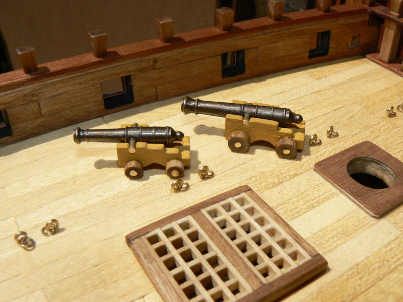

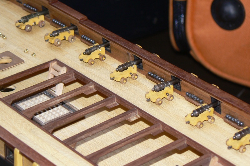

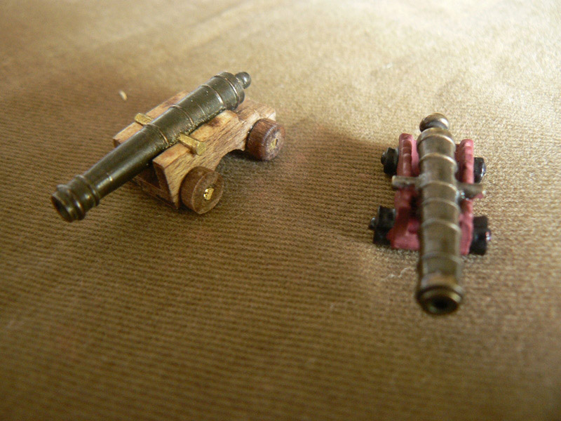

In these five images I want to show you the two new prototypes of the Santisima Trinidad's guns.
These are prototypes of two different guns.
The bigger should be the 8 pounders long gun, located in the quarterdeck. There was ten of these guns installed as recorded in my reference book.
The second type, the smaller, should be the 4 pounders gun, located in (or what should be ) the waist. Also this caliber was installed in number of ten.
Last, there should be in the forecastle 8 carronades of 24 pounders. I haven't yet found a solution for the carronades. I'm looking for a gun barrel greater than the 8 pounders to be cut (by using ie. my Dremel) shorter and install on a different carriage.
I'll keep you informed of the progresses. Jack.

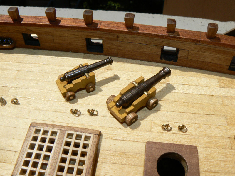

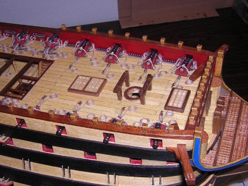

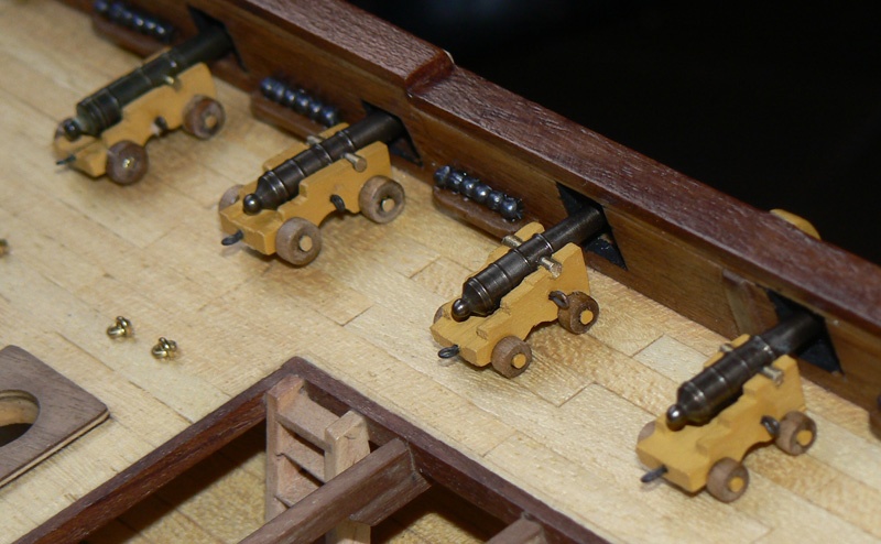

August 12, 2007 - Current activities - Part 1:
I have terminated the assembly of the 10 eight pounders guns.
In the following three images I have positoned them in the proper location just to provide an idea of the general outlook. Now it is not the right moment to install them, but, when this moment will come, I will have to provide the proper rigging for each gun.
I suspect that this task will be very similar to a nightmare but I live now in the illusion this will be solved anyway.
I am convinced that these "demi scratch built" guns are immensely better than the kit provided ones. See in message #62 the first image to compare. But the work necessary to reach this result is absolutely worthy of a crazy mind ....

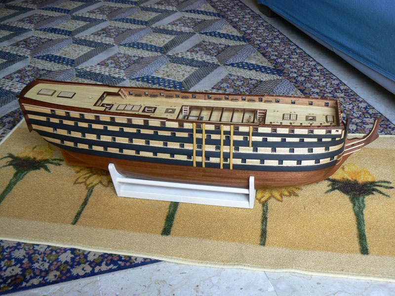

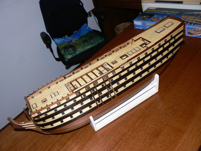

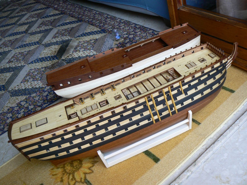

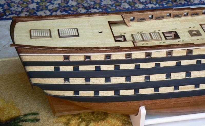

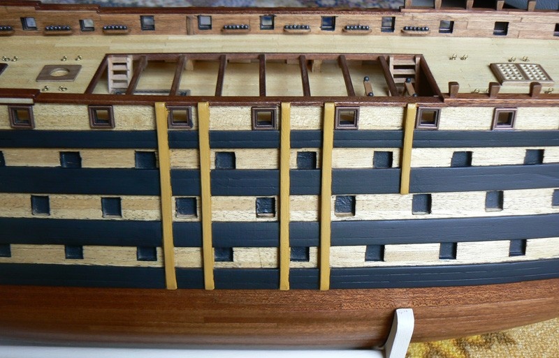

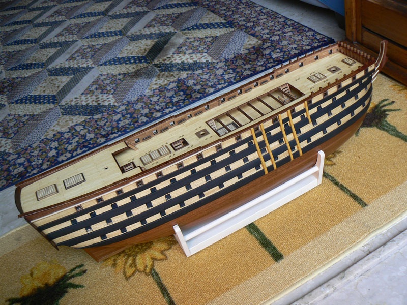

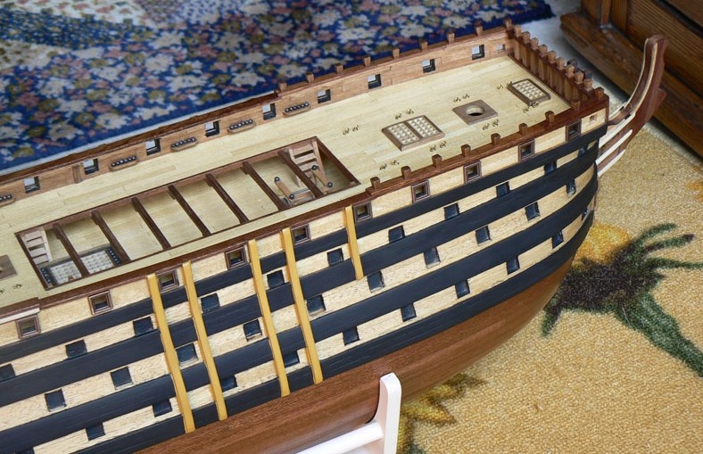

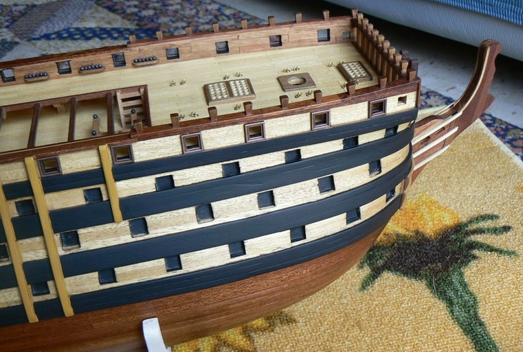

August 14th, 2007 - Current building activities:
Some messages ago I said that I was in trouble with the painting of the wales.
I don't know exactly what was happening but, after the application of a coat of transparent paint (Humbrol Matt 49) the result was:
- the paint didn't dry, or better it took days to dry
- instead of becoming matt, it's partly matt (and dry) and partly gloss (and not dry).
Most probably the Humbrol paint contains some kind of component that is not absorbed by the walnut of my wales.
To conclude the result was not satisfactory so, after many attempts I take the final decision to paint the wales with an acrylic black paint. With this new kind of paint, were the essence that was rejected by the wood of my wales is probably absent, the result is shown in the next three photos of the complete hull.
After, having realized that this solution was really good and definitive, I also took the decision to paint the wale vertical reinforcements with an acrylic ochre colour.
The whole operation (black on the wale and ochre on the reinforcements) needed an eagle eye, a very firm hand and several days to obtain the final result but, I am honestly very satisfied.
The last image shows the Santìsima Trinidad in the foreground and the San Juan in the background. I think you can appreciate the difference in terms of hull and dimensions, being them at the same scale.
Next message will contain more detailed images of the newly coloured hull.
Regards. Jack.
jack.aubrey attached the following image(s):

New more detailed photos of the repainted wales and vertical wales reinforcements. Nothing new on the model. Only photos.

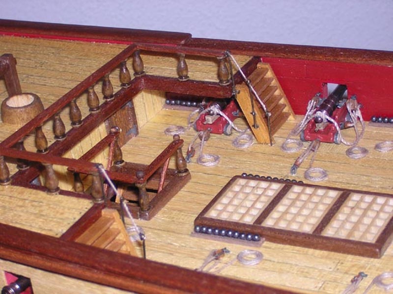

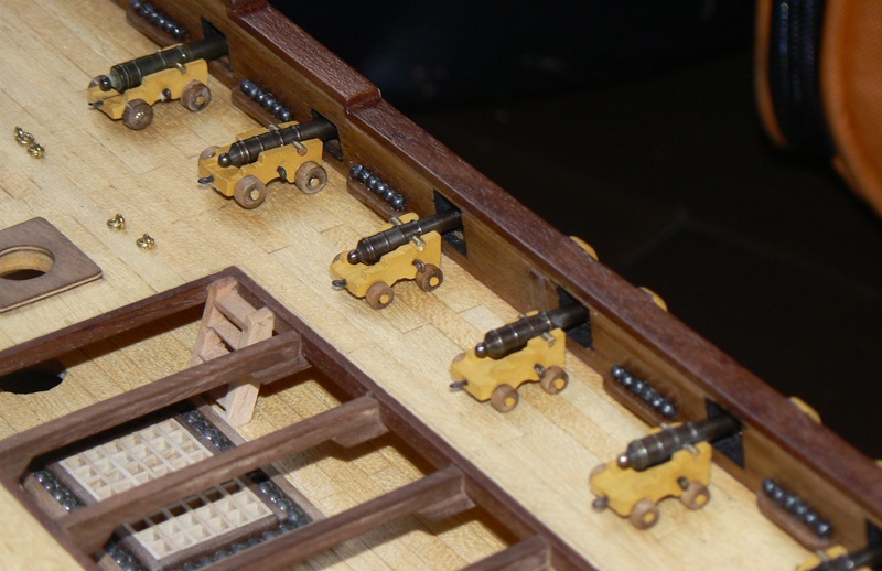

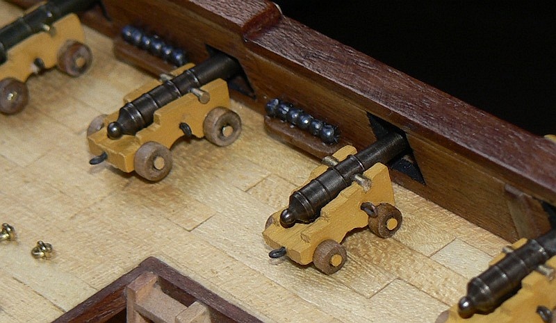

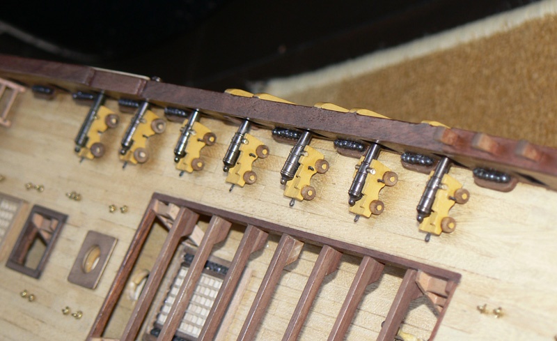

#67 Posted : 23 November 2014 14:29:25
Joined: 28/05/2014
Posts: 938
Points: 2,823
Location: Milan (Italy)
Posted: Sun Aug 19, 2007
August 19th, 2007

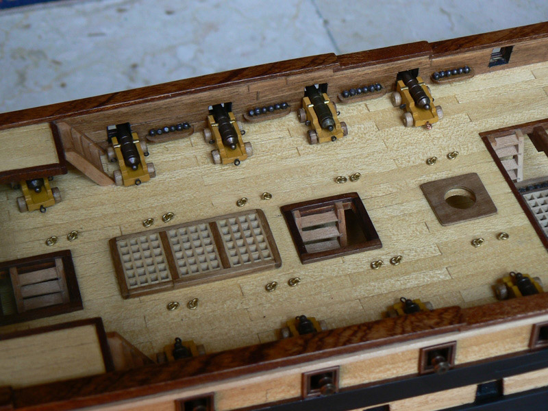

Here are plenty of images of Santisima Trinidad's ordnance. In these days I have built ten new guns. These guns are in accordance with the second type mounted on the quarterdeck. They are smaller than the other 10 previously build and documented. In any case I have positioned them near to the other type in a way to make possible comparisons between them.
The first image is a very close view of both models. The image is much bigger than it is in the reality and you can see some details that are not visible naked-eye. And they may appear imperfections ...
That's all. Your sincerely. Jack.

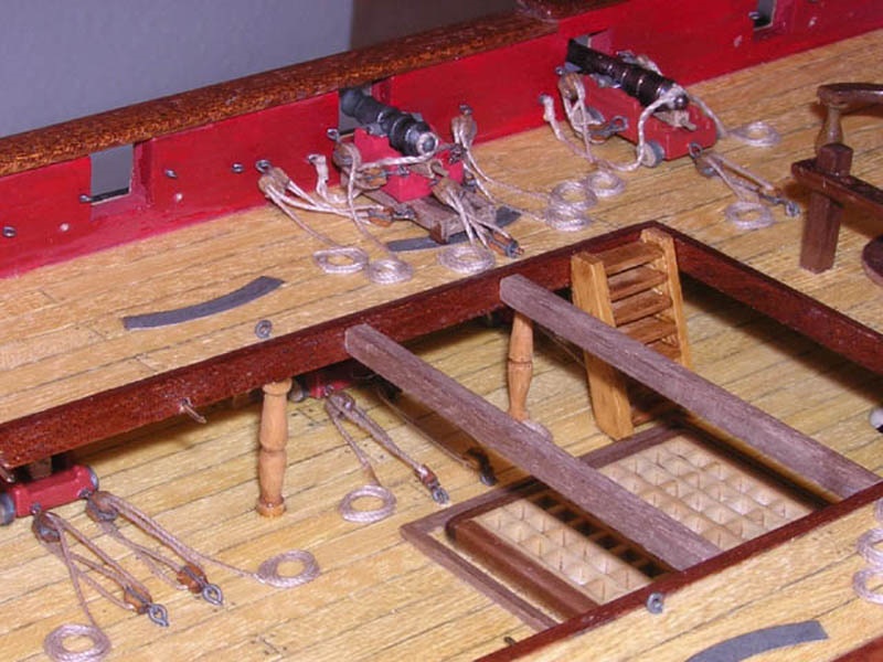

Posted: Fri Nov 16, 2007
I'm back on this topic after my trip in Ireland just to inform everybody that I haven't yet started any kind of work on the Santìsima Trinidad (ST).
The reason is that, just sometime before to resume the ST model, I received a telephone call by the model-shop of my choice informing me that the timber I ordered for the second planking for my simultaneous build (74 gun ship San Juan Nepomuceno ) was finally available. So I went to buy it and after that I was not able to resist to the wish to try to lay some planks.
What then shortly happened is that now I am fully involved in this new task and the Santìsima Trinidad is still idle ......
Some days ago I published on the San Juan Nepomuceno topic (unfortunately totally lost after the previously mentioned crash) some images of the Santìsima Trinidad built by another italian modeler. He is here known with the nickname FAM and this message is a tribute to his craftmanship.
His images started some positive comments and participations in that topic ..
He does not publish his work on this site (I tryed to convice him ..) but he has authorised me to show you some other pictures of his model so I have posted here six photos of his masterpiece, showing the tremendous amount of work done by him on the quarterdeck of the ST.
It is also important to know that his ST, like mine, is built starting from the De Agostini parts work, with some changes/customisations.
So, in the waiting of some good news from my ST, for the moment I hope you will appreciate this other ST ... It is worth appreciating.
See you soon. Jack.

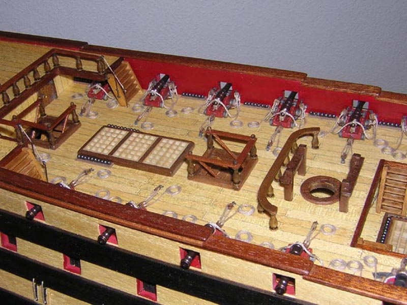

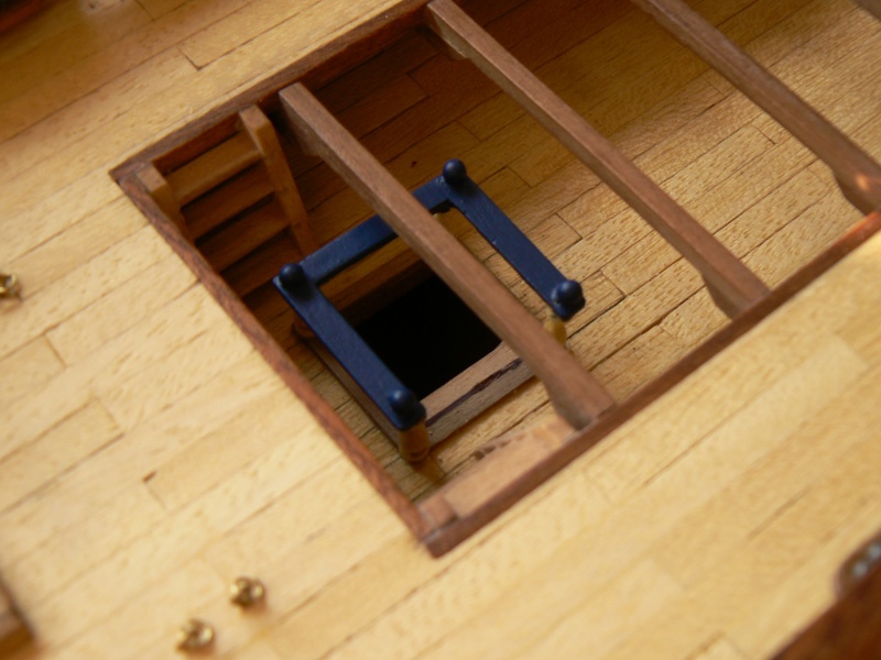

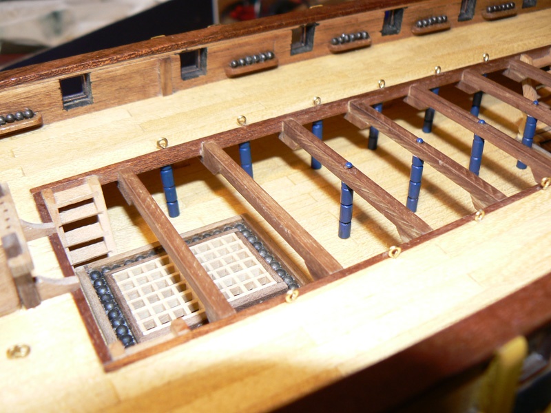

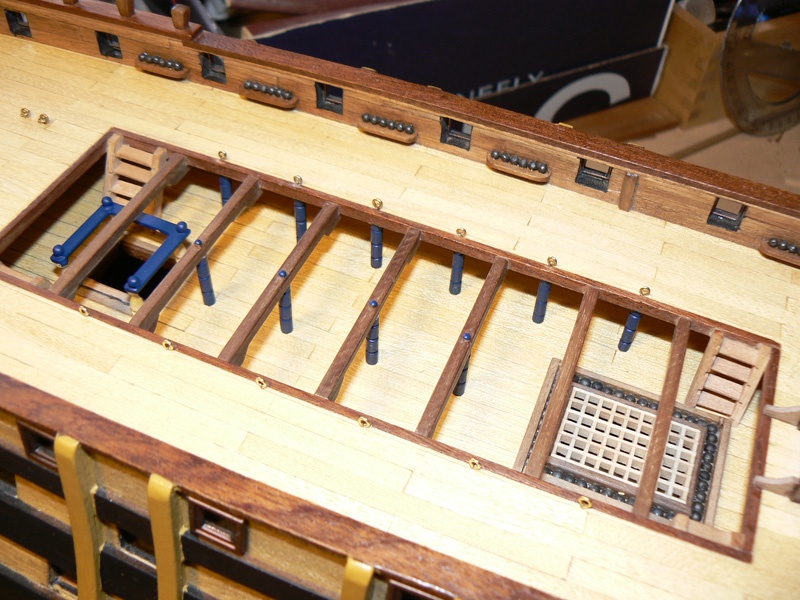

Posted: Sun Dec 09, 2007
Last Friday, December 7th, 2007, I finally resumed the work on the Santìsima Trinidad. It was more than three month I did nothing around her, mainly because the italian postal service lost a monthly shipment from the kit manufacturer.
But now I am back again, although I have done few work ... some small deck details ... but what is important is that, as we use to say here in Italy, the "ice has been broken".
I started to work following the instructions of the kit magazine issue n° 74 (until now we are at the issue n° 95): this means that I have a lot of work to do.
As soon as it will be worth to take photos I will publish them. See you soon. Jack.

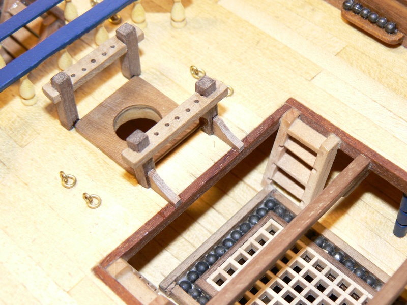

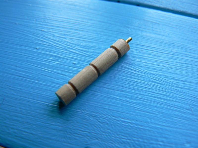

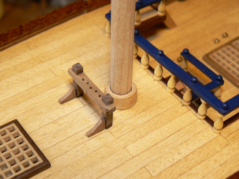

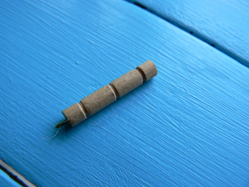

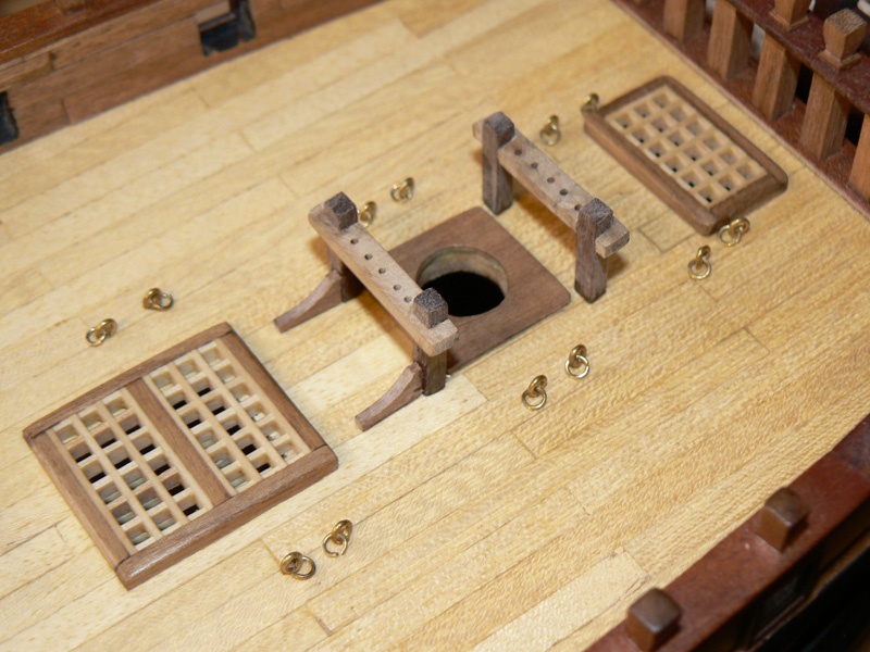

Posted: Sun Dec 16, 2007

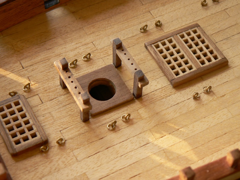

This is the first result of my resumed work on the Santìsima Trinidad. The attached image shows the fore topsail sheet bitts (on the left) and the main top bowline bitts (on the right). The area involved is the forecastle.
There are three additional bitts, two before and after the main mast and one after the mizzen mast.
To fix the bitts to the deck I have first drilled a hole in the vertical columns and inserted and glued a brass nail into it. Once cutted the nails head I have then drilled the deck in the proper place and, by inserting in the two holes the prominent edges of the nail, I have definitely fixed the whole with glue. It seems quite robust ....

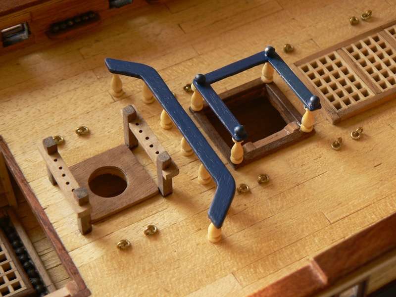

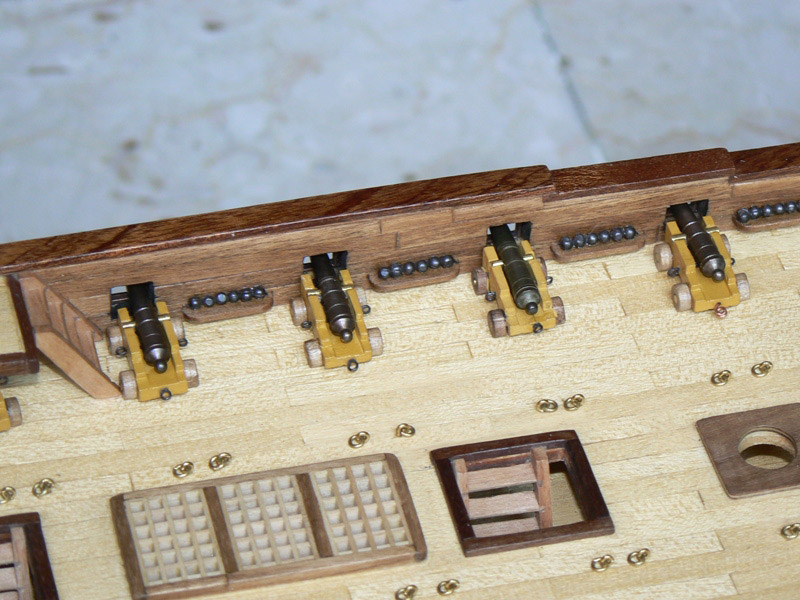

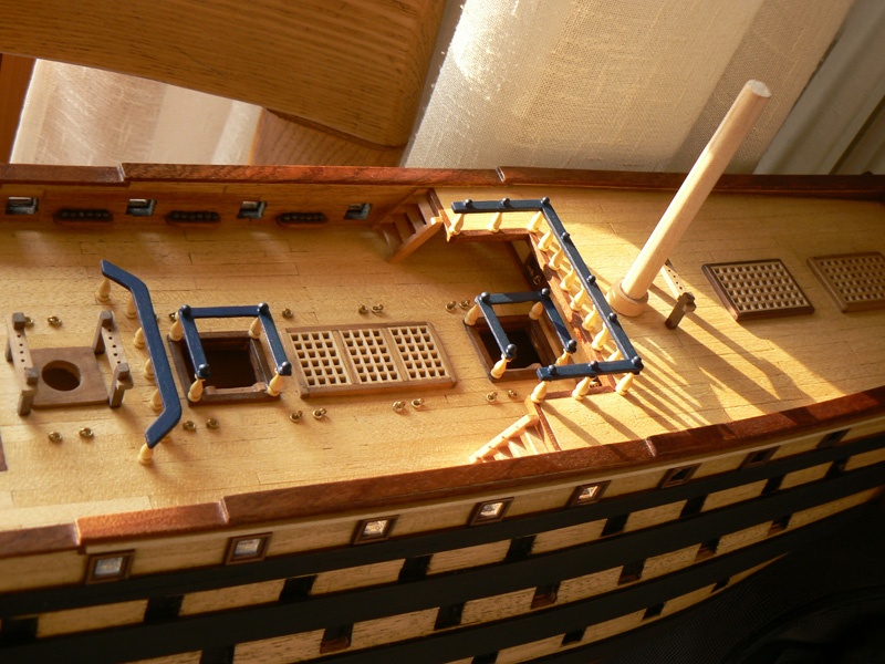

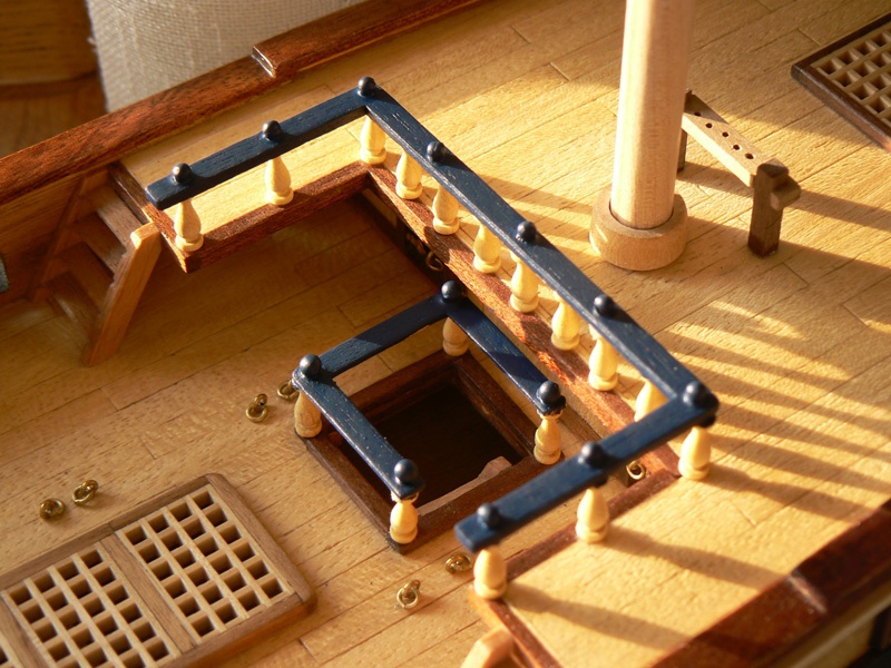

Here you can see another work I've recently done on my Santìsima Trinidad.
Companionways with rails and other details. Very small details on the quarterdeck, but very much visible. Finally I have decided to paint the rails with a blue paint because the color of the wood used wasn't much omogeneous and I didn't like it.
I like particularly the ballusters (the columns made with boxwood).

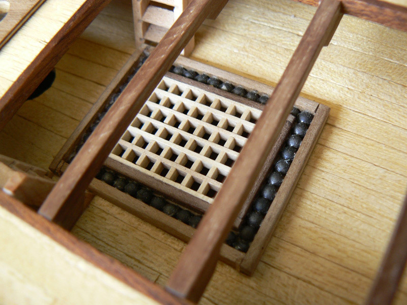

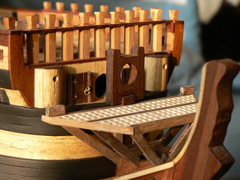

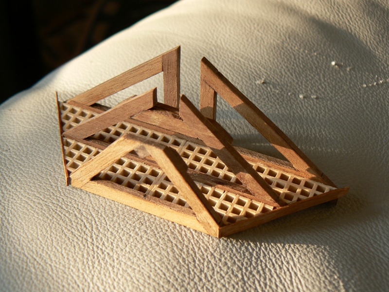

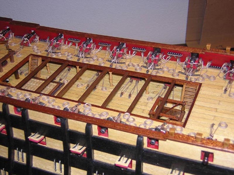

Posted: Wed Dec 19, 2007

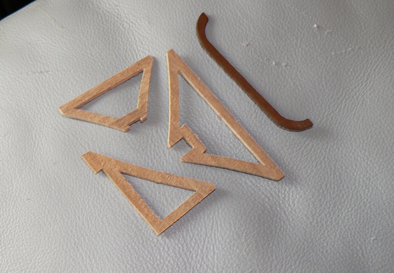

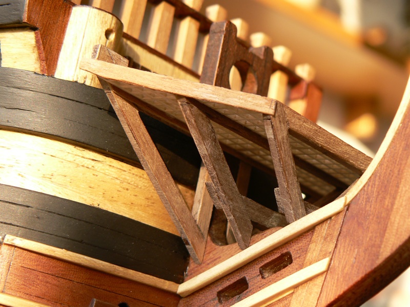

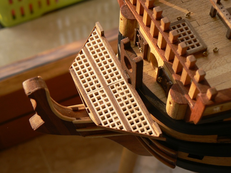

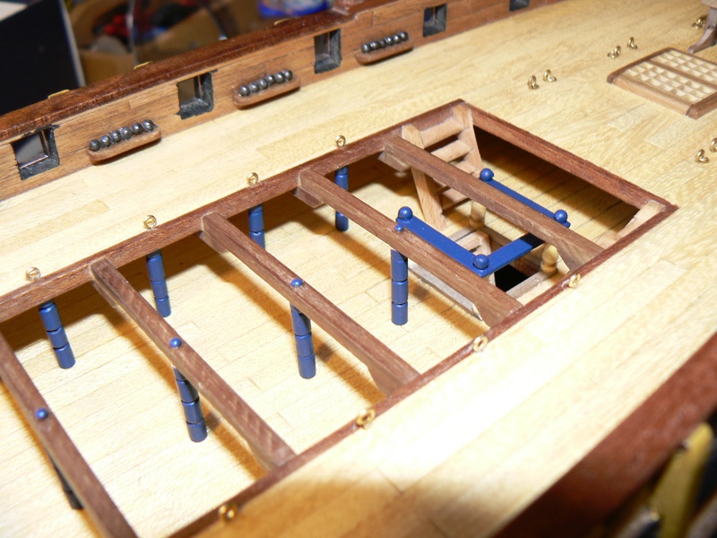

I'm back again to explain the work that is currently engaging me: the construction of the structure, I think the right term should be "the head", located at the prow, between the figurehead and the beginning of the forecastle.
It is a very complex area but the main problem I'm encountering here is to identify the proper terminology. I am using as reference the 32-gun Frigate Essex, of the Anatomy of the Ship series, page 48, 49, 50 and 51.
The raw materials supplied by the kit manufacturer were:
1) gratings to be mounted, glued and cut at the right size
2) pre-cut plywood (2 mm.) for the cross timbers and up to three rails (main rail, middle rail and lower rail).
The first image shows some of the cross timbers pieces when separated from the plywood sheet . . . . . briefly I wasn't satisfied of them, first of all because of the poor quality of the plywood.
So I decided to discard everything and use them only as templates for my own cross timbers. To do them I have used walnut stripes of 2x4mm and 0,5x4mm. I have built the timbers by glueing the two types of wood in order to frame-up the angles and have more surface to fill with glue. The resulting width of the timbers is 2.5mm. but I thing the pieces are much better and probably more realistic. From another point of view I have used the gratings supplied by the manufacturer without any change.
The second image shows the structure partially finished and as it is now. I need to build another small cross timber to install in front of the other three.

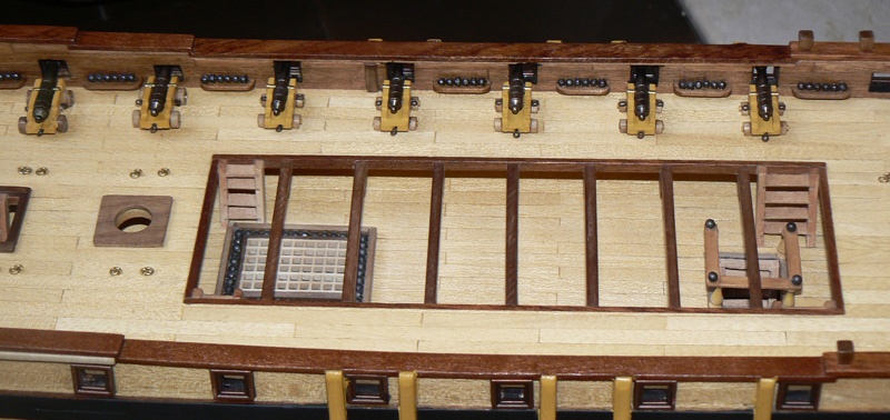

This is the continuation of the previous message where you can look at the structure installed in its proper place, but not yet fixed.
The three images here below show the area from different perspectives. I like it and until now I'm satisfied.
Looking better at the third image it becomes evident that there is a gap between the round hull of the prow and the overlooking first grating. This gap will be filled with ledges or with another grating properly shaped when the structure will be permanently fixed to the hull.
What I need now is to find some time to continue this work, but the Christmas period is here and everybody is very busy and I'm not different.
I want also get this chance to wish Idea Merry Christmas and Idea Happy New Year to everybody. Your Jack Aubrey.

Posted: Fri Dec 28, 2007

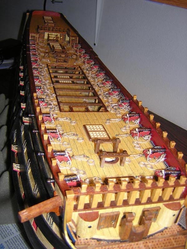

I have added some small details to the sheet bitts. These makes them more realistic than before ...

I'm now working on adding new details to the upper deck and the quarterdeck.
What you can see in these two following images are some kind of "home made" small columns. The real size of these protopype object is the following: 3mm. diameter, 18mm. length. So, the images are much more bigger than reality . . .
To build it I have used my Dremel minidrill.
I cut a piece of round wood and I mounted it in the drill in place of the drill bit. Then, with a file I made the three grooves. Then I cut the column to the proper length and drilled the two edges to insert and fix a brass nail in one side and an eyebolt in the other (when mounted in place).
