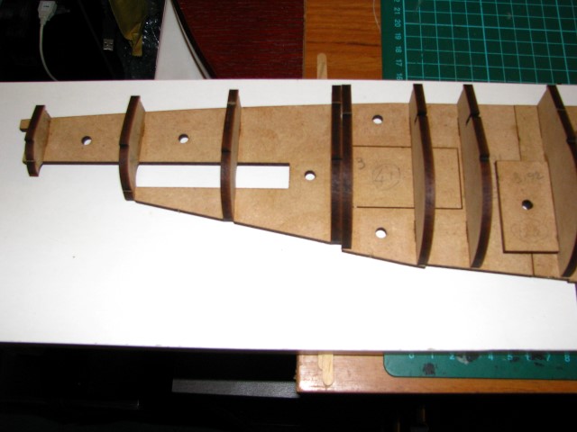

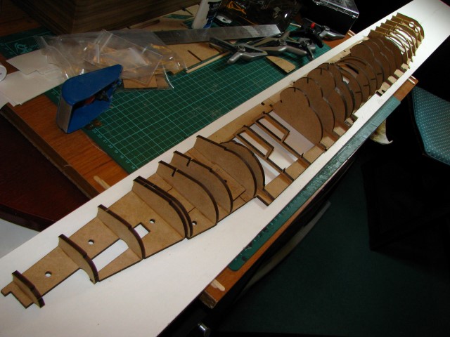

BUILD UPDATE #5
Hi everyone.
Thanks riff-raff, Gandale and Pemberg for yesterday's input, much appreciated.
Well today the build can start, but from the outset things do not go as per magazine build guide. As you know, I've opted for a forward torpedo room conversion to the standard kit, which in my humble opinion, will greatly enhance this build. So, the first steps are to do away with the 1st and 2nd frames from the standard kit. These are replaced by one frame which contains the cutaway for the enhancement. Also not required for the 'mod' are transverse frames/ribs (or whatever we call them) 6,7,8,9,10 11,and 12.
In the build guide in Stage #1, we've started from step #9 onwards.
In stage #2, steps #1 and #2 were omitted. I've also decided not to work on the PE at this stage, preferring to keep them in their original packaging until later in the build, so as to maintain their pristine condition.
To finish this stage, I've taken the main frame from stage #3 of the build guide, attached it to the the previously completed torpedo room frame and left it to dry.
HANDY TIPS FOR MODELLERS
If the modellers amongst us don't have a 'set square' for lining up the transverse frames yet, a handy 'get around' can be used. I've taken the insert from transverse frame #19 and am using that as a squaring device for the frames.(see photo).
Also, I found an off cut of 5mm dowel from my previous build of the 'Sultan Arab Dhow' which can be used as a centering tool for the reinforcement parts of the frame. It is an exact fit for those holes and lines them up perfectly.
That's all for now. Thanks for looking in and keep the comments coming
Happy building
David

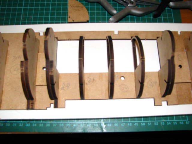

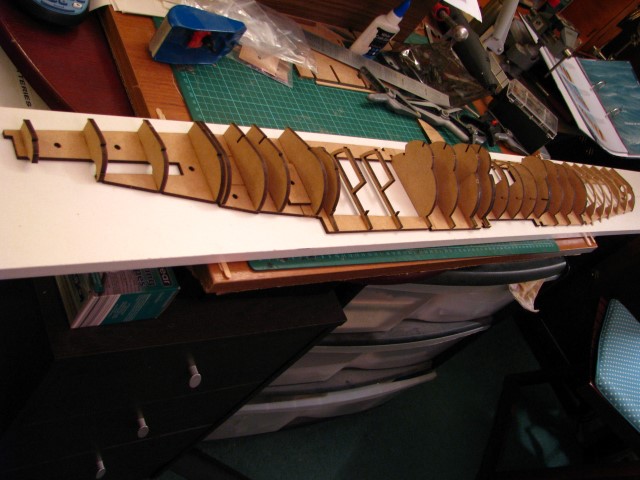

BUILD UPDATE #6
Hello again friends and thanks for the feedback.
Today I pushed on with build, finishing Stage #3 and moving through Stages
4, 5, 6, and 7.
Haven't met with any significant problems and have to say that my reservations about working with MDF were ill-founded, apart from wearing a mask when filing, I've found it a good medium to work with. All the parts are extremely accurately cut and give a really good tight fit. The only problem was with the extra conversion parts which were not laser-cut but CNC milled, which meant that the insides of the notches and cut-outs had very slightly rounded corners that had to be filed square with a small needle file before the transverse frames could be fitted so as to sit correctly.
So that's about it for now, another 4 weeks until my next delivery during which time I'll be ordering a few more parts of the torpedo room conversion from Germany.
Thanks for looking in and happy building
David
