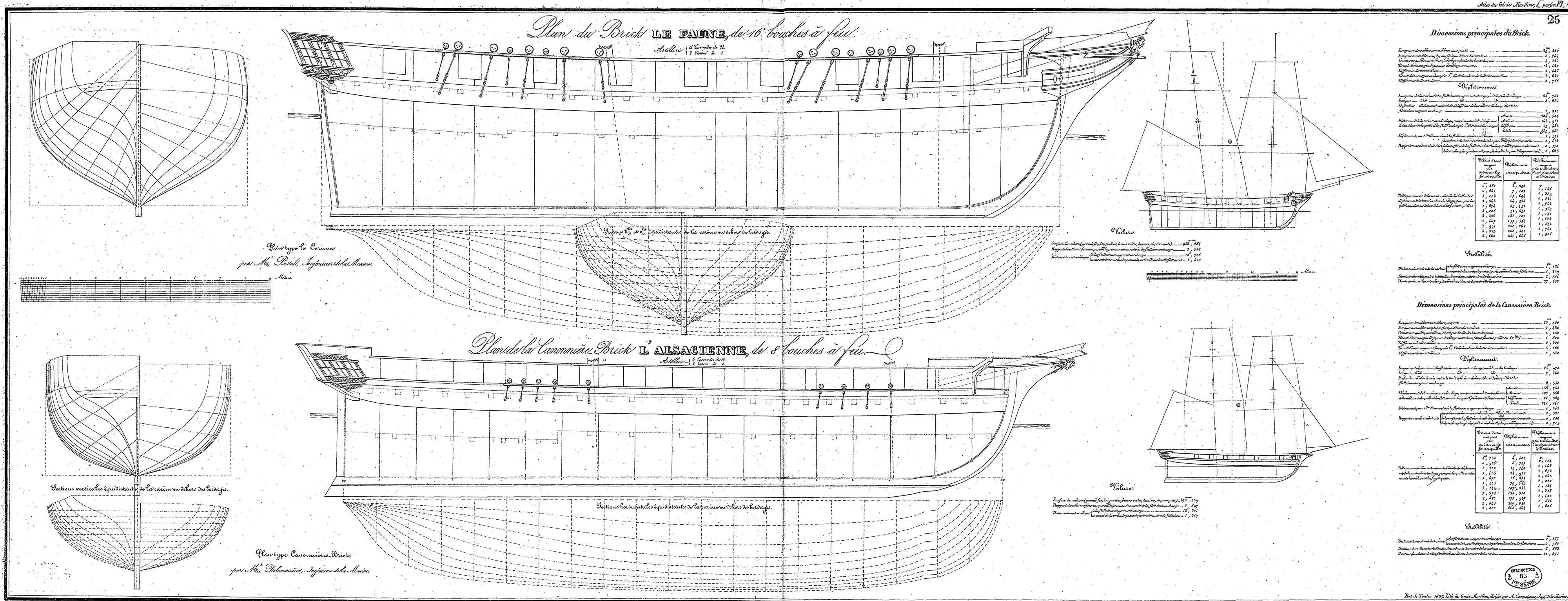

Here is a beautiful example for those who wonder about the usefulness of the forums . . . Sometimes the tool really proves valuable, as in the case mentioned here below.
Elsewhere someone else has taken up the issue raised by me long ago on the figurehead and sent me something really useful, something which I thank him publicly:
Quote:
Hello Jack,
Meanwhile, congratulations for what you are doing and how you teach it: for me as a beginner it is a real lesson of shipmodelling. I would like to re-open the issue of the figurehead sending a file that I found surfing on the internet: it is "Le Faune". Of course the Royal Navy changed its name as HMS Fawn, but as you can see the figurehead I thought would be of interest, of course if you do not already have it. Friendliness
The attached file is the following:
Le Faune.jpg (1,281kb) downloaded 25 time(s).
