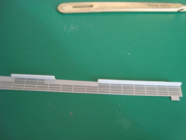

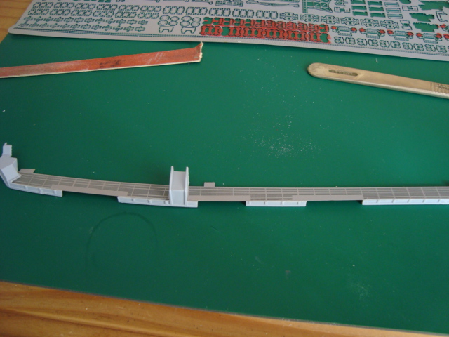

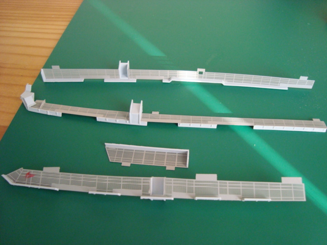

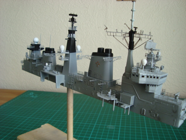

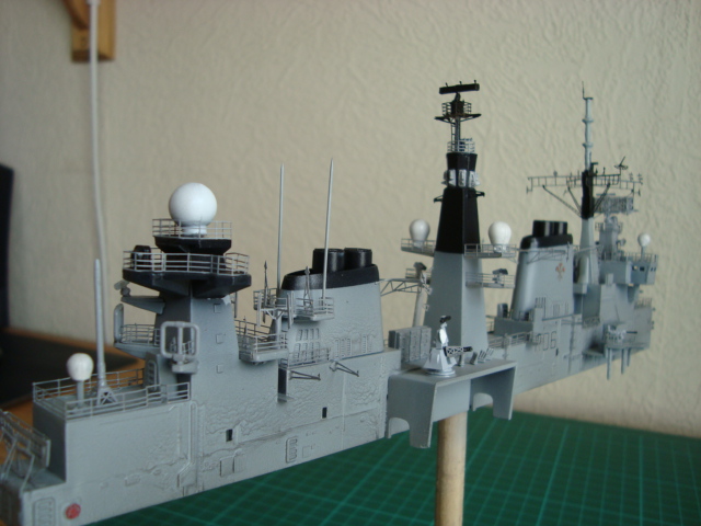

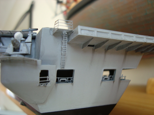

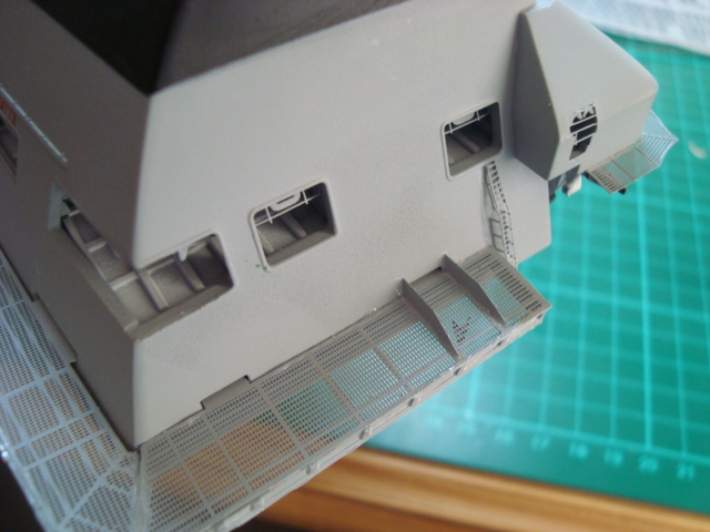

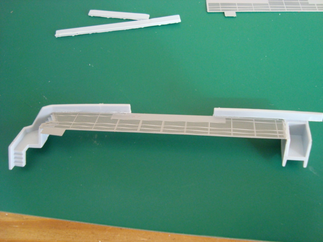

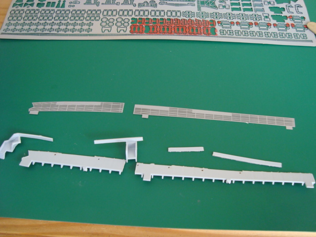

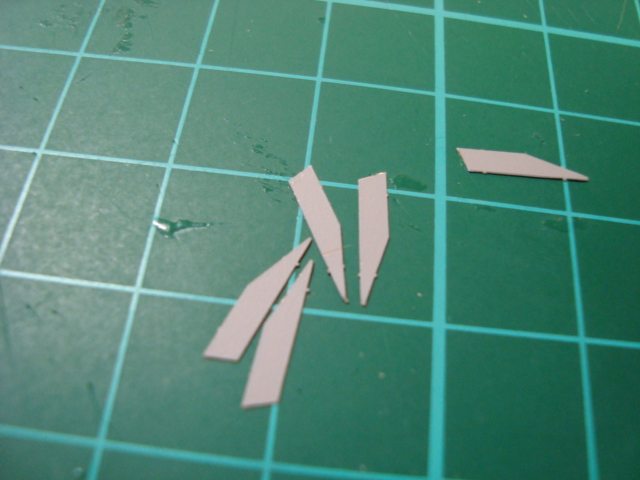

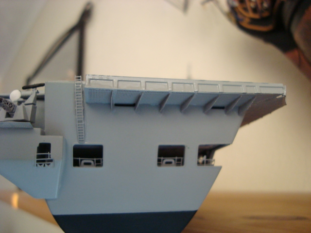

I'm calling the island structure complete now so it was time to start work on the catwalks and safety nets.

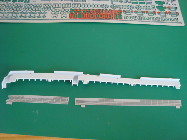

The kit parts were to be replaced with the etch parts and they really are very niceBigGrin
Only thing was though that the catwalk bulwarks and other bits had to be cut from the kit parts first, so its basically only the catwalk floors and nets that are being replaced.
The first pics show the completed island with decals, light grime wash and a satin overspray to get a more "metal" look to the paint.
The next lot of pics is to try to show the process of making one of the catwalks and what parts are required from the original kit parts. There are also 86 etch support brackets that are placed under the catwalks and I have just completed this horrible task today.

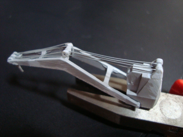

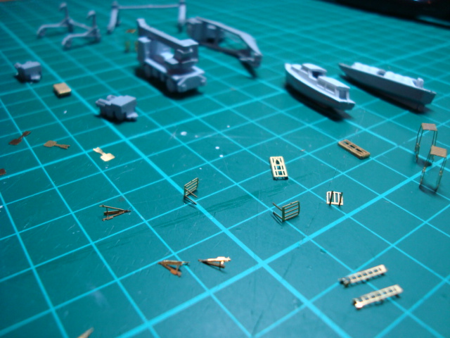

Now that the ship no longer needs to be turned over I can now start to add some detail to the flight deck, the first part being the crane pictured below.
BTW, the last but one pic of the stern shows a little problem I could have solved if Id thought a bit more - the locating slots in the hull for the catwalks are a lot bigger than the etch lugs that fit into them, I think I could have perhaps cut off the plastic kit lugs and fitted these to the etch parts as well and then these would have filled the slots in the hull. As it is now I will need to fill or cover these slots
More soonBigGrin

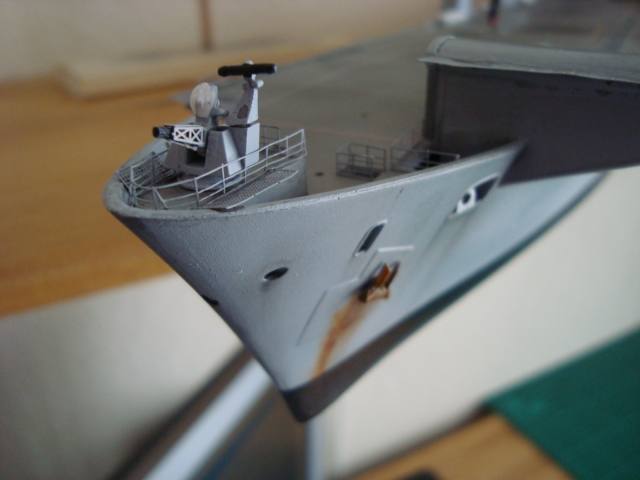

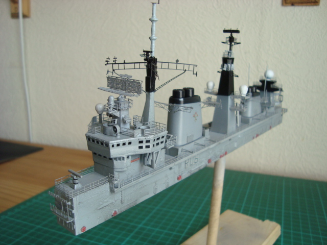

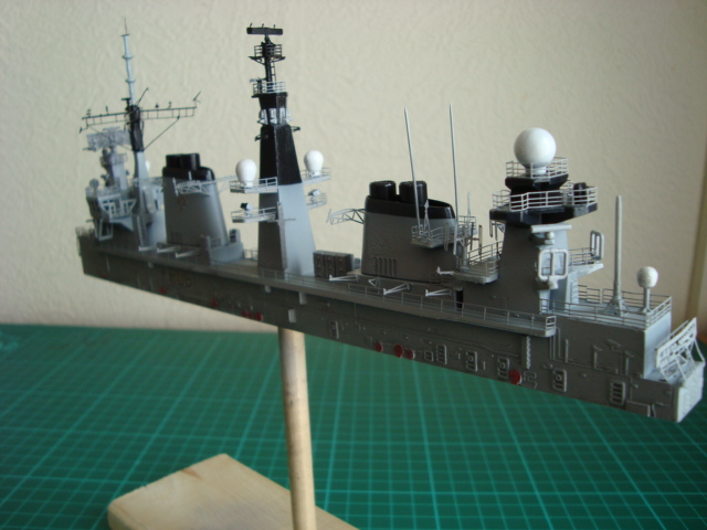

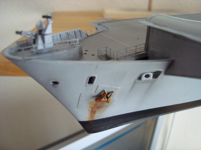

Thanks for the encouragement guys, I'm the feeling that this one is on the home straight now, the end is in sight and I may even begin to make a start on the resin sea base todayBigGrin
All catwalks and nets are done, and I have also just installed all the life raft cannisters around the catwalks.

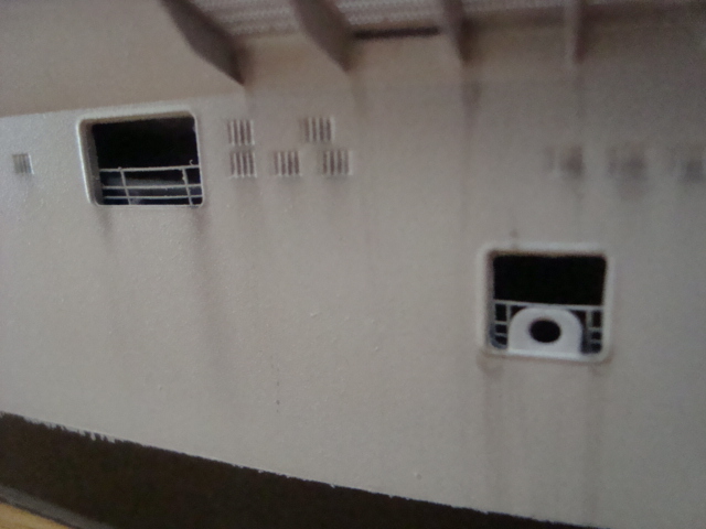

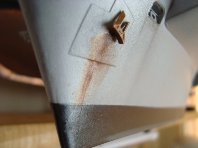

Started the weathering as well, now Im going by one pic of the Ilustrious for this - she can be seen all all different states from spotlessly clean to the ones with damage to her hull but I have gone for an in-between look.
I wanted very subtle grime streaking and some heavy rust streaks from the anchor as the pic below. The grey streaks seem even stronger on the camera than they really are but believe me it's very hard to know when to stop with weathering, and that's the hardest partBigGrin
I may have some pics with the island fitted in place tonight. More soon.

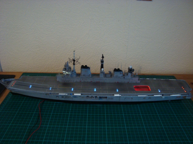

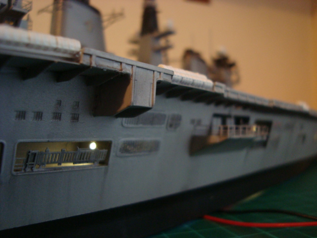

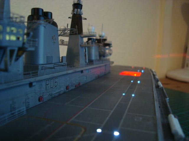

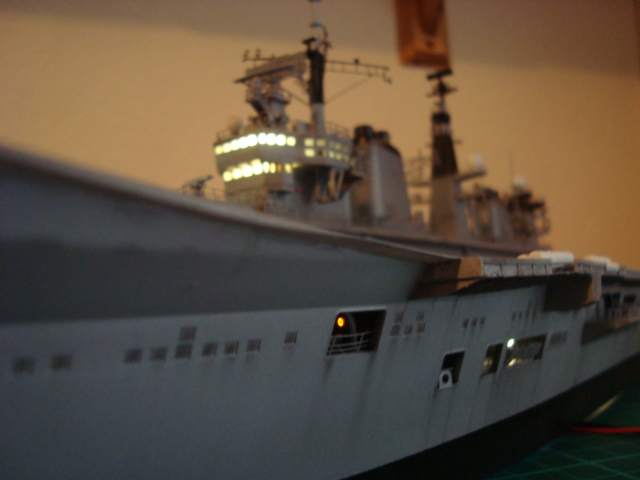

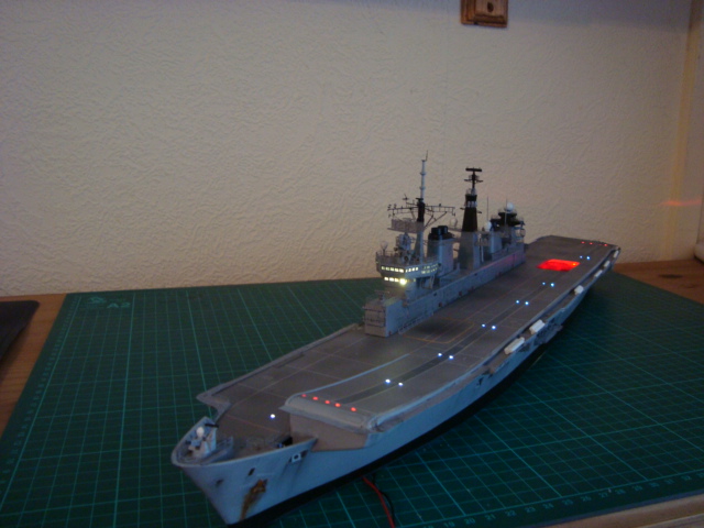

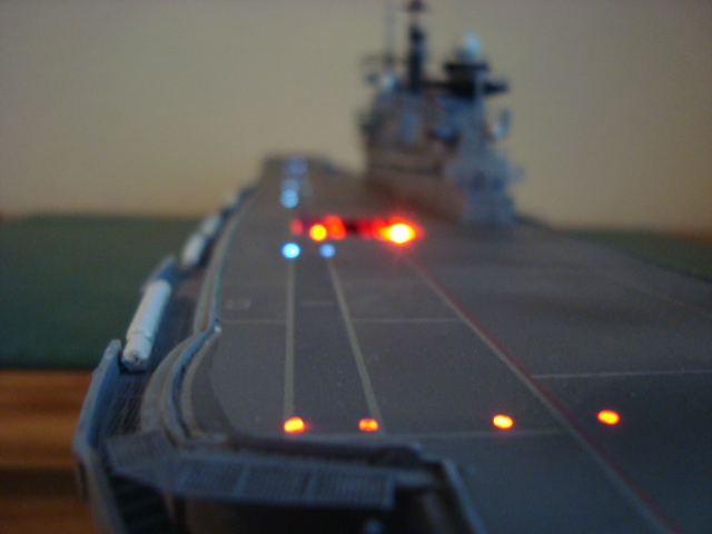

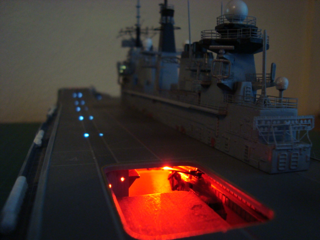

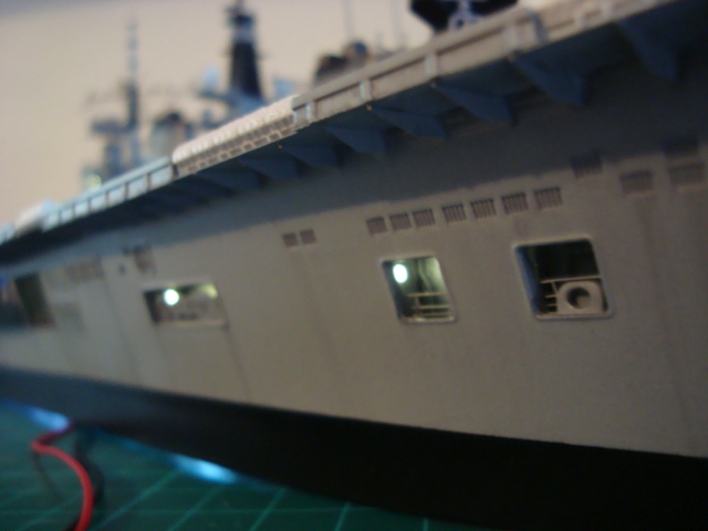

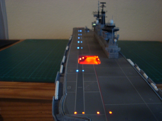

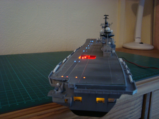

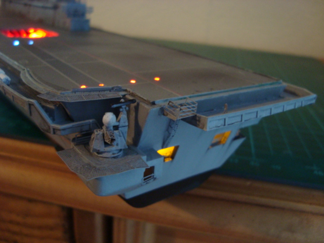

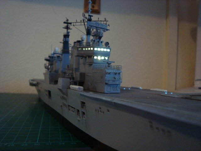

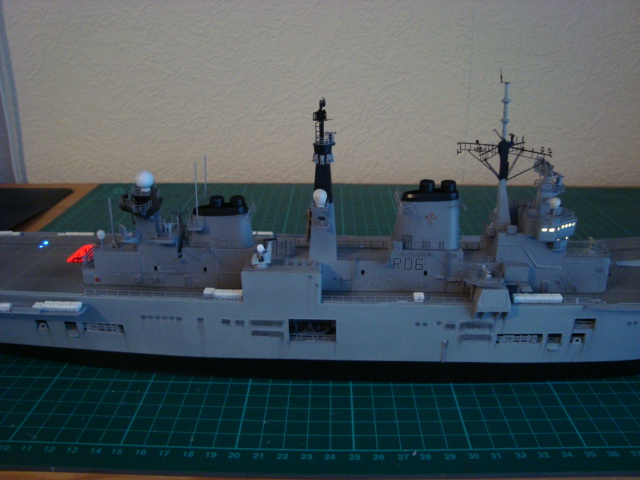

Thanks for all the commentsBigGrin As promised the island is now attached so I thought Id indulge in some low light shots even though it's not completed yetLaugh
Still to do are the work boats and Davits, crane, flag poles and some bits and bobs for the flight deck - forklifts, crane vehicle, towing cars and towbars, jacks and ladders.
I will probably be setting this into the sea base before adding all the above and the airwing of course which will consist of 2 seakings, 2 merlin, 6 harrier gr3 and 6 sea harrier.
#79 Posted : 09 August 2014 21:49:45
Those lighting effects look brilliant. Especially good as you have stopped any light leaks or light fairs that sometimes marr these sort of effects.
It really is a fantastic build.
