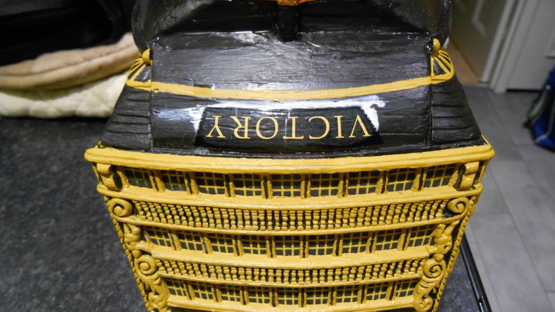

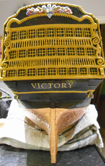

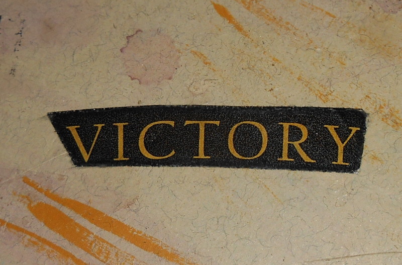

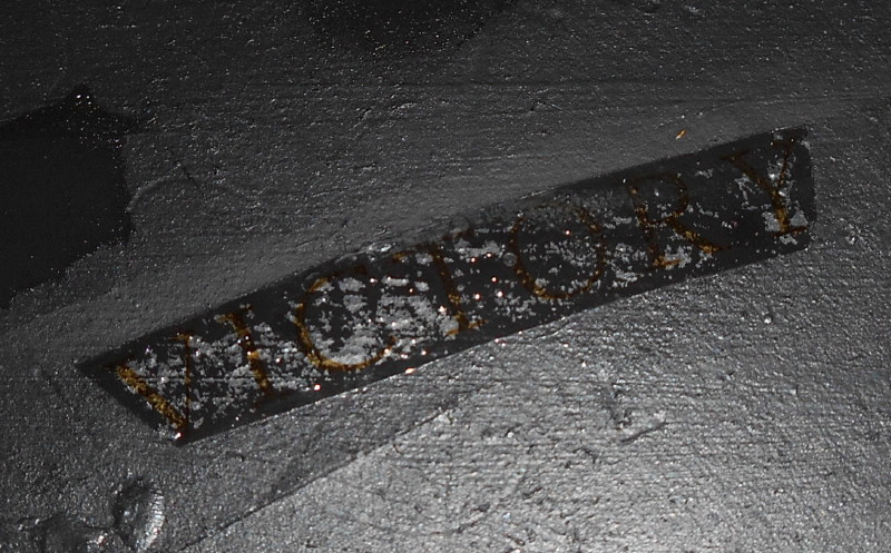

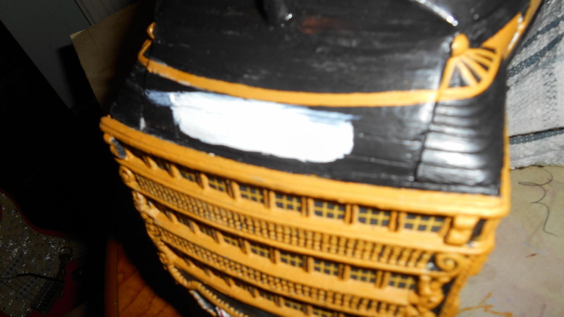

Over the last couple of days i have been working on the "VICTORY" decal at the stern of the ship, i started by printing the decal onto clear decal paper but when applied to the ship the black backround just hid it, then i tried printing it with a black backround and it still did the same thing (picture 2), so i painted a panel on the stern with two coats of white acrylic (picture 3), then stuck the decal onto that (picture 4), when everything was dry i painted around the decal with black (picture 5).

Hi Gibbo!
Well done on the nameplate! I had similar problems with the yellow, inkjet yellow ink on its own isn't bright enough (or opaque enough) to cover a dark background, the printers rely on a white paper base to allow it to 'shine' through.
I think I forgot to mention that I used the white background decal paper in the end! Blushing
The black ink for the background behind the letters blended in perfectly with the Admiralty black once both had had a clear matt varnish over the top!Cool

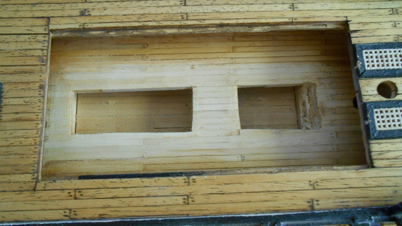

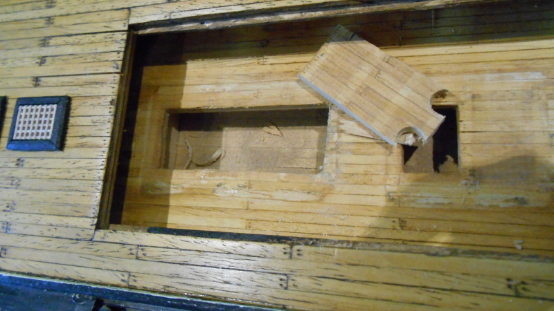

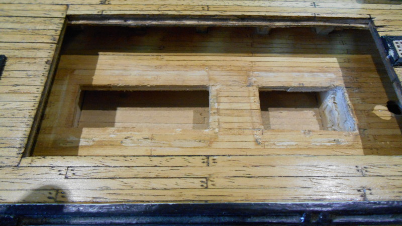

This weekend i decided to re-do the grating on the lower deck, i had already done some of the grating on the upper deck during the week

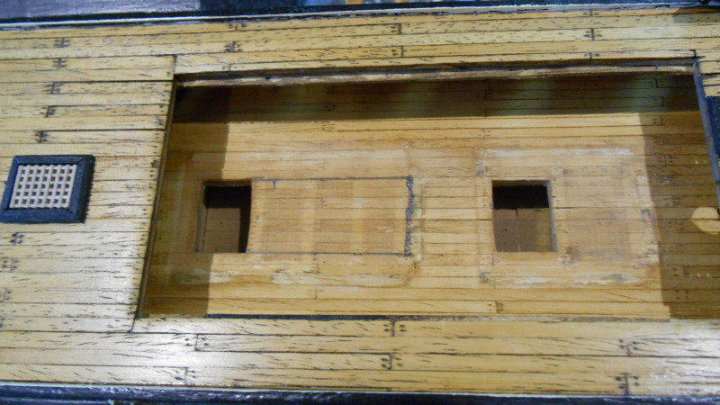

Marked & cut out the sections ready to take the new 1.2mm grating from Cornwall Model Boats, taking a saw & drill to already laid decks is a scary thing, measure ten times - cut once.

#74 Posted : 06 July 2014 23:53:25
Now that I do like Gibbo, beautiful work on those gratings... Cutting holes in a previously completed piece is always scary and your advice of measuring 10 times and cutting once is so very valuable to all newcomers....Drool Drool .. Keep up the great work, will be following....

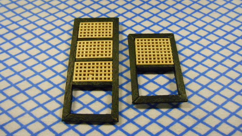

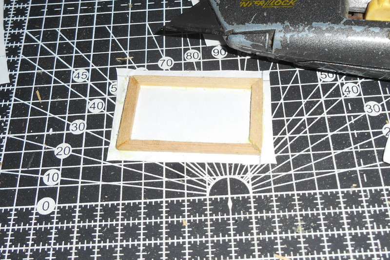

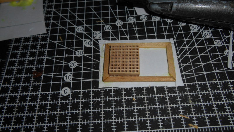

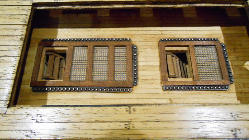

I built the grating first and then built the frames around them, i found it a lot easier to stick the frames onto paper first, i marked two lines at 90 degrees to make sure they are square and when dry cut them out,and finally the new frames ready to go on.

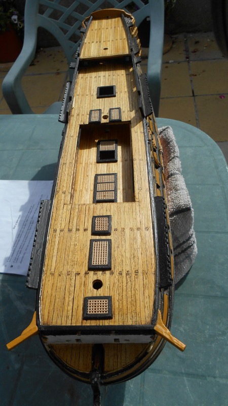

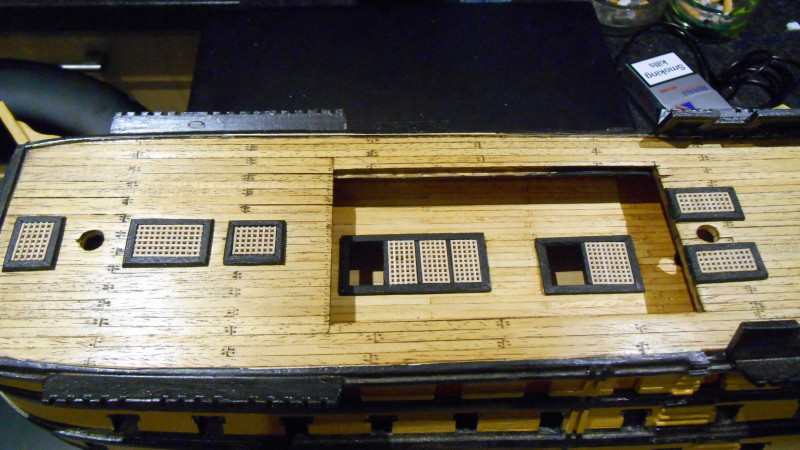

Gratings and hatches complete, waiting for ladders to arrive, next up the Rudder.

Blimey Gibbo, that brings back some frightening memories Blink
Glad to see you are going for the improvements on your Victory, the gratings look great, be aware though that there are a couple of divisions in the forecastle gratings.
